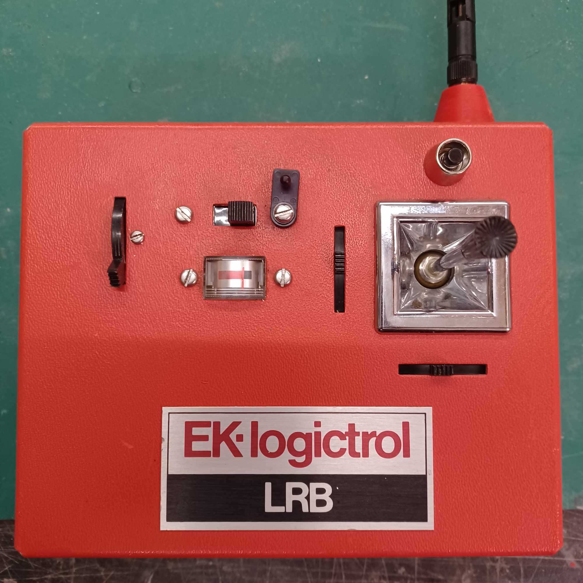

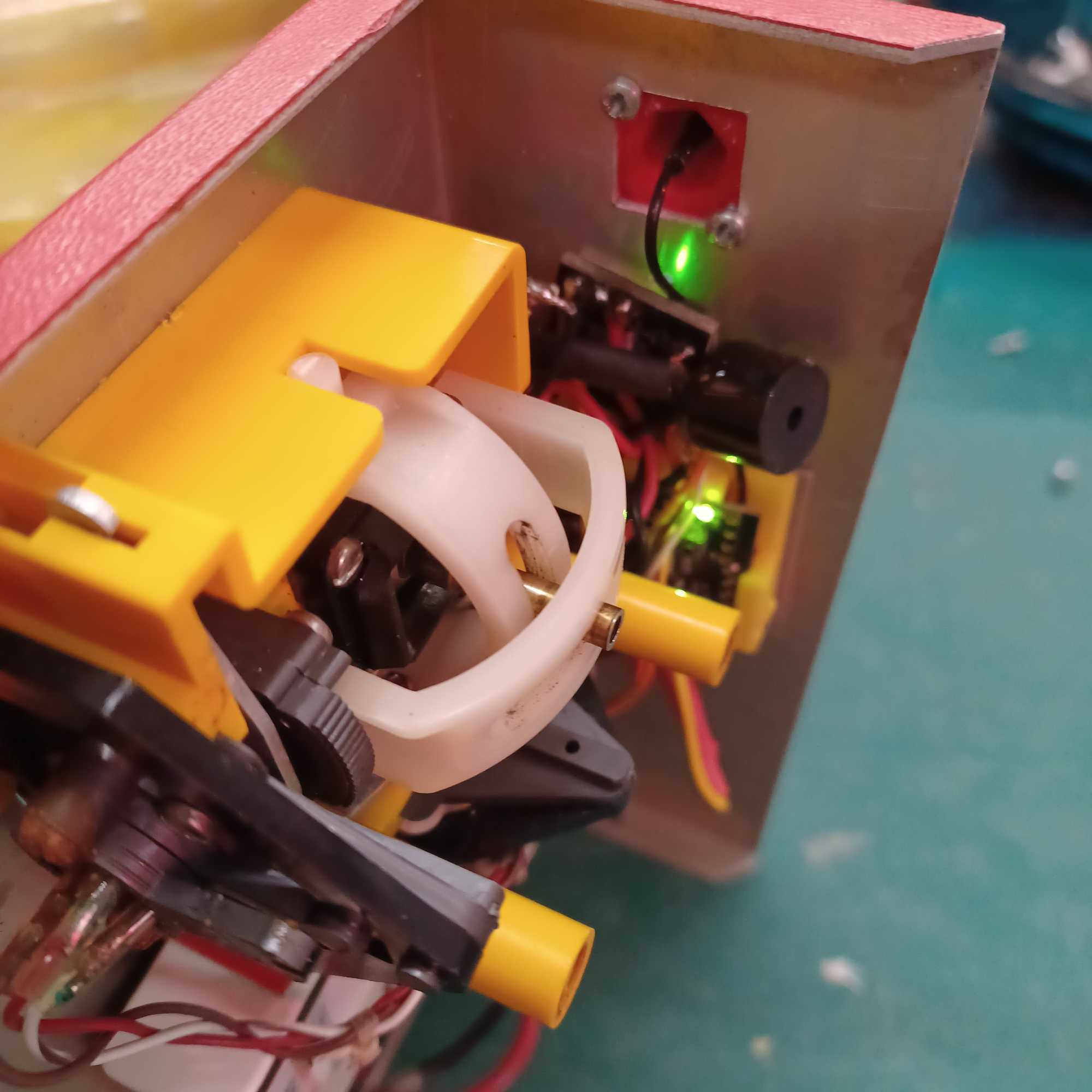

Quick report on a 3 channel transmitter conversion using one of Phil's 4 channel Digispark (aileron pot was wired to rudder and aileron inputs to avoid any loose signals floating around). It will be used with one of Tobe's Rand Galloping Ghost Replicas.
Used a lemon DIY module for the 2.4GHz...what else?!? I may sound a bit biased methinks! :)
The encoder and Lemon module mounted neatly on the top face of the Tx and is powered by a Poover (other brands are available) 9V rechargeable Lithium PP9 equivalent.
Hope you like?

Very neat! The mechanical bits look in excellent condition.

Very good job, so clean.
très soigné comme travail, simple que d'apparence. merci du partage

Nice job :)
Is the red antenna base custom made or part of the original (modified?)? My LRB is an earlier model and the antenna base is much taller and the antenna hole a smaller diameter.

Wayne_H wrote: 20 Nov 2024, 14:09 Nice job :)
Available here, Wayne
https://www.ebay.co.uk/itm/134615248001
just specify that you want a red instead of black antenna mount at check out.
