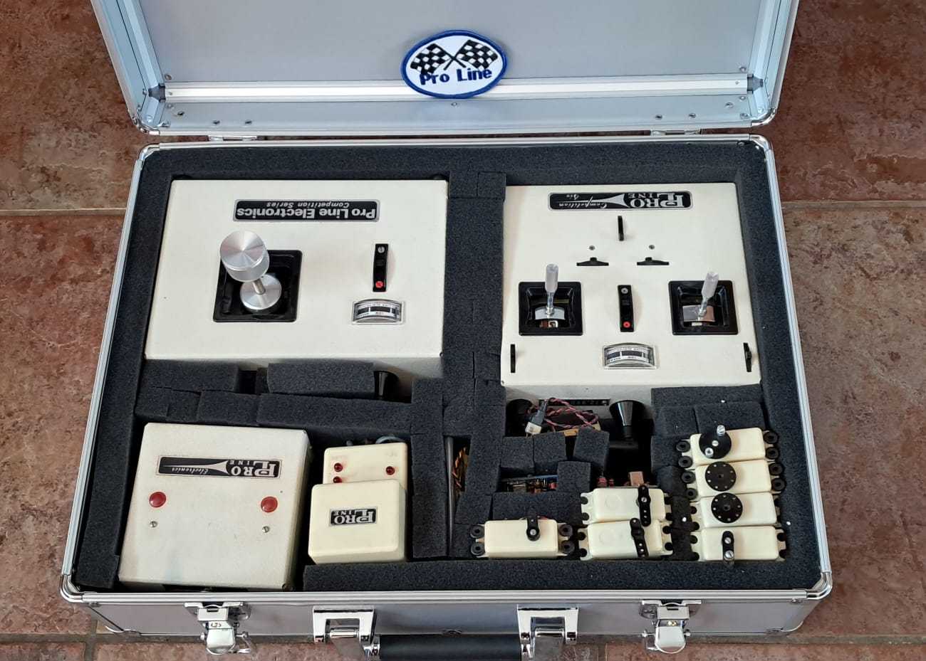

One of Lemon's best UK customers (Pattern Flyer and serial Tx converter, Andy Hopkins from Somerset) has just produced these two beauties that I thought I should share with fellow Forumites!
Both converted using Mike's GTS encoder (as he tried to use the PPM from the Pro-Line but found the channel mapping was incorrect for the Lemon DIY) coupled to LemonRx 2.4 RF module https://www.ebay.co.uk/itm/133704108565
Enjoy!

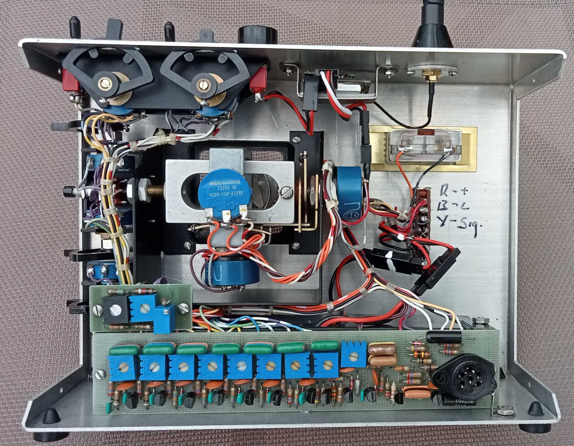

I dont normally do conversions for others but Ray asked very nicely, I had to find him a Pro-Line Comp 6 which IIRC came from Duie.
This was nearly 5 years ago, very little room inside, a 2S 800 just fits:

Very nice Stuart and Phil! I have a couple of dual sticks and a single stick ProLine Competition Six - each with the wonderful all metal gimbals - that are in my project queue, so very interested to see how those turned out.
Stuart - looks like the original encoder boards were kept in the conversions - is that correct? Any particular reason why?
Phil - it looks like there are wheel trims on the vertical channels (elevator & throttle) but regular tabbed trims on the horizontal (rudder & elevator) ones, or is it just that the centers of the horizontals are painted or something? Does/did that unit have the cross trims?
Re: Pro-Lines for the 21st Century
Hi Bill
re the trims, the set went to Ray a long time ago, I recall they were all 270° trims, and yes the white dot disappears under the slot! most peculiar! :D

When I finally got one recently, I found it interesting that the Futaba Module 7 of the late 1970's, AFAIK the first Futabas with a plug-in frequency module, seemed to emulate a lot of the features of the ProLine Competitions (I think Futaba was trying to break in with the top pattern and other contest fliers at the time) including the 270° wheel trims in a cross-trim configuration.

GardenGate wrote: 03 Dec 2024, 16:30 Stuart - looks like the original encoder boards were kept in the conversions - is that correct? Any particular reason why?
Often try and keep the original PCB if space allows, we dont know what folks might want to do to them in another 50 years!?!
A couple of mine: 2.4 GTS/Lemon converted Comp 6 Mk1 and a Mk2 in original 72MHz, enables you to see the subtle differences in case design, sticks, batteries, circuitry, meter etc between the two iterations of Pro-Line
