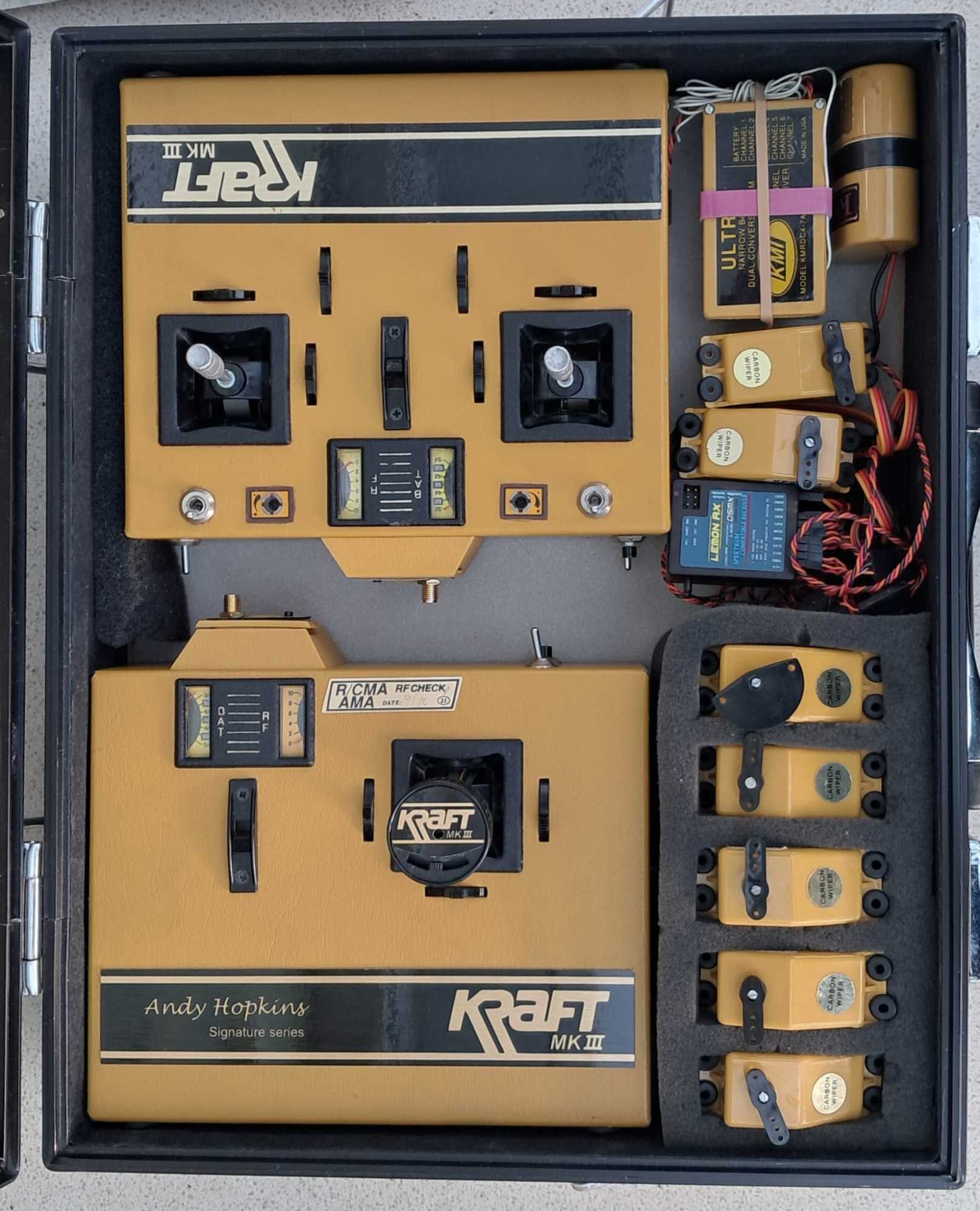

One of Lemon's best customers has sent me some photos of his Kraft Mk III in twin and single stick format.
These have been cleverly converted utilising the original encoders feeding a pulse into a Lemon DIY module with some clever circuitry to adapt the short Kraft trigger pulse to suit the lemon 2.4 module. Anyone who knows these later style of plug-in RF module of Krafts, will know that the conversion to 2.4 GHz is not as straightforward as it seems. Together with his electronic expert friend, a new board to replace the existing Kraft RF module design some circuitry to enable the packaging of the Lemon module within the original Kraft plug in module case.
The major advantage of this is that the module is still able to plug in using the original socket and work both meters (Battery V & " RF") where applicable.
Similar Plug and Play conversions utilising the Kraft synthesised module are offered in the States, and these UK produced modules are the first to use the more compact modules more commonly found in later Kraft transmitters.

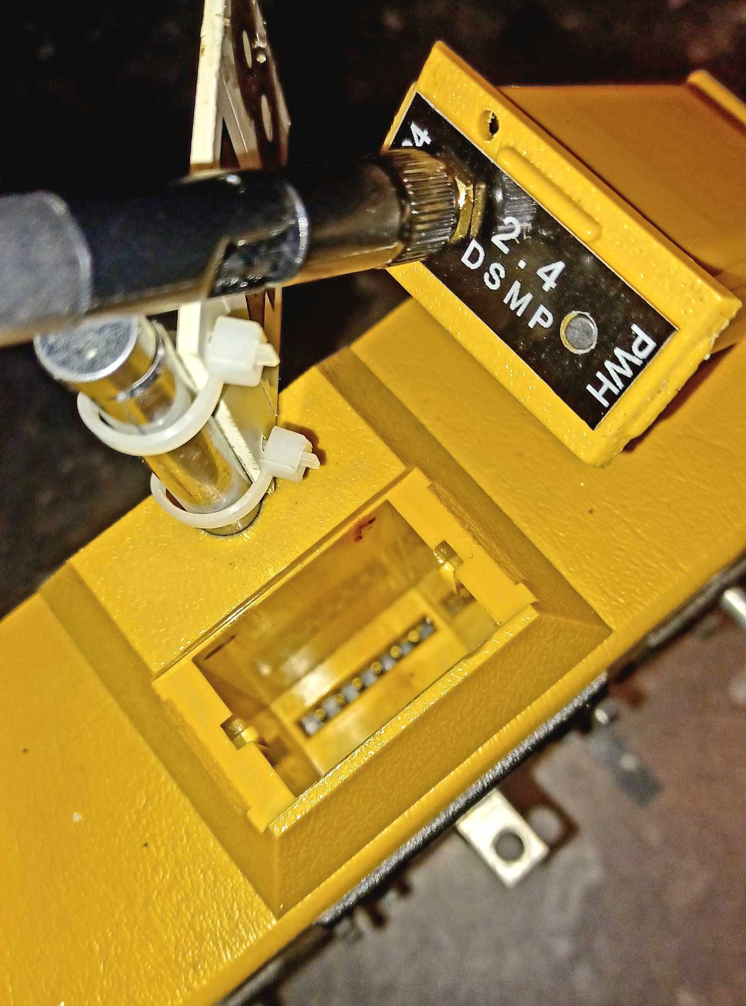

Here is a small batch of the Lemon 2.4 modules installed in the Kraft module case:
If anyone is interested in one of these, we have a small number of boards designed specifically to install a lemon DIY module and can offer a conversion service using your original Kraft module case and plug as donor parts. Please get in touch if interested?

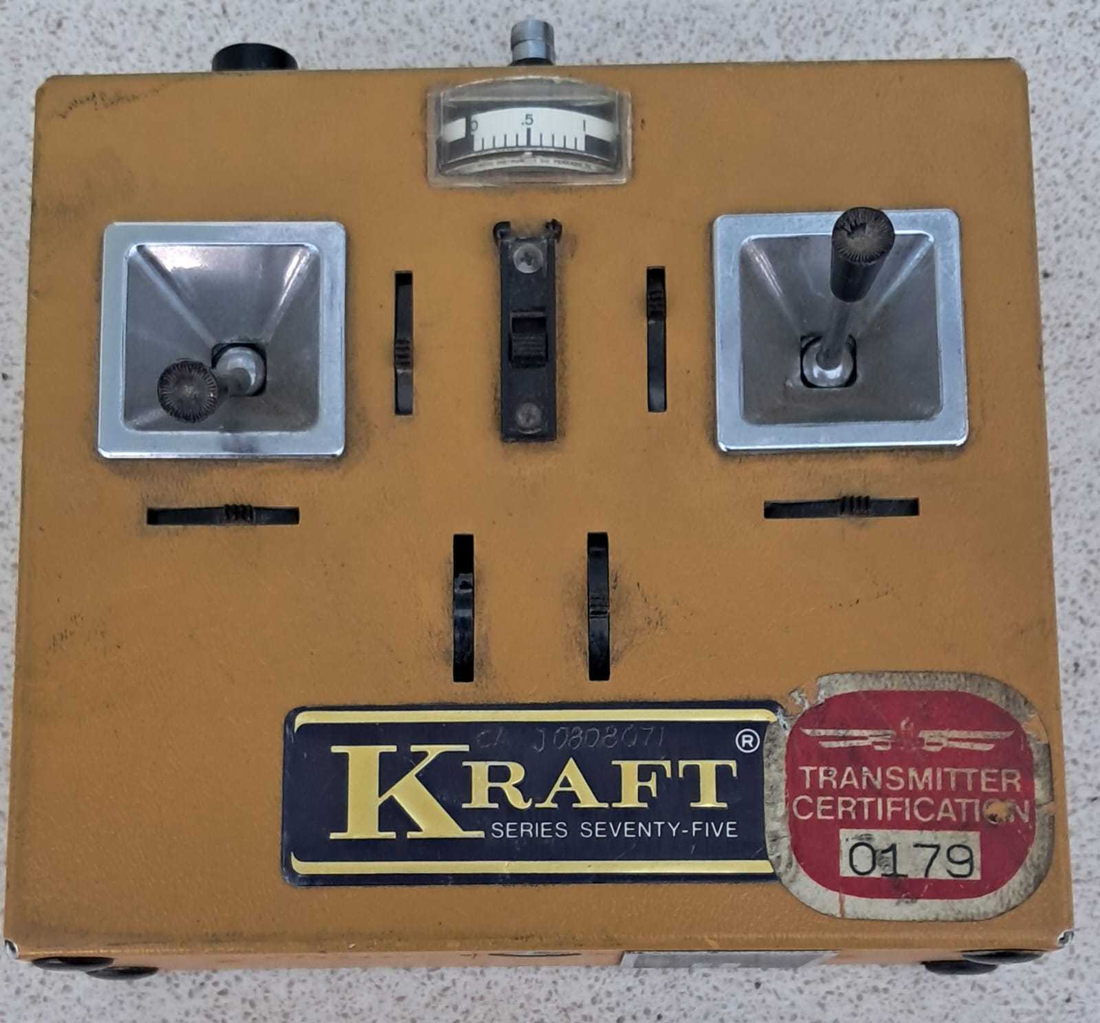

Here is a before and after of a Series 75 using Mike's encoder and Lemon RF module:

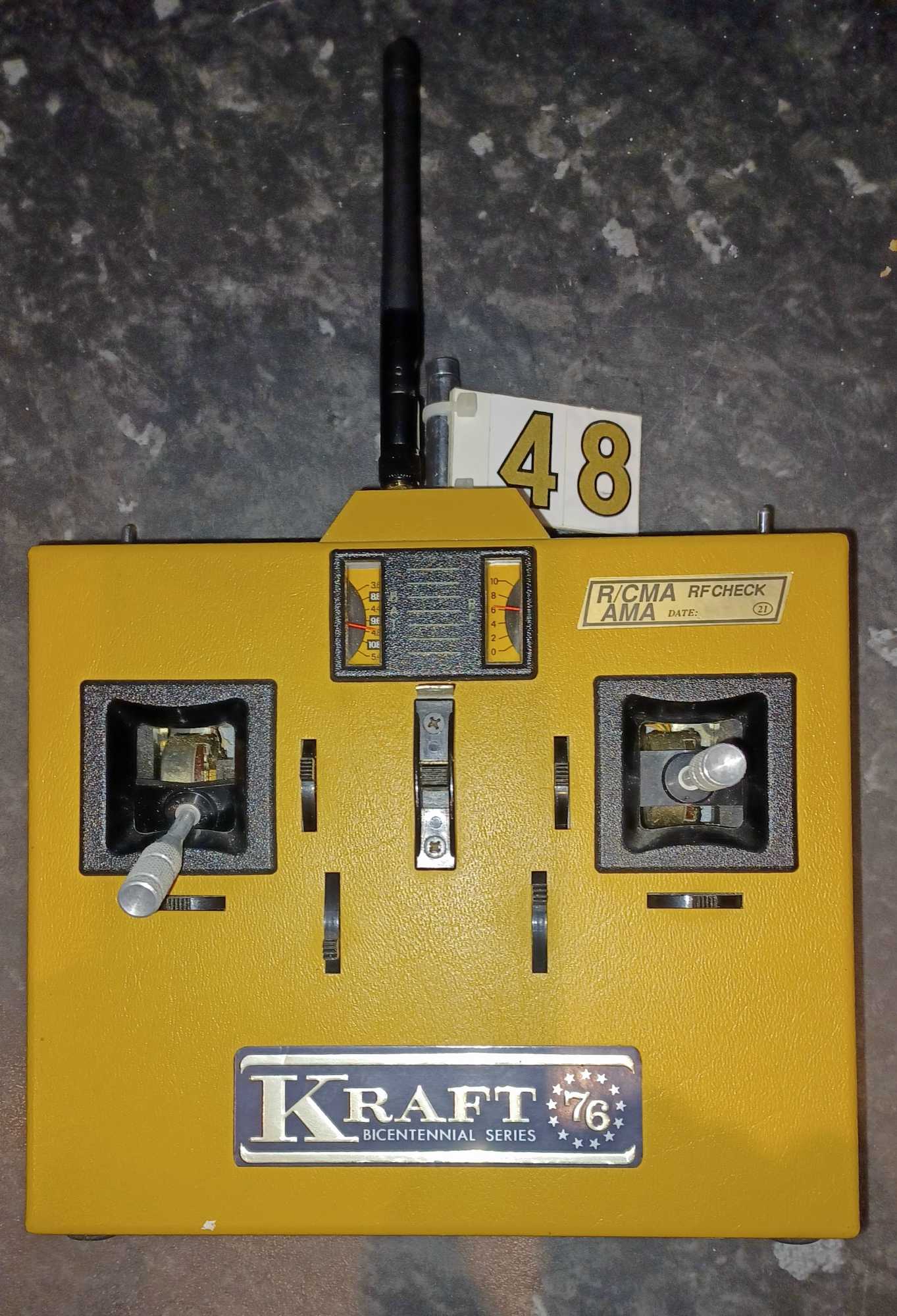

And here is my Bi-centennial series converted using the new plug in module/lemon DIY combo.
Hope you can see both meters working too?
