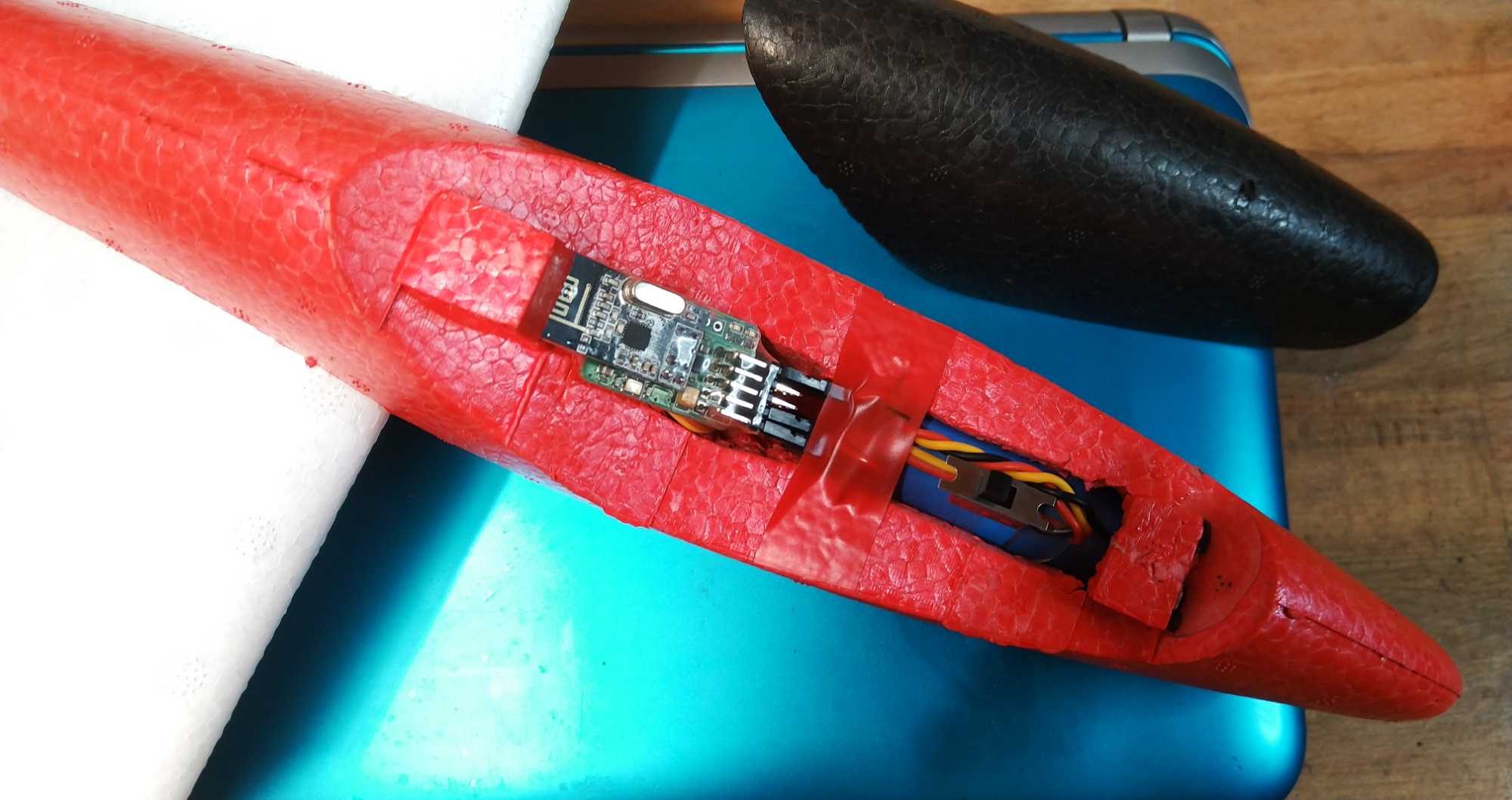

Well I got the centre section carbon outer tube fixed in place. Hot glue then fibreglass tape over the top to keep it tidy. I just cut the carbon tube with a zona saw. Made v little mess and just vacuumed it up.
Looks good. I've slid the rod through the centre section and dry fitted the tubes in the wings and pushed the lot into place, and the whole assembly seems to line up nicely. Will glue it all up tomorrow then I need to sort the servo linkages and run the servo wires to the cockpit.

In the cockpit I'd suggest removing the absolute minimum of material, just enough to get your gear in - and to melt it away rather than cut.
You see some build photos on the FB group where they've hollowed it right out and left just a 1/4" wall, usually followed by a photo of a pile of confetti :D

Point taken about the cockpit. I'm using my trusty dirt cheap Flysky FSI6 transmitter with its little lightweight receiver and two 'brand x' 9g servos.

What's a good idea for rx battery in a LIDL glider? I'm running a Flysky 6 ch rx, and two SG90 cheapie servos. I was going to try a 1S lipo ? Anyone else tried this? Trying to keep weight down.

I used a one-cell Lithium in my twisty-wing Lidl. See the very last few seconds of this video, where I take the canopy off.
It's an AA-size rechargeable, but a Lithium cell. I think they're named 14500. That was a cheap Chinese one, and I think it's a fake as it's even lighter than a 'real' 14500. It only has a capacity of about 250mAh, whereas a 'real' 14500 is normally closer to 1000 mAh. I suspect it's a tiny cell, inside an empty-ish case. Anyway, it has plenty of capacity for that model.
That video's now five years old. Probably I should fit a fresh cell, before I fly it again. I'll probably put in one from a discarded vape this time.

Stew wrote: 01 Jan 2025, 19:08I was going to try a 1S lipo ? Anyone else tried this?
Nearly all my gliders use a single cell :D Most modern receivers are fine on a single cell, the only ones I'd be wary of is the older Spekky receivers which had a poor (high dropout) regulator and would brown-out where others continue working fine. Its a lower pack voltage than a 4-cell NiMh but it has such a low ESR that this voltage is rock solid with varying servo loads :D
Of my various lidls, the lidl-wing has an 18650, the twisty a 400mAh lipo cell, the rudder-elevator one has a big 1000mAh 1S mounted in the canopy. The powered lidl of course use the speed controllers 5v BEC. My two SAS Wildthings and two Veron Impalas each have an 18650 cell. The Elf DLG uses a tiny 150mAh cell and the Instigator a single 350mAh lipo cell :)
