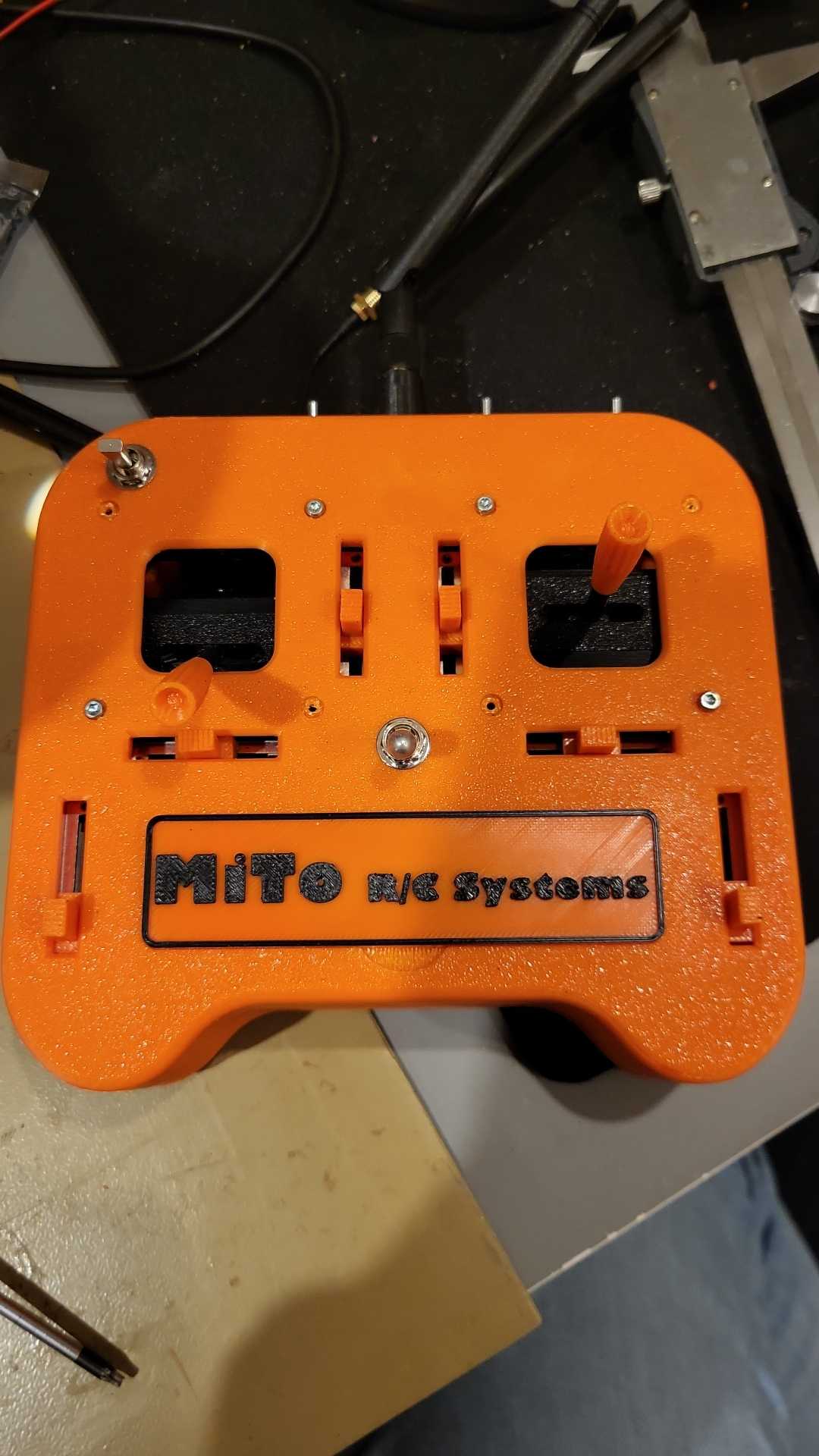

Enough of this and let us go back to what is going on, let me introduce you to the next generation of MiTo transmitters, you have probably seen the new
viewtopic.php?f=27&t=1914

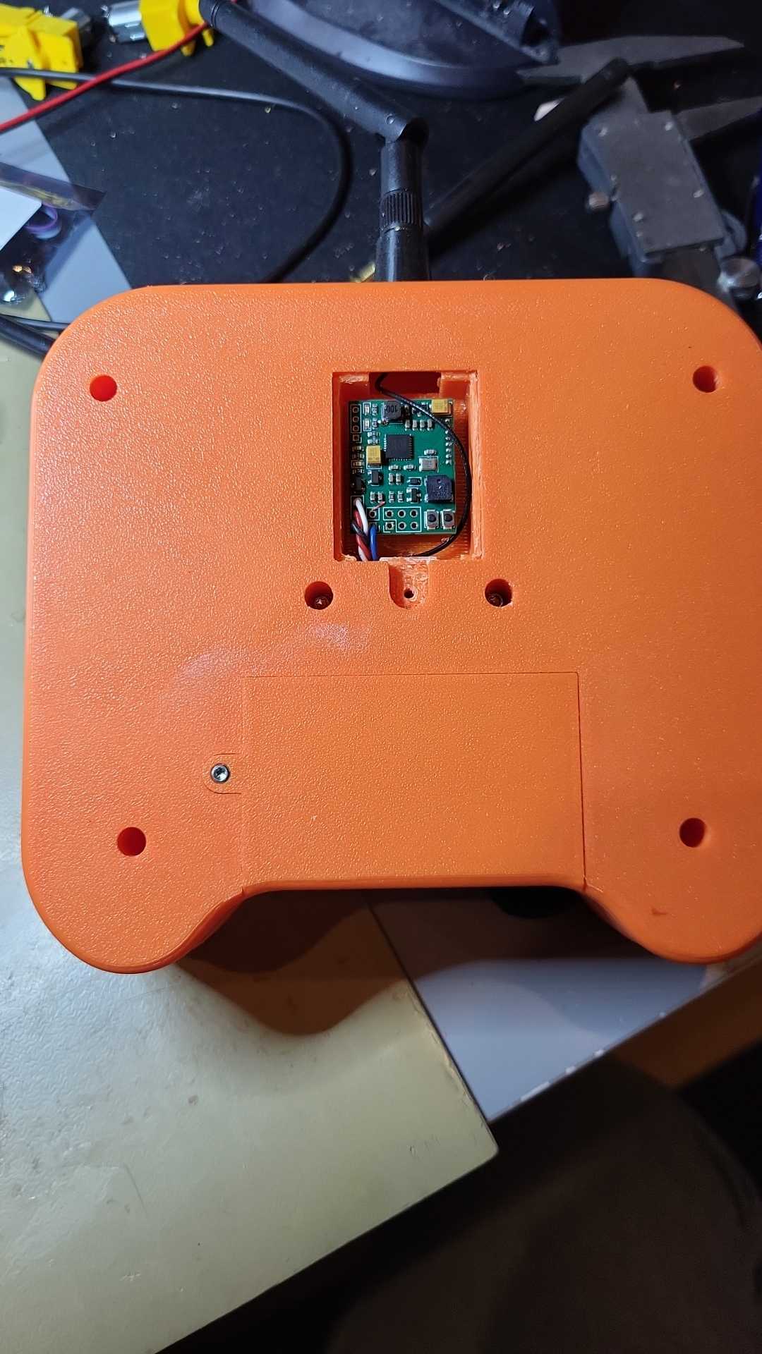

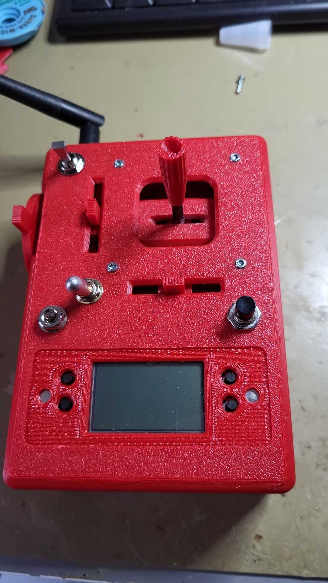

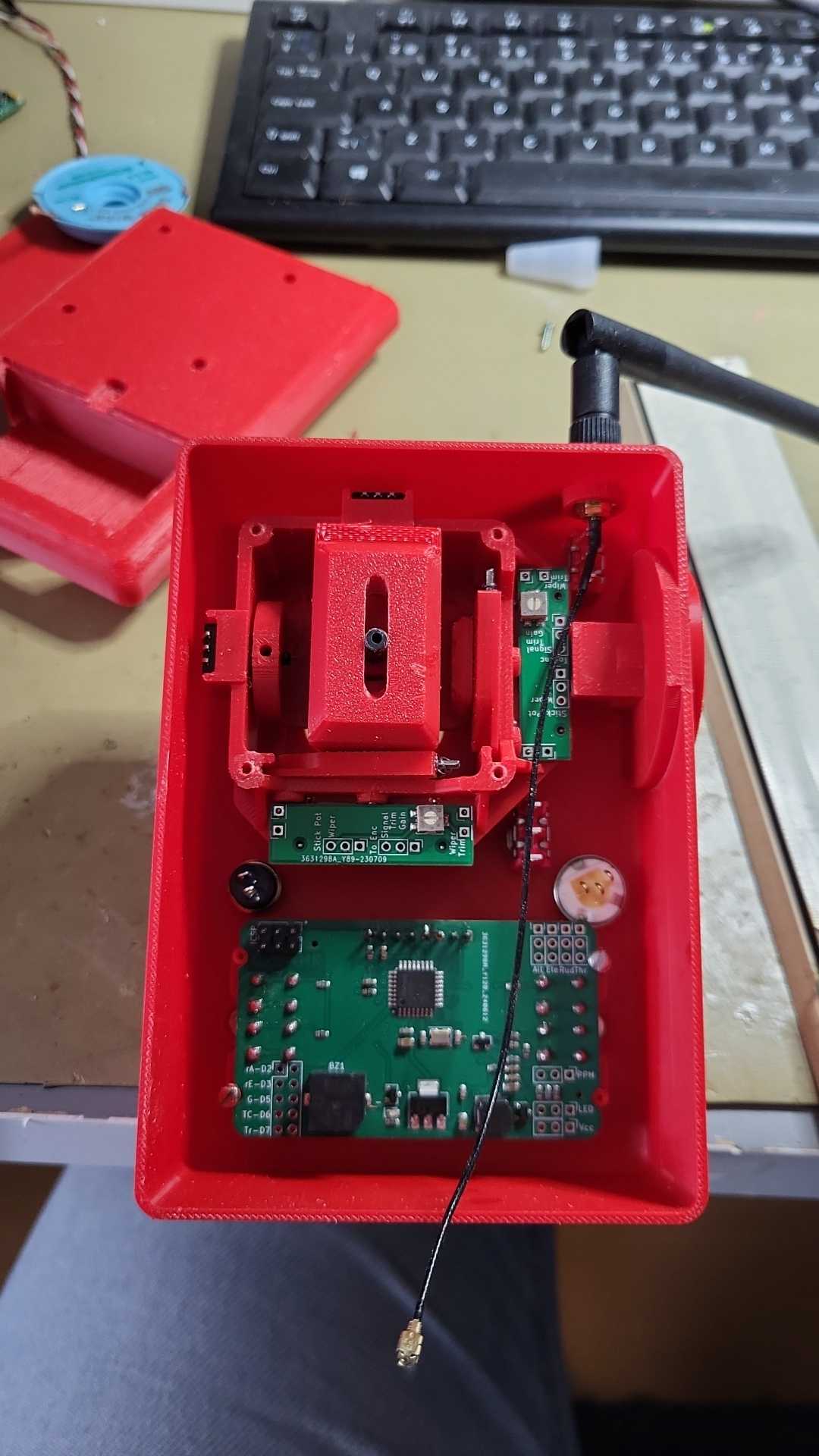

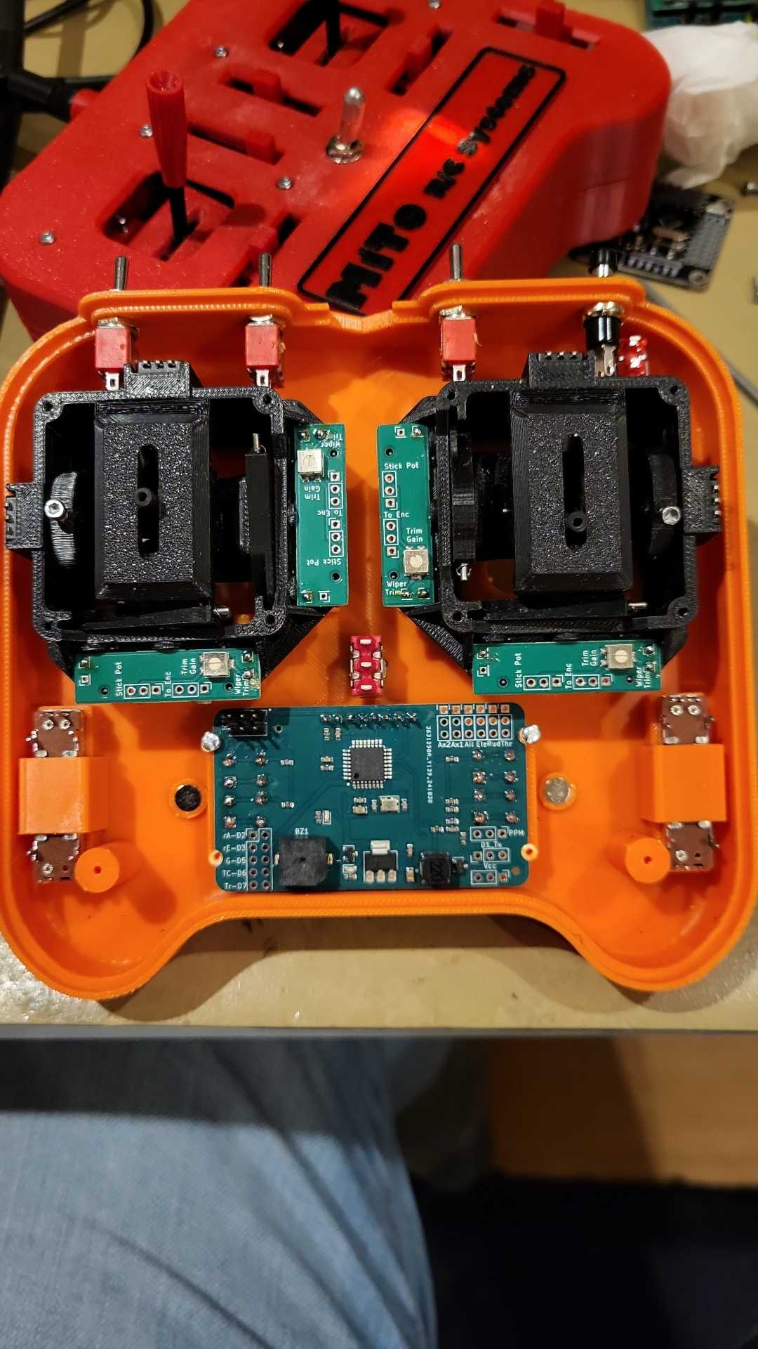

...but of course there is a more Mike&Tobe version!
Here comes the MiTI MKII that match the above RX

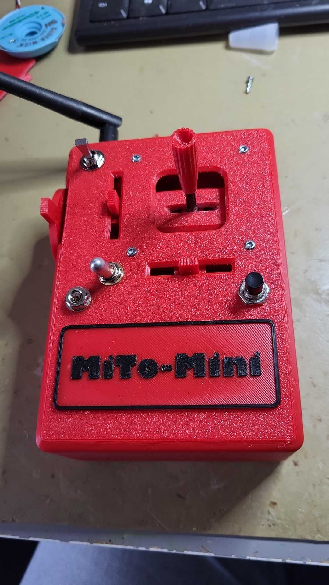

....and for those going light there is a mini version:

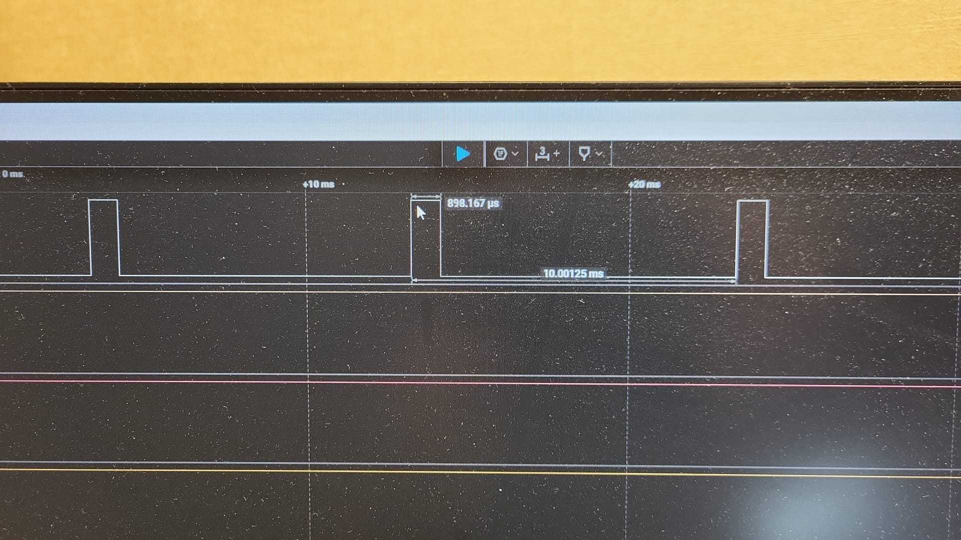

Did some math around my version for nRF24_FHSS, so this is based on my code with the packeting as Mike with failsafe flag for 8 channels:
NRF24L01+ Single Packet Transmission Timing Analysis
1. SPI Communication (Pre-transmission)
SPI Clock: 8MHz
Command bytes to NRF24: ~10 bytes
Time per byte: 1µs
Command transmission: 10µs
Mode switching delays: 90µs
Total SPI Setup: 100µs
2. NRF24 Internal Processing
TX FIFO loading via SPI: 50µs
Packet Assembly:
Preamble (1 byte): 32µs
Address (4 bytes): 20µs
Control field: 10µs
TX settle time: 40µs
Total Internal Processing: 150µs
3. RF Transmission
Payload: 17 bytes = 136 bits
Data rate: 250kbps
Calculation: 136/250,000 = 0.544ms
Total RF Time: 544µs
4. Post-transmission Processing
Status register read: 10µs
Flag clearing: 10µs
Mode switching: 80µs
Total Cleanup: 100µs
Total Theoretical Minimum Time
CopyPre-transmission: 100µs
Internal Process: 150µs
RF Transmission: 544µs
Post-transmission: 100µs
Total: 894µs (0.894ms)
The total theoretical minimum time for a single packet transmission is 0.894ms under ideal conditions, not accounting for any environmental interference or retries.
