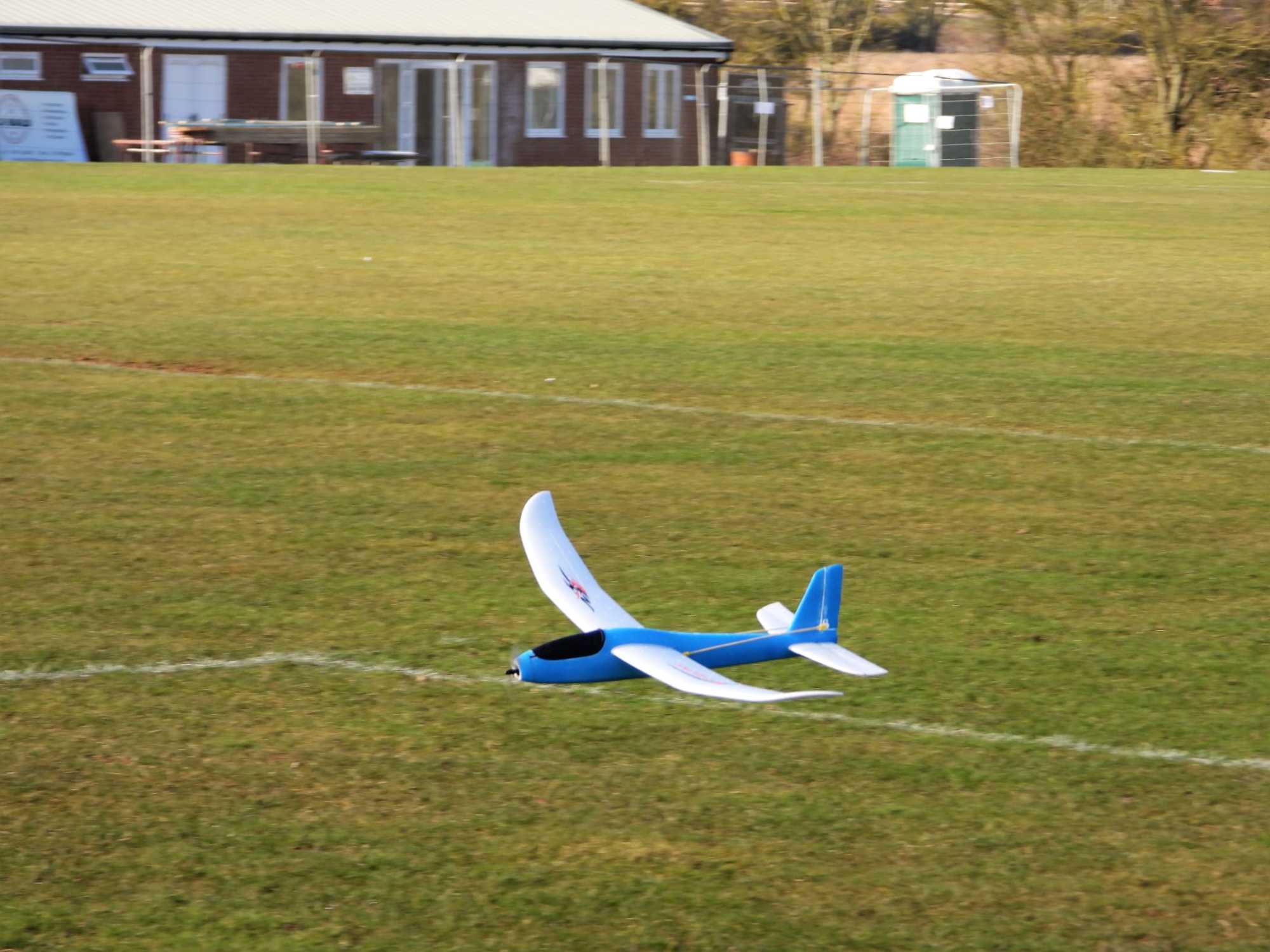

I've got one of these Cheetah lightweight 'toy' foamy gliders that I've converted to motor power, but it would work well as a glider too. I really ought to change the pushrods - it was a quick lash-up, so I used bamboo skewers, as I didn't expect it to fly very well. But it actually flies great - much better glide than the Lidl glider, and the wing is in two pieces with a sort of dovetail joint at the centre, so it would fit in your backpack.
Fuselage is a bit longer (600 mm) but you could saw it in half and add some kind of joiner (carbon rod or similar) if you want it to break down smaller.
It's slower flying than the Lidl ones, so wouldn't work well in windy conditions.
I've not added any sort of wing joiner, yet, and I do get a considerable increase in dihedral when pulling a loop! :D
It was as cheap as a Lidl when I bought mine. Here's an Ali Express seller (click one of the '99cm' versions in 'Color:' choice.) https://www.aliexpress.com/item/1005006592515475.html

After getting the Cheetah out to photograph it, I took it with me on Friday, and one of my mates, Mike, snapped a few flying shots.
