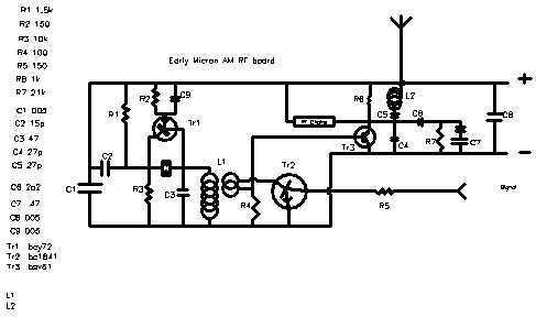

My initial drafing of the RF board. I was going to test it, but as soon as I twiddled the ferrite slug, it collapsed in a heap of dirt. So I need to order another one, and hope that it's an appropriate permissivity, or however they measure these things...

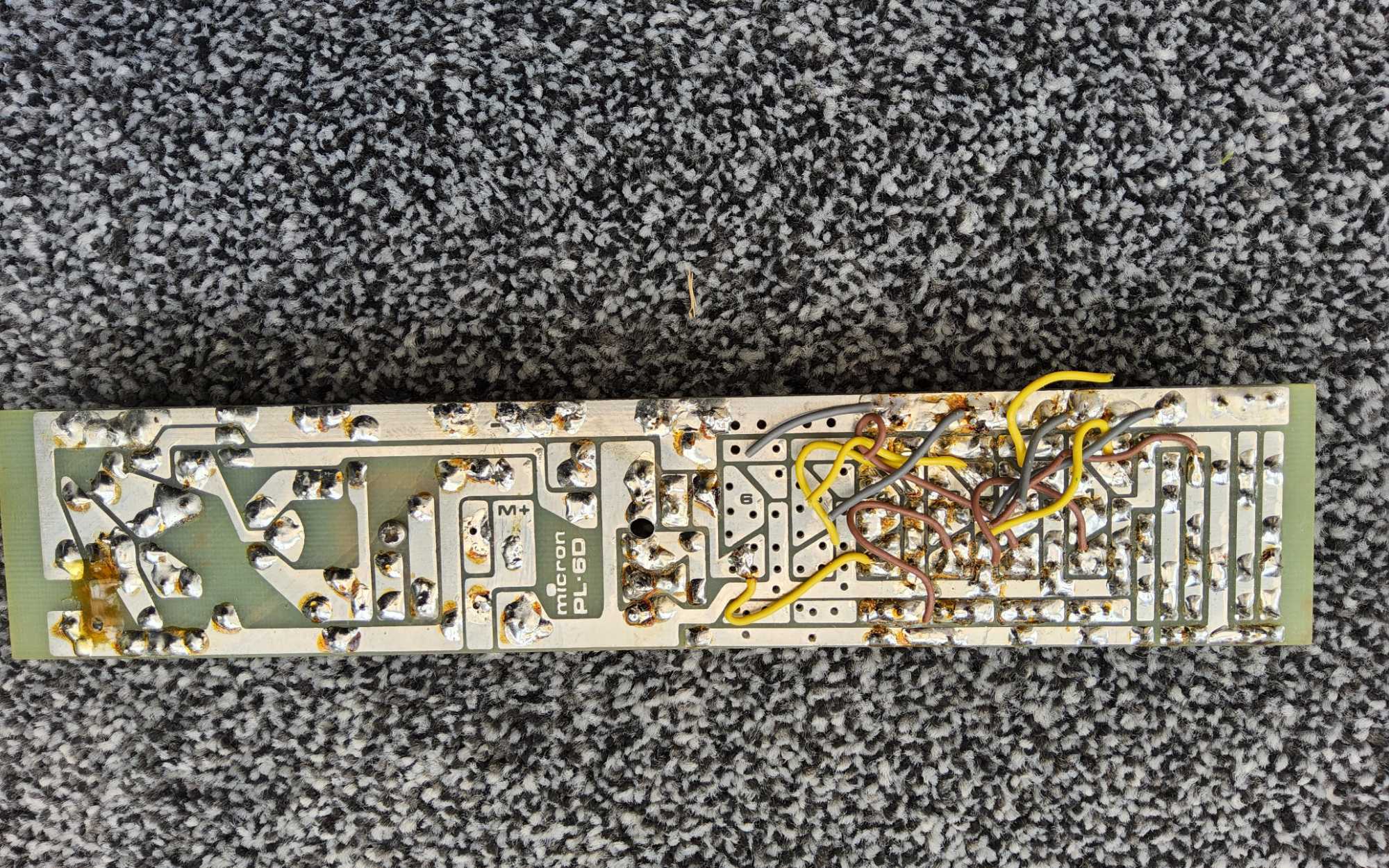

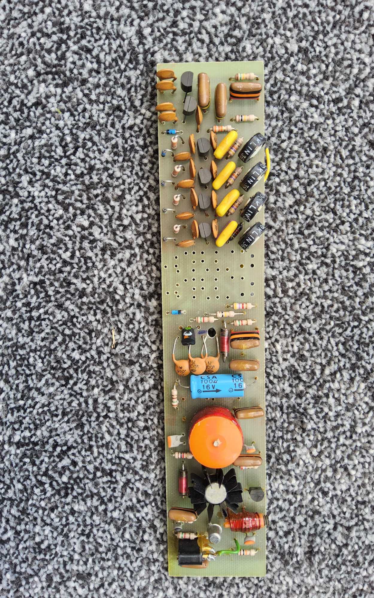

I finally found my Micron PL6D board as removed before the 2.4 GHz conversion. Not sure if the pics will be any help to you, but was working ok at the time of removal.

Andy, Thanks for the input. Not of direct use, I'm afraid, as it's a pl-6d, but interesting nevertheless. It gives me a clue as to how far the ferrite slug should go in!
I see that the board has the encoder and the rf sections on the same pcb. Different electronics again!
