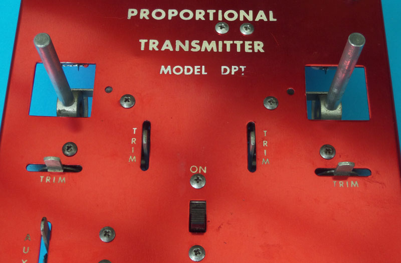

this pic (found online) shows the actual aftermarket sticks which were available for the set:
