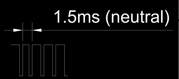

I flashed the Nano, there are a number of places where the sync pulse needs to be edited to get it working.
I have a funny here,the width of the pulse is not from the rise to the fall but from a rise to the corresponding rise. Maybe the Flysky TX modules need the signal like that but it seems odd to me. I would think that the width of each pulse should be the corresponding pulse width. I've attached a sketch to show this, I could grab the wave form off the scope but it's a bit tedious.
My rates/expo are screwed all the way down and I have calibrated the sticks.
Am I just dum?
Am I just dum?

Re: PCB for Phil's 7 Chan Encoder
I think that's right - the value for a channel is measured between two rising edges (or two falling edges which is usually the same), The pulse width is usually fixed (commonly at 300 microseconds) and conveys no information. Some manufacturers used to vary the width of the pulses too on some of their systems - to transmit additional information - fail safe positions and such.

On the 'analogue', 35MHz and such equipment, isn't the pulse width sent exactly as such to the servo? Isn't the servo expecting a pulse width, rising edge to falling edge of 1-2ms?

You're confusing two separate things:
Actually, more modern receivers don't do that - but that's how the older ones operated, and the concept is still correct.
- the pulses sent to each individual servo, which are indeed pulses nominally 1ms to 2ms wide sent about fifty times per second (so every 20ms).
- the combined pulse position signal, used in buddy box leads, and the signal sent to the RF section. This consists of a train of pulses - a first marker pulse, and then one pulse for each channel. The pulses are all (normally) 300 microseconds wide, and it is the time delay between each pulse and the next that represents the channel value - again 1ms to 2ms. The whole frame repeats fifty times per second, so eight channels (nine pulses) can be packed into the 20ms frame while still allowing a longer than 2ms gap between the last pulse and the first pulse of the next frame - this longer gap serves as an 'end of frame' marker. With all 8 channels at their maximum value of 2ms the whole frame of 9 pulses lasts 16.3ms (the point three is due to the 300 microsecond width of the last pulse). This, by the way, is why 8 channels was a common maximum number. If you wanted more channels than that you either need to use different timing than 1 to 2 ms or accept that the whole frame couldn't be transmitted fifty times per second. The first option means that you can't easily use standard servos, and the second one gives a slower less responsive link between transmitter and receiver.
