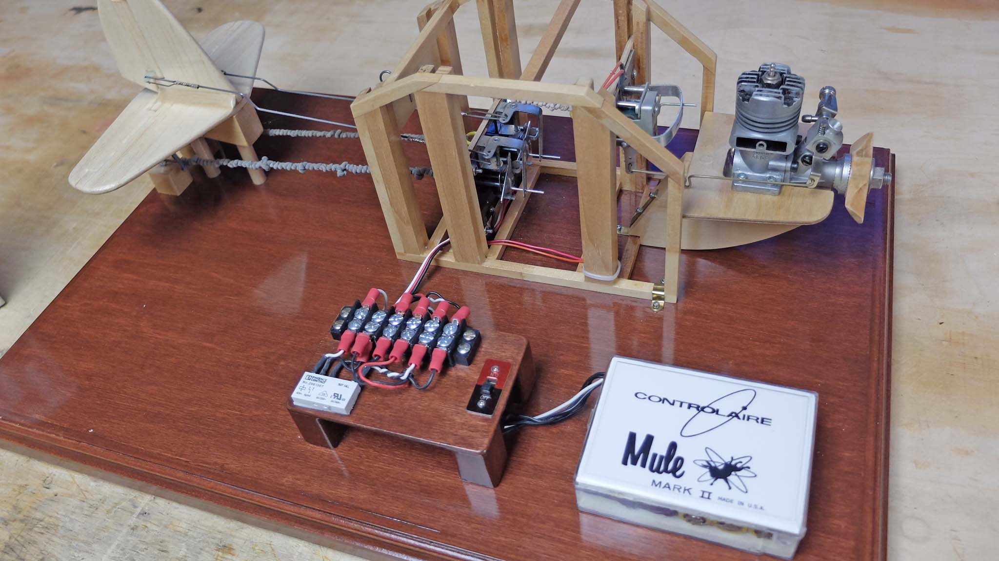

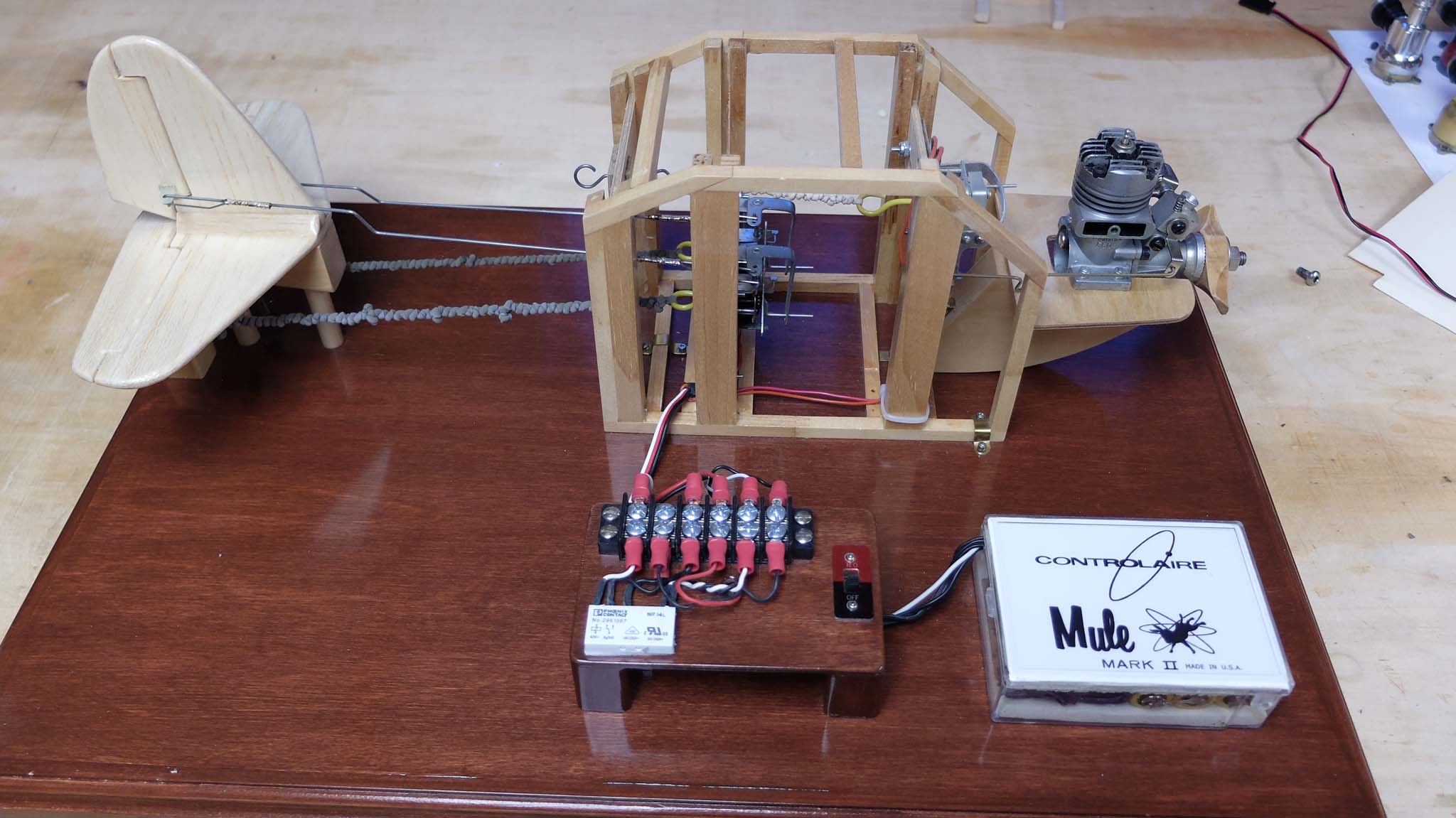

One mans demo rig...... for what its worth.
I made up the demo rig in the photos around 10 years ago so I could play with my old single channel stuff again and also present at various club meetings & events as a show n tell & to introduce those who had never seen a single channel radio set before a look at how far we have come in our hobby.
The transmitter for the demo unit is a Controlaire Mule MKII on the original 27mc.
Also attached is a copy of the brief introduction and description of the system which accompanies the demo stand.

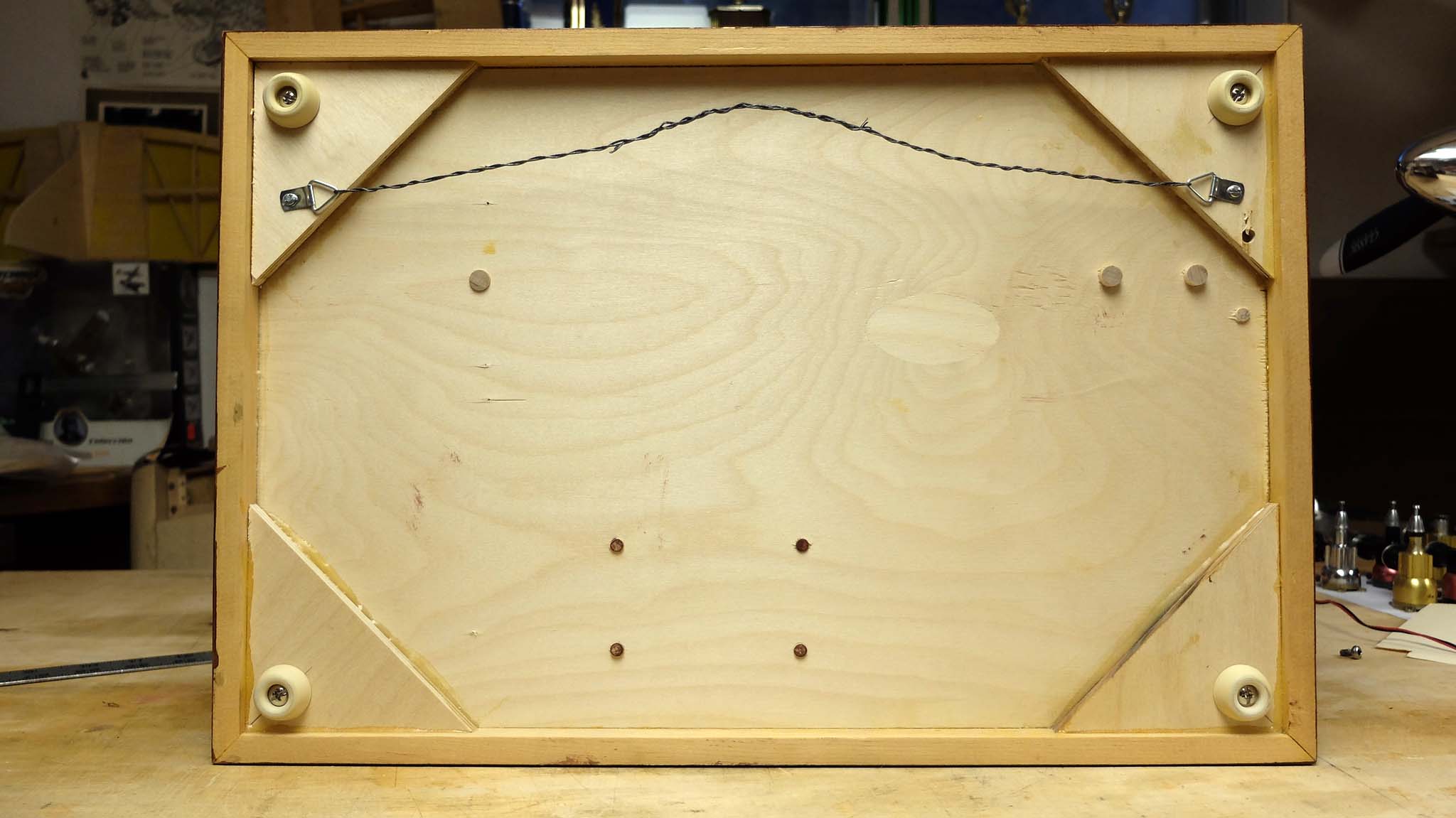

The base is made of 3/8" plywood approx. 12" X 18" with a pine facing around the edges to make it look pretty! When not out on tour it hangs on the wall.
The "aircraft" portion is made from some scrap pine sawn into 1/4" square glued in to the shape of a fuselage. The escapements are mounted on ply plates which slide into slots in the fuselage as was typical on most installations.
The funny hinge line of the rudder and elevator is borrowed from a Phil Kraft idea he used on his .15 powered Bi-Fli. The leading edge of the control surface would project somewhat into the wind upon surface actuation acting like a boost tab to bolster the torque of the wound escapement rubber on faster or more powerful models.
The equipment on my demo is comprised of a Controlaire "5" relayless receiver, an old Aristo "Quad-Trol" escapement, which, with luck gave you right & left rudder (which it does most of the time) and less frequently, up and down elevator on demand. An additional set of wiper contacts on the Quad-Trol would also allow an output to a motor control escapement.
A relay is required on this system to distribute voltage to the multiple escapements.
The motor control escapement is a four pole OS motor control which works surprising well when the Quad- Trol co-operates (which is not often!) This demo uses two packs of 3 AA NiCad batteries. One pack runs the Rx and relay, the second pack is for the escapement coils. The original 56 year old OS miniature relay finally died and was replaced with a 5V dc relay from a commonly available Phoenix Contact "slice relay".
Works well on the demo with 4 to 5VDC.
The fact that it does not always work perfectly, accurately reflects the real world of RC back then!

That's really nice, Mike. I wish I had one like that to hang on my wall!

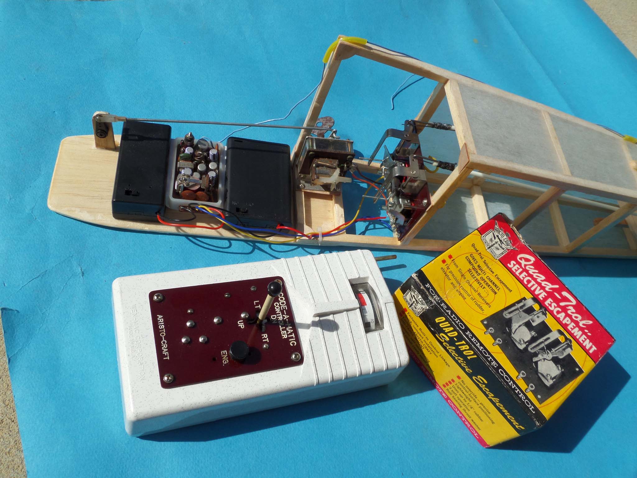

I like the clockwork motor control. I have never actually seen one.
Always wondered about the Code-A-Matic controller. Back in the day you would have felt this was like the real thing with that control stick. I could just imagine wiggling the stick and a little rubber finger pressing furiously on a button in that box!
