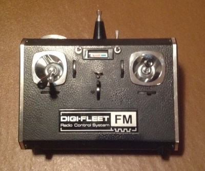

Just got this rather nice Digifleet Custom 3 for use with my vintage models. Unfortunately I don't have the manual for it though and can't find anything on the internet. Can anyone tell me what the various switches do? Secondly, I saw an old advirt from the time that said it was available with either a NiCd pack or PP7 battery. From this I presume the battery pack needed would be 9.6v. Is that right? Thanks.

It looks like the two short levers either side of the meter are rates switches, and reduce the servo movement by 50%. The left switch controls ch 1 or 4 and the right switch ch 2. Mine doesn't have the switch on the top, so not sure what that would be on yours. The instructions do refer to a 2-way switch and a 3-way switch, so it might be one of them. Glancing through I didn't see the voltage specified.

Forgot I also have PRO 7 with extra switches and buttons.
instructions for the Custom III say:
The central lever is ch 5 (flaps)
The 2-way switch to the right of the aerial is ch 6 (retract)
The 3-way switch to the left of the aerial is ch 7 (auxiliary)
"Super models" have a yellow button top left and a white button top right which the instructions say are "roll buttons" - so I assume these are the same on my PRO 7.
There is an additional switch on the top to the right end, can't wee what that's for.

Could it be for a buddy box?Carl wrote: 01 Jan 2019, 23:07 There is an additional switch on the top to the right end, can't wee what that's for.

Many thanks Carl - that all makes sense now. No throttle cut switch then - that could get interesting!
