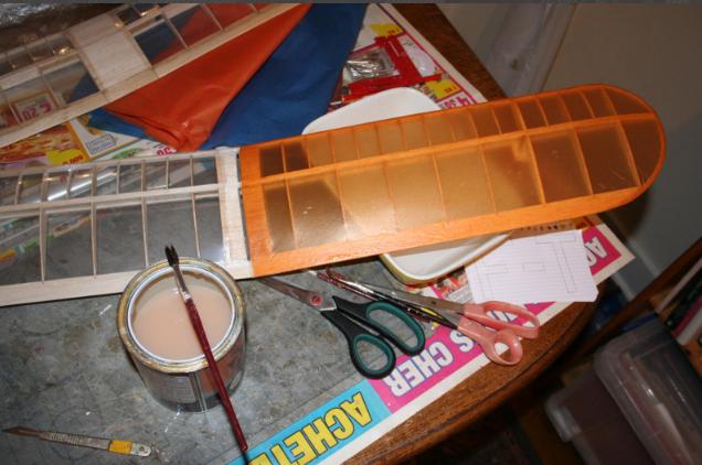

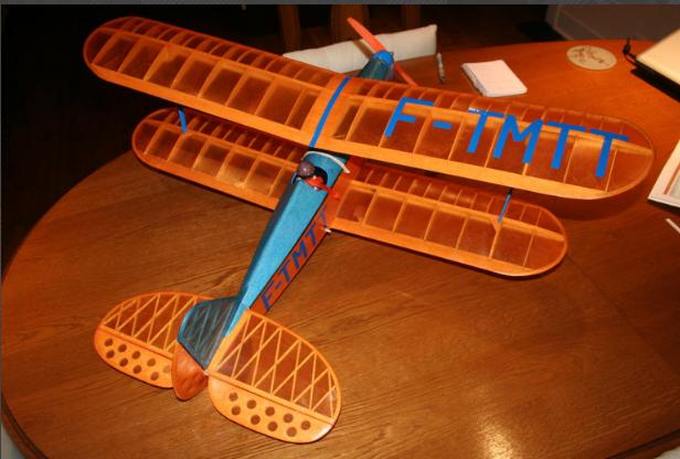

I have a number of models that I used WBPU (floor varnish) on during a period when I couldn't get dope here in rural France, albeit they are tissue over mylar rather then synthetic tissue. I would endorse everything that he Colonel says above, the finished article is OK but I avoid flying the models in damp evening conditions as the slackening off is a pain and doesn't do anything for the structural rigidity or good looks! His other comments about the inability to dope down overlaps etc are also spot on. So, if it is impossible to use dope then WBPU (or, if you are feeling rich, Eezeedope, which as far as I can tell is the same stuff repackaged in little cans and tripled in price!!) can produce an acceptable job, but dope is easier, better and would be my choice if at all possible. BTW I expect that it will air proof the tissue but don't expect any significant shrinkage/tightening. The model shown is the first one I covered using WBPU and is still going strong after 9 years.
