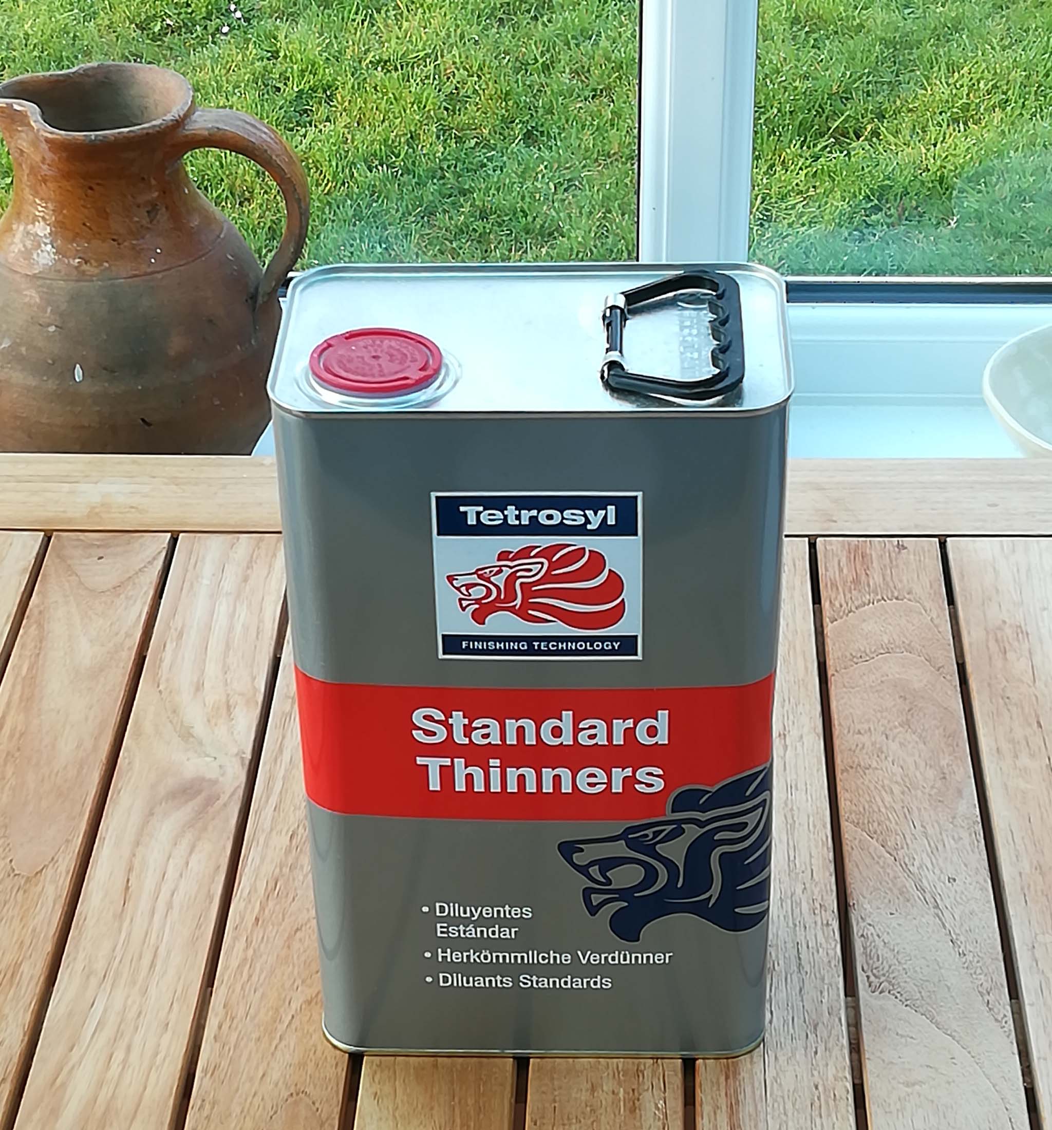

I use quite a lot of thinners for other things and use some of it for thinning clear dope and any other modelling applications. I buy "Standard Thinners" in 5Ltr tins from anywhere that's cheap........
This one was was £18 from a car goodies shop in Ipswich but I think most paint suppliers stock it, usually at around £22 - £25 though if your're lucky you may find it for less.
