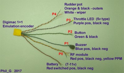

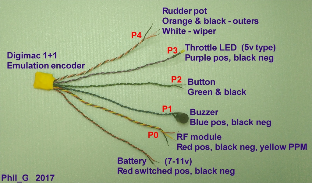

Hi Marc, I would suggest the 1+1 encoder that we use for the single-channel Digimac and the Elf, it has one propo channel for rudder, and an optional button for sequential throttle. Its based on the DigiSpark, so its tiny at 3/4" square, but I do them ready-wired so theres nothing intricate to do, just connect the module, pot, button & switch. The LED and buzzer are both prewired. Have a read of the 1+1 document (P20 on the Archive page of www.singlechannel.co.uk) and see what you think Image
The one-plus-one is a really pleasant way to fly.
