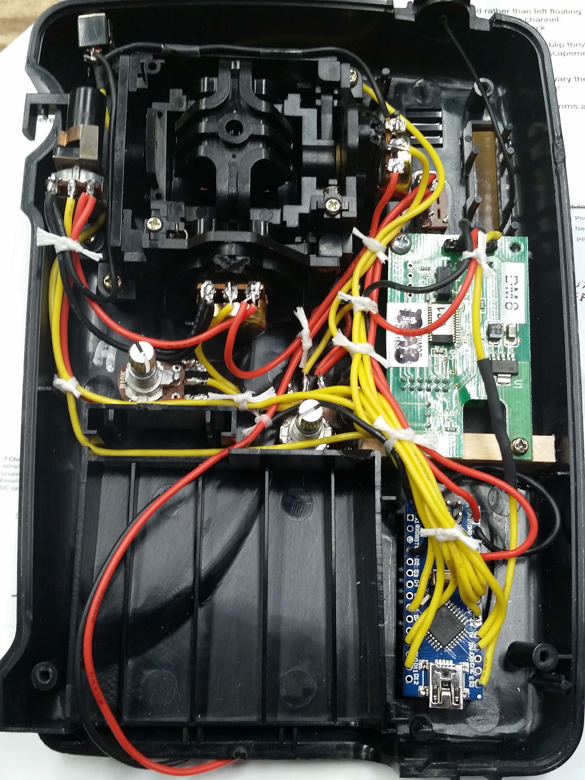

I'm done with the conversion of a 3ch Thunder Tiger radio. All is well. I did change the pulse width to 400us BUT that is all I did. Winter has set in so I can wait a while for Phil to update the sketch for other goodies...
Thanks to all for the help!

Hi Dave, you also need to compensate by taking 100uS off every channel, otherwise your neutrals will be out. Its all caused by Spektrum's non-standard PPM timing, one of the many reasons I'm not a Spektrum fan! When I get a mo I'll separate out the PPM so you can easily set it how you like, but unforch as it stands on the 7ch its not just a case of extending the pulse to 400uS. As you know from your previous project, with the Reeduino you can!

Phil_G wrote: 09 Jul 2019, 15:02 Where "neutralPulse" is defined, and initialized to 1200, just change the 1200 to 1100 Dave
static int ppm = 0, ppmPulse = 300, neutralPulse = 1200;
change to
static int ppm = 0, ppmPulse = 300, neutralPulse = 1100;
Presumably you changed the ppmPulse = 300 statement to 400?
Thanks Phil.
Yes I changed the 300 to 400. That is the only change I made,
