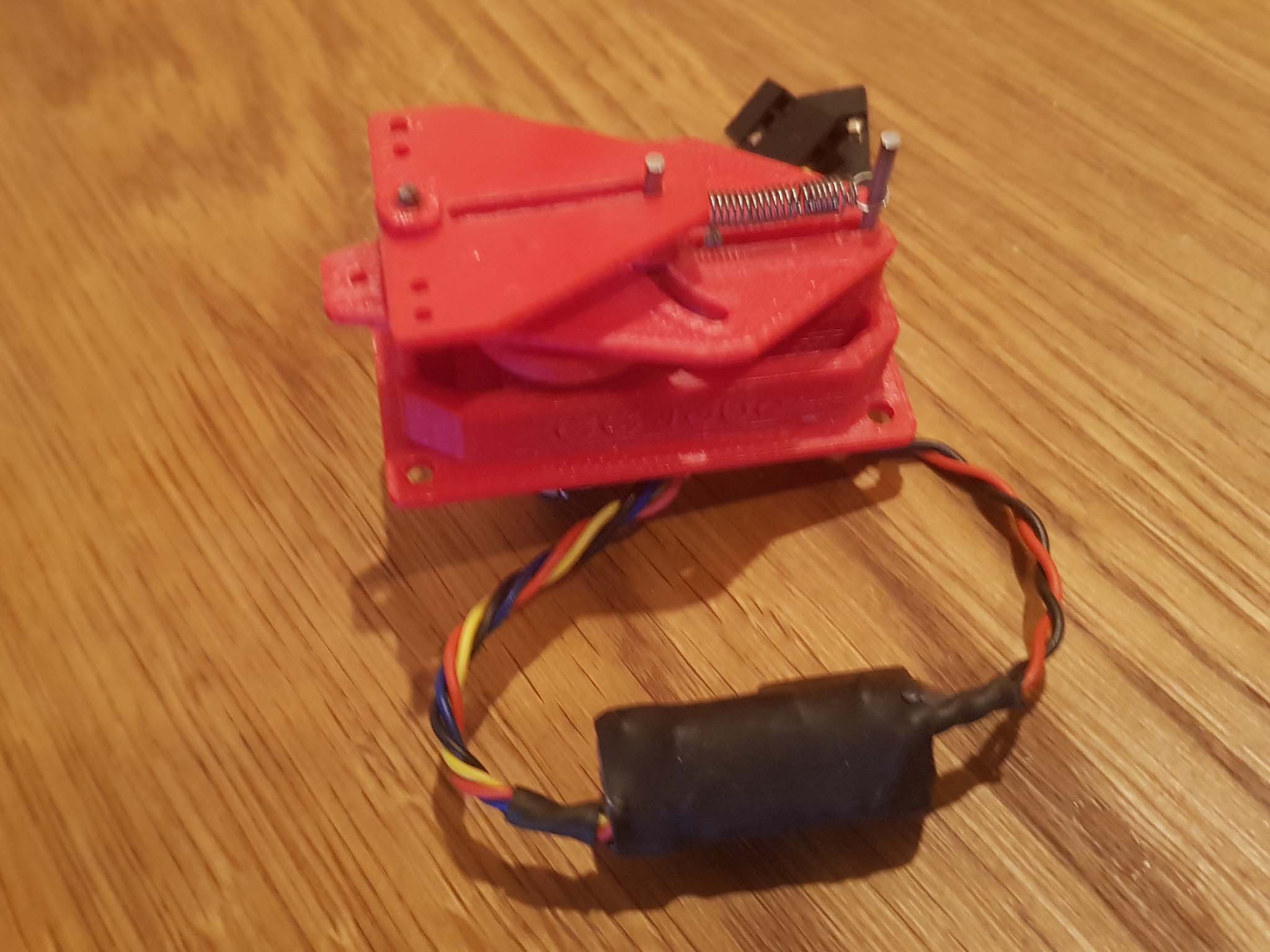

It consists of a "Rand clone" actuator, designed, 3D printed and assembled by Tobe, driven by PIC re-coder electronics which convert conventional rudder & elevator channels into a variable mark/space and rate pulser with a high current FET bridge to drive the actuator. Tobes "Rand clone" is superb and emulates the original in every way other than it has no throttle mechanism - that comes direct from the receiver throttle channel.
Considerable effort goes into these units and they are passed on almost at cost - there is no profit as such, hence if anyone wants to fly GG again after 50+ years, first you need to convince Tobe that yours is a worthy cause and that it will actually be used - in fact a GG flight video should be the 'final installment' of his fee :D

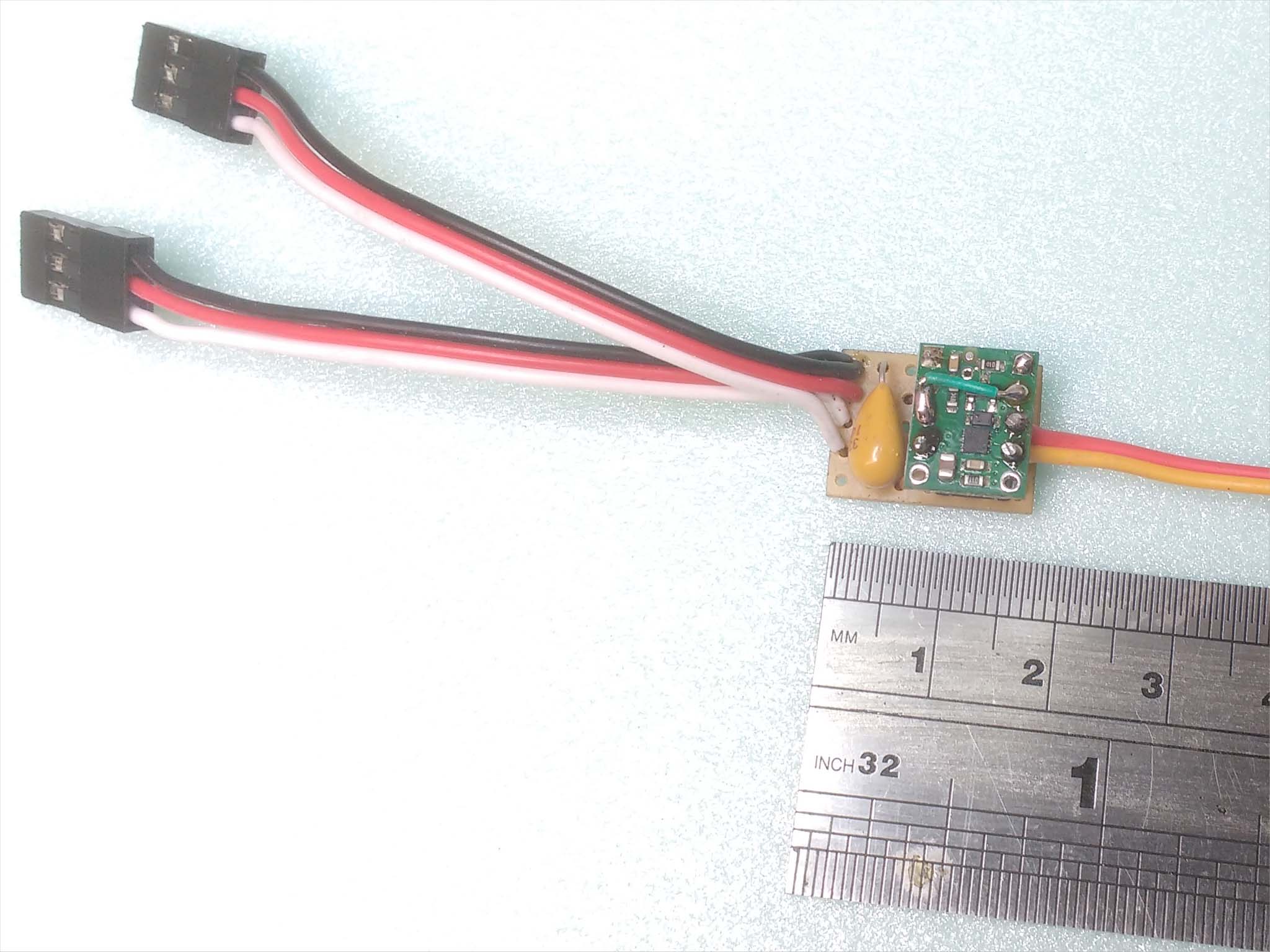

For those who wish to DIY, maybe with an original Rand, a bare Tobe-GG or a Mighty-Midget/birdcage arrangement (as perfected for the second time in history by a member of the Lovegrove family!) then here is a vero recoder layout, actually two, a flat, easy one and a piggy-backed compact one thats a bit harder to make.
Tobes version which he supplies with the plug-&-play version is even smaller, barely larger than the PIC chip, and is neatly integrated into the actuator moulding. Whilst Tobe's P&P actuators are complete and ready to fly, the recoder PIC chip itself is available for DIY fans, email me, and the DRV8838 bridge comes from Technobots or Hobbytronics in the UK. US members try Mouser, Digikey or Pololu.

.... and the Tobe GG actuator itself:
Please note that when the piggy-back layout was devised, I had to slightly change the PIC pin assignments used in the original 'flat vero' layout, so although software 'b' and 'c' are identical in function, the PIC pinout is different. Having two versions is a pain, so I've changed the 'flat' layout so both 'flat' and 'piggyback' layouts use the same pinouts and therefore the same software version. Bear this in mind if you're comparing last-years 'flat' layout with the 'new' diagram:
Revised Apr 2018 for common software 'c'
Here's the preferred 'piggyback' layout. Both function the same - whilst the 'flat' layout is easier to make, the piggyback layout is much smaller & neater:

The first GG-TOBE from the first batch, March 2016

I should add that I used one of my homemade actuators which employs the 100:1 cheepo Ebay gearbox (like the one in the photo above) mounted on a vertical sub-former so that it is aligned fore and aft. This makes connection to a torque rod easy. The "birdcage" at the back end was also straightforward and the whole set-up is more than adequately powerful. It would comfortably fly a much bigger model.
