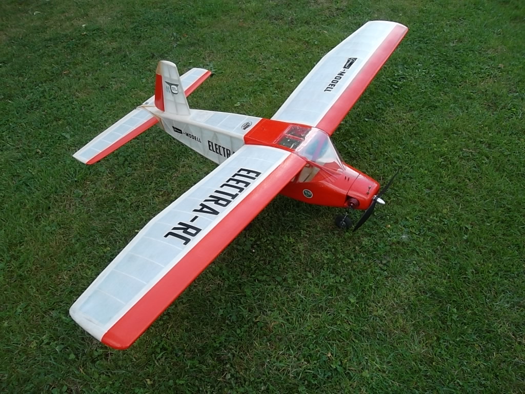

This time it´s not a new replica transmitter but a new model. My latest project build from scratch. It was one of the first R/C kits available here well over 60 years ago.
Can anybody identify it ?
I hope to finish it within the next two weeks. It will be flown on the button as intended and on reeds. Cheers

The Electra is almost ready now. The maiden flight took place prior my holiday. It has now three test flights, but the rudder still needs improvement.

It looks a lovely model Frank but for Rudder control it doesn't appear to have much dihedral. If the rudder needs "improvement", I think you would get better Rudder response with more dihedral....... Is there any way you could increase the dihedral angle, perhaps by making slightly longer wing struts?

not the rudder response is the problem, but the yaw stability. I am thinking of adding more rudder area.
Also I noticed a slight warp in one of the wings, which I need to eliminate, which I will do first. The next flights, hopefully with less wind, will show.

This morning I did several test flights.
First I removed the warp out of the wing. Not much improvement.
Second I increased the dihedral. This makes it even worse. Very touchy to fly.
Third I increase the rudder area by about 50% and decreased the throw by 40%. Much improvement.
Fourth I removed the excess diheadral again to the inital value. Again more improvement.
Now the Electra is a nice model to fly and cruises lovely around.
The original fin has a very thick symetrical airfoil, I think a thinner airfoil with an area increased by 30 to 40% and a rudder increased by 40 to 50% with decreased throws would make the deal even better.

Maybe you could add a small under-fin, like a tail skid, to add some extra side area at the rear without deviating too much from the "official" outline. You could use a piece of transparent plastic, so that it's almost invisible.
