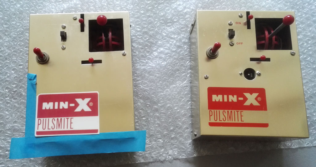

I've got two Min-X Pulsmite sets, one's immaculate, the other missing its graphics and not quite so neat and tidy. As the one without the graphics has a badly corroded PCB and can't easily be repaired, I've decided to convert that. The first problem is copying the graphics. A quick Photoshop of a photo of the "good one" has the graphics sorted. I'll use Ron's excellent method and laser print it on clear/transparent vinyl and use a quick spray of polyurethane to stop it getting damaged.

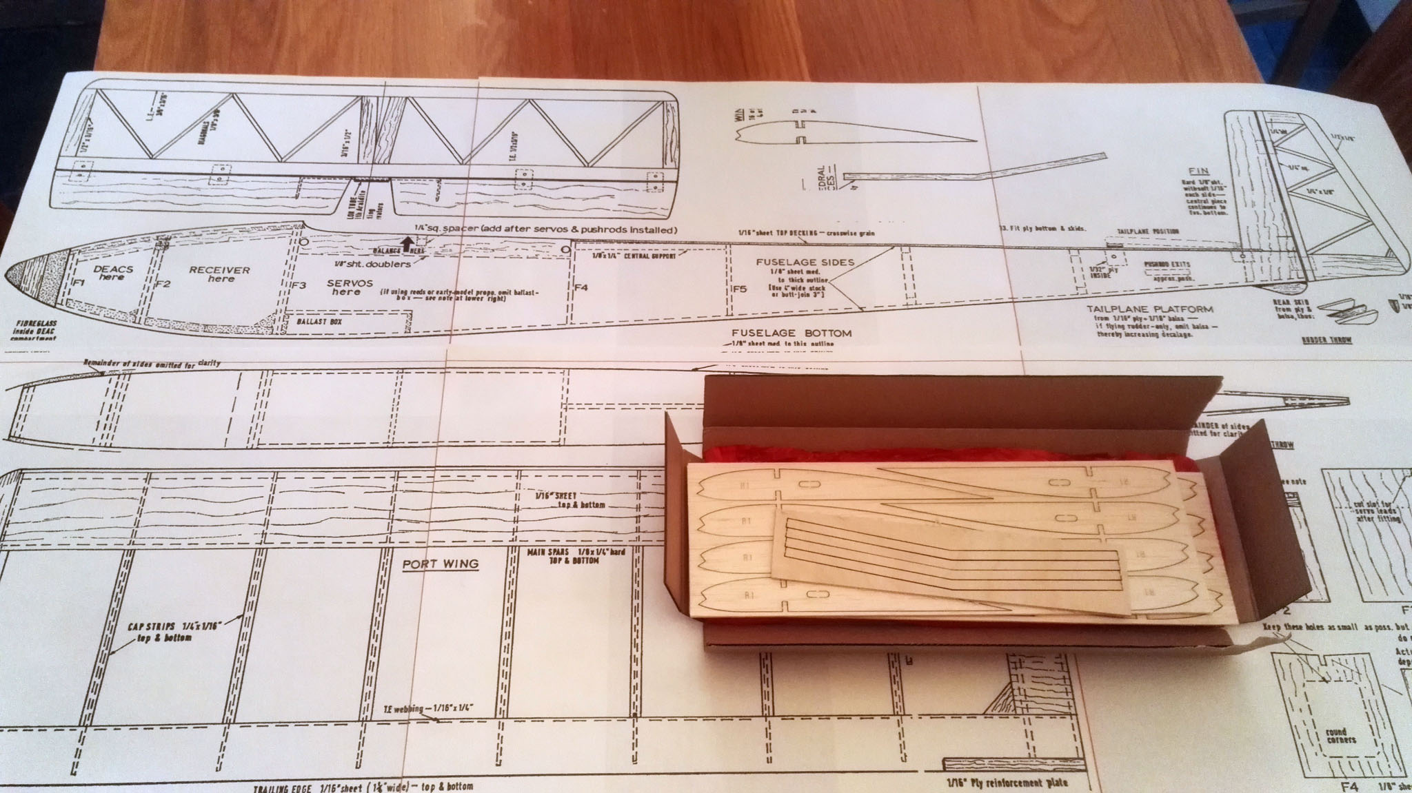

And there is the little matter of building a Soarcer. I've cheated a bit and bought a set of laser cut wing ribs from Neil at iGull and printed a set of drawings from Outerzone. So it looks like I'll be cutting some balsa this evening :P

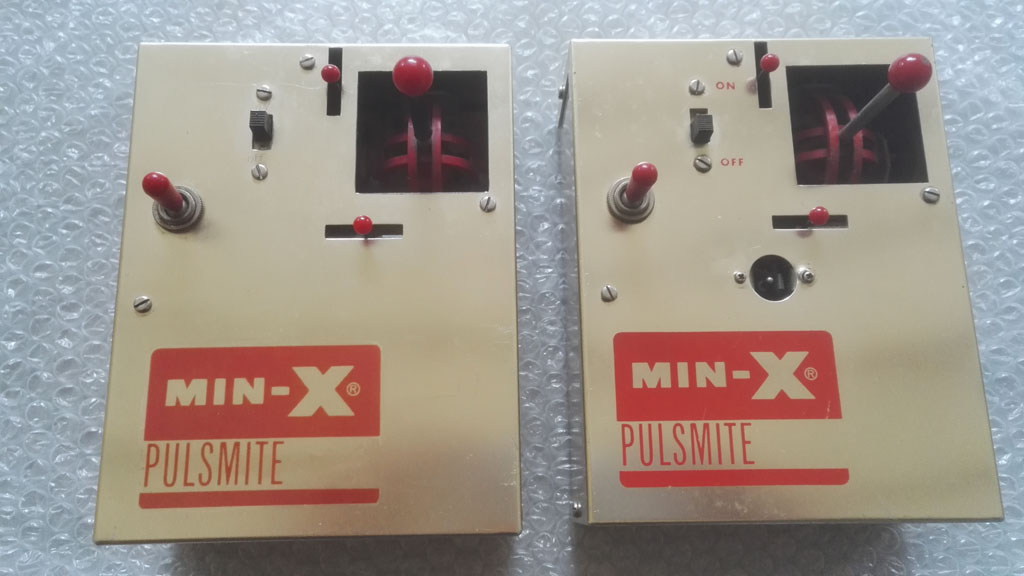

The Min-X Pulsmite transmitter is nearly finished, I just had to be patient for the polyurethane lacquer on the label to dry overnight before fitting it. Thanks again Ron for sharing your label method, I'm really pleased with the result. I've fitted the label slightly right of original so I don't touch it when holding the transmitter how I would normally hold it when flying, the labels are not as durable as the originals.

label still on its backing
label fitted, but still to be smoothed down
finished!
finished!

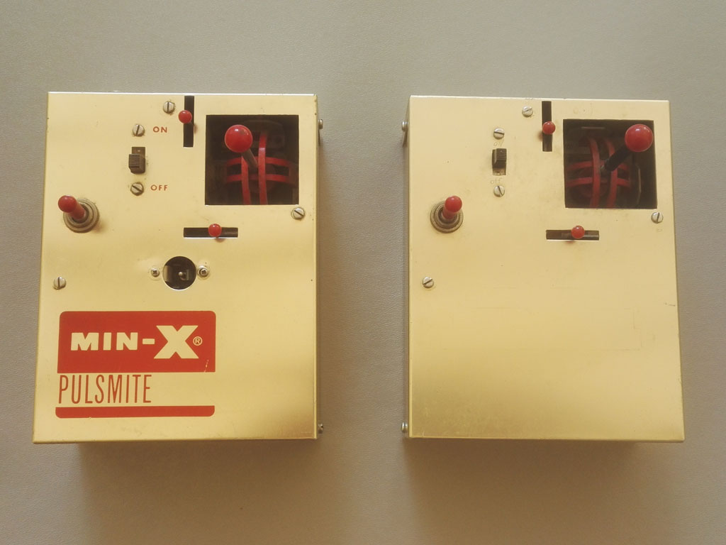

I found this pic of a MIN X - similar but slightly different:

glad the decal system worked out, Looks really good
