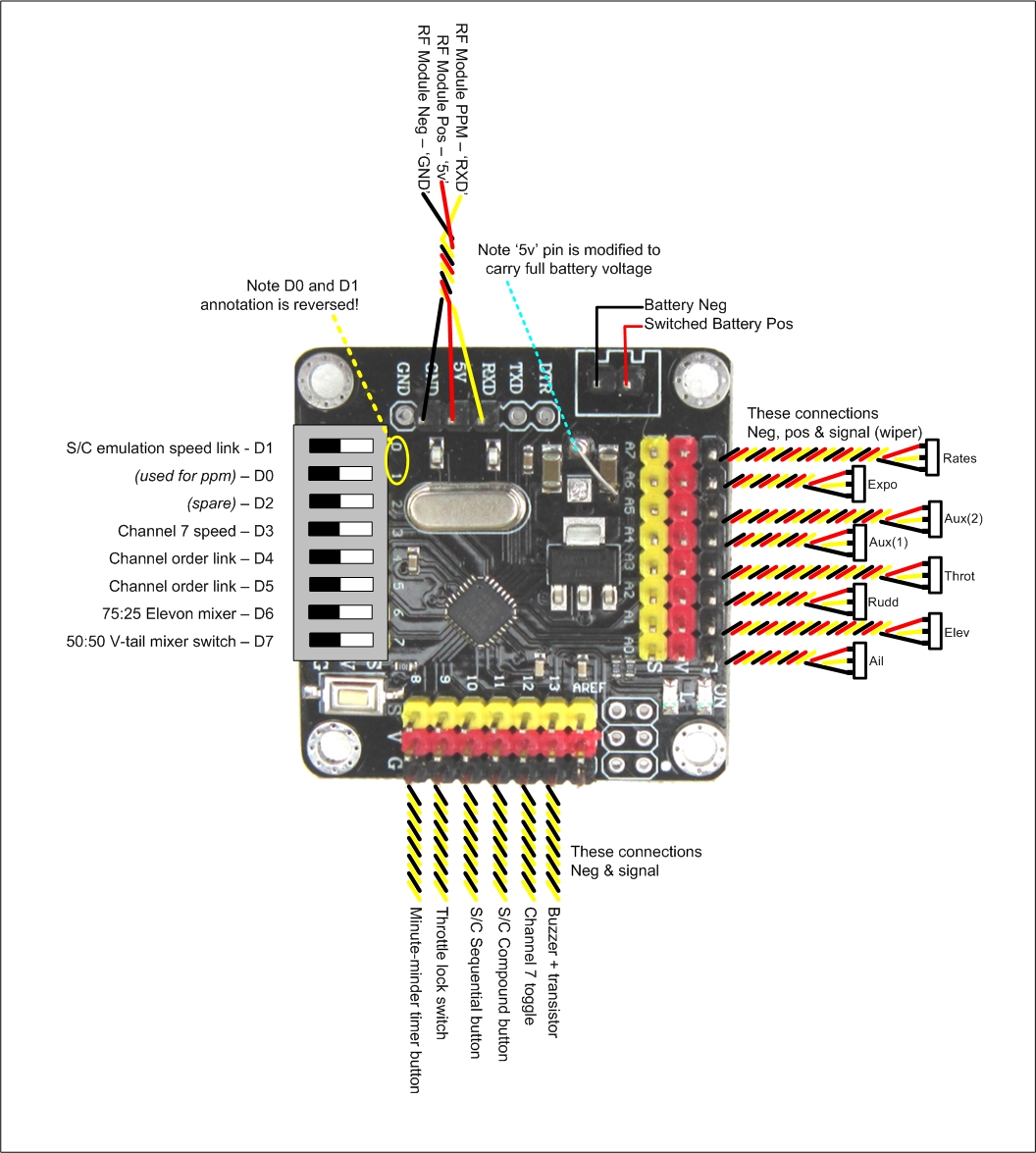

Connections:
Following Mikes suggestion, to accommodate an 8-way dipswitch I've swapped D6 (timer button) and D8 (75:25 mixer) from the previous version. Theres no code change as such, only these two port pins are swapped. Obviously your 'D6/D8' hardware connections have to match the sketch. Any ready-made encoder requests can be supplied with or without the dipswitch but will have the current 'swapped D6 and D8' firmware regardless of whether a dipswitch is actually fitted.
This means that the options in blue such as S/C emulation speed, Ch7 transit speed, channel mapping, and mixers can optionally be selected by flipping a dipswitch rather than by adding & removing links to the header pins:
D1 S/C emulation speed, linked = fast *** remember DIYMore Strong board has D0 and D1 reversed ***
D0 PPM out, position unused, use the RF module header
D2 spare
D3 channel 7 speed, slow or faster (.8 or 3 seconds transit)
D4 channel order with D5...
D5 D4&D5 open = AETR, D4 linked = TAER127, D5 linked = TAER712 (400uS), D4&D5 linked = ETAR
D6 75:25 mixer dipswitch or link
D7 50:50 mixer dipswitch or link
D8 minute-minder button 1 minute per pip
D9 throttle lock switch
D10 S/C sequential button
D11 S/C compound button
D12 Channel 7 toggle switch
D13 buzzer (& haptic if reqd, connect in parallel in 2N3904 emmitter)
A0 Aileron pot
A1 Elevator pot
A2 Rudder pot
A3 Throttle pot
A4 Aux1 channel pot
A5 Aux2 channel pot
A6 Expo switched pot (switch is only tactile, not wired)
A7 Rates switched pot (switch is only tactile, not wired)

I've done a much briefer doc concentrating only on the DIY-More 'Strong' board, of course anyone familiar with Arduino will have no trouble on pretty much any of the popular boards. The mods differ between different boards, so check whats required if you use other than a DIY-More Pro Mini Strong.
As before, if anyone would like an assembled, programmed & tested board, ready-to-go, drop me an email on philg@talk21.com please. Let me know if you prefer header plugs or a dipswitch for option selection. Time permitting, I dont mind doing the odd 'variation on a theme' either.

I've a nice Skyleader Clubman, already Frskyfied and was originally fitted with a 5ch PIC encoder which was fine but basic - so I've re-refitted it with the new 7ch encoder:
As the document shows, a small mod is necessary to the DIY-More Strong" board to provide a convenient RF module header which carries neg, battery pos and PPM.
Bear in mind the dipswitch is optional, you can choose headers or a dipswitch, the code is the same.

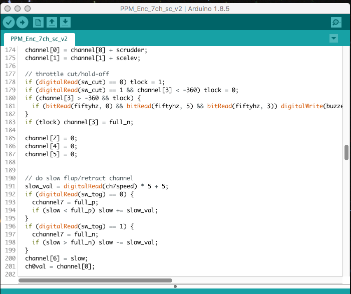

Here is a screen shot of what you would add to Phil's code. And here is a photo of it in action. You can see I pulled plugs from the three unused channels and the PPM analyzer shows them still centered.
Hope this is slightly clearer than mud and helps :)
Scott
