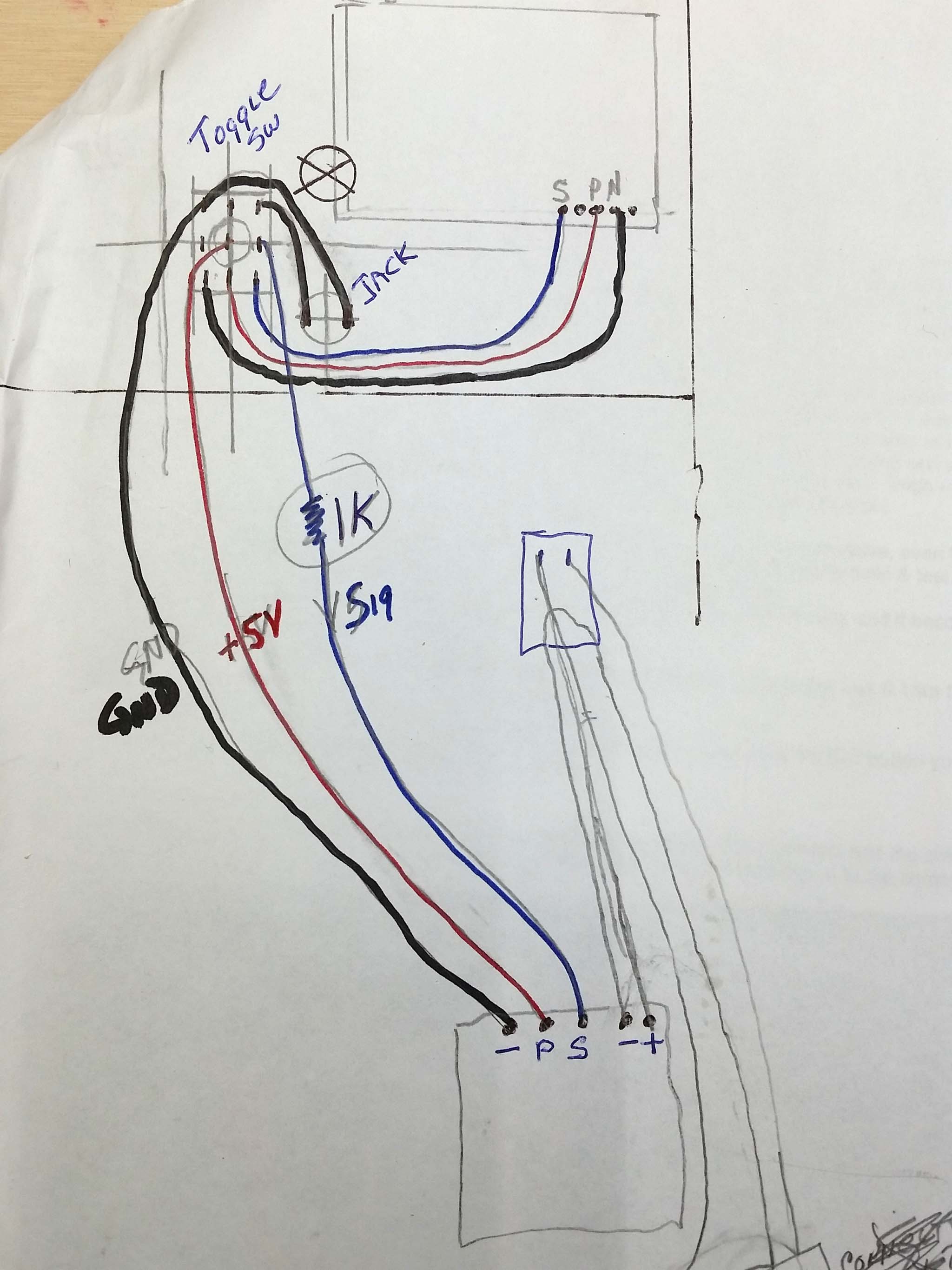

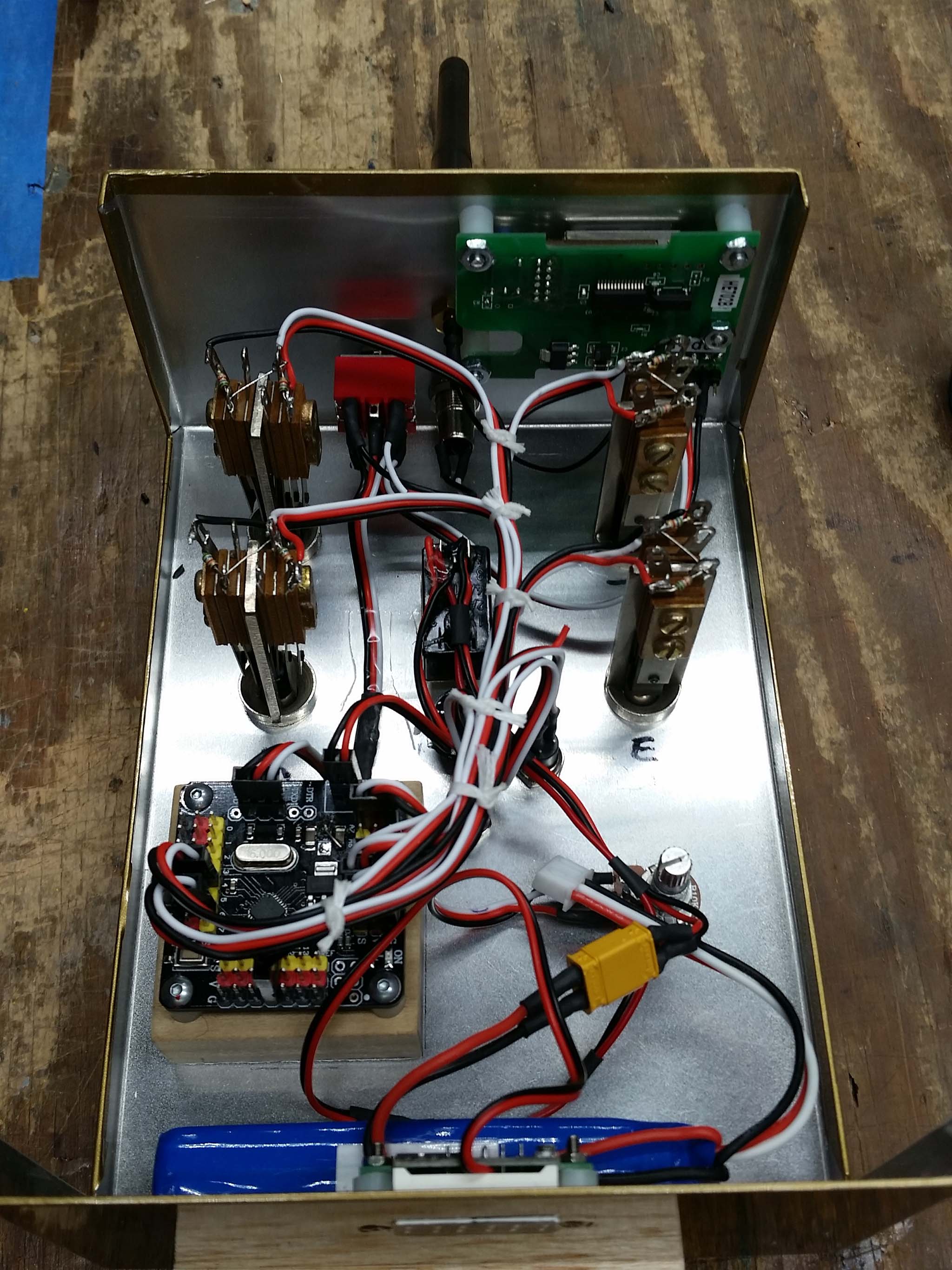

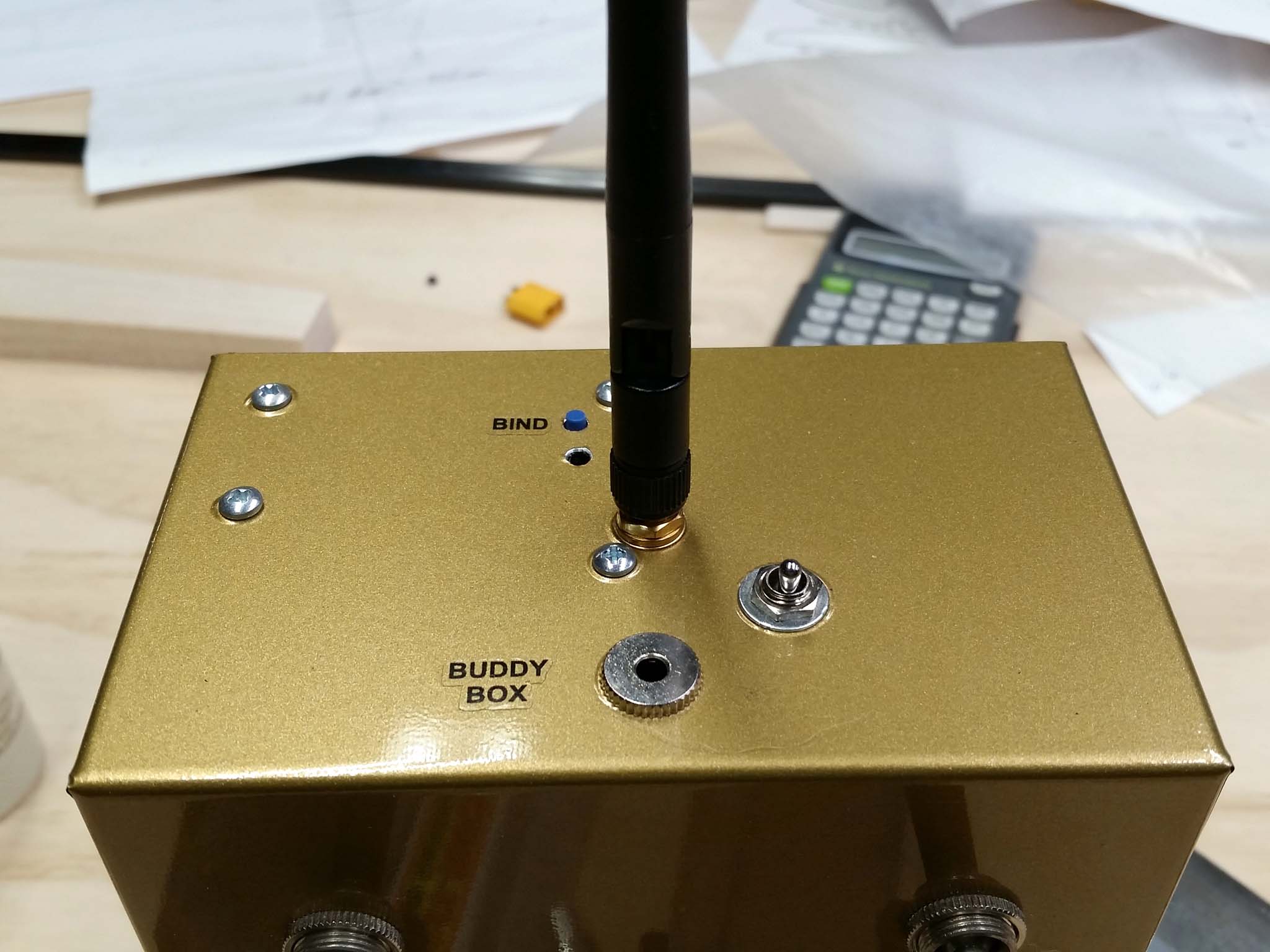

Here's how I made MY reed tx as a standalone "transmitting" unit OR as a slave to a SPEKTRUM tx.
I used a toggle switch wired as shown below. When the toggle is towards the antenna it is in transmitting mode. When toward the buddy box cord jack it is in buddy box or slave mode. Simple.

I had an idea....
Uh-oh, look out guys, he's trying to think again!
OK here goes: On the Reeduino, how about using a jack for the mini phono trainer cord, and connecting the tip to PPM (D0) and the sleeve to ground Bind the plane to the master Tx, plug in the cord to the master Tx and then the master/slave switch will select the reeduino or master, correct?
If I want to save battery power, the reeduino module can be unplugged from the Arduino.
I'm assuming trims will need to be set up for no shift when going from master to slave.
This could be done by flying on master first, set the trims, land, and then set-up the Slave/ Reeduino trims to match.
After writing all this, I see why Phil made his comments!! :)
