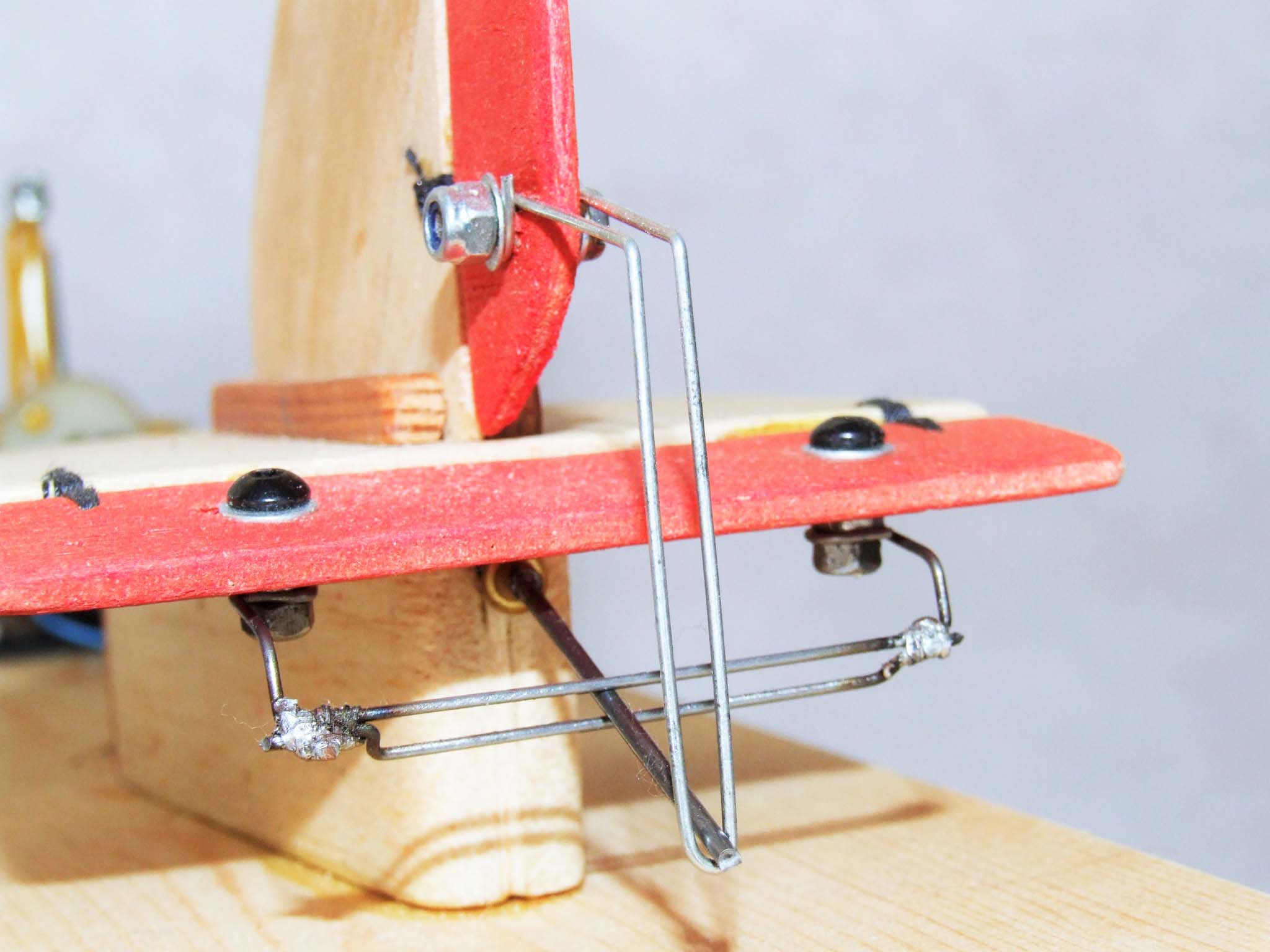

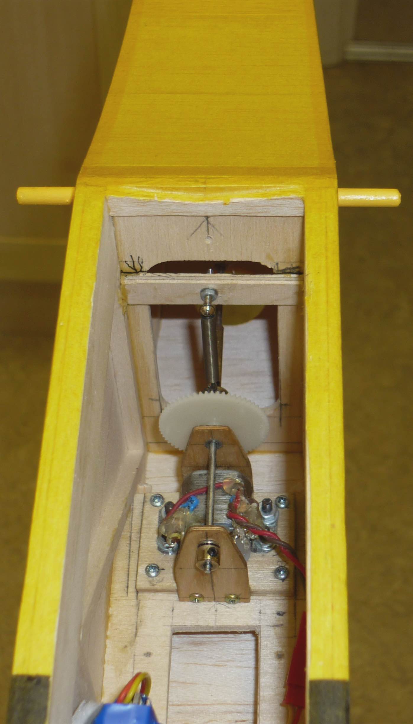

Having been shown the error of my ways, I'm hoping there will now be a couple of images below, depicting the parts needed to make a DIY GG actuator and the finished article, installed in my Mangled Wot Mk. 2.
It's not essential to copy this slavishly: a simpler way of mounting the shaft would be to attach a length of 2mm ID brass tube as a bearing to the top of the motor, packing it as necessary to achieve a "fag-paper" clearance between the pinion and gearwheel. That's a bit crude but it would do the job and save the bother of making the larger frame in which to hang the 2mm ID flanged bearings used in mine and Shaun's actuators. Your choice.
As you'll see, this is a modeller's, rather than an engineer's solution. The pinion is an 8T; the main gear is 60T, giving a ratio of 7.5:1, which is the same as the old Mighty Midget set-up. Pinions may be a little tricky but look at www.kpaero.com. They supply cheap pinions for all their motor/gearboxes. You need the one for the KP01, which may be a 9T, giving a ratio of 6.6:1, which should still be okay. It will be compatible with the 60T.
The motor was sourced from www.hobbytronics.co.uk. Another useful site for gears, shafts, bearings etc., is www.technobotsonline.com. The spring is nice but again, not essential - a simple rubber band will do, but will need to be checked regularly. Aim for as near as possible nil tension at rest; it merely gently assists the gear train to return to centre from the extremes of movement. You need 270 degrees of movement to get the deflections required.
Because this actuator is so powerful, I recommend driving Phil's recoder with a reduced voltage from a spare Rx socket. Have a look at www.uv3r.com/FlightChip/index.html and scroll down to voltage reducers. These are very small and light and wonderfully inexpensive - £1 each or 3 for £2-50. You'll need to modify the recoder (a simple job) but it's worth doing for the extra flexibility it confers.
Any problems, PM me. Should you have difficulties, I have spares of most of the parts and could probably help you out.
David
PS: Apologies - I see I've forgotten to mention the source for the 60T gear - www.technobotsonline.com. The shaft is from the same source but you'd need to buy a pack of them - far more more than you'd ever use - better is to find a scrap of 2mm piano wire. This will be a very tight fit in the bearings and will need reducing with emery cloth or wet'n'dry.

Re: Repost: Making a Mighty Midget-Style Actuator
Here you go.. get bending :D
