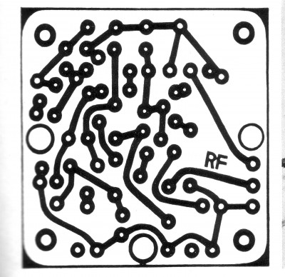

Hi
I'm scaling an image of a PCB for manufacture and the only known detail I have is the 4 board fixing screws.
It mounts on the back of a HB stick unit. Anyone Know the centre distances of these holes?

Here you go Clive . Mounting hole centers (vertical and horizontal) are 1 3/4". I didn't mount mine on the back of the stick unit as shown in the article. As I used and old MacGregor 2 channel single stick case, I just mounted the board to the tx case..
Mine worked fine..

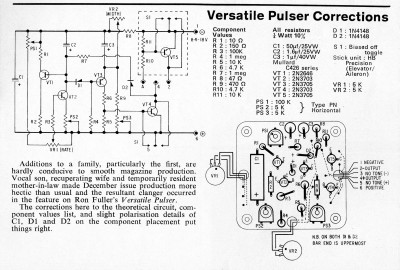

And don't forget they printed some corrections in the Jan RCM&E.

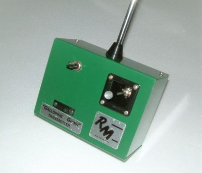

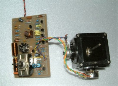

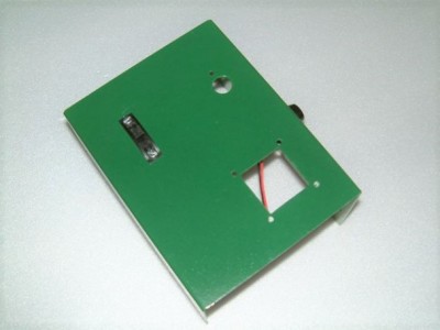

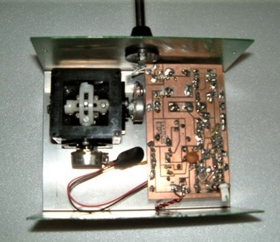

Here's a few pics of the Radio Modeller GG set I built a few years ago.. This one works fine as well..
Case was from Maplins.. good job I bought a few of them ;)
