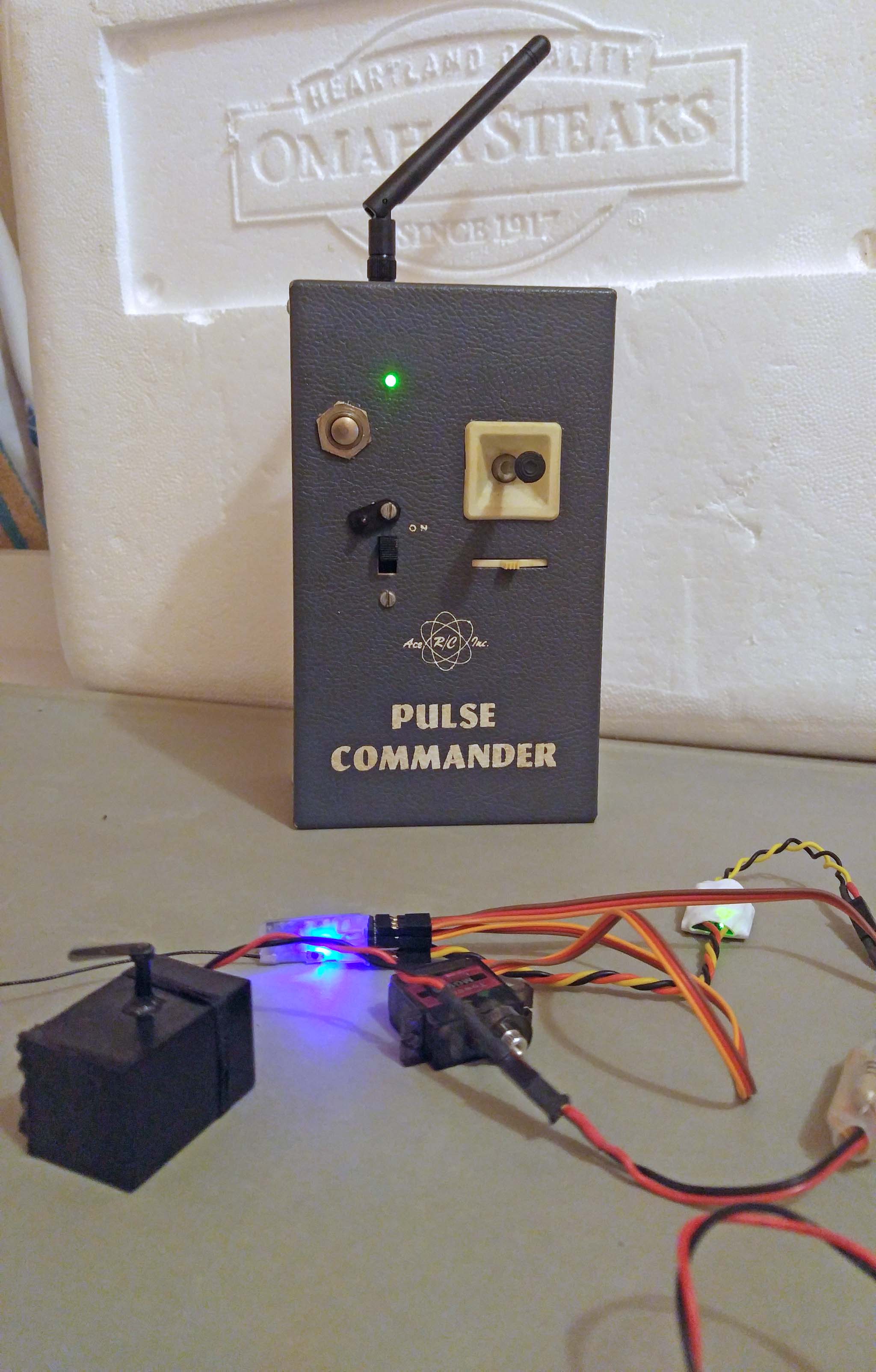

One of the few positives of self isolation is catching up on projects and photo documenting them. Finally put the finishing touches on an Ace single channel r/o transmitter that already had provision for three position throttle. This conversion was pretty straightforward. No need to change out the stick potentiometer and with one of PhilG's Digimac 1+1prewired encoder boards, easy-peasy.

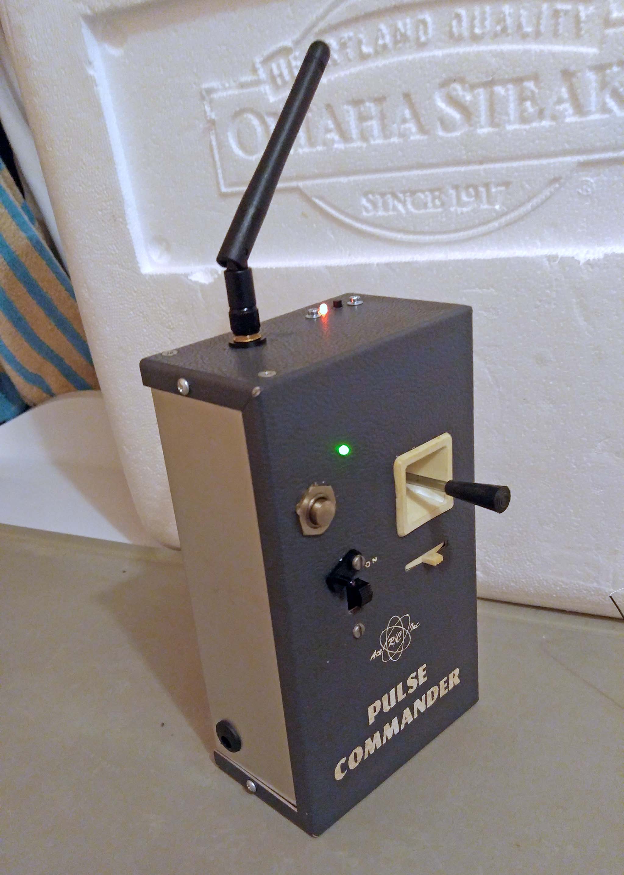

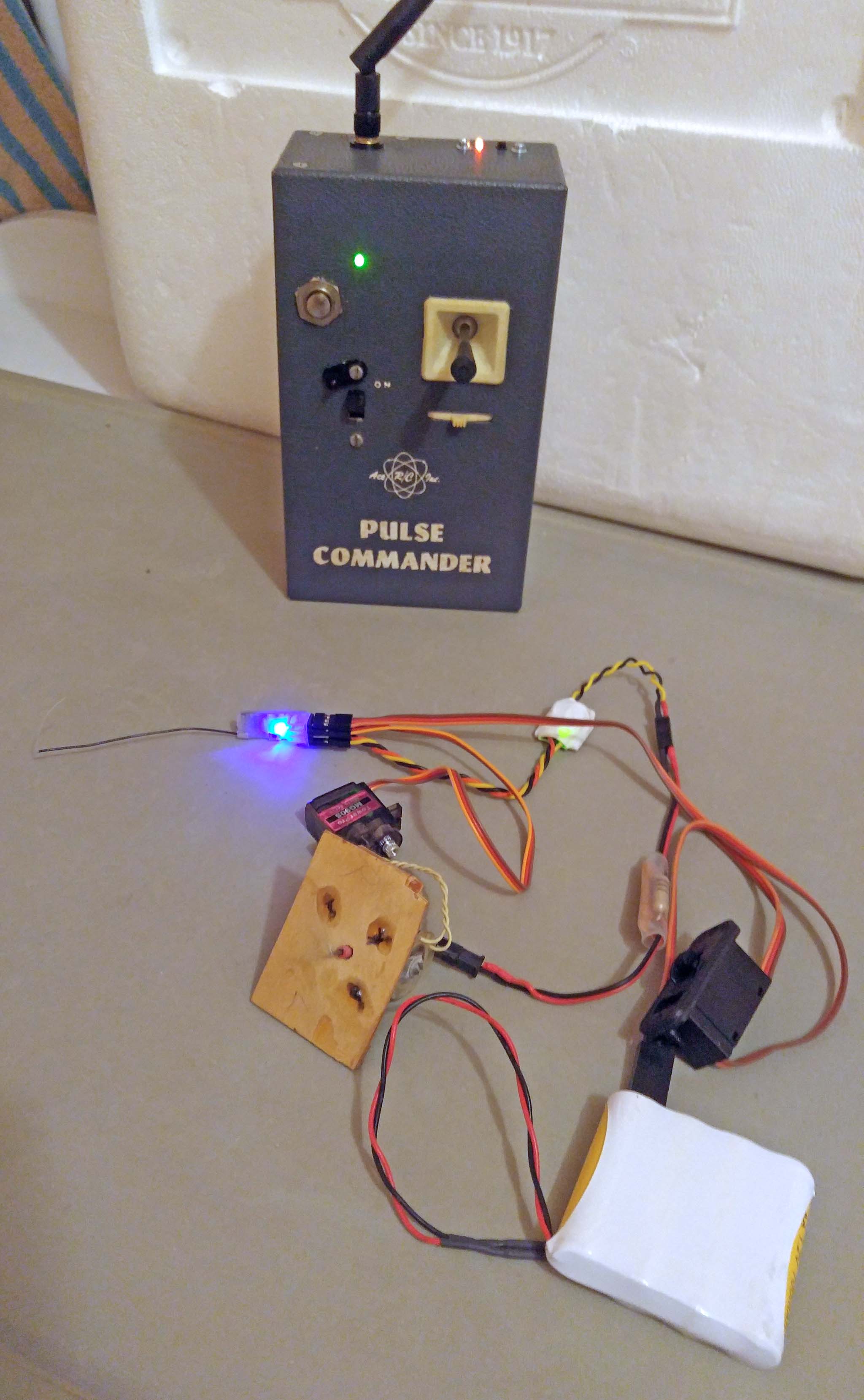

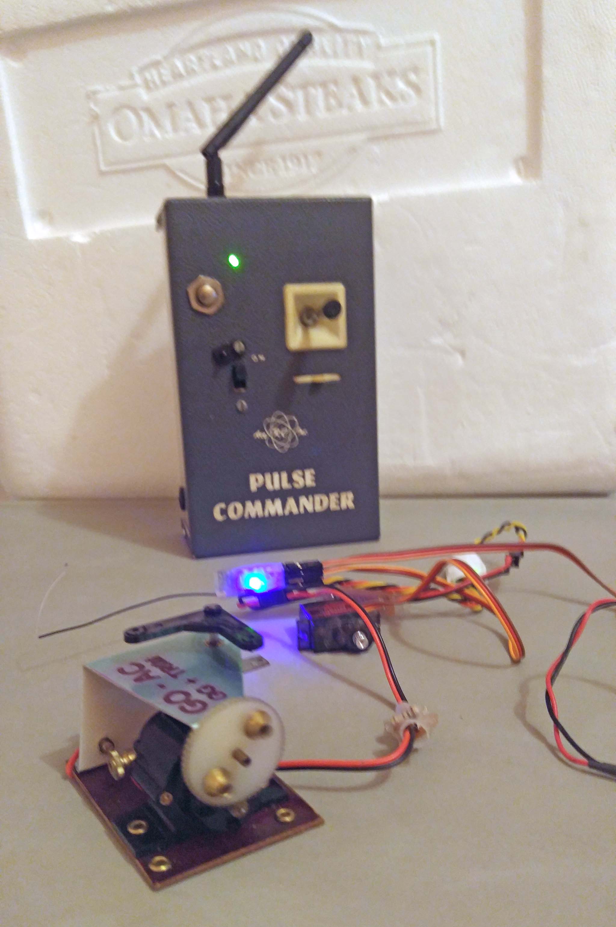

Tested with servo first. All good. Also tried one of Phil's onboard pulses with 100 ohm resistor inline to an Adams actuator. Also works with Southwestern RC actuator and (a nice surprise) an GO-AC GG actuator. A very enjoyable and satisfying project. This one might go into a BMJR Souix. More to follow. Thanks to all those who help make old school radio control fun again!
