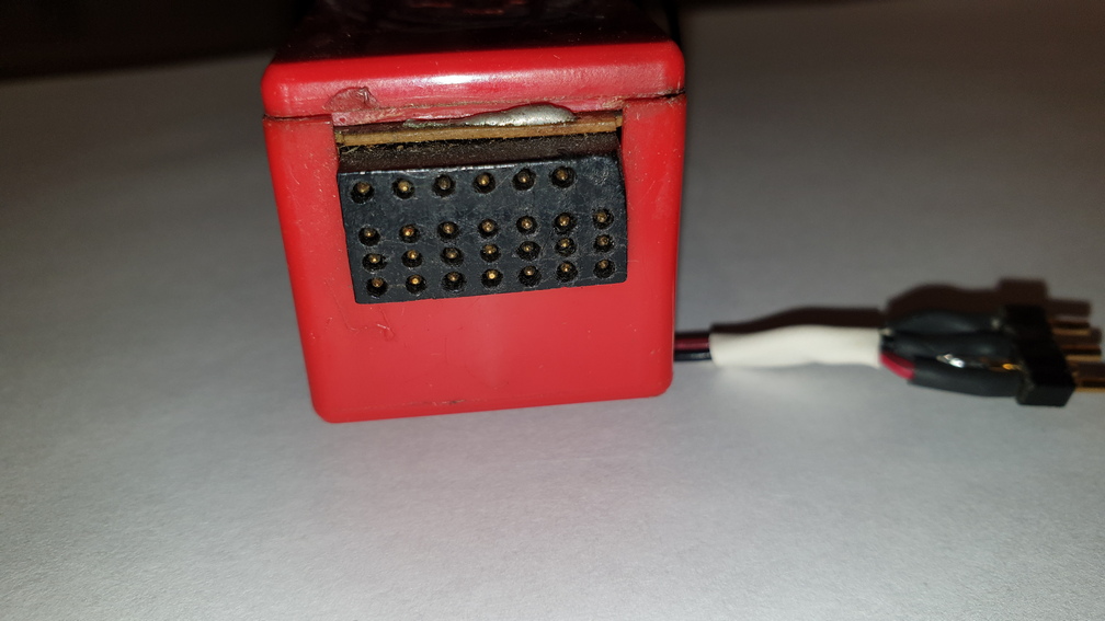

Are the servo plugs for the Staveley digital 27MHz receiver still available somewhere? They seem to be similar to the old Skyleader ones but with a slightly different pitch.

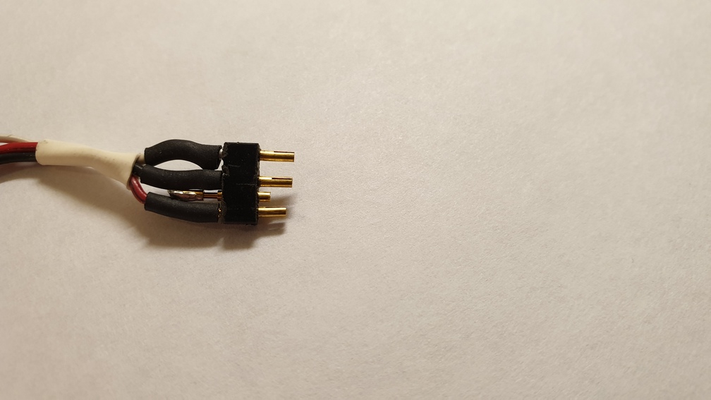

Hi Phil,
2 photos showing receiver socket and plug.
Spacing on the group of 3 is around 1.85mm and 2.9mm for the polarising pin.

Re: Staveley receiver servo plugs
The plug and socket look just like the old Kraft plugs.
John H.
- Posts: 717
I see, I have plenty of Kraft original connectors so PM me with your needs. They are brand new and comes with the leads. Do you need 3 or 4 leads, i.e. with or w/o center tap
Horizon were using the same connectors however the Kraft were crimped to the wire as the Staveley and the Horizon had soldering tabs.
