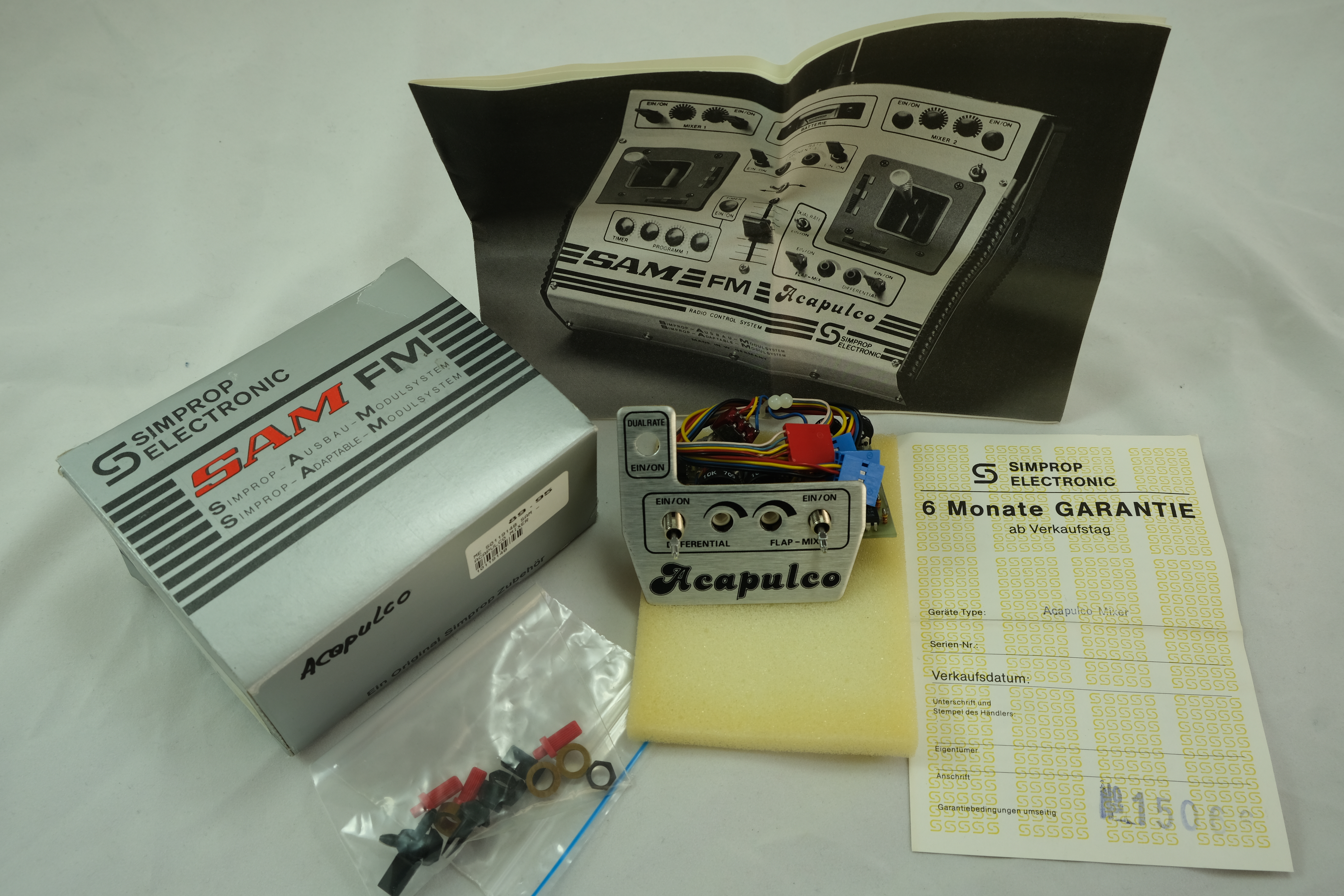

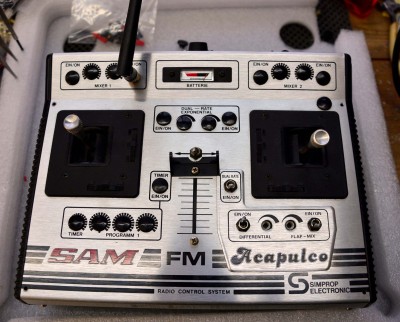

Just to show you how you would build up the operating features of the SAM, here is the Acapulco module introduced to celebrate Hanno Prettner winning the World Champs in guess where?
It added an extra two channels to the Tx (channel 6 , aileron right and channel 7, flap servo)
The module contains:
Delta- V-tail mix
Aileron Dual Rate
Aileron and flap differential
Landing and camber flap adjustment.
It fits into the lower right hand switch bay on the Tx front panel.
It cost around 80 Deutschmarks back in the 80's

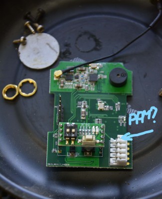

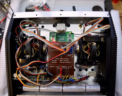

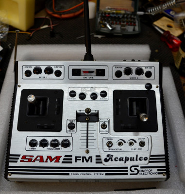

Good progress made today and with FrSKY JR module hacked and wired in. Using existing encoders and mixers on the Tx.
Fitted a new Eneloop battery with a plug connection to separate when not in use.
Wired in a Simprop 3 position switch into channel 1 and the Acapulco module looks after the aileron differential and flap mixing, but sorting that lot out is a job for tomorrow. Will need to look out for a linear slider me thinks to operate the flaps/airbrakes.

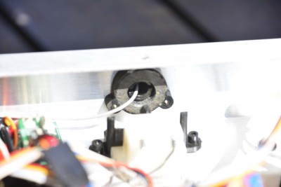

Aerial is in one of the module bays at the moment, but need access to a lathe to bore out the OE moulding to accommodate. But this will be destined for my Prettner Curare when the opportunity arises.
Thanks to Peter Gruchot and Mike K for their help so far!

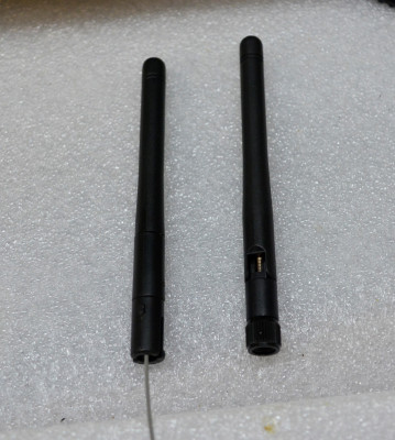

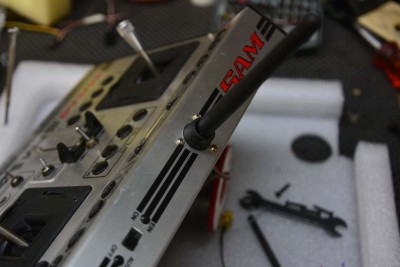

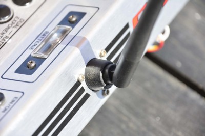

Further inspiration from Paul Jefferies and I managed to get the 2.4 Gig antenna from Spektrum (on left FrSKY on right) located where it is supposed to be today.
