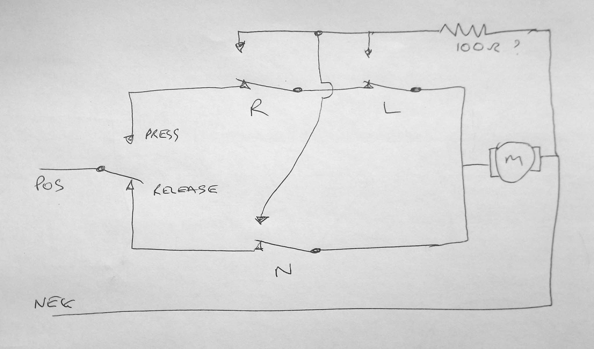

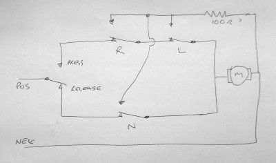

Hi Dodgy
Re the over-run & brake, try wiring all three microswitch 'make' contacts together and through a 47 or 100 ohm to neg. At each stop this will partially short the motor acting as a brake, whilst not presenting a short to the neutralising current:
(microswitch commons must be on the motor side)

Re: Macgregor Codamac
Post by Dodgy Geezer »
It works! Shows you what experience can do, as opposed to my smattering of technical misunderstanding....
If it makes you happy.... here is the actuator running with a 100 resistor - you can see it on the wiring. The motor stops much more abruptly now...
