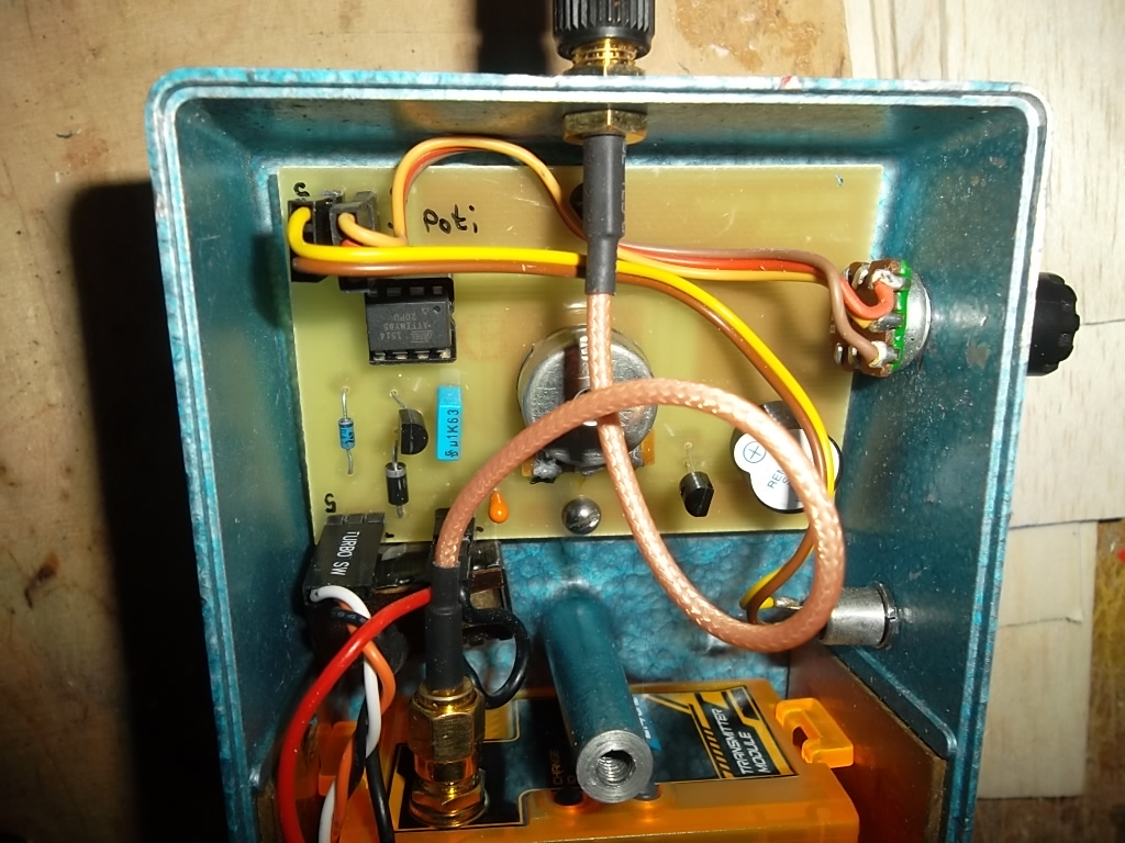

To convert the TX I made a PCB with everything on it but the RF module and the throttle pot. If you can etch a PCB here is the drawing: The PCB fitts exactly into the Tx case in place of the original PCB. It uses an ATtiny 85 as a single chip with additional P5, a 10k poti with 4mm axis for rudder and another separate 10k pot for proportional throttle.
Features:
- Rudder servo reverse
- Inactivity buzzer
- Low voltage alert
- Throttle lock and alert on power-up.
- Provision for an extra switch for another channel or any special feature (GG on a standard servo for expl)
Works really well.
Edit: I added a small picture of the finished and installed PCB that everybody can see how it looks like.

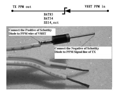

The big diode is just a polarity protection diode. 1N4007 or similar. You can use a jumper wire if you never connect the battery the wrong way. (don´t ask why I always use them)
The BAT43 Schottky diode is an input protection for the module, which can be replaced by a jumper or 1k resistor for most modules. As far as I know only Corona modules require the diode. I use Orange modules and 35MHz modules, they require nothing, just a jumper.

- Posts: 633
Re: Webra Picco and 2.4 GHz conversion with original #1271 actuator.
It is the correct way around Max, the encoder pulls the PPM line 'low' and the modules internal 3v3 pullup provides the 'high'.
This was only necessary for Coronas and the early Frsky V8 modules. Frsky later (crudely) added a schottky in the PPM wire.
Its not necessary for a DHT, Orangerx, Flysky, etc.

For all the interested guys, I added a small picture to the previous post to make clear how the PCP will look like.

Tidy installation Frank! Gives you a good impression of the space inside the Picco case.
Interesting text "TURBO SW" on the module connection.....
