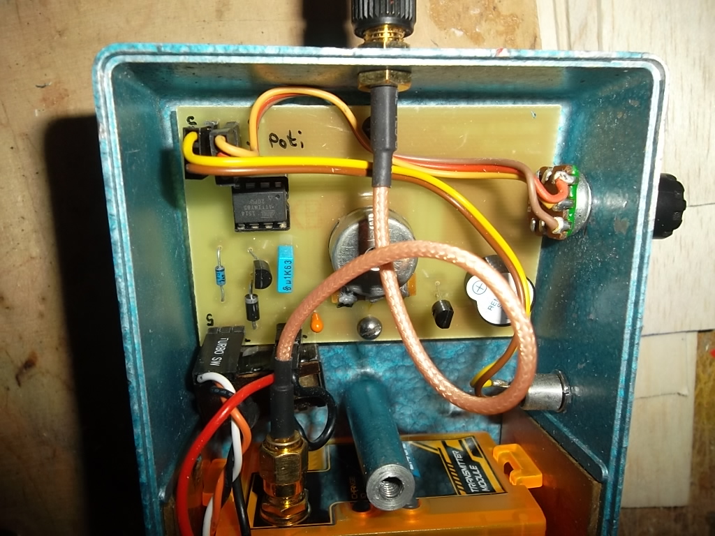

To convert the TX I made a PCB with everything on it but the RF module and the throttle pot. If you can etch a PCB here is the drawing:
WebraPicco.pdf
(1.32 MiB) Downloaded 230 times
The PCB fitts exactly into the Tx case in place of the original PCB.
It uses an ATtiny 85 as a single chip with additional P5, a 10k poti with 4mm axis for rudder and another separate 10k pot for proportional throttle.
Features:
- Rudder servo reverse
- Inactivity buzzer
- Low voltage alert
- Throttle lock and alert on power-up.
- Provision for an extra switch for another channel or any special feature (GG on a standard servo for expl)
Works really well.
Edit: I added a small picture of the finished and installed PCB that everybody can see how it looks like.

I have been studying your PCB layout, and most of it is clear. But I do not quite understand the two diodes, the one without identification, and rather large mounting holes, in between the battery + connection and the input to the voltage regulator.
And the other one, the BAT43, is clearly some sort of protection for the HF module, but is it the right way around? Would it be necessary for my Frsky DHT module?

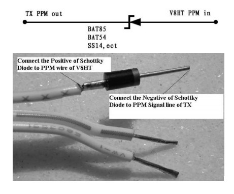

Max.
tiptipflyer
Posts: 406
Joined: 16 Feb 2018, 22:49
Location: Germany
Re: Webra Picco and 2.4 GHz conversion with original #1271 actuator.
Post by tiptipflyer »
The big diode is just a polarity protection diode. 1N4007 or similar. You can use a jumper wire if you never connect the battery the wrong way. (don´t ask why I always use them)
The BAT43 Schottky diode is an input protection for the module, which can be replaced by a jumper or 1k resistor for most modules. As far as I know only Corona modules require the diode. I use Orange modules and 35MHz modules, they require nothing, just a jumper.
The Attiny85 is a plain DIP8 chip only.
The transistor for the buzzer is a BC547 or 2N3904 or similar.

MaxZ wrote: 21 Dec 2020, 14:44... the BAT43, is clearly some sort of protection for the HF module, but is it the right way around?
It is the correct way around Max, the encoder pulls the PPM line 'low' and the modules internal 3v3 pullup provides the 'high'.
This was only necessary for Coronas and the early Frsky V8 modules. Frsky later (crudely) added a schottky in the PPM wire.
Its not necessary for a DHT, Orangerx, Flysky, etc.

Phil_G wrote: 21 Dec 2020, 19:57 Frank I wonder if placing a couple of small neodymium magnets would help give the Webra actuator a bit more torque?
Not sure how it works, maybe near the coil or on the rotor?
Thanks Phil for pointing this up, I will try it out at a later time.
For all the interested guys, I added a small picture to the previous post to make clear how the PCP will look like.

Tidy installation Frank! Gives you a good impression of the space inside the Picco case.
Interesting text "TURBO SW" on the module connection..... :P
