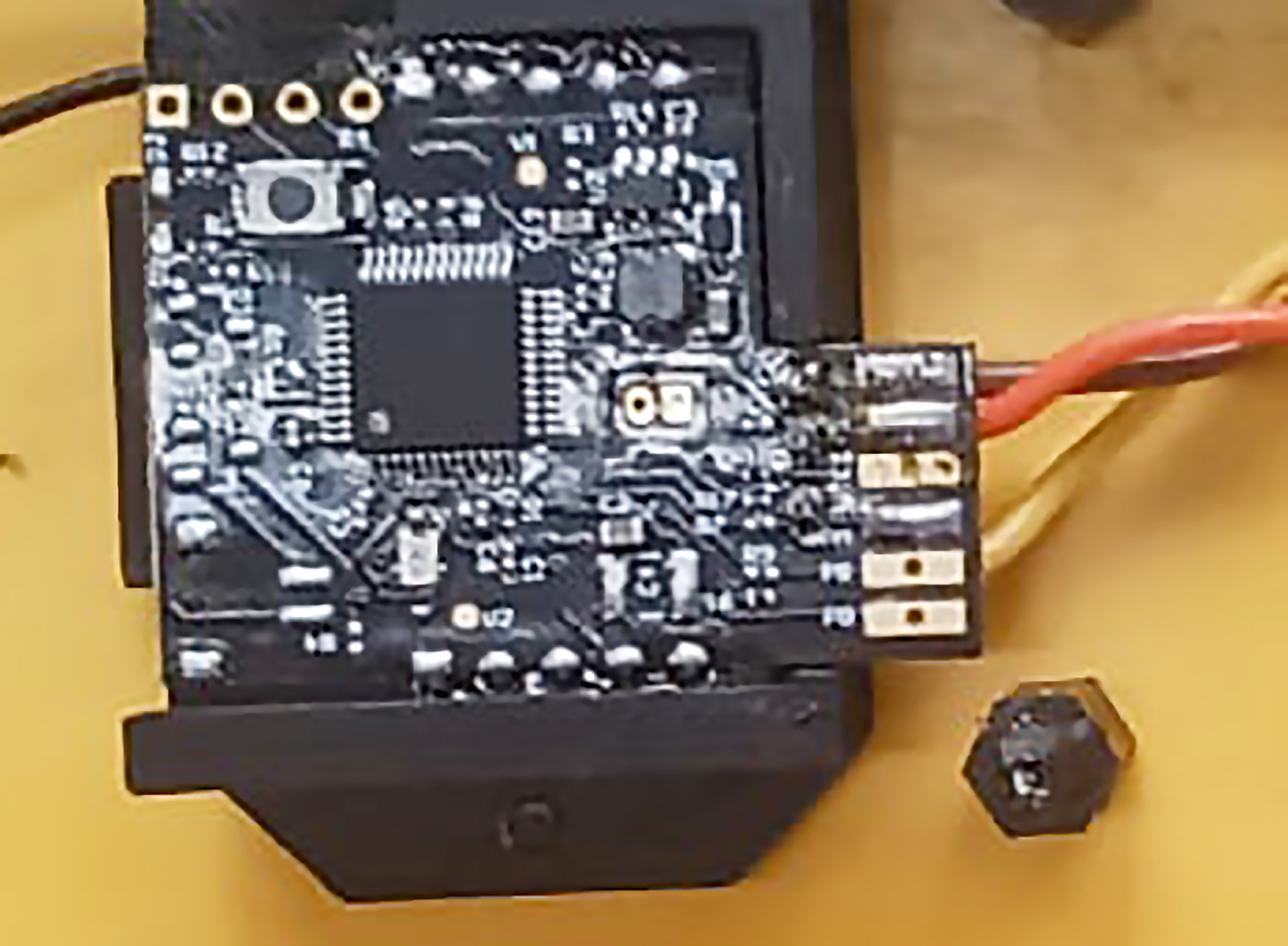

Thanks Stuart -and thanks for the speedy dispatch of the Lemon modules.They are quality. I do wish that they would solder the header on for the PPM in though - that's been the trickiest thing that I've had to do in all of these conversions. A higher level of soldering finesse needed than my previous agricultural soldering "technique".

It's the supplied 3 pin connector Stuart - that was the trickiest job for someone who isn't used to fine electronics soldering - usually I'm just putting 4mm gold connectors on 12awg cable or soldering up piano wire undercarriages. On my first one I soldered the feed from the encoder directly onto the appropriate pads, rather than using the three pin connector. I haven't seen the need for a separate bind button - access to the inside of the Macgregors is so easy with the Dzus fasteners.

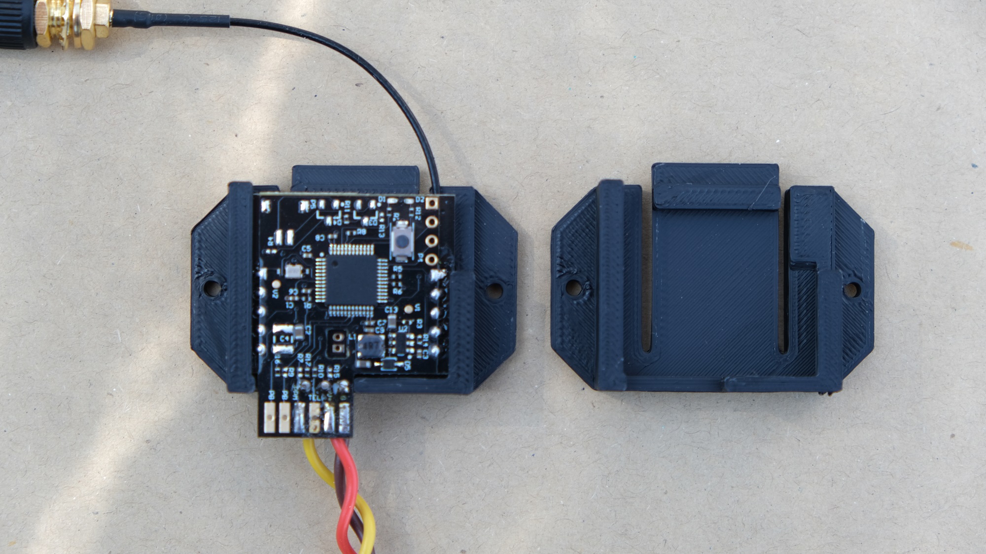

Brian, try fitting a servo plug over the pins and use a wooden clothes peg or similar to hold in place & use this as a jig to hold the header pins in place and use a fine tipped soldering iron and not the high wattage one that you would use on electrical power connectors with resin cored solder. Usually the solder will flow only onto the solder pads on the module board.
I normally hard wire onto the pads (tin the wires before inserting into the holes) and use a plug only at the encoder end.
