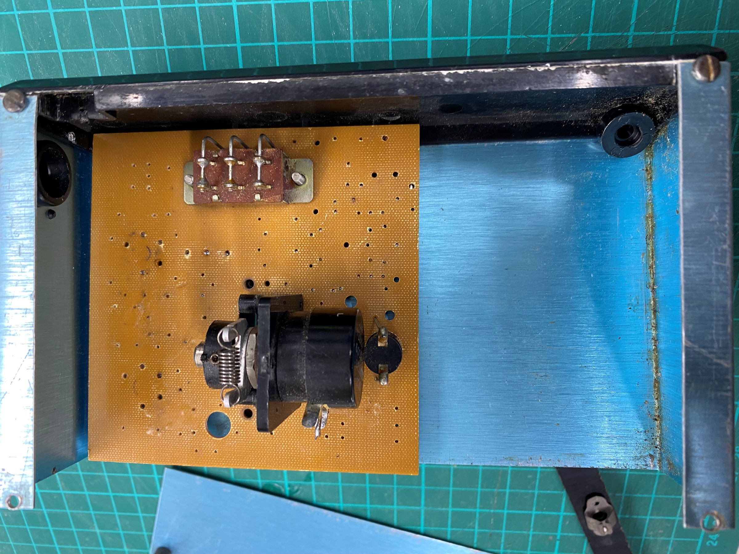

The set is quite well used and Phil had already depopulated the board leaving just the stick unit, on-off switch and single channel button for his own conversion. I could have replaced the latter two items, but they seemed to be in reasonable order, so I thought I'd try them out.

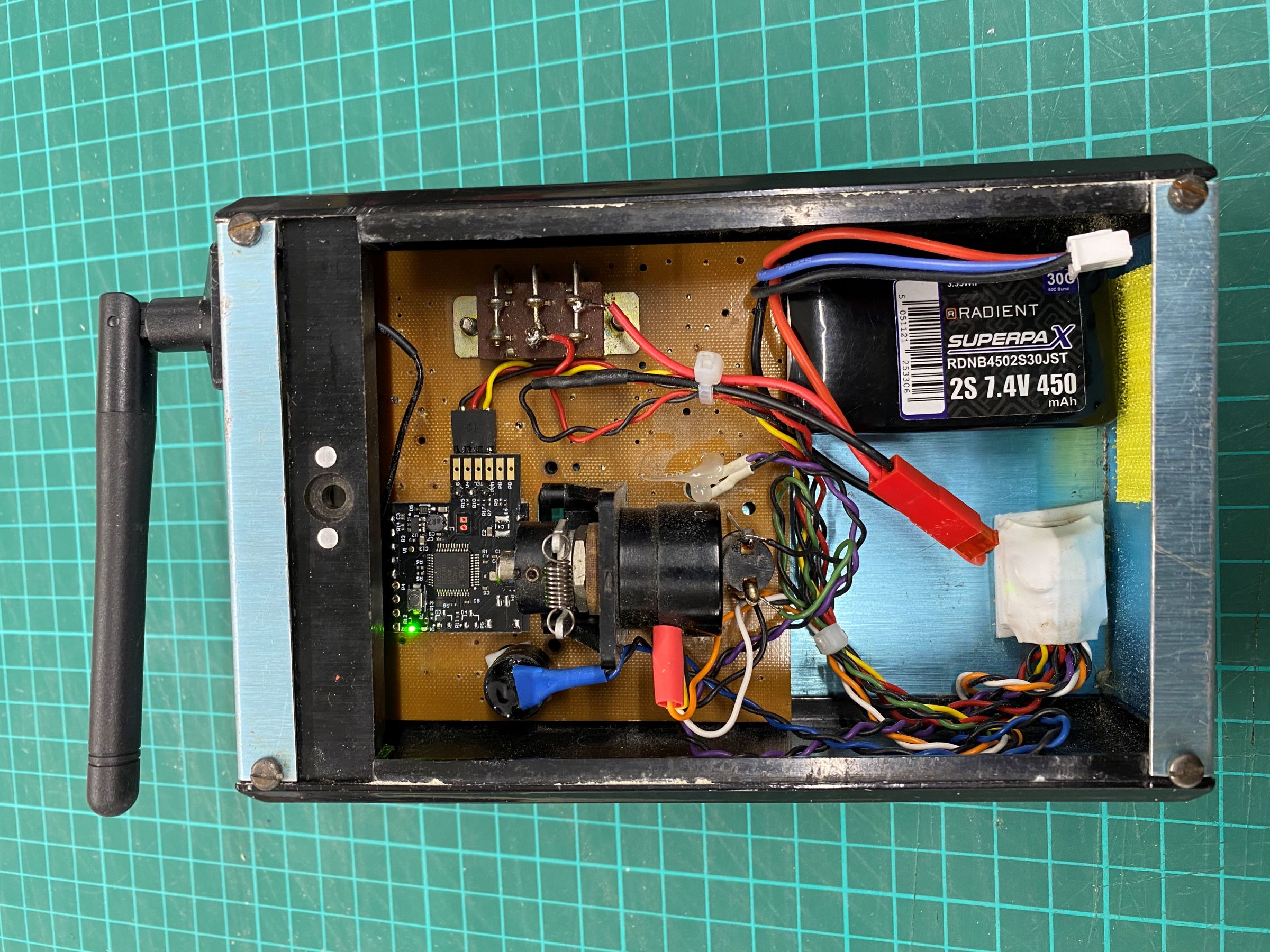

The various components are secured with cable ties, some double sided servo tape and in the case of the throttle setting LED a blob of hot glue. Power is supplied by a 2s1p 450mah Lipo, of which I have quite a few spares.

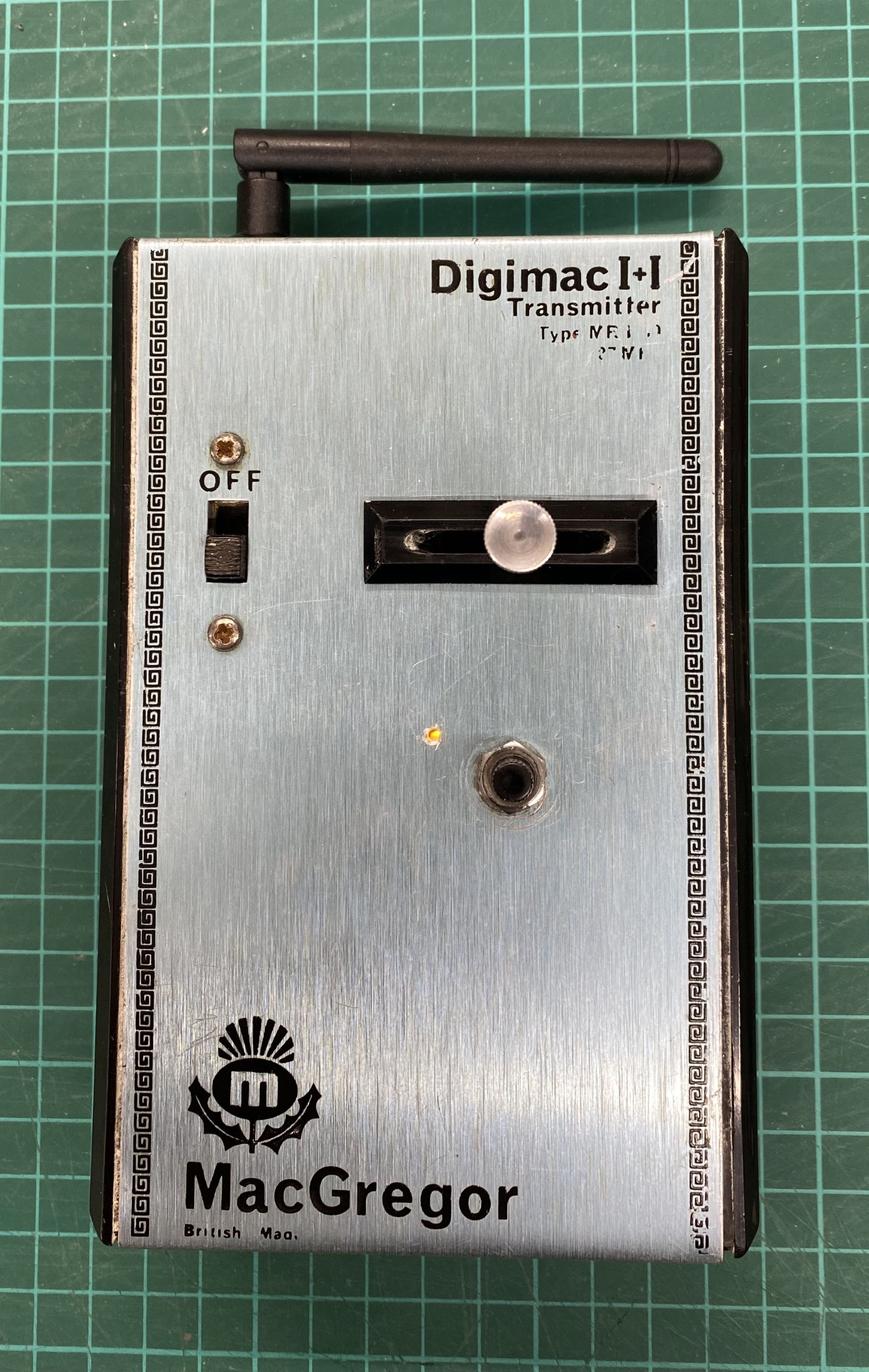

The 1 +1 encoder is encased in heat shrink, all pre-wired with flyleads and just needs crimping a servo plug on the PPM feed to the module, a wee bit of soldering to secure a battery supply via the switch and to tag onto the stick potentiometer. So in short order the Digimac 1+1 was done and bench tested. The biggest part of the job was reaming out the wee plastic housing for the aerial from around 8mm to 10mm, so as to allow passage of the 2.4ghz antenna and drilling a small hole in the face of the transmitter to allow the throttle setting LED to be seen. It's not pristine and exactly as original, but this is a transmitter to be used, rather than sit on the shelf.

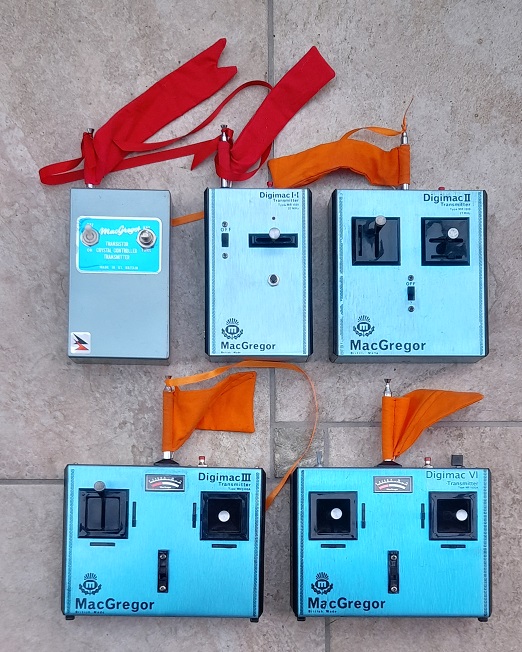

Here's my Clan MacGregor - and that's just since Ponte in July

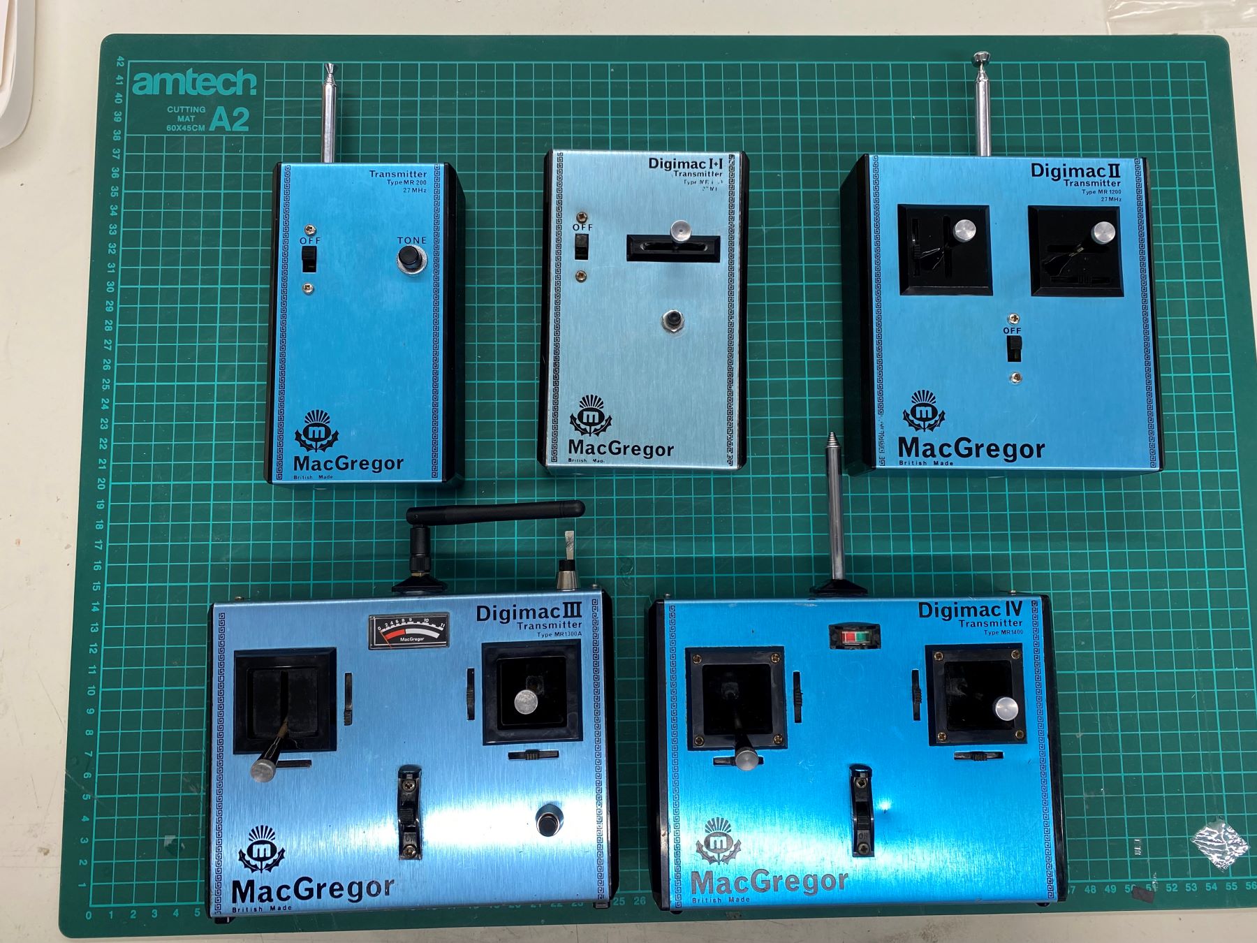

All those blue trannies & not a hairy leg or dogs dangley in site
Does the size of the sporran reflect the number of wee MacGregor sets owned

Each of the transmitters above have already had a model assigned to them, some of which aren't even built yet.
