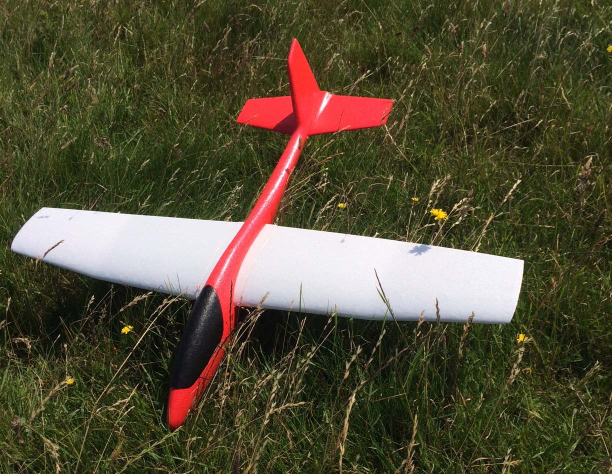

Here's mine, maidened very successfully today and an absolute delight to fly.
This one has no extra weight and was perfect in 10 MPH winds coming over Middle Hope on the Bristol Channel, I bought a black and yellow one as well and I may do the same conversion but work a little extra weight into it for more breezy days up Crook Peak.

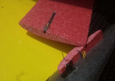

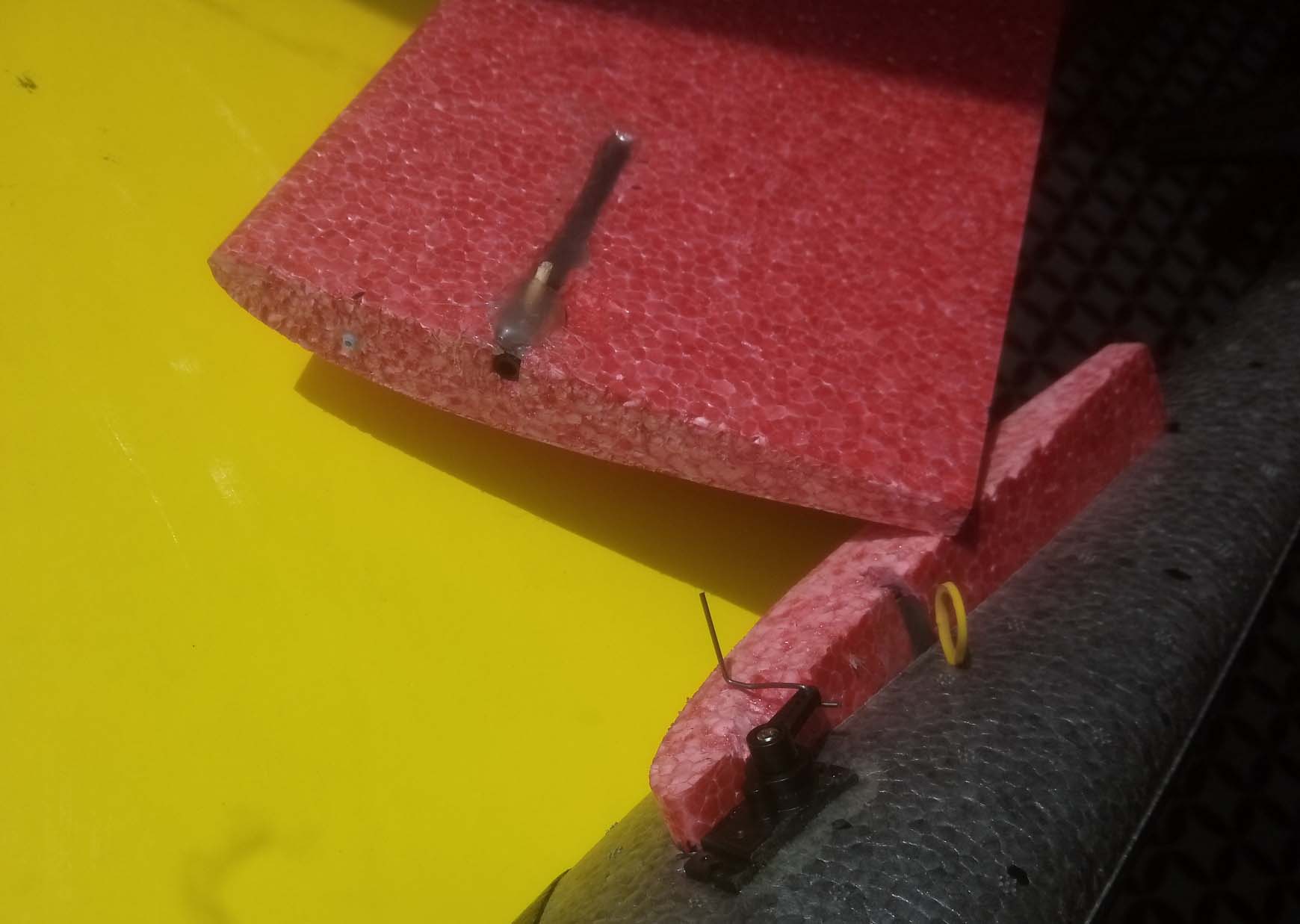

Phil or Neil
what type of glue did you use to stick the tubes to the wing?
Phil - also how do you disconnect the servos to remove the wings - unscrew the arm?
Richard
Re: Lidl gliders available again
Hi Rich
I used a hot-glue gun.
Each pushrod is a short length of wire bent at 90 degrees into an "L" shape,
the servo end of the "L" has a Z-bend for the servo arm, the other end simply
pokes into the wing root. The hole it pokes into is lined with an inch of WD40
straw (or earbud stalk) as a bearing. Nothing to disconnect to remove the wings,
other than the rubber band that keeps the wings together.
When you remove the wings the two "L" pushrods stay on the servos.
I use 3 sections of 'outer' tubing with one on the centre section, that means the
slot is a uniform width & easier to cut. Click & click again to zoom in:
