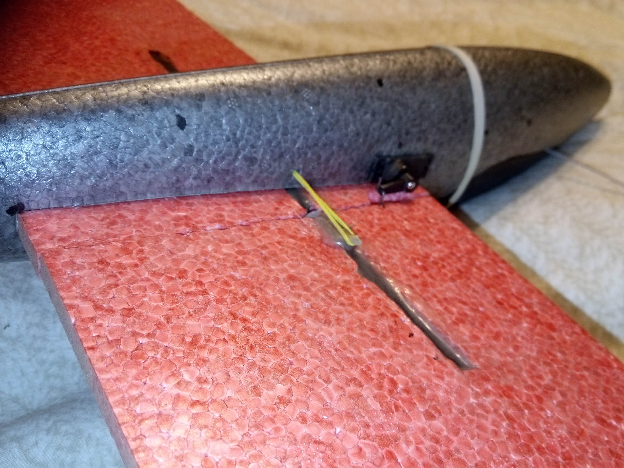

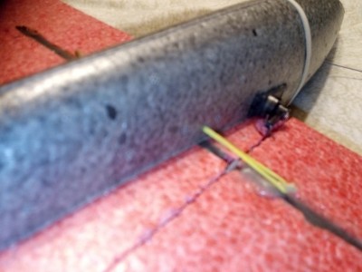

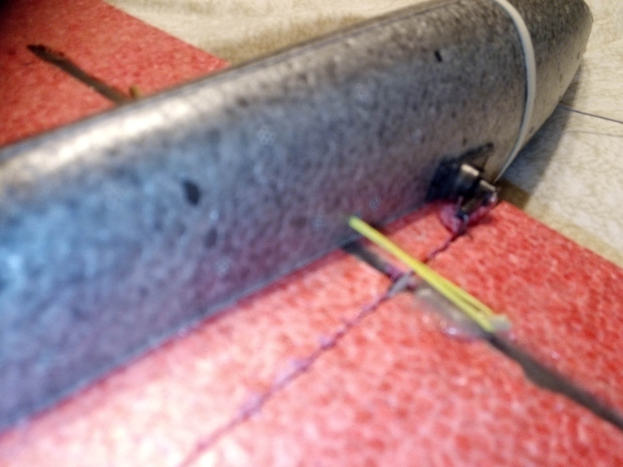

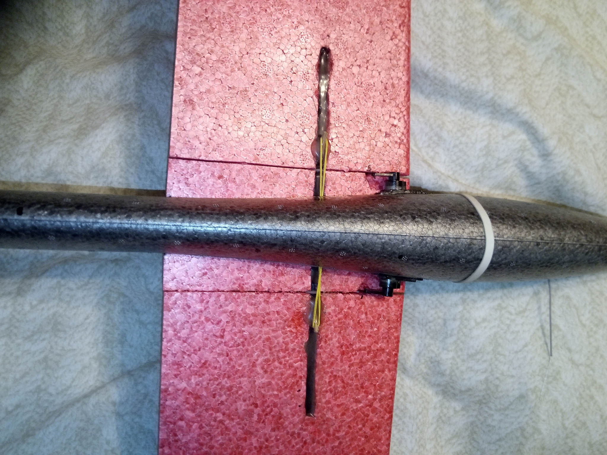

Some pics of my own twisty-wing setup, this does brilliant twinkle rolls, the response is instant and very quick. Another advantage of twisty wings is that there is no extra weight at the back, and nothing back there to break. Twisty-wings has been an eye-opener for me!

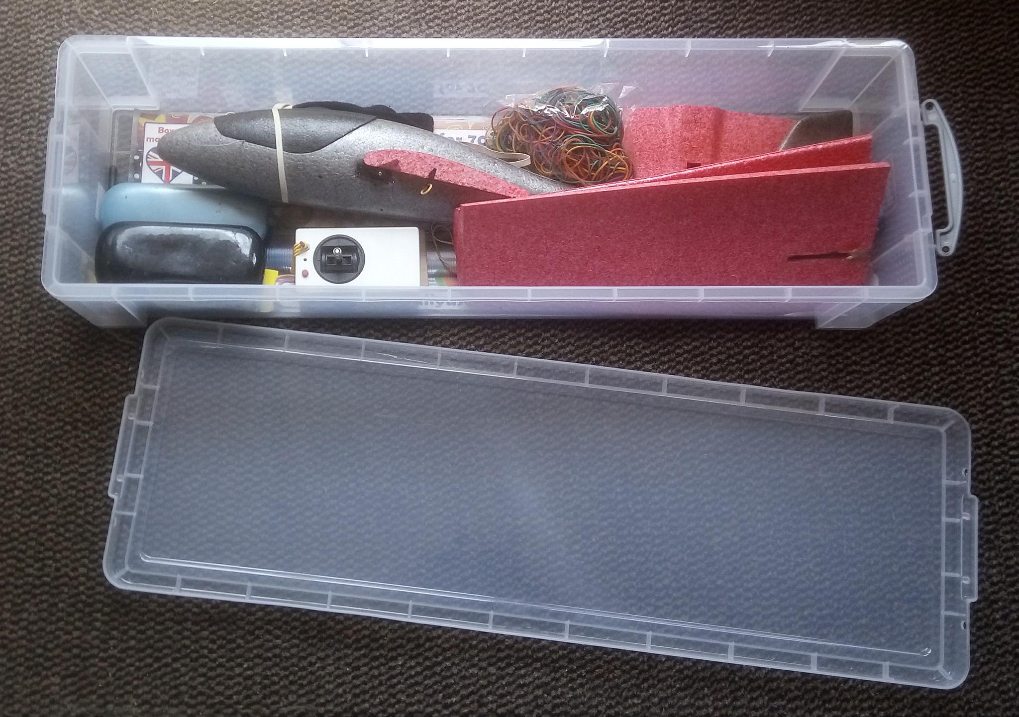

Mine all fits in a small "Really Useful Box" with the little 2+1 tranny and my sarnies:
