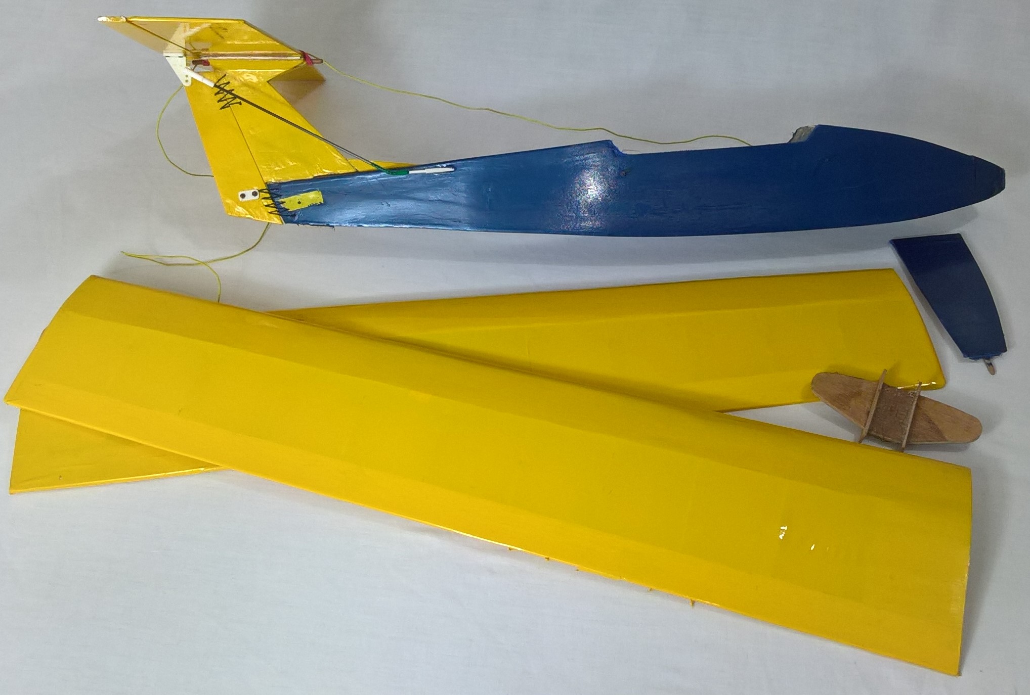

A little while ago I got hold of a ready built Sigma that needed a little work that I have now done. Different to Wayne's approach I would like to make an electric power pod for mine. I've worked out how to mount one, but would like a little advice on what motor/prop combo would you think will do the job. Or just a starting point would be good as prop size basically will determine the height of the pod.
The wingspan is 45" with AUW of 410g (14.5oz). It's quite a short model - I'm so far used to seeing the fuse having a similar length to the wingspan.

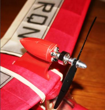

Good point that Wayne makes about three blade props Carl, a way to be able to use a shorter pod. And one other thing to mention (forgive me if you already know this),if needing to extend the wiring, lengthen the three motor-ESC wires, not the two ESC-battery ones. The wires for the little 1811 on my Tarquin (below) run in a hollow pod strut with 1 mm ply sides around a balsa core.

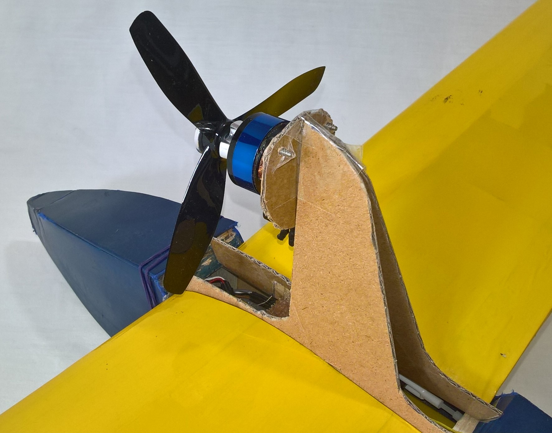

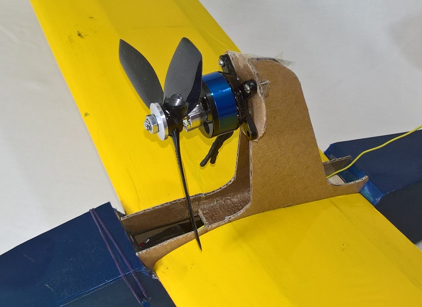

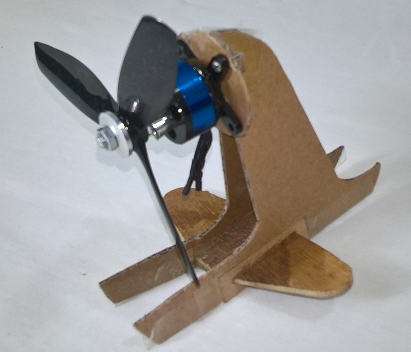

So what I've done is come up with something that is basically combination of what has be suggested.
The Sigma has plug together wings using a joining piece, so I'm going to make a new joining piece that incorporates a pylon power pod. I've produce a version in card:
There is a shaped piece that goes over the wing joiner over which you band the wing into position. So I'll need to in-fill some block to get the same result. Because I've installed a 2 channel 27 mhz system I plan to use my motor timer on the Sigma. But will add another new feature. At present if you set a zero motor run time, the timer counts down and does nothing. So I plan to add a feature whereby you can activate a switch operated by full up elevator to turn the motor on and off when the timer is set to zero (I will eliminate the countdown blips in this situation). If the timer is set for a motor run, then I will still allow the switch to override the timer and cancel the timed motor run, and from that point the motor controlled by the on/off switch.
I have a few pictures of the model. So I'll do that next...
