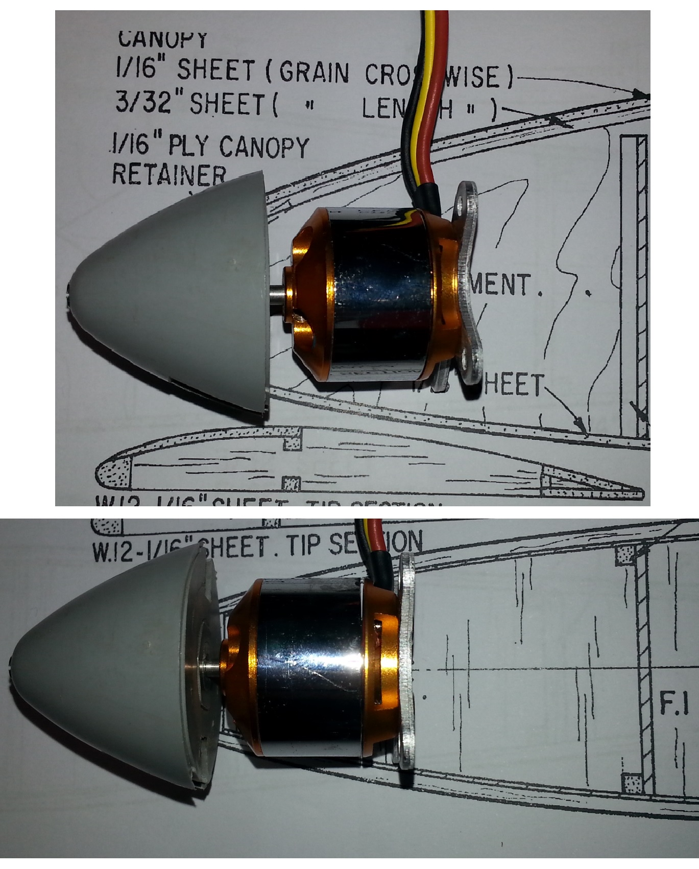

Re: Sigma
Preliminaries:
wing - already in one piece - is a Union foam job, suitably reinforced. It is almost a direct replacement for the original, simple enough to convert to 2 pieces with a carbon rod joiner.
The chosen motor - a 2212 6T (2200Kv) - should go well on only 2 cells, using a Graupner folding prop pinched off an old S400 combo. The nose will need to be enlarged "slightly" to accommodate.

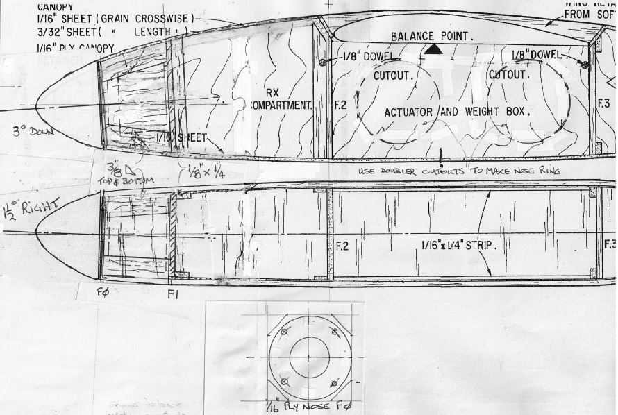

Re: Sigma
Managed to get a little time over the weekend to sort out the nose modifications:
screen shot of the pdf scan of the modified nose
As you can see, the changes to the side profile are minimal/subtle, but the nose has had to be widened noticeably. I think it will still look like a Sigma in the air :)
Sigma_motor in nose_LR.pdf
It's a "roughie" but you should get the idea.
(187.75 KiB) Downloaded 380 times
All the bits have been printed out & glued onto cardboard for templates. The structure will be 2mm foam for the fuse (with strategic reinforcement) & the tailplane, while fin will be 4mm foam.
I bench ran the motor with a Graupner CAM 9" x 4.5" on 2 cells and there is plenty of thrust. I haven't done a current check yet but neither the 12A ESC or motor got even warm. Looking good so far!! :D
