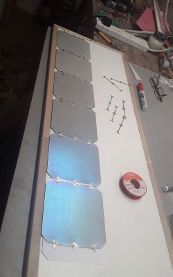

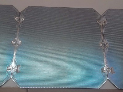

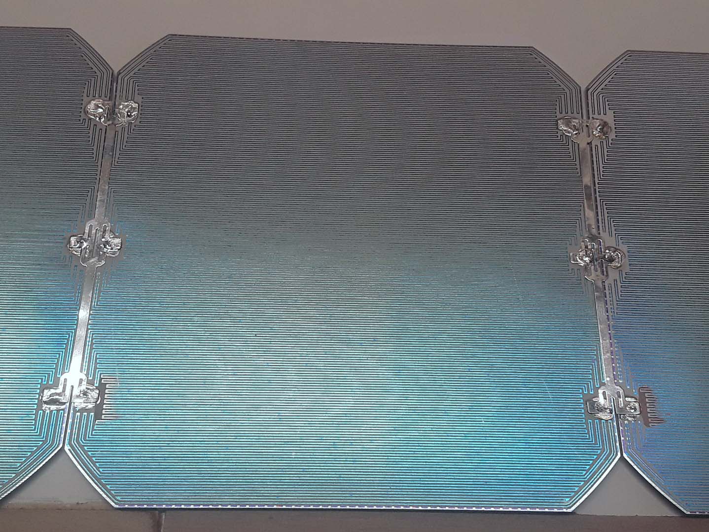

Solar cells in place, then tin the cells and joiner.
Cells soldered together.

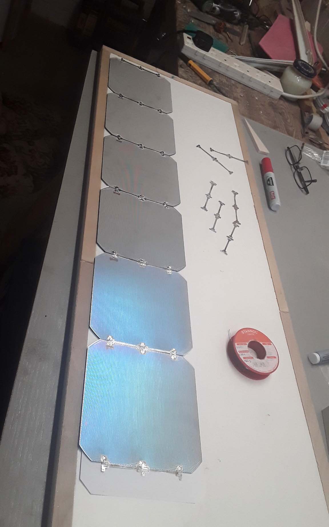

I got some cells from Martin, solder 6 together, +'ve marked red.

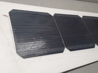

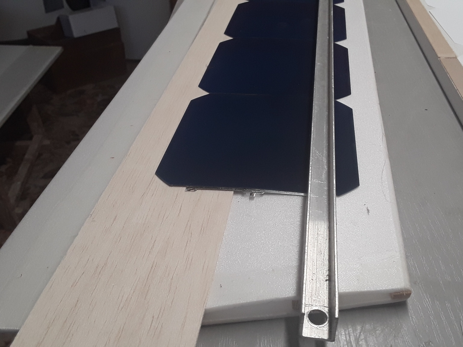

Cut a 25mm strip of glasscloth

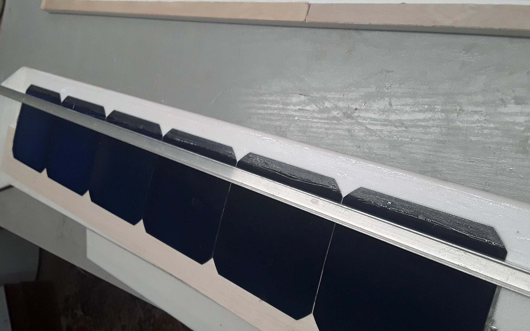

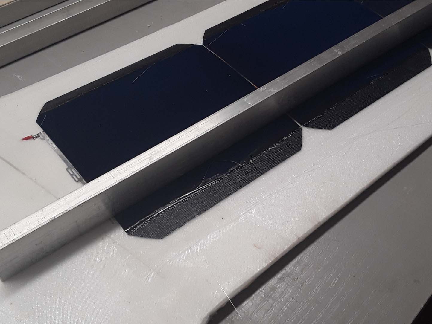

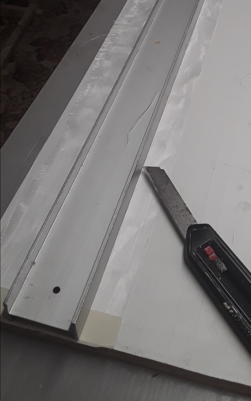

The cells are put in place, the rear resting on some balsa/Depron to get the front resting on the LE. Then held down with an aluminium bar.
The glass cloth is fixed with acrylic varnish, about 10mm on the cells, 15mm on the Depron LE. Make sure none sticks the bar to the cells.

Bar holds the rear of the solar cells down to fix trailing edge glass cloth fixing.

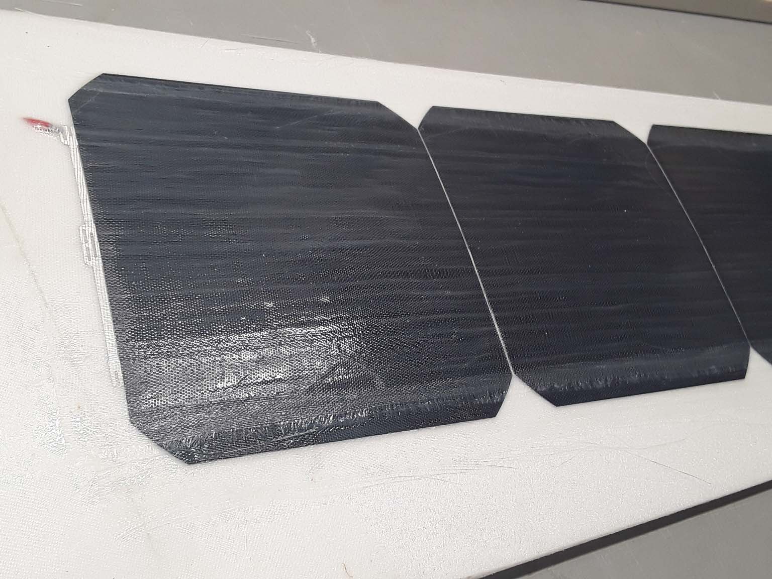

Finally glass cloth covers the rest of the cells and slightly overlaps the other glass cloth.
This side is now completed, there is a connecting 20swg 0.9mm copper wire going from tip to tip, I have used enamelled wire but copper earth or similar is fine. Next task is to do the other side.

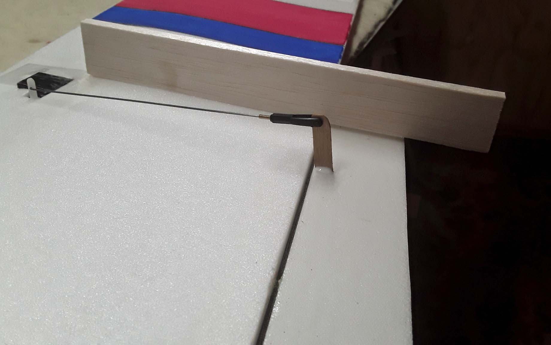

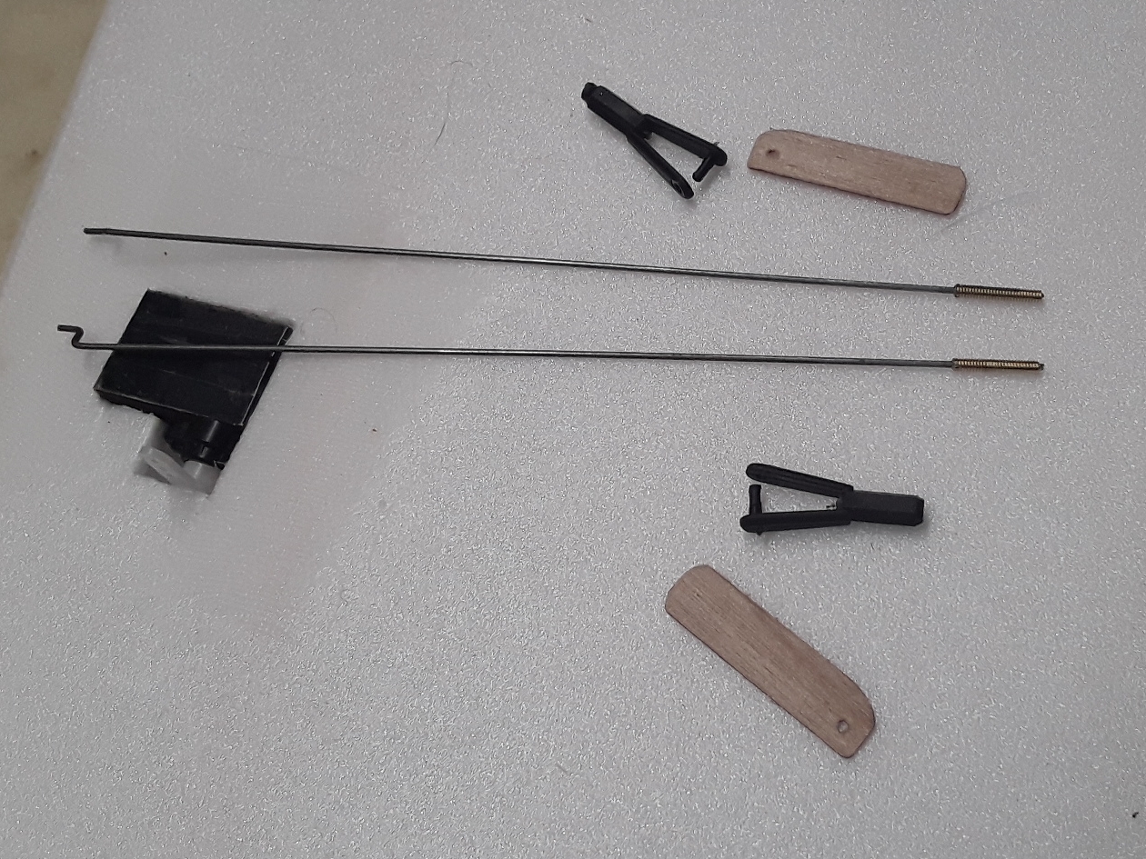

The other wing has had the solar cells soldered together, fitted to the wing carefully get them the right way around, only to find they were turned around. So had to alter the wiring. I am using 2 old Graupner servos which remain excellent and work fine with this low voltage.
The servo connection I use is a 1.5mm ply horn, 30mm long, 20swg pushed and then connected to a clevis with a short piece of brass tube 2mm diaameter threaded for 2mm. Fixed with Loctite.

Set up the Clovis, set servo to neutral on the radio, apiece of balsa to set the elevon level with the lower wing, then add glue to the slot and horn and stick with elevon in the correct alignment.

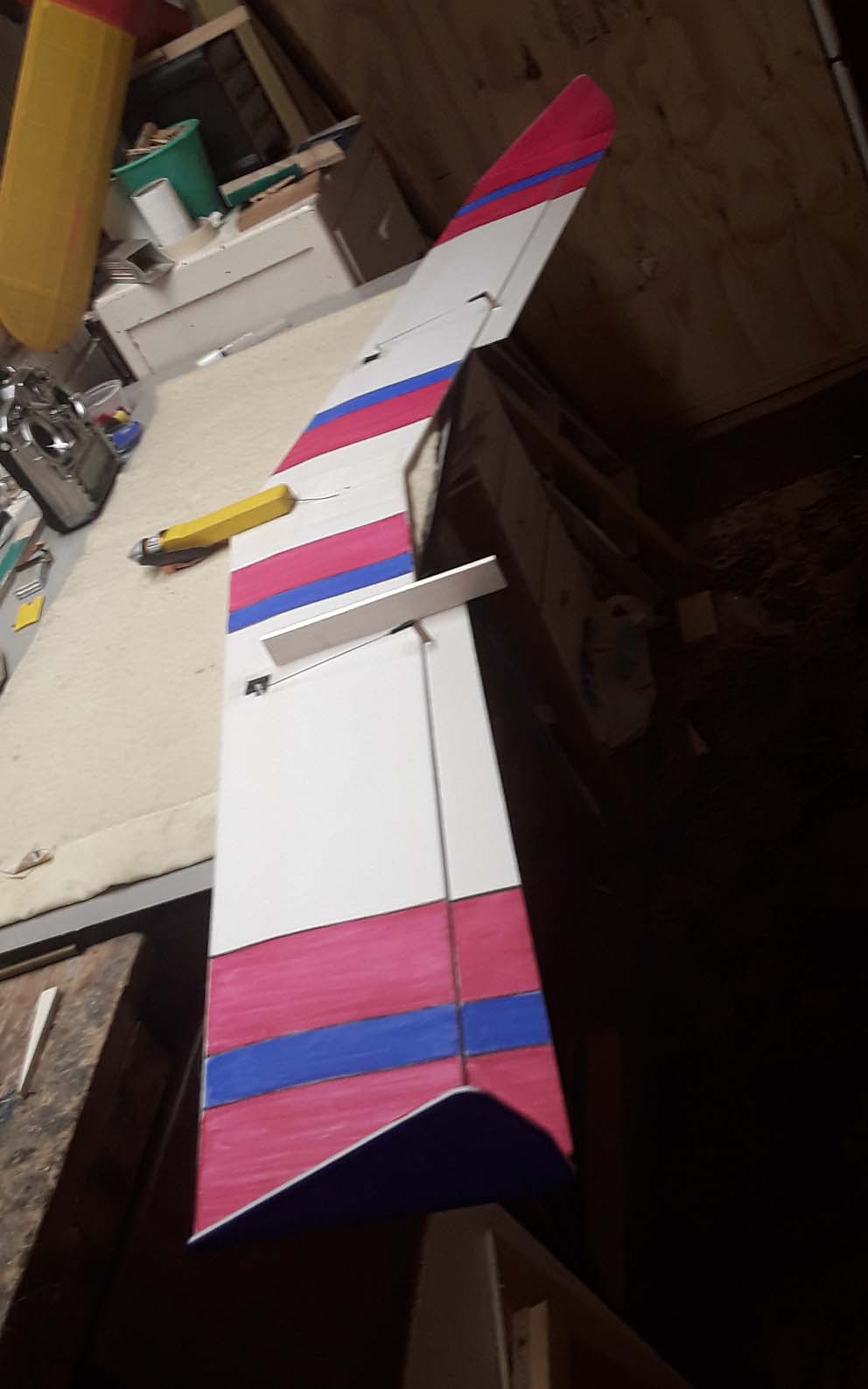

I paint strips on the underside, the fins being positioned underneath makes the wing look odd and as if you are inverted until you become accustomed to it.

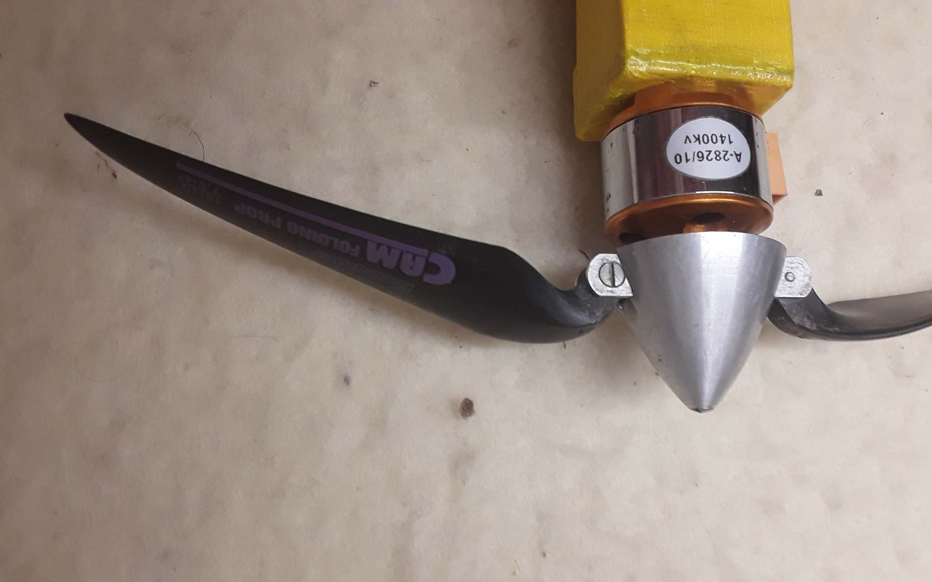

I aim to change it to a 100kv motor later and a 8 or 9" prop.

The plane is now completed ready for testing on Thursday if the weather is good. I am getting about 28W of power, between 4A and 4.6A with direct sun, dropping to 3A when at an angle, but looking good. Weighs 410g, the motor position was a reasonable guess with more cells and a larger motor the CoG has come out a litte bit infront on my estimate, i wll see how it seems when flying.
Tip fins were stuck on with Por. On my previous models they were just painted, this time to make them more durable wither increased weight, they have been covered each side with glass cloth before fitting.

At home I have now tried a 2812 but I did not get enough power on an 8" prop, and I'm so not t,think a smaller faster revving motor will improve things, so back to the 2822 1400kv motor, wait until the 1000kv motor arrives and then try some different props. I may then shorten the nose to move the CoG backwards.
Motor and prop selection is far more critical than with battery planes, it just needs to be adjusted to the power V and A available. The motors are easiest fitted it you can find short hexagonal bolts, and use a long handled driver, unfortunately I have some from he'll maintenance.
