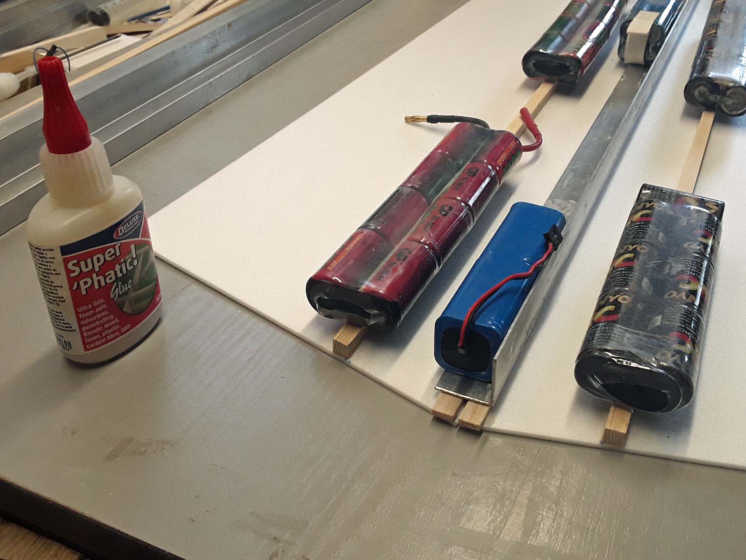

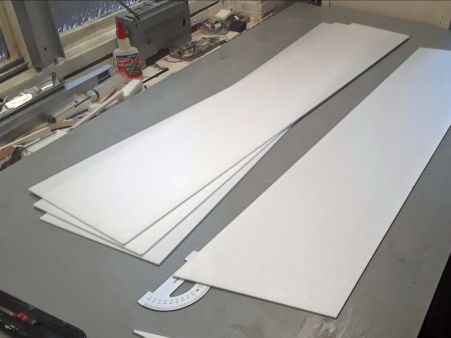

I use 3mm AeroDepron, it comes in sheets 1250mm long, trim to 900mm. Then cut 2 sheets of 900x360mm, then divide to give 200mm root and 160mm tip. These 4 wing blanks then need to have the tips cut to 15 deg.
I used to use PVA but the AeroDepron is not gluing well, I found that Superphatic was best, so first time building a complete plane this way. The spar is 7mm spruce from a diy store, the leading edge is 3mm balsa strip, about 8mm. Weigh down and wait a while.
Cut 4 wing blanks.
Cut 4 wing blanks.

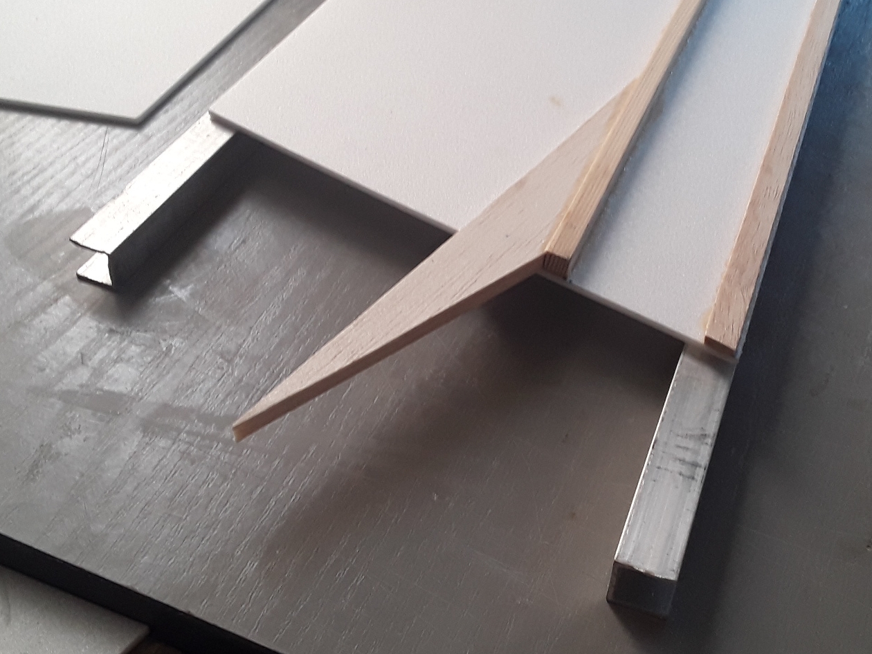

Glue the leading edge and 7mm spar.

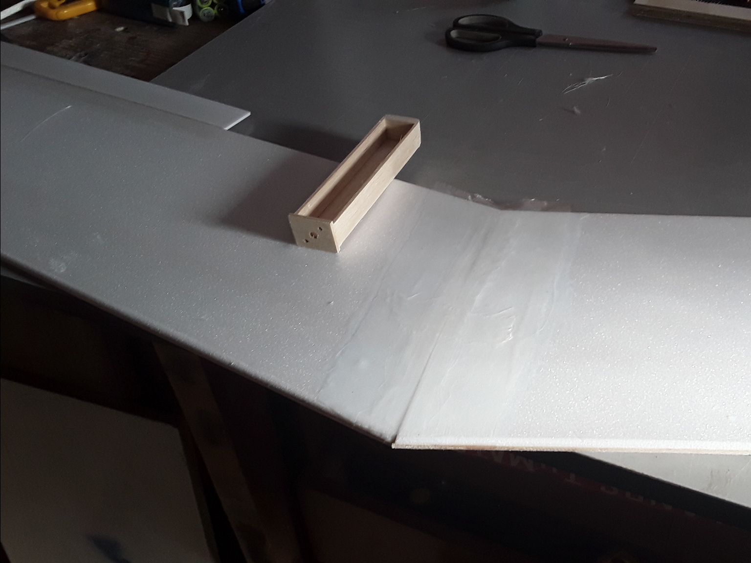

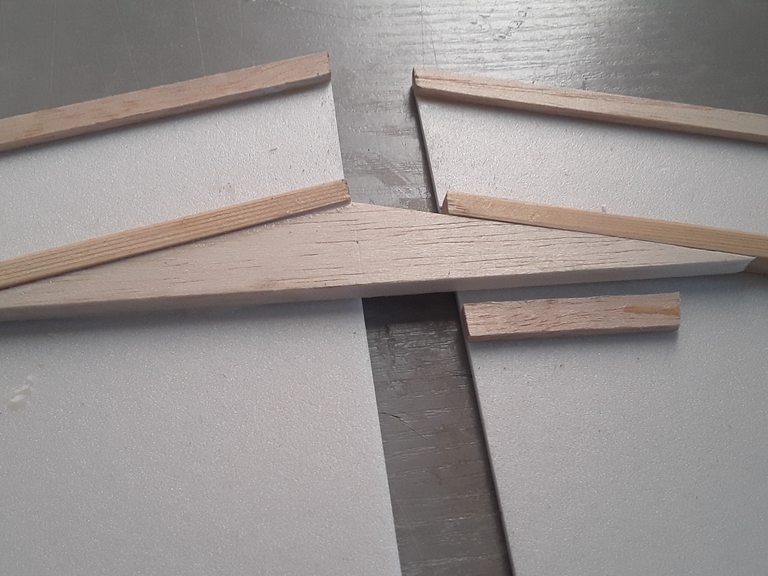

Add 6mm balsa joiner, 3mm balsa to help align when joining.

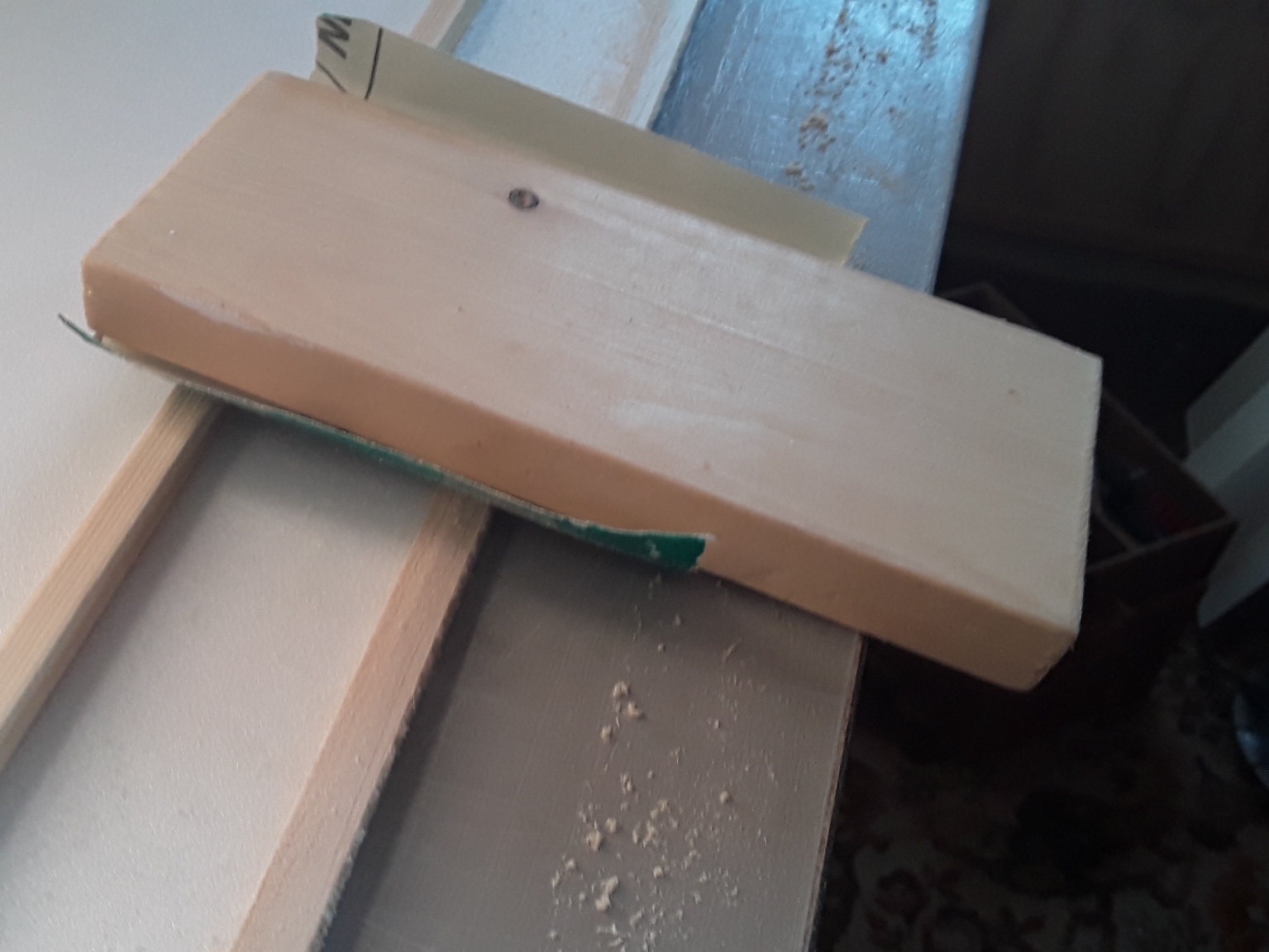

Sand leading edge inline with the spar.

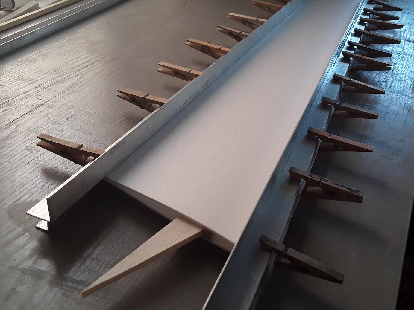

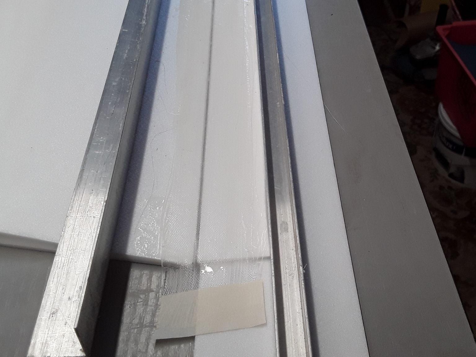

The wing is constructed on aluminium bars which hold it straight and keep the skins together with clothes pegs.

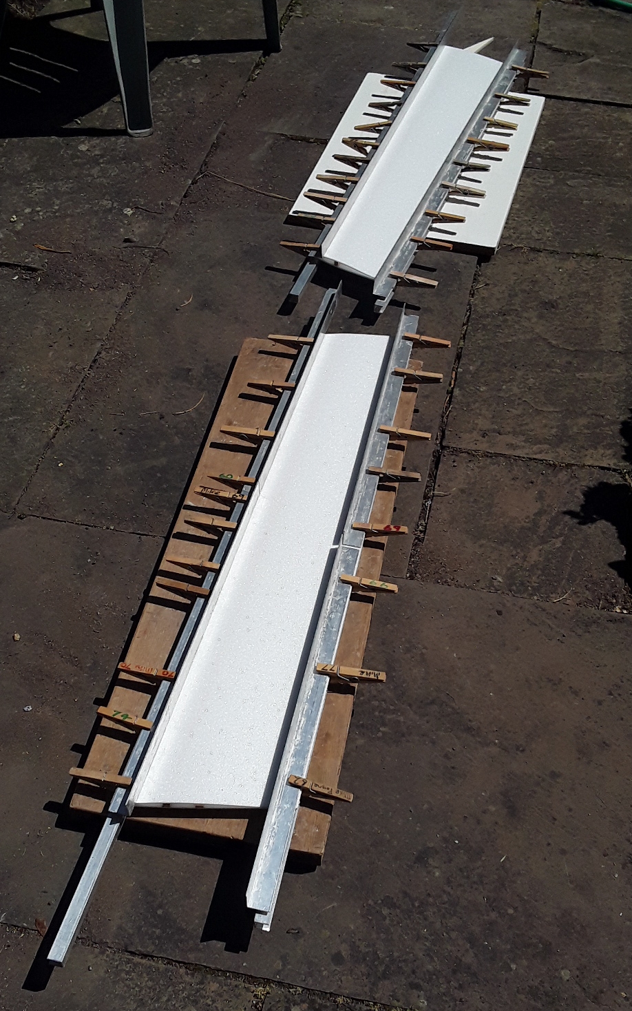

Run some Superphatic down the LE, spar and trailing edge, smooth out, add top skin, clamp with pegs with another aluminium bar.
Place in the sun to dry.

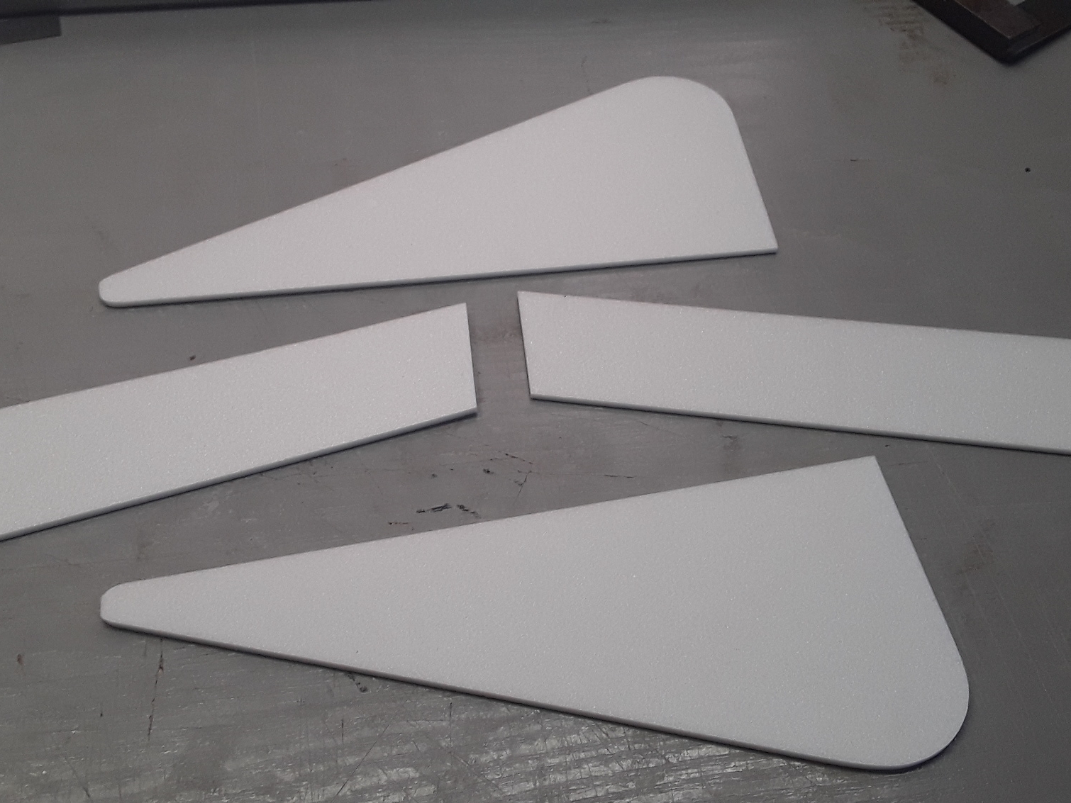

Tip fins are 220x110 3mm cut in half and shaped, elevons are 600x90 3mm Depron, cut to 40mm root 50mm tip.

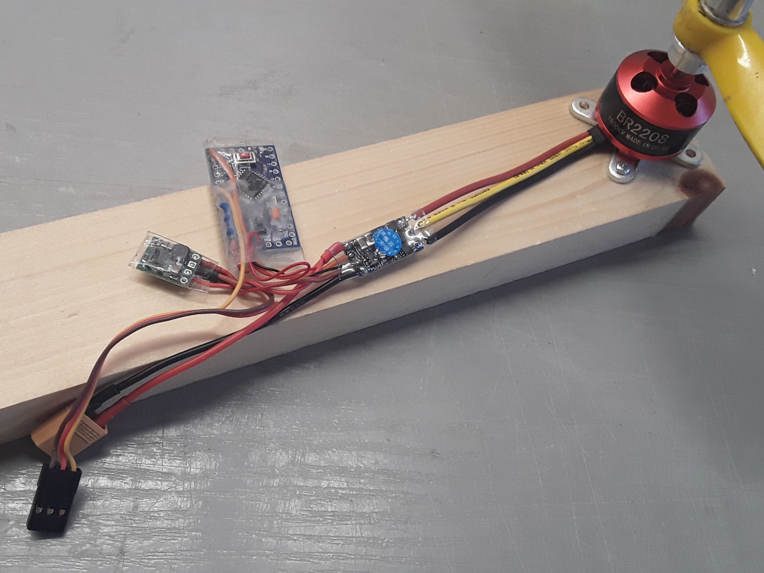

The controller, is an arduino, a Pololu 3.3v voltage regulator and a 1-2s Racestar controller.
Martin will add details about the arduino sketch and function, the power supply is a 3.3v Pololu regulator, plenty of power with some servos. You need a dedicated 1-2s Esc. Racestar tattoo 8a blheli.

The motor and prop are quite specific, you need to identify what voltage you are working at, 12 panels about 7.2v with about 4A, so 28W. The motor / prop combination needs to get this current at this voltage, for 10 panels a 2208 motor with 1800kv and a 6x4 prop should work well. I am going to try out some larger motors for my 12c model.

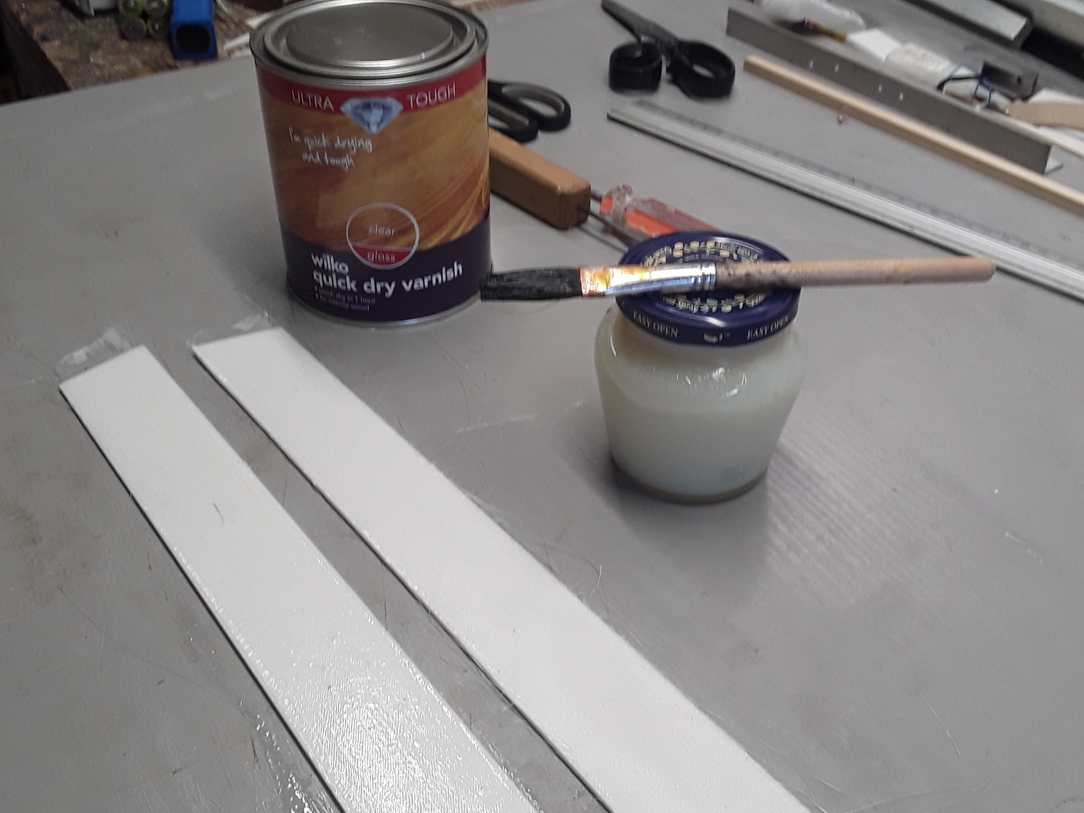

I use a lot of glass cloth, the 3mm Depron elevons are not very stiff, so I have added glass cloth to the underside, and the upper side has 60% covered by glass cloth which is used as the hinge. The glass is stuck down with acrylic varnish, I get mine from Wilkinsons. The wing join will have glass cloth top and bottom and the solar cells are fixed and then covered with glass cloth. The wing tips where the fins attach have a band added.

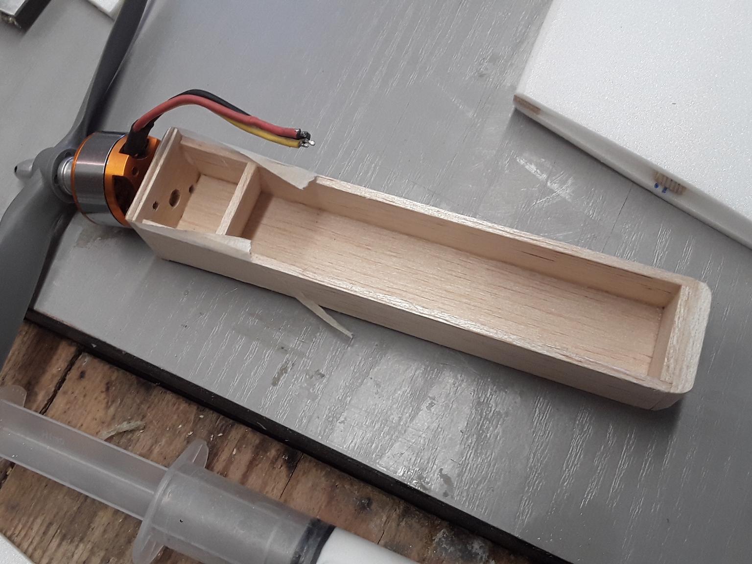

Simple box fuselage, holding the motor to the wing and covering up the Rx, ESC, and arduino controller.

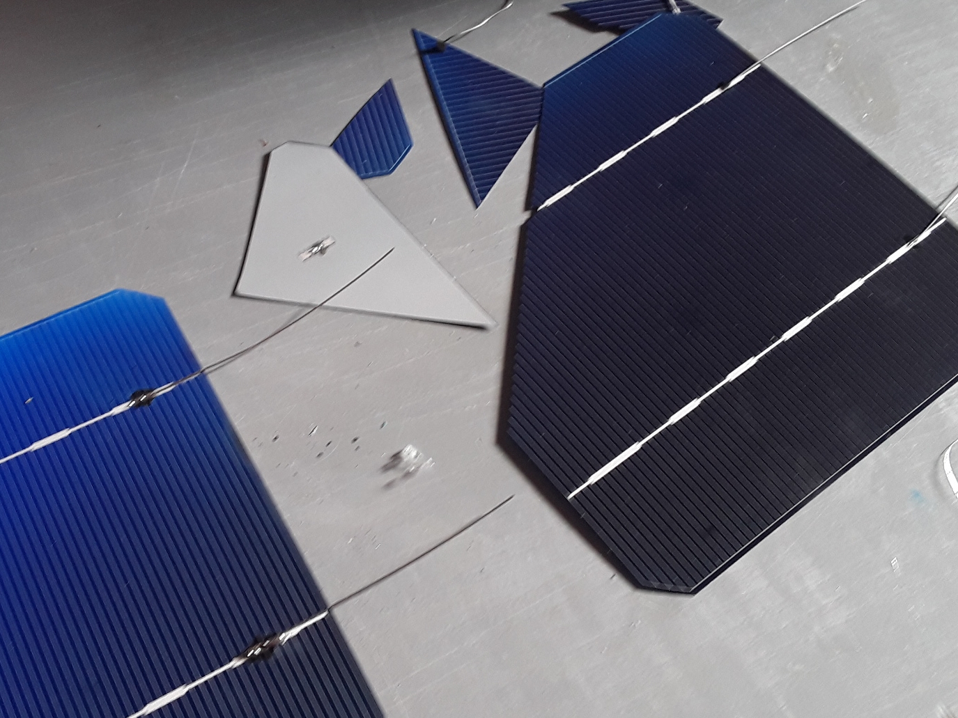

I got these cells to try,  very brittle and you need to solder top to bottom. The the top connection is too thin and breaks when soldering, easy to get, cheap and no good.

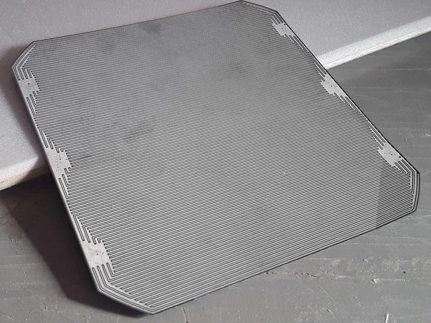

Sunpower C60 cells are all blue on top, goes to black with glasscloth, and have an array of contact strips on the back. This my damaged one, you can see a crease in a corner, but they still work fine.
Sunpower C60 cells are best, they can be difficult to get, but ebay currently has a reasonable supplier in the UK.
