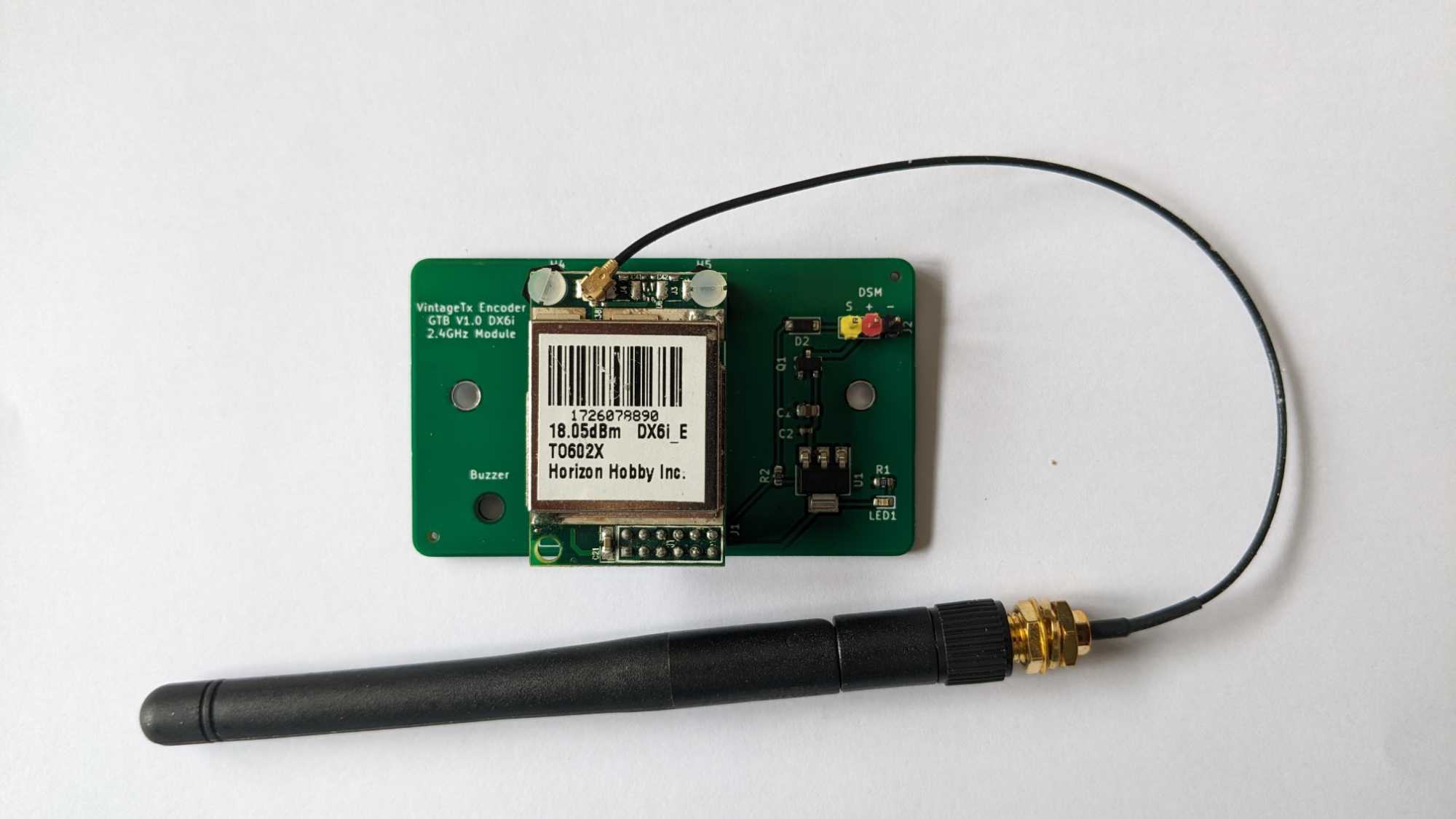

Of course, you are 100% correct, 125K baud is possible with 16MHz Atmega328p. I realised this a few weeks after that post but I never got around to posting my findings and my other work on using the Spektrum X1TX0 module. In fact, there is a bit of a story about it all…
The reason we were playing around with the Spektrum X1TX0 module from a DX6i, DX5e, DX4e or DX4 was there was a period when there were few other modules available for 2.4GHz conversions, it was the time between the FrSky DHT being discontinued, but before the XHT was released, the OrangeRx DIY modules were permanently out of stock, Spektrum had discontinued the DM9, nobody much wanted to use the Futaba TM7 FASST modules, the LemonRx module was not announced yet, let alone available and the only alternative was the 4-in-1 multi-protocol modules, but they had there own set of issues at the time.
When I eventually read the Atmega328p data sheet, rather than relying on what I had read elsewhere, I got the UART working at 125K. I added it to the firmware for my LCD encoders, it simultaneously outputs both ppm and DSM serial. To go with this I designed a simple Spektrum module board, with an onboard 3.3V regulator and logic level shifter (5V to 3.3V) and connector for the module, it was designed to piggyback on my GTB encoder boards. There are a few conversions I did with the X1TX0 module still being used at our field. The Spektrum X1TX0 module has only 6 channels and most people seem to want 7 or 8 channels, even though their models don't need that many channels and they're only using a 6 channel Rx so never really took off.
X1TX0 module adapter that I designed way-back
