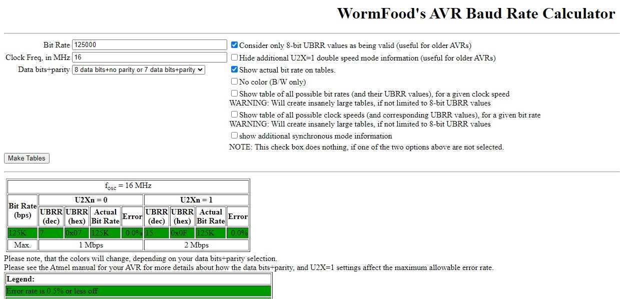

Just browsing older posts and happened across this again Mike, recently I've been using the Wormfood Baudrate Calculator which suggests that a 16Mhz 328P (with its single UBRR register=7) does 125000bps exactly?Mike_K wrote: 26 Jan 2019, 17:11 ... a couple of years ago I did get a Spektrum DX5e 2.4 module working with an Arduino, but as I wanted 7 channels for many of my models, I didn't pursue it. There has been a far bit about using them on other forums, but many have had issues getting them to work with a 16MHz Arduino. The reason is the Spektrum module works at 125K baud, which is not available with a 16MHz ATMega 328. They set the baud rate for the nearest available which is 115K, but this actually gives 111K buad on a 16MHz Arduino (115K -3.5%). Spektrum DX4e, DX5e and DX6i all use 3.3V ATMega's at 8MHz. An 8MHz ATMega at 115K baud actually runs at 125K buad (115K +8.5%) so obviously is matched. The secret is to use a 3.3V 8MHz Arduino, there is plenty of processing power to do all the other bits of the encoder, maybe I should finish that project off properly so that Spektrum DX4e, DX5e and DX6i modules could be used for conversions.
From the 328P datasheet table 19.1 it also works out exactly with UBRR=7 in normal mode or 15 in double. Maybe I missed something.
Just for interest, not being a Spekky user its very unlikely I'd ever use it... maybe I'll give it a try & measure the actual rate...
