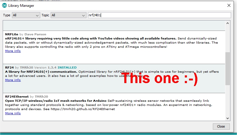

Eureka :D Fixed a library problem that had been bugging me, somehow I'd both NRF24 libraries installed, the Maniacbug one and the (preferred) TMRh20 one.
Deleted both, reinstalled TMRh20, reloaded two nanos with the most recent code and everything is working great. I think I confused the IDE with a mix of the two libraries. Actually this rings a distant bell...
One of the problems was the IDE not compiling library changes, and I found online an easy way to force a 'rebuild all' - change the processor setting from Nano to something different - say 2560 - and recompile. Dont worry about any errors caused by the 'wrong' processor. Then change it back to Nano and recompile. It will rebuild all including the libraries. You learn summat new every day :D

bluejets wrote: 07 Apr 2020, 01:35Do you still have a link to the particular library that worked? (TMRh20?)
I loaded it from Library Manager Jeff. Click 'include library' then 'Manage Libraries' to load LIbrary Manager, enter NRF24L01 in the search box and you'll find it, make sure its the TMRh20 one and click install.
The process is very slow on my PC, dunno why, you need to wait for each screen.
No problems since, provided you force a 'rebuild all' once for every one of your sketches that used the old library. I like Martins method, where the .cpp and .h files are in tabs within the sketch.

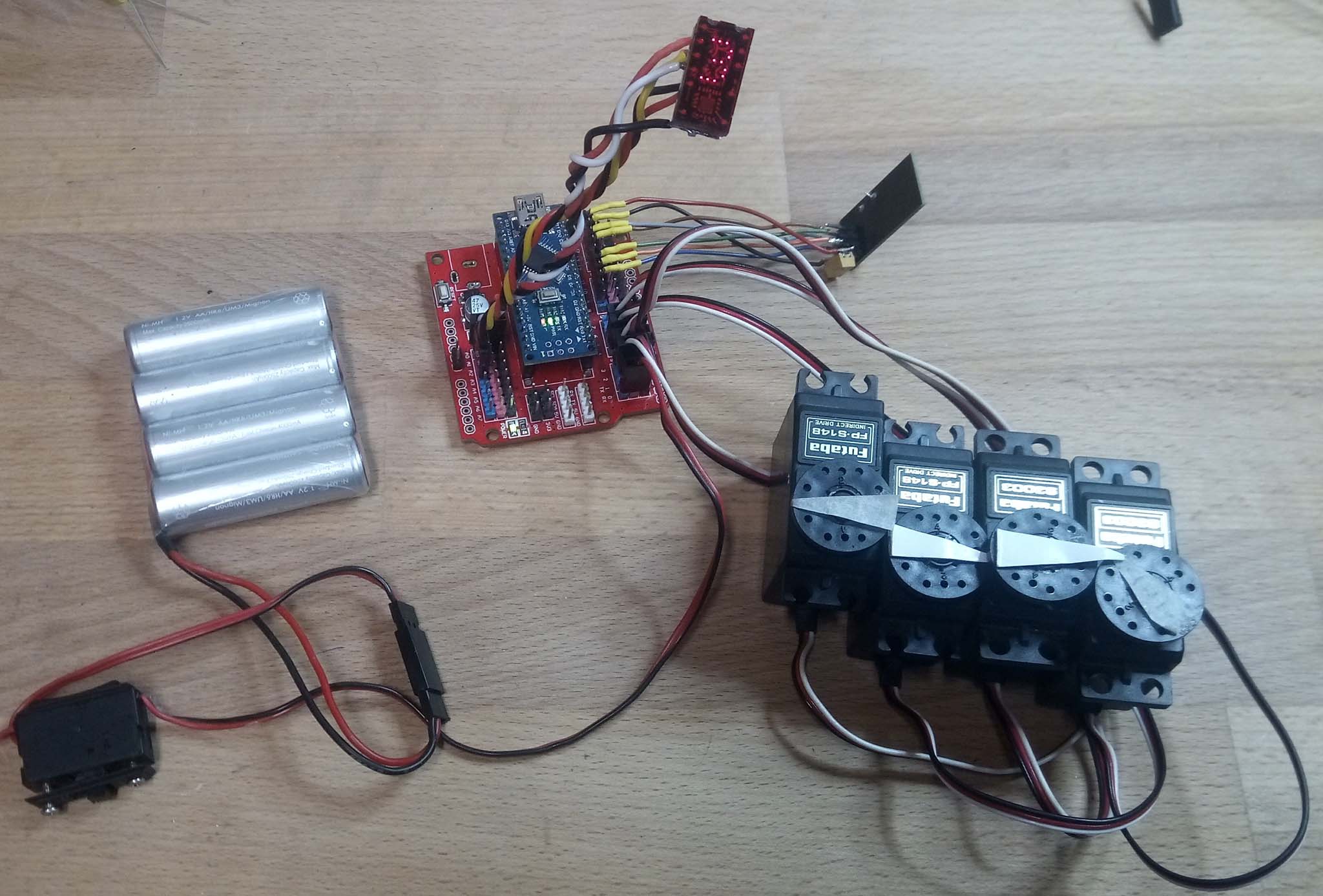

I've three complete receivers and two transmitters here, I'm repeatedly testing them and no problems at all since sorting the library problem. The MPX Pico now has a high power module and sports a sassy aerial, the other tx is a loose ebay redboard on my bench for ease of tinkering. Two receivers are the small ones in the photo and one is also a redboard. For now I've used the same pipe address for everything so either transmitter works with any of the receivers. Coolio :D

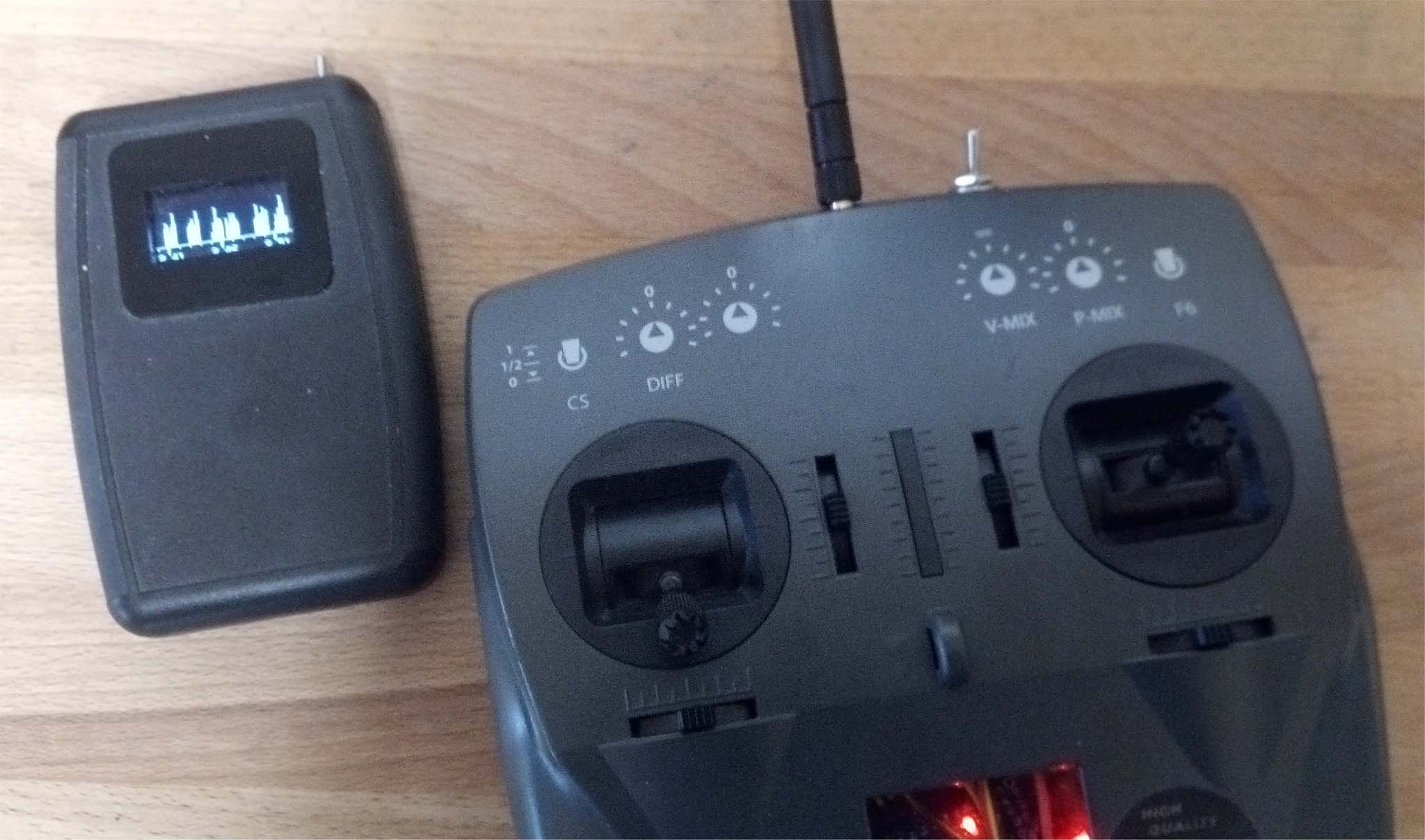

Wahoo, after a lot of experimentation I've got a rudimentary but functional form of hopping working.
Its not 'traditional' FHSS like Werners, in fact I'm not sure if this has been done before. To explain:
The transmitter reads the joysticks, assembles that data into a packet, then sends the same data on six RF channels in sequence. These six channels are widely spaced through the band and theres no preference.
The receiver sits on any one of these six channels and whilst everything is working it stays there. If it loses a couple of packets, it moves to the next channel and so on. At this point it picks up where it left off, but if not it keeps trying the next channel in sequence, scanning the six channels and settling on the first one it finds with a good signal. If you like, as an option on the rx you can add three 5v LEDs on D14, D15 & D16 (A0, A1 & A2) which show in 3-bit binary which channel slot is in use.
I dont know if this particular channel-swapping concept has a name, someone may have done it before I dont know, I certainly couldnt find anything similar.
Its a little bit like Spektrums DSM2 but with six channels to choose from instead of two. I settled on six after looking on the spectrum analyser, any more than six looks greedy and probably isnt necessary. Spekky were happy with 2!
In practise the single fixed channel is super reliable and I would happily have flown with it, but this should make it even more solid in a noisy environment. And I like how you can use any of your transmitters with any receiver. I'm quite chuffed with it :D

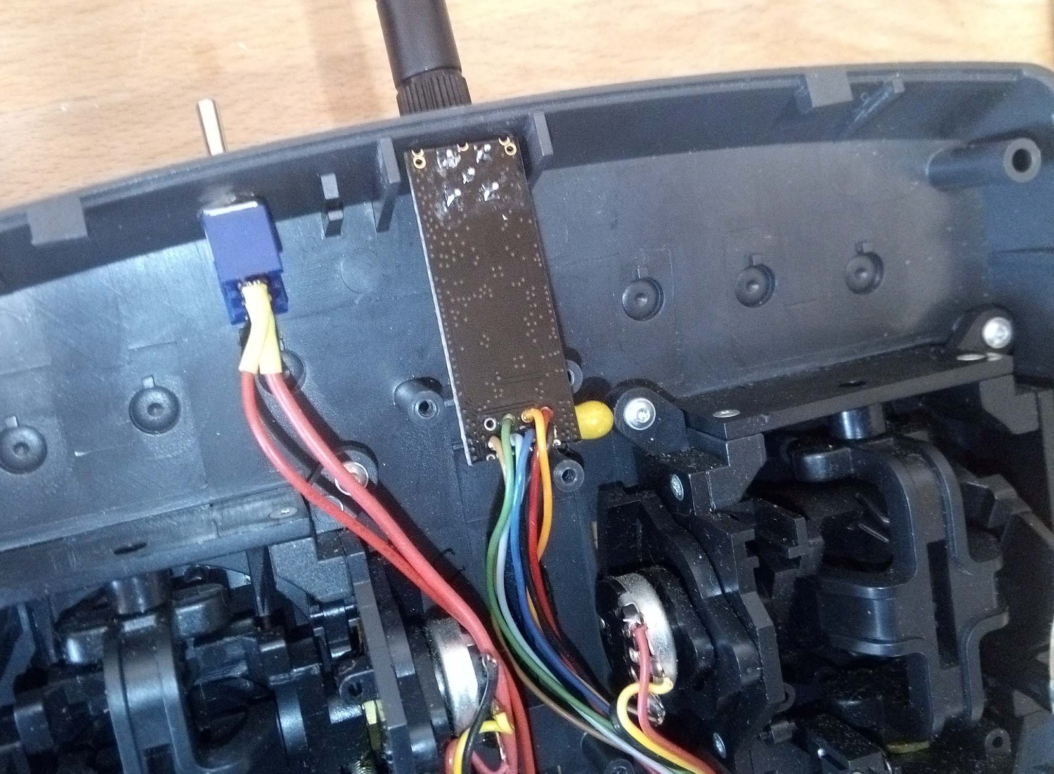

I did use the 5v adapters in some experiments but the Redboard has a proper 3v3 1A regulator so works out quite neatly without. For the MPX Pico I removed the pins from the module and soldered directly:
I've found that the NRF modules do need a good clean 3v3 supply, especially for the high-power ones.
I've seen some projects that use the 3v3 output from a Nano which really isnt up to the job - they seem to rely entirely on a large capacitor to prop up the supply. For those I think the 5v adapters are pretty much essential, and using one would avoid the need to modify the Redboard (repurposing vref as 3v3).

Phil_G wrote: 08 Apr 2020, 12:36 I've found that the NRF modules do need a good clean 3v3 supply, especially for the high-power ones.
Yes indeed! Due to the nature of the RF transmission, the power supply sees a huge swing in load: from a few microamps to suddenly 130 mA.
I usually add a 47uF/6.3V Polymer electrolytic cap directly across the power supply on the module.
Recently I designed my own PCBs. I added a separate 3.3V regulator just for the RF module (belts-and-braces approach). Just a few cents costs providing a piece of mind.
Also important: don't run the module without antenna attached, as the output amplifier may get damaged.

I remembered I had some 45-year-old (yes!) TIL311 hex displays, ideal for a channel slot display instead of those LEDs. This is just for my own interest on the test receiver which is an ebay Redboard so plenty of room, the tiny receivers dont get or need a display :D
We 'upgraded' to these in the old 'switch & LED ' days of early homebrew microprocessors.
They were excruciatingly expensive but really neat. I've two of these on my old homebrew SC/MP system that runs Kitbug and NIBL, still works after decades in the loft :D
Incidentally they are still widely available either used or as a DIS1417 modern equivalent... I remembered I also used two on a 45-year-old motorola M6802 homebrew micro, it still works, it has a homebrew monitor as I didnt like Mikbug... when in the monitor the two TIL311's say: '1C' for 'input command', '1A' for 'input address' and '1D' for 'input data', '1B' for 'input breakpoint address'...
Did you find the retro computing section on here Werner? theres a lot of interest in old gear, the BBC are even running Micro-Live again!
The 'poor mans FH' set up is working really well, I just wish I could try it down at the flying field :D The best bit is watching the TIL311 display scanning... :D
