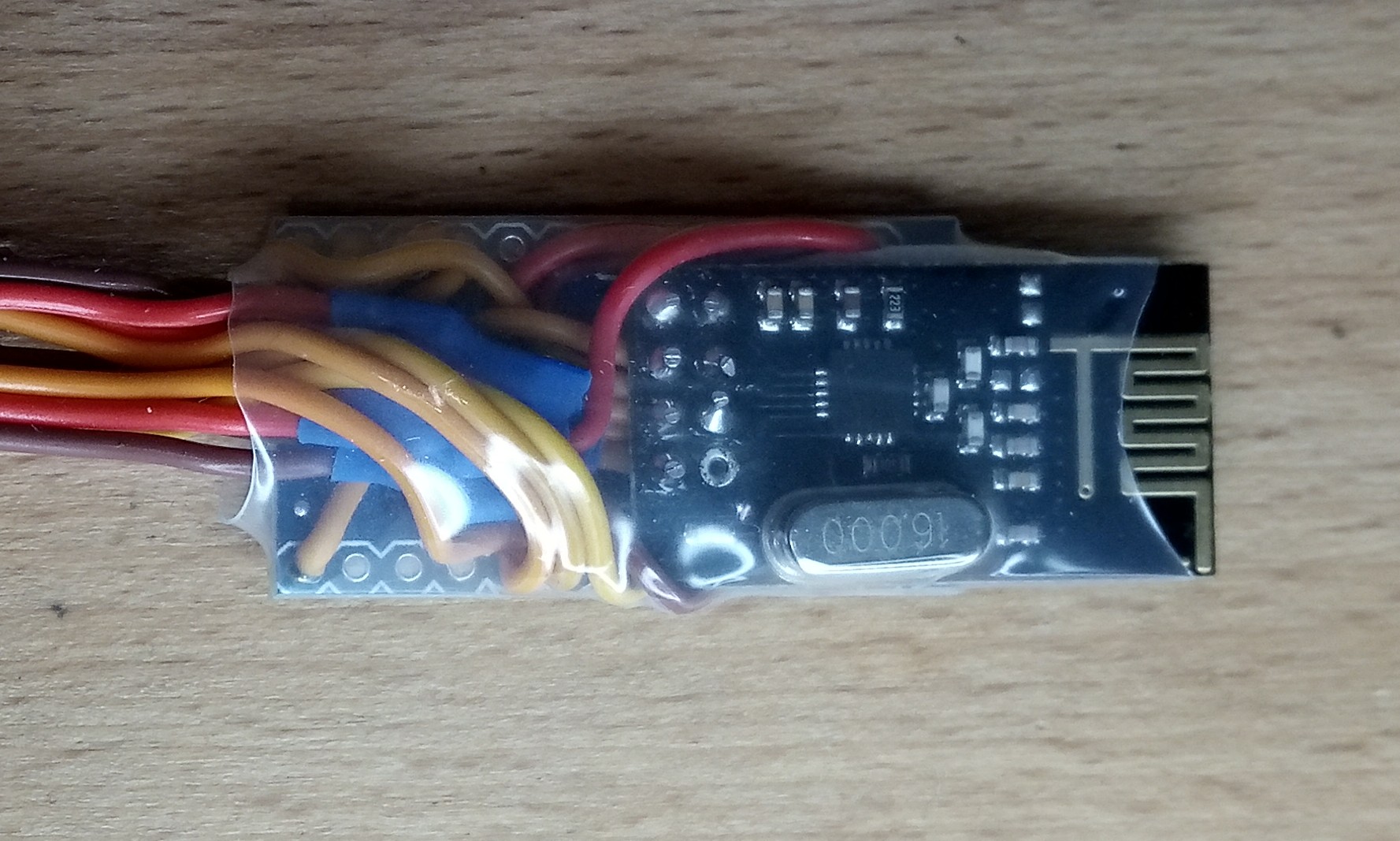

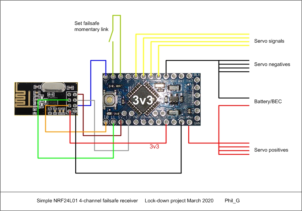

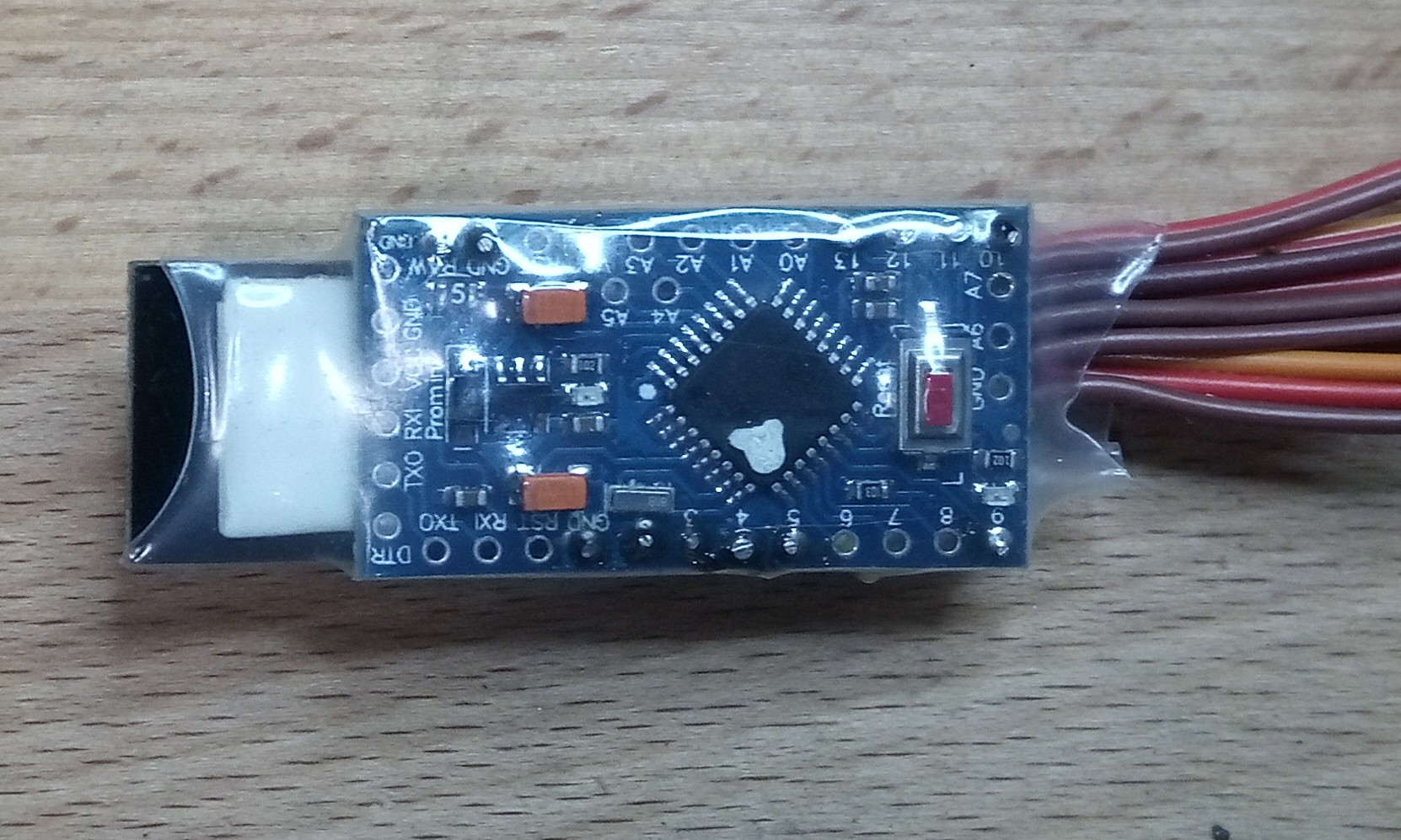

The receiver is a 3v3 promini with another NRF24 piggy-backed, the promini 3v3 vcc regulator supplying the Promini and the radio board. It has a built-in aerial and programmable failsafe on all channels set by momentarily placing a link on the rx. There are no spare LEDs so it confirms failsafe has been stored by wiggling a servo ;)
For ease I chose the servo leads like old retro receivers used to have rather than a header block, it keeps the receiver nice & small. Having the aerial on-board is neat, though obviously the usual rules apply, dont hide it behind a battery, etc.

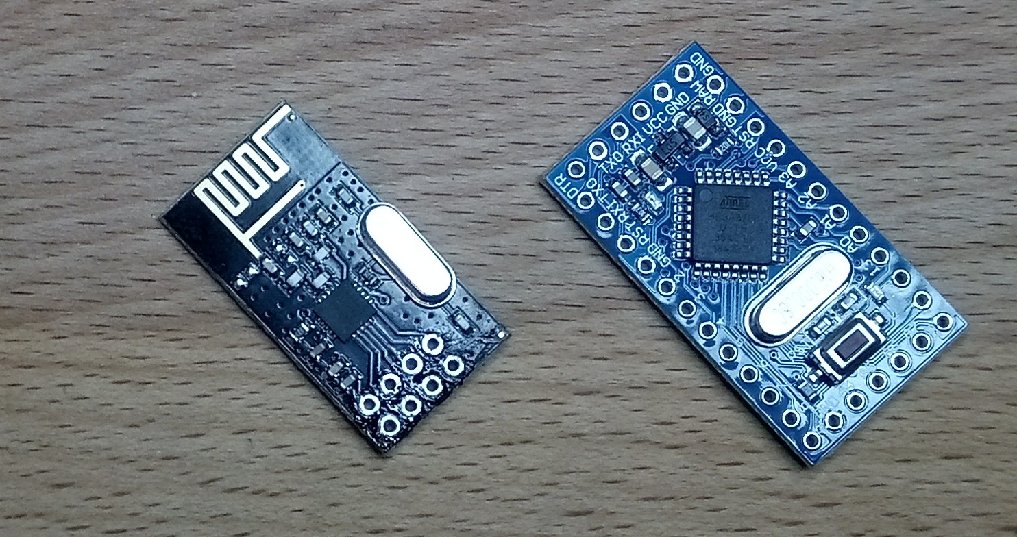

These are the low-power NRF modules, I have some high power (LNA+PA) ones on order from Banggood but they've not arrived yet. [Edit: yes they have!] Range on the low power ones I found was at least 200 yards where I ran out of space, everything was still working and no failsafes. I'd happily use it in a boat as it is, but I'm waiting for the higher power versions to arrive before trying it in a plane.
Besides the "NRF24L01+" theres an older NRF24L01 (no plus) which I'd avoid except for experiments, they both have the 1M and 2M datarates but the later 'plus' version also does a lower datarate of 250khz which gives more range.
The diagrams below show the essential connections, the rest follows the usual "7ch+S/C" principles, though note some pins have had to be moved. It was very much a make-it-up-as-you-go-along project ;)

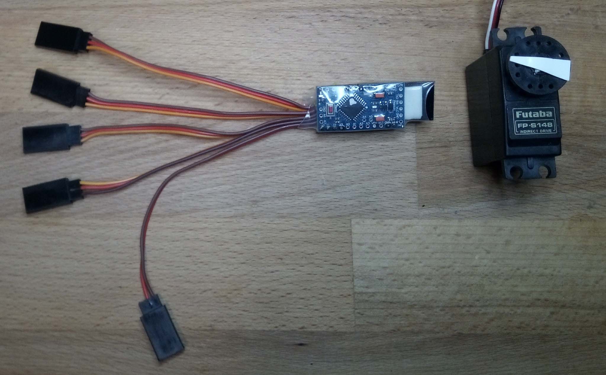

Rx size against a standard servo
Thats the aerial on the left of the Promini

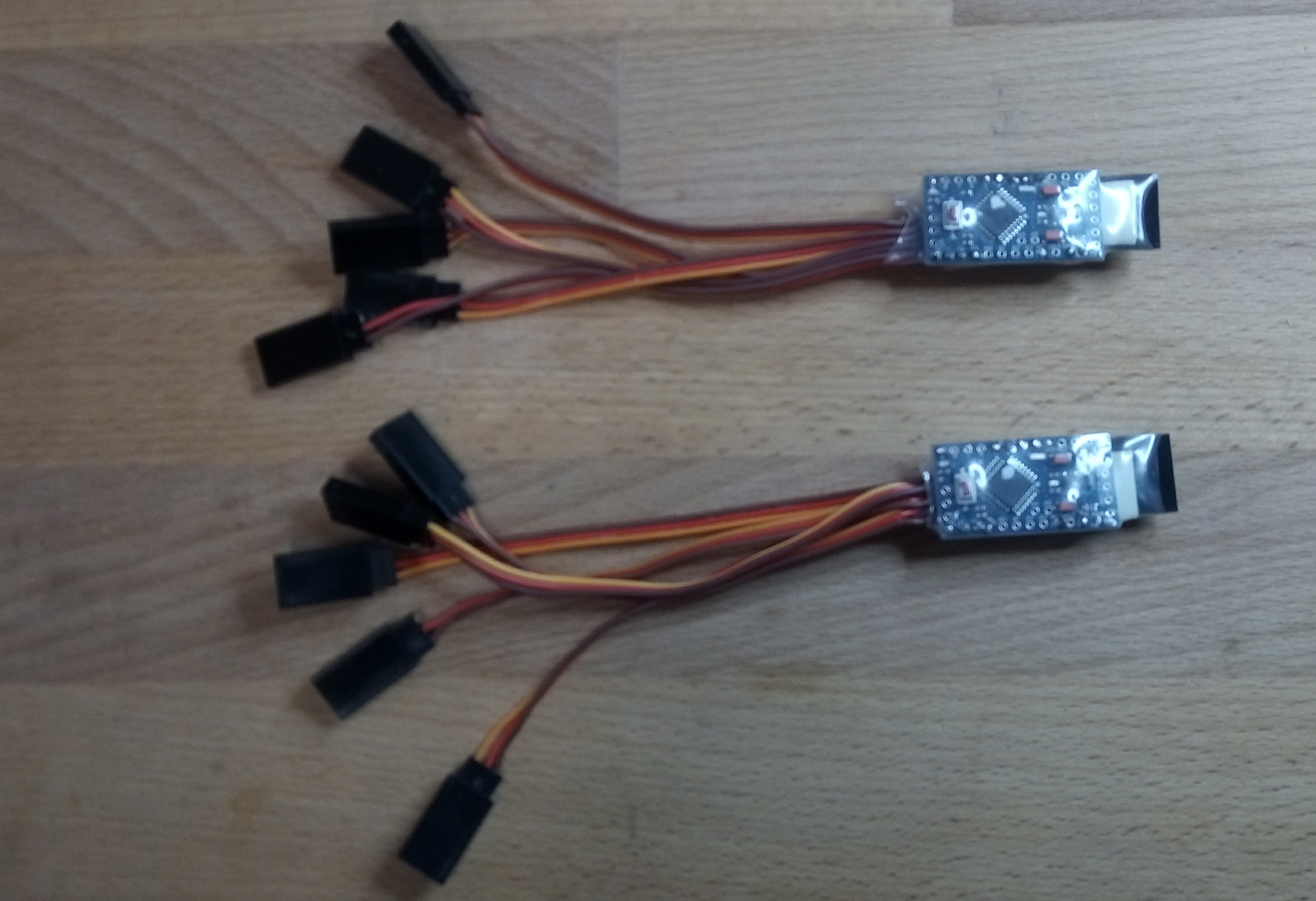

More receivers...
More receivers...
The blue heatshrink covers the five-into-one neg and pos bundles, aerial can be seen on the right
Receiver diagram
Receiver diagram

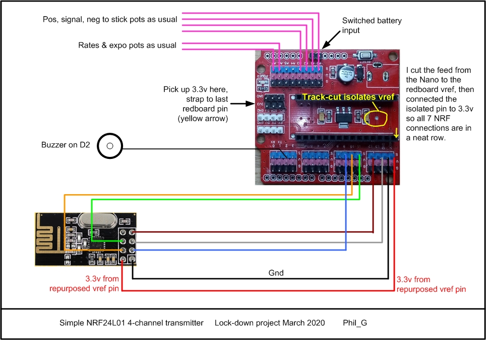

Transmitter diagram
Transmitter diagram
The remaining connections are similar to the "7ch+s/c" document but with the following pin assignments:
D2 is the DC buzzer
D3 is the minute minder button pin
D4 is the optional faster S/C escapement emulation pin
D5 is the 50:50 Vtail mixer
D6 is the 75:25 elevon mixer
D7 is the throttle-lock toggle
D8 is the pushbutton for s/c compound, & stick calibration

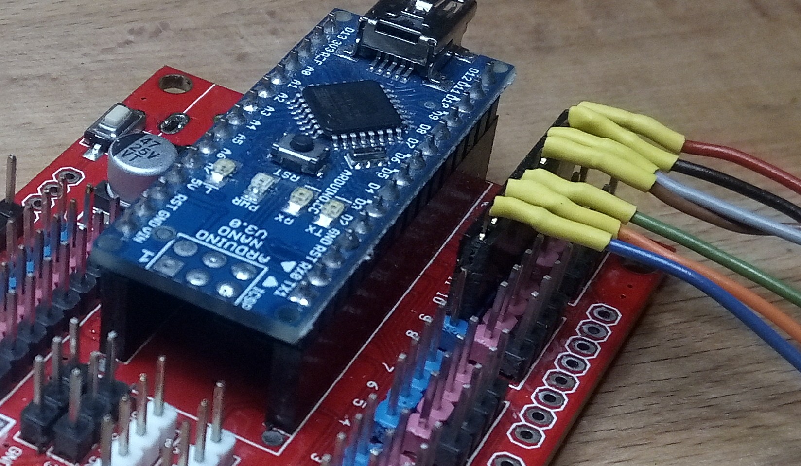

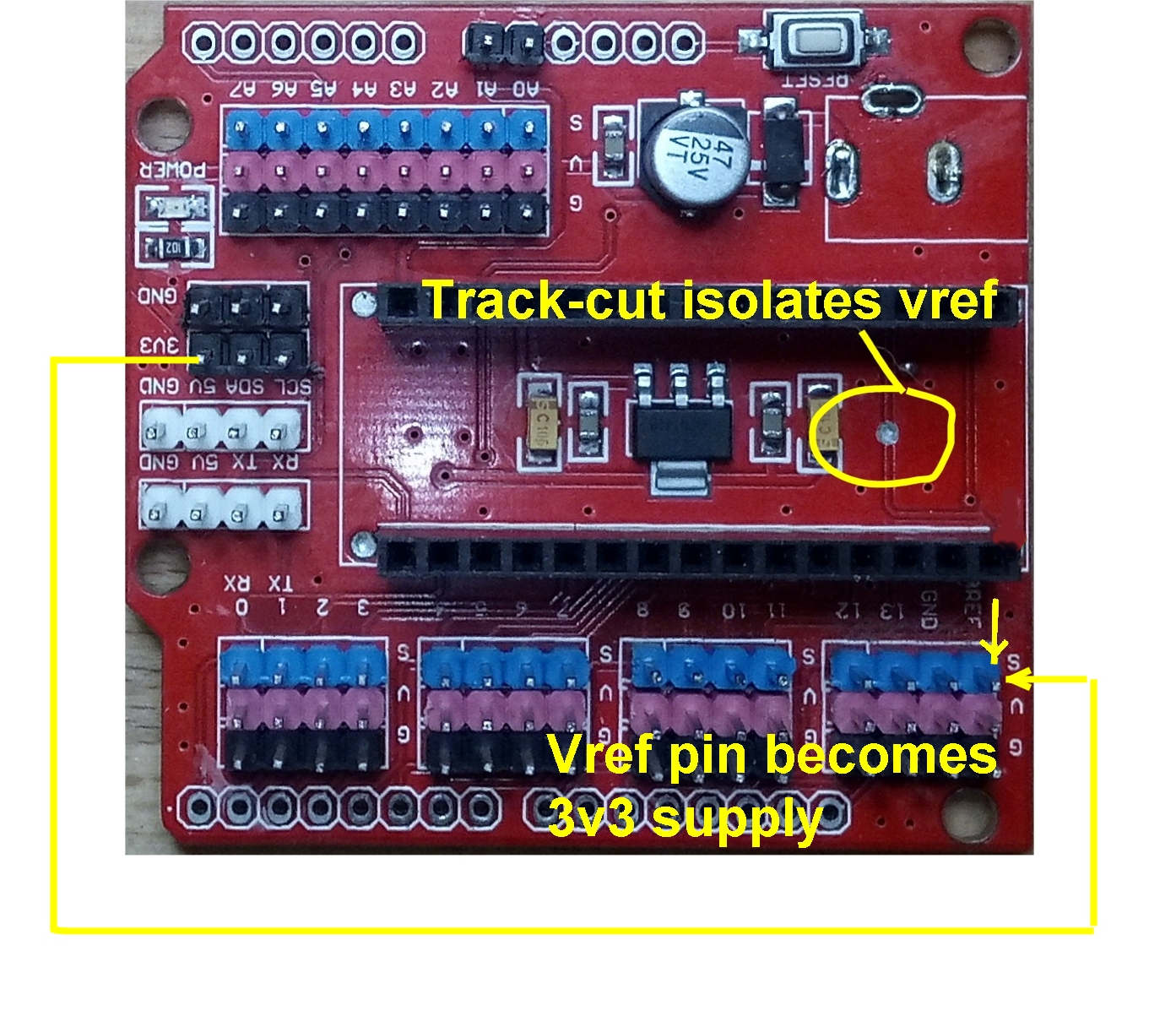

Any 328P board is suitable but for convenience I used an old ebay Redboard for the tranny, by isolating vref with a track-cut the vref pin was in a convenient place for 3.3v to the NRF24, so all its connections are in a row - I used a single 7-way header strip across the seven signal pins. On these headers the pos & neg rows are not used, just 3v3, gnd, and D9 to D13 signal pins:
Repurpose vref as a 3.3v supply to the NRF24
Just use the signal pins row, red at the far end is the repurposed vref pin, now supplying 3.3v to the RF board

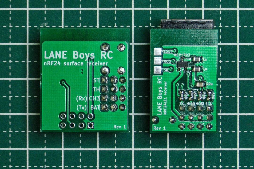

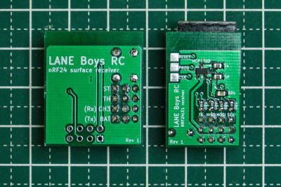

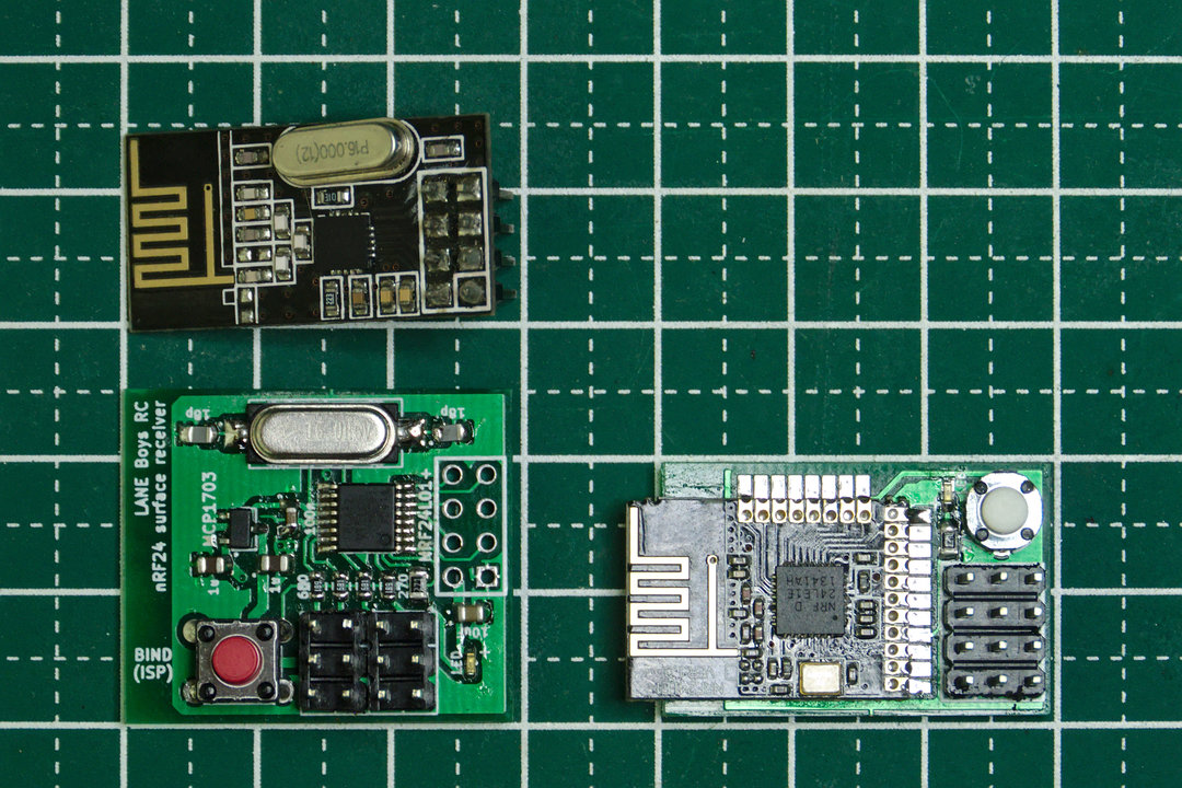

Some photos of my 4-channel receivers, one based on LPC812 MCU and the other one using nRF24LE1.
