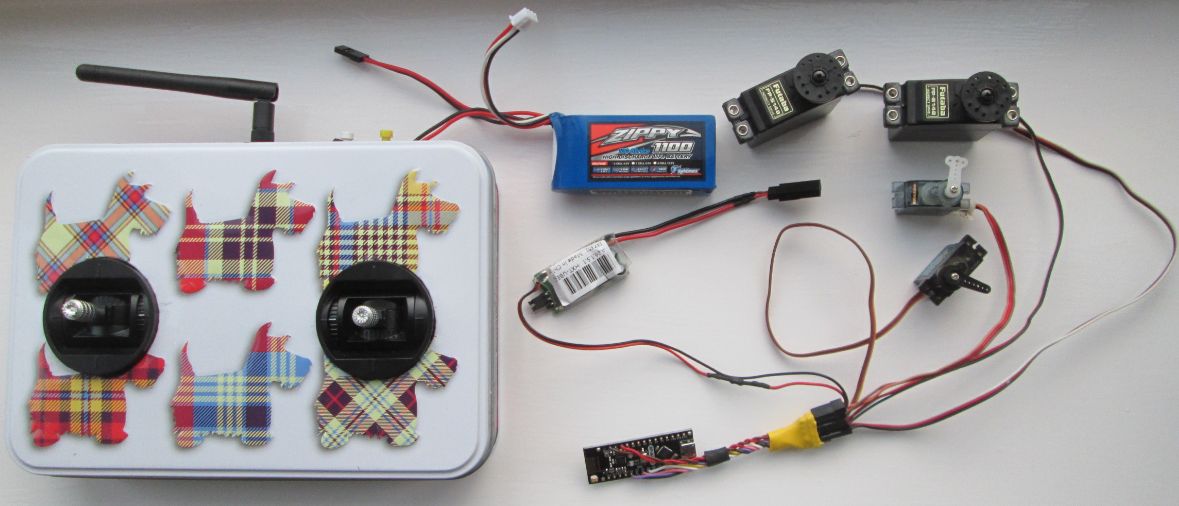

Finally I have a 4 channel NRF24 biscuit tin system that works. Tx straightforward although I found header pins are quick but unreliable. Rx was a big problem I used RF NANO code 1913CL set ce9 csn 10 which didn't work so changed to 10, 9 and vice versa 6 times to no avail. After hour here and there over three days I gave up. Today I wired up another RF NANO one with the u.fl aerial addition and connected two New Power XL-9HMB servos and of course jitters and no control. Then connected up a Dynam, Etronix micro to ch 1 & 2 all went well so connected up 2 Futaba 148's to 3 & 4 and they went jitterbugging. After cursing and messing with connections they worked, fantastic.
The New Power servos I tried again but no luck, anyone any ideas?

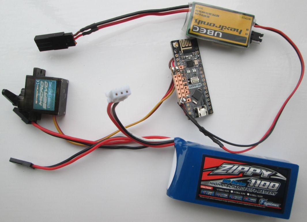

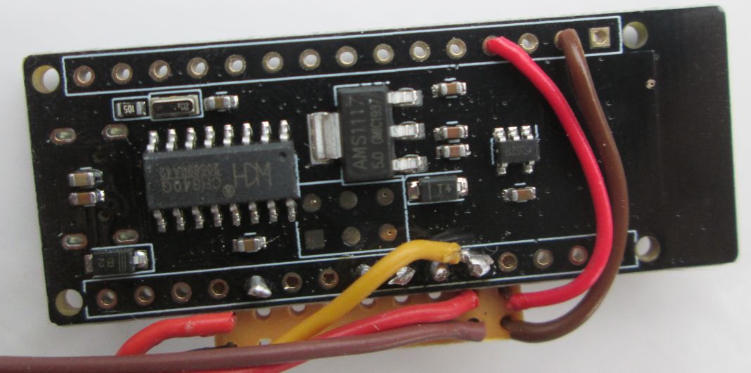

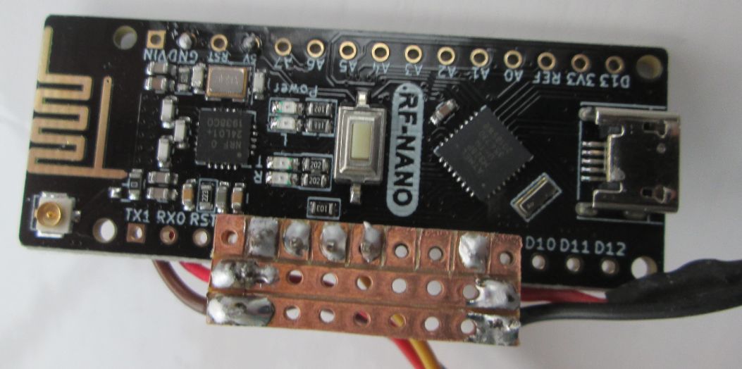

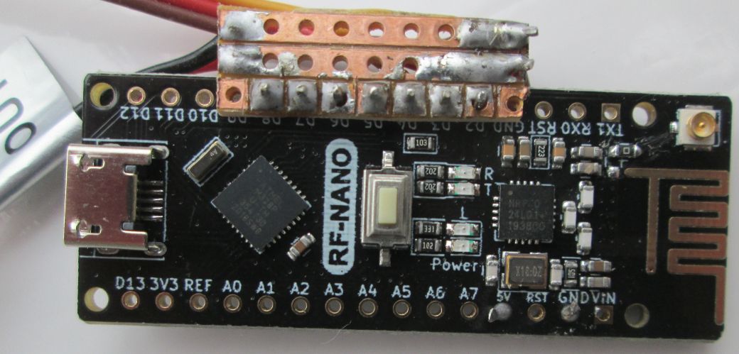

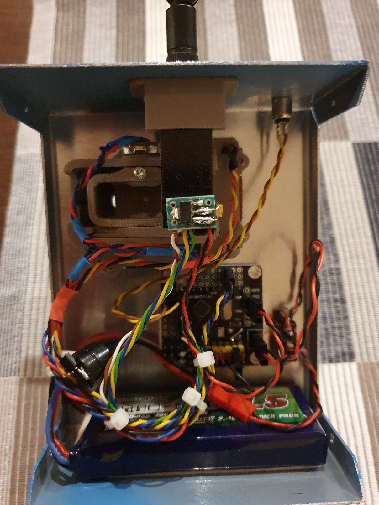

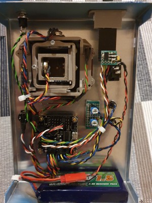

I'm back again. I had a think about the receiver, RF NANO board and all the connections for battery, UBEC, servos etc etc and came up with the idea of adding a piece of veriboard to the NANO. The system works although I only connected up one servo and yet to include the two capacitors. There may be short comings that I'm unaware of due to lack of electrickery knowledge. Photos show what I've done.
WernerL
Posts: 27
Joined: 22 Jan 2020, 02:30
Post by WernerL »
James wrote: 14 Feb 2021, 11:07 The system works although I only connected up one servo and yet to include the two capacitors. There may be short comings that I'm unaware of due to lack of electrickery knowledge.
That looks perfectly alright! What you have done with the Veriboard is exactly what is going on in a commercial receiver: + and - are routed through all the servo connections, and are tapped-off to feed the electronics.
cheers, Werner

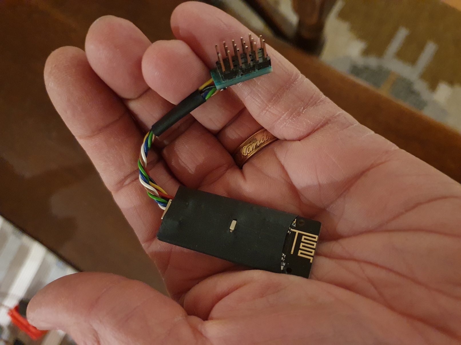

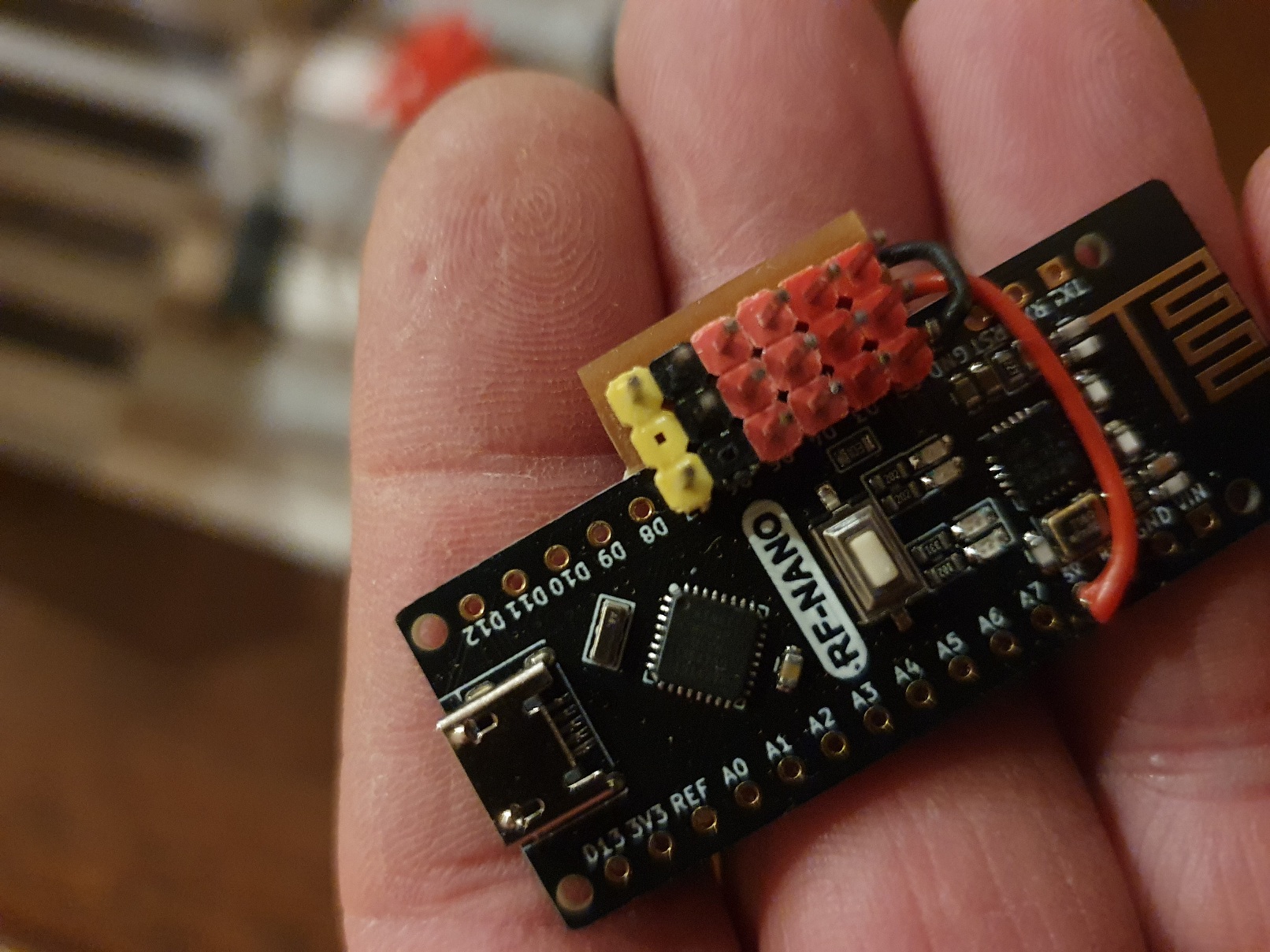

RF nano aerial any explanations please.
I won't bother with details of how I found this out but suffice to say I didn't switch the biscuit tin on.
Anyway point is I built another RF NANO receiver moved the 0 resistor to 90 degrees, see photo, picked up Tx and connected battery to the NANO twiddled the stick and nothing happened. I removed the aerial picked up Tx and again nothing happened this is when I realised my error fundamental mistake hadn't switched the Tx biscuit tin on. I switched on and with no co axial ufl aerial I still twiddled the stick and the servo responded perfectly. Next day I tried again at about 30m range and all worked (still no ufl aerial plugged in) I couldn't get any more distant but did walk around the front of my house (brick built) and everything still worked despite there being said house between me and the Rx.
I assumed that on re-positioning the resistor the "on board" aerial would not work. Is it perhaps a case that it does and when resistor is biased towards the ufl there are in fact two functioning aerials?
Hi James, the track leading from the NRF chip to the empty u.fl socket is sufficient to pick up a signal,
plus 2.4 is such a high frequency that even the tiniest capacitance across a open area of PCB will pass some RF.
Even the NRF chip itself, in its epoxy moulding, will accept RF at close range. Nothing wrong here :D

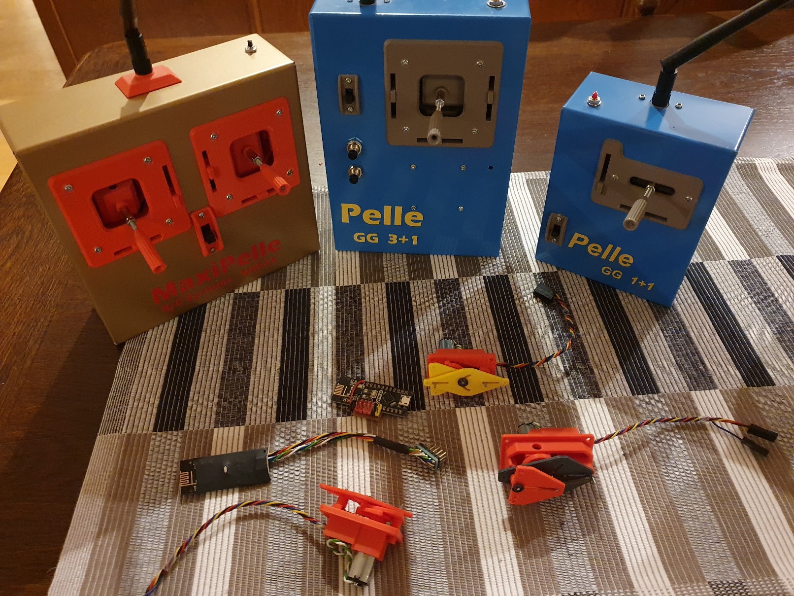

Posts: 716

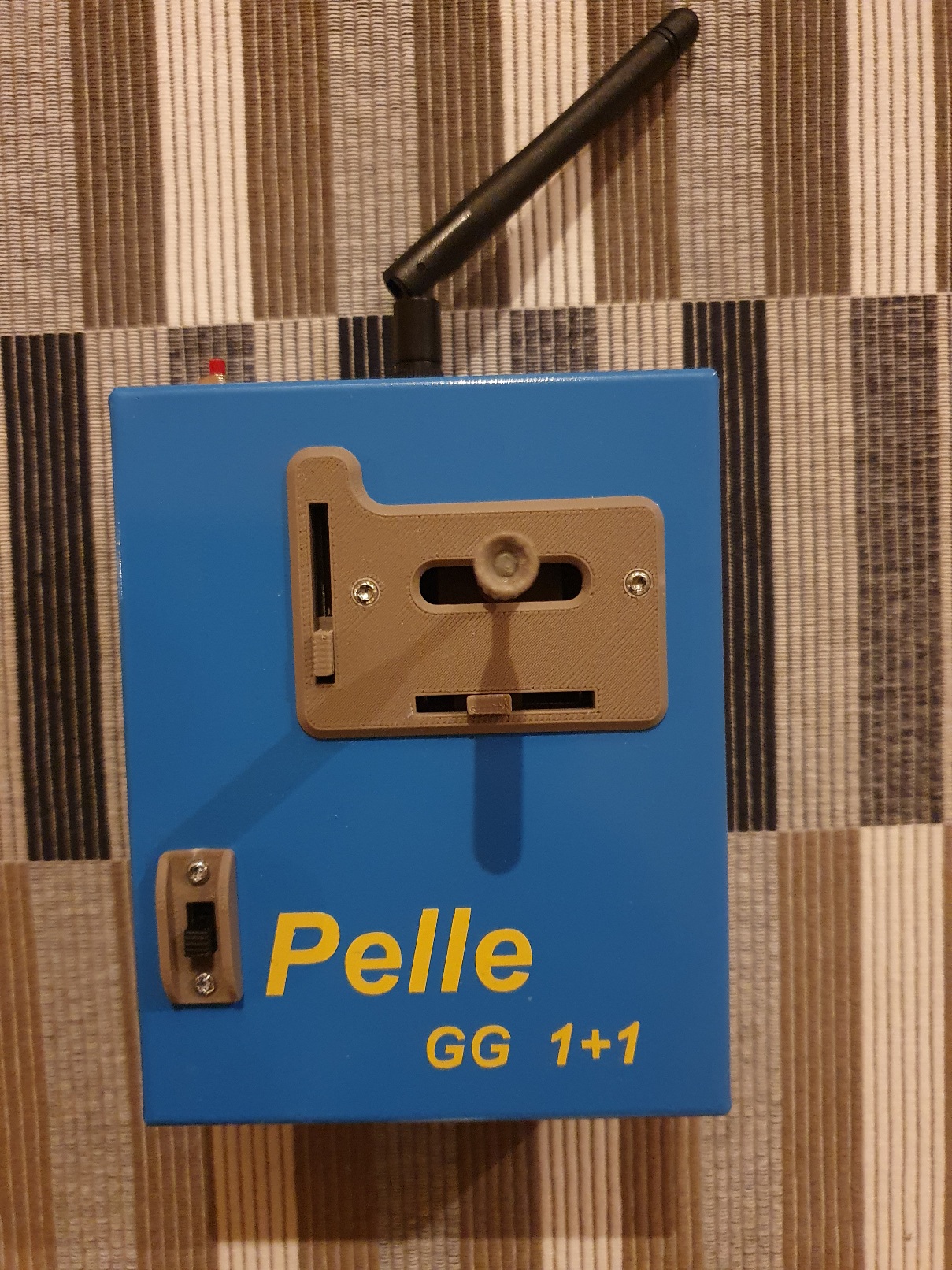

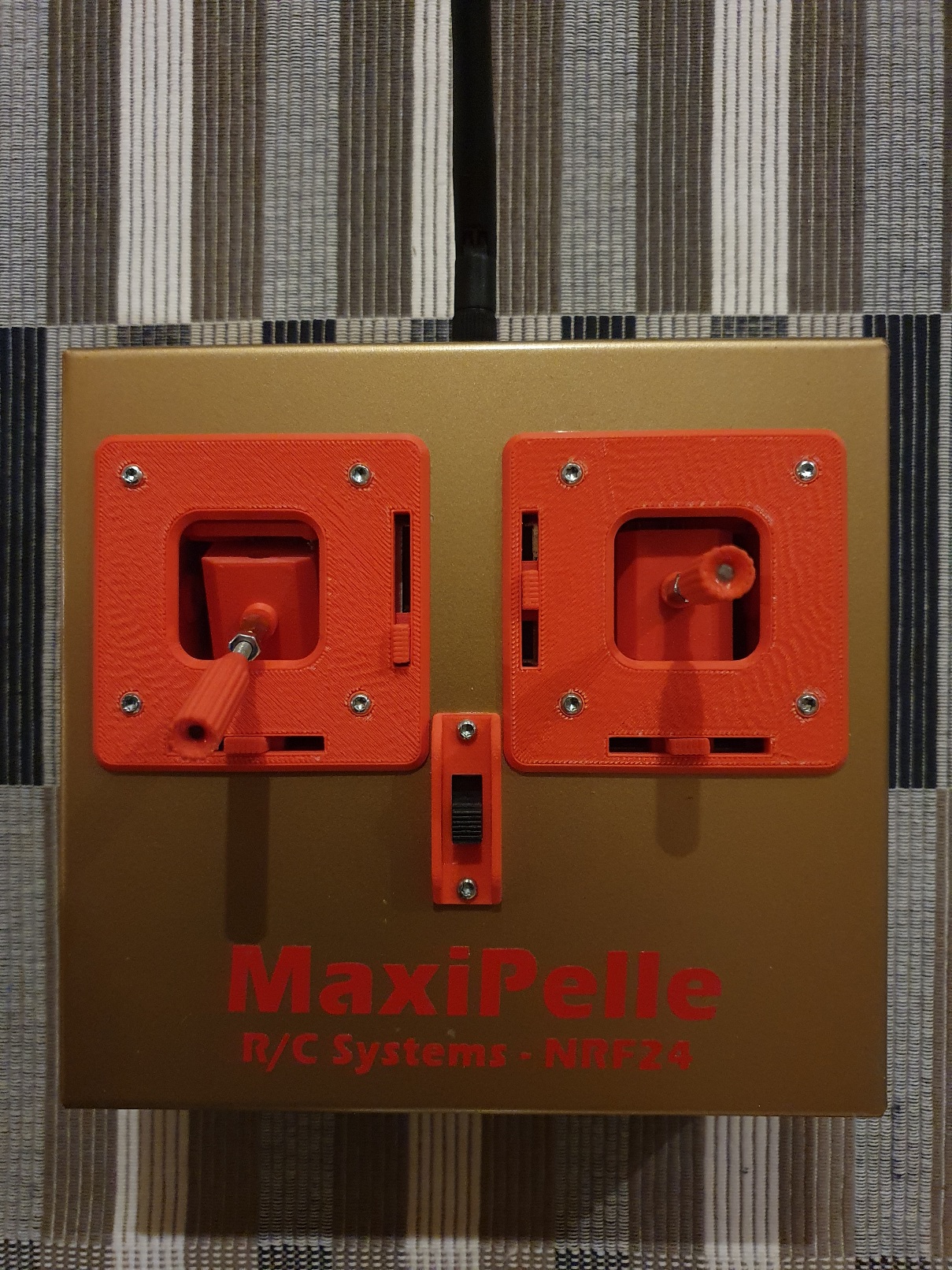

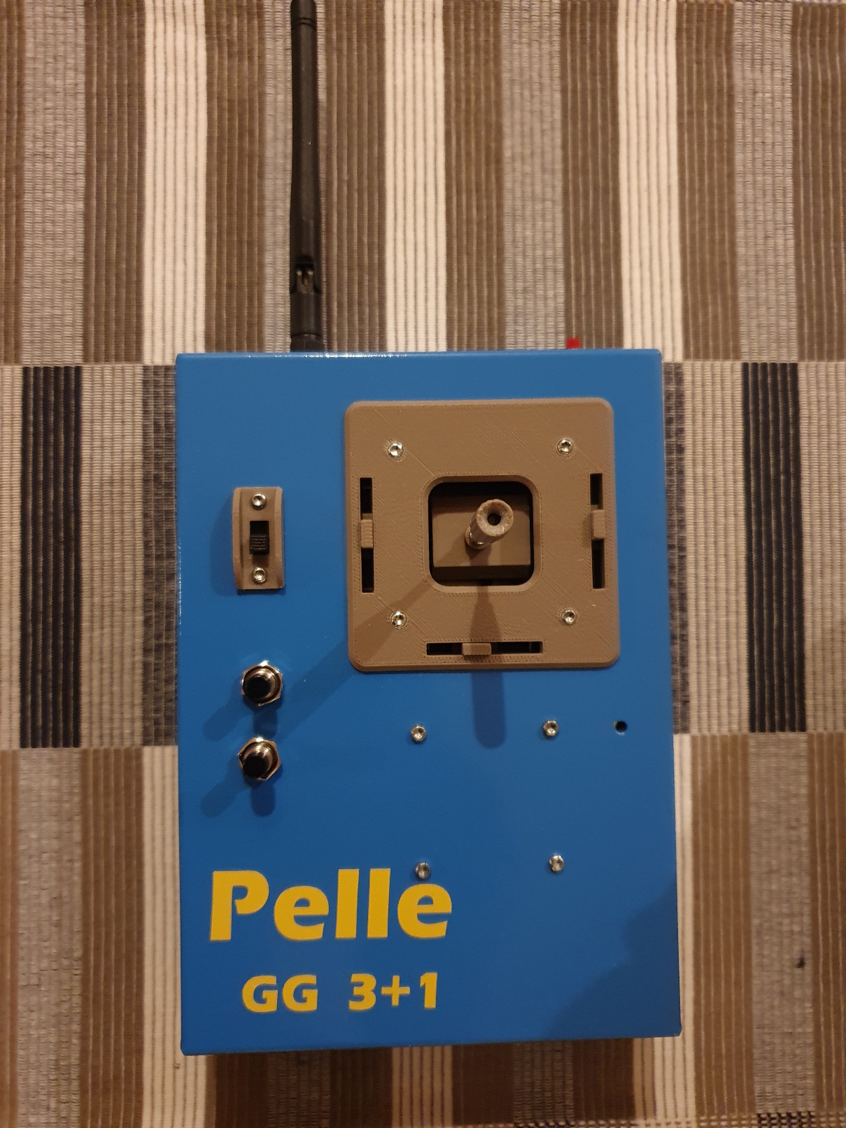

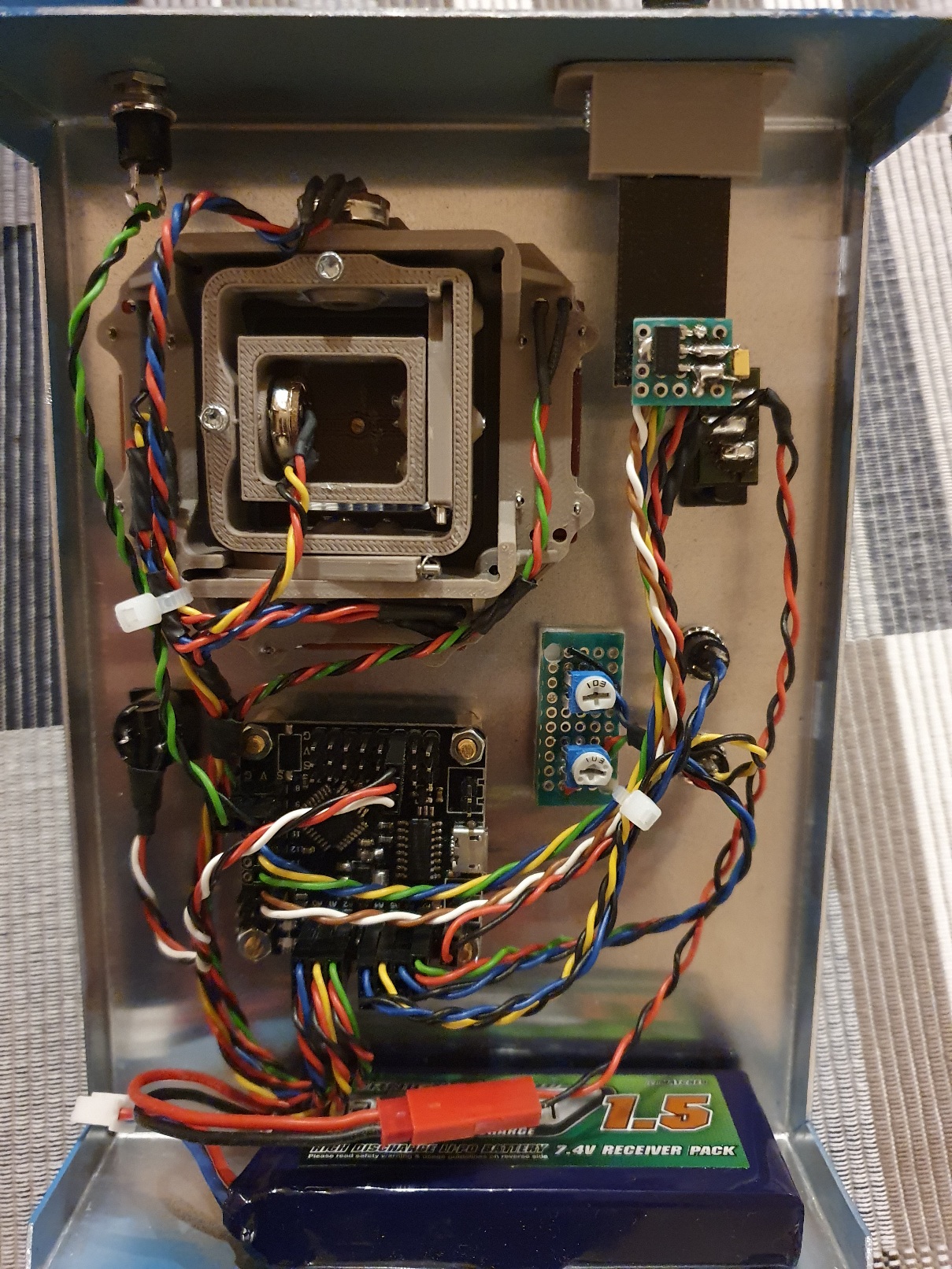

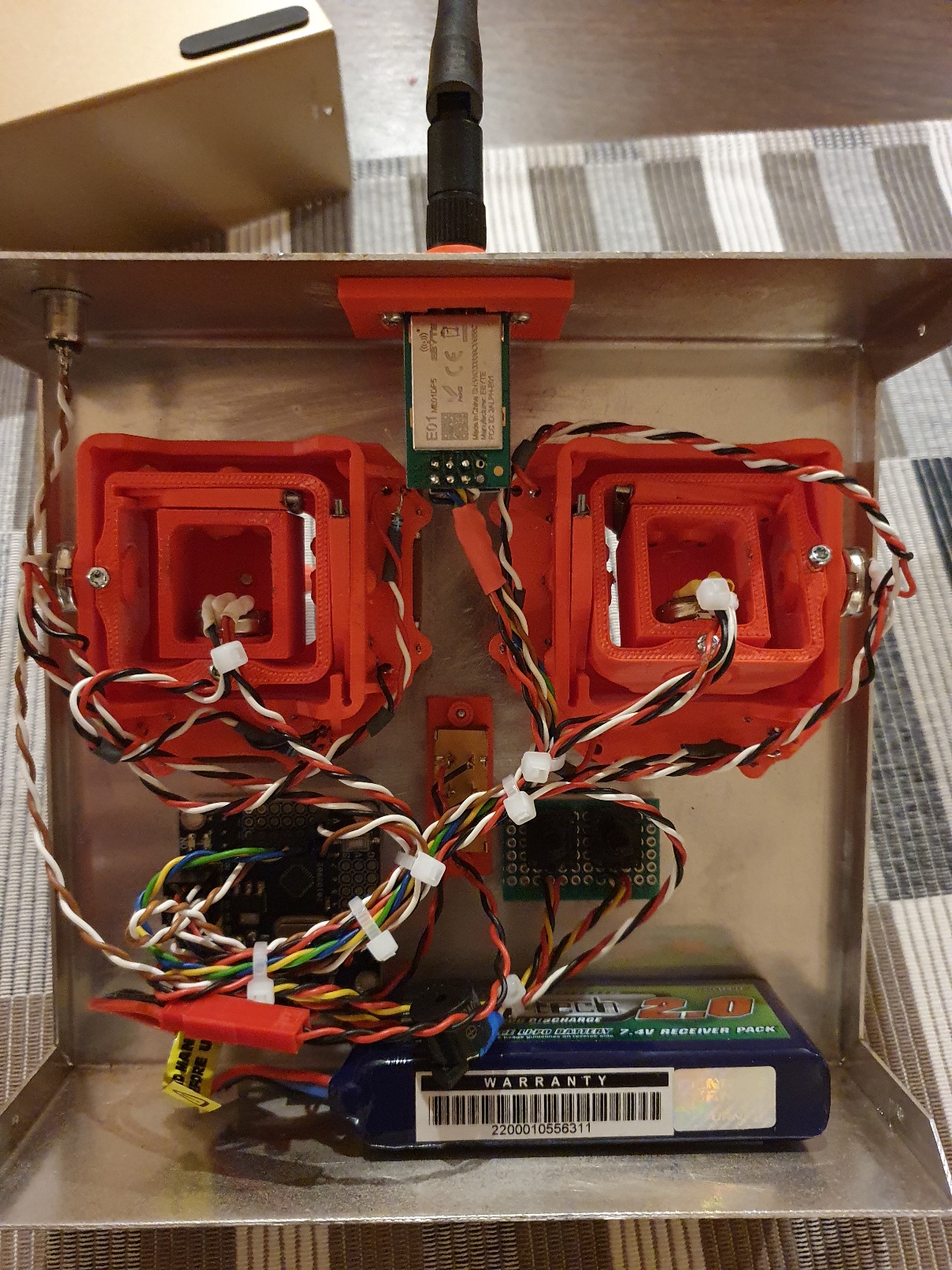

My NRF24-systems, as you might see I have left conversions behind for a full scratch built and yes, I fly with everyone of them w/o any problems also when flying on a frozen lake with temperature of -15 degC.
Top of the line we have my 1+1 - rudder & throttle
Second my GG set 3+1, rudder, elevator with the option of sequential or proportional throttle
Last for the moment my full house set dual stik .
I have included also a few of my actuators and Rx.
