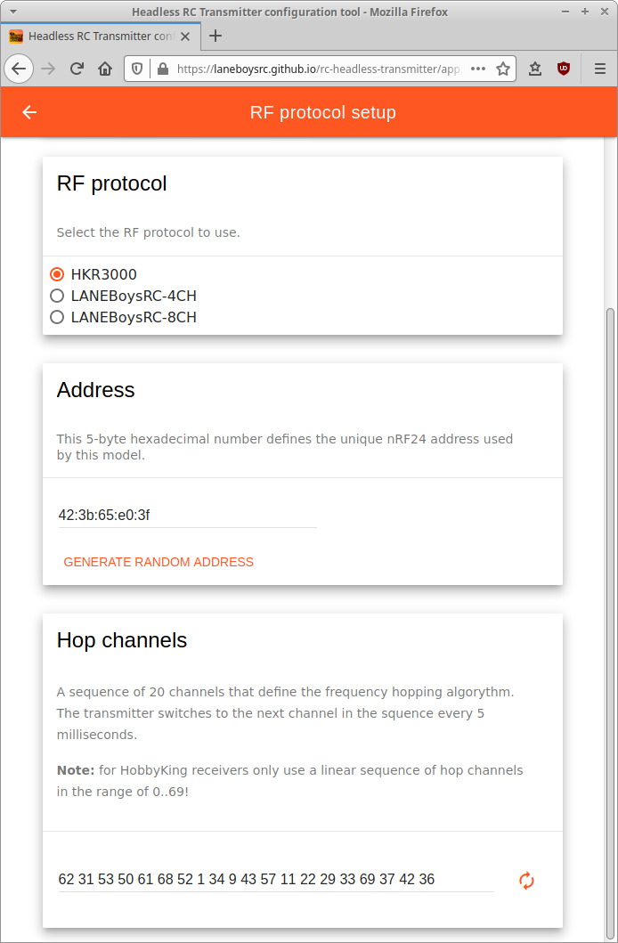

Attached is a full description of the reverse engineered protocol of a commercial nRF24 based RC system (hkr3000-info.md, opens in any text editor).
cheers, Werner
hkr3000-info.zip
(2.35 KiB) Downloaded 606 times

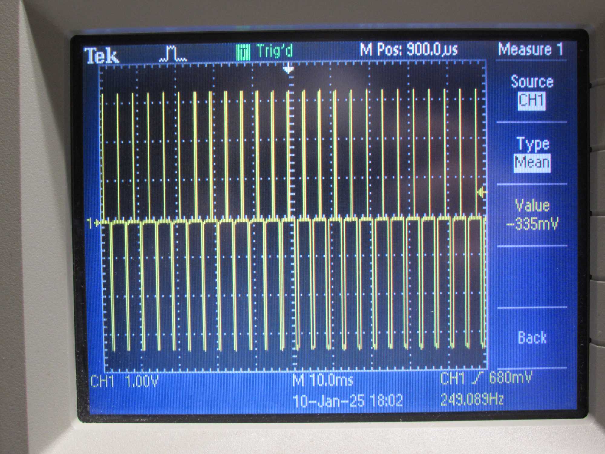

Well, my humble first attempt kinda works but as yet its not syncing properly. I'm posting this in the hopes that writing it down might kick my fuddled brain into gear.
The transmitter is fine, spot on 5ms packets sequenced over 16 FHSS channels.
The receiver code is giving me the runaround. I'm sure I have a flaw in the sequence, but I've worked through it a gazillion times and I cant see it. But tomorrows another day. Hopefully the answer might wake me up at 3:30am as these problems tend to do!
Basically I followed Werners text description in the previous post.
I've a 6ms timer interrupt which sets a timeout flag. With perfect reception the 6ms should never timeout. If it does, we've missed a packet so we switch to a 5ms timeout and carry on hopping.
If we miss 6 packets we restart from the first channel, and if we miss 200 it goes to failsafe.
Visually the set works fine, no servo jitters and instant response, failsafe works, but somethings not right...

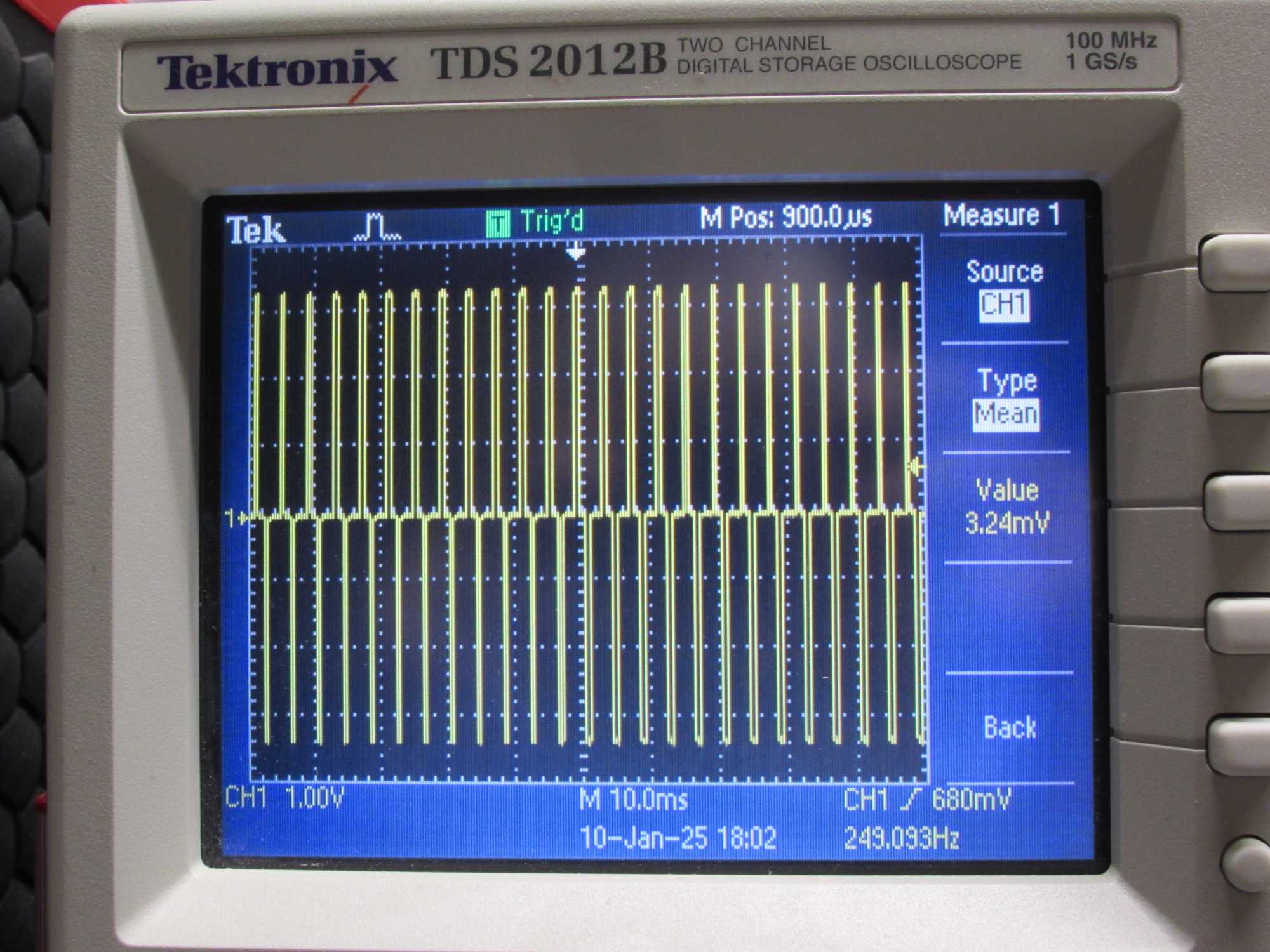

For testing, I've put a bit-flip on D7 in the packet-receive section, for my scope, where I'd expect to see alternating 5ms high, 5ms low, with an occasional glitch expected when a packet was missed and the hopping was resyncing.
What I actually see is a 5ms high followed by 80ms of low, which indicates two packets received then it has a bit of a lie down, then two more...
I have it set up for 16 FHSS channels, which is where the 80ms is coming from, 5ms per channel. Which makes me think its either restarting constantly, or sitting on one channel and catching every 16th packet.
The servo drive is commented out in case its upsetting the timing - but makes no difference in or out.

I've been twiddling sticks for over an hour with the NRF receiver surrounded by as many other transmitters as I could find, including two FASST, a few Frskys, two Oranges, and a Flysky, all on full power whilst the NRF transmitter is set to minimum RF power, and no glitches, stuttering or delays - perfect :D
The scope now shows packets every 5ms with an occasional one or two missing as you'd expect.
Range on the very lowest power setting seems to be about 30 - 40 yards, beyond that failsafe kicks in. Walking back it hooks up again at about the same distance. This is using the low-power integrated PCB antenna modules for both tx and rx, with a high power module I expect the range to be as good as any.
