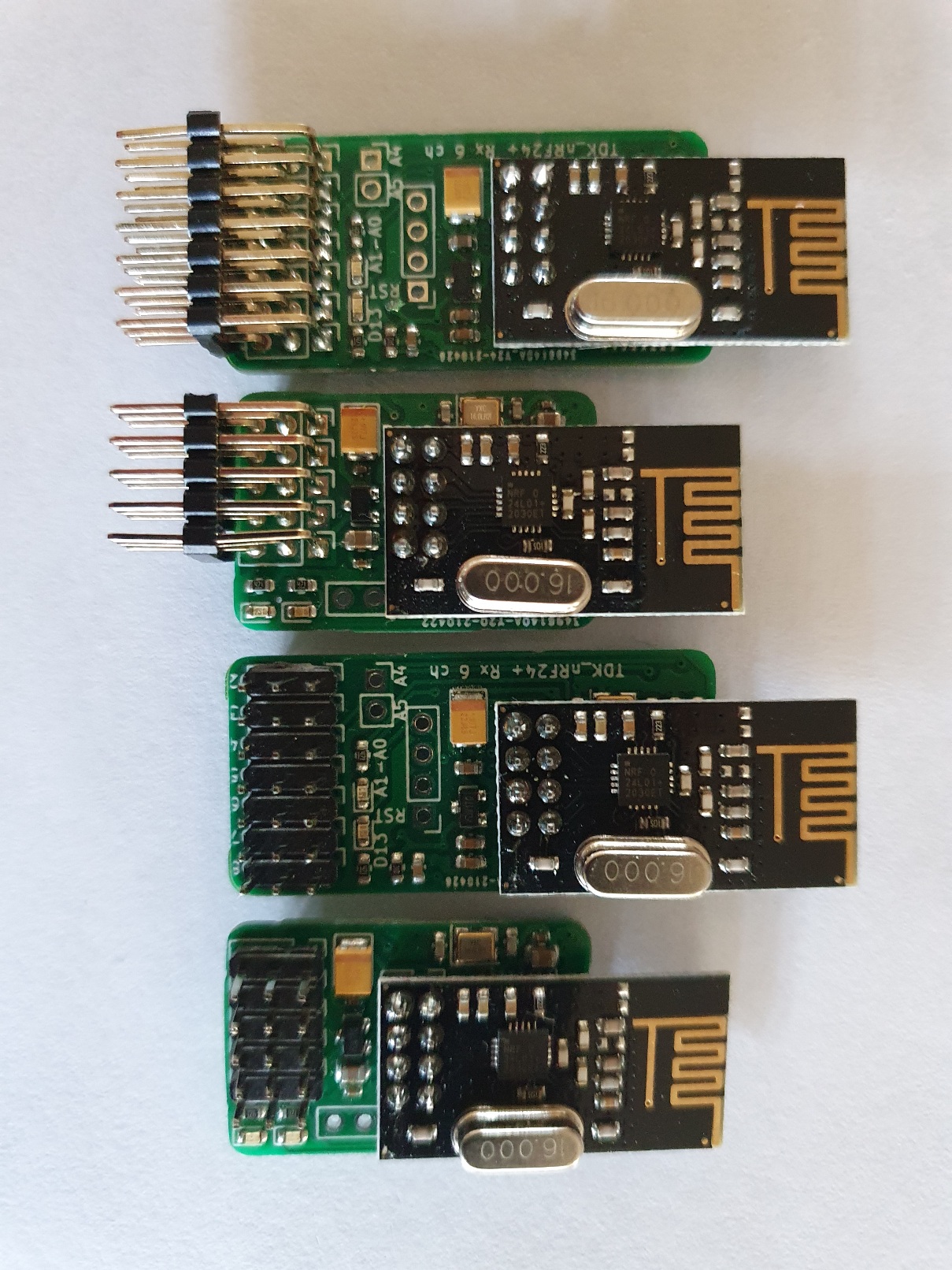

- Posts: 716

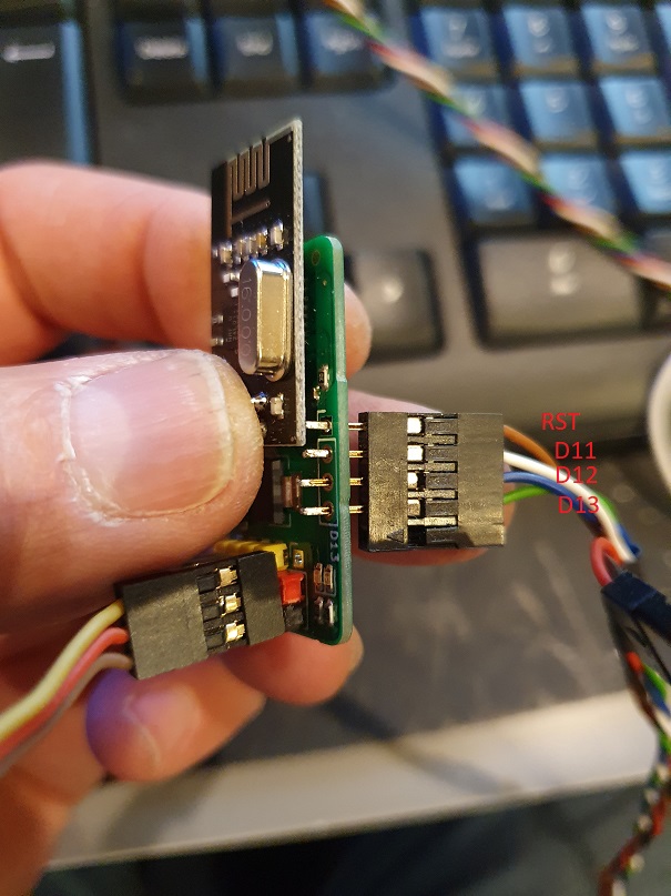

There are a few nRF24 Rx and nRF24 Tx pcb's of my design available so for those of you that might be interested please PM. They are at cost plus S&H
They runs straight forward with Phil's nRF24 project and here comes a pic in how to connect your USBASP to the Rx as the Tx has regular ICSP.

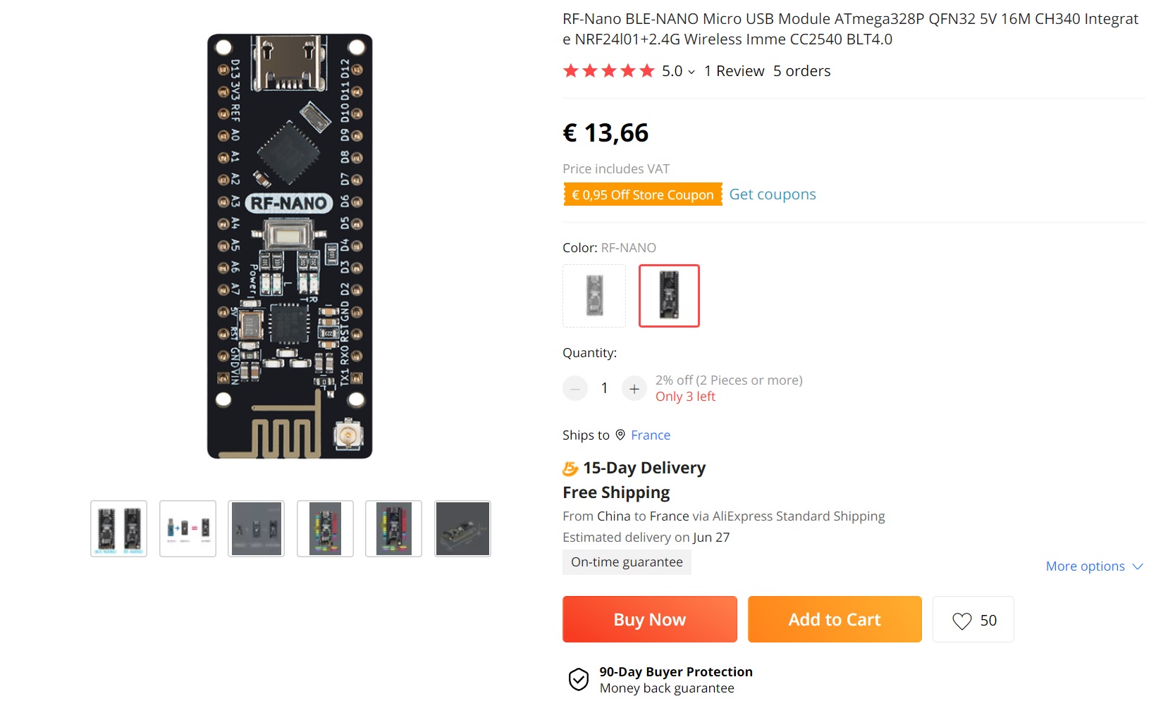

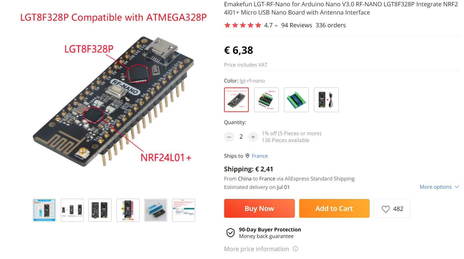

Hi all.. a bit late to this party so please excuse if I'm behind the curve.
The RF-Nanos you are using for this project - are they 328p RF-Nanos or LGT8F328P RF-Nanos?
https://www.aliexpress.com/item/1005003745213152.html As you can see there is quite a price differential.
Some info on the LGT8F328P https://sites.google.com/site/ericmklau ... uino-clone
