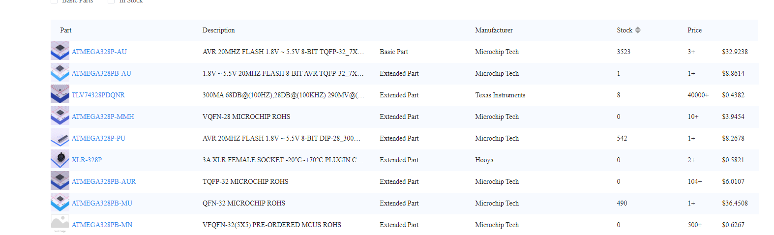

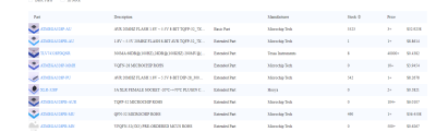

One important point in this discussion is that we don't always need a 328P for our projects I.e. we don't need that amount of memory and a 168P works as good and it's cheaper and believe it or not also available at a more sensible price. I often order my PCB's with everything on except the processor and solder by hand what ever I need for the purpouse.
A 328P had times when the price tag was well above $ 50 and not always available, last time I checked it was around $32 but available.

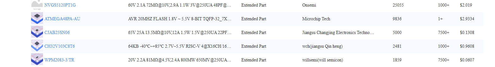

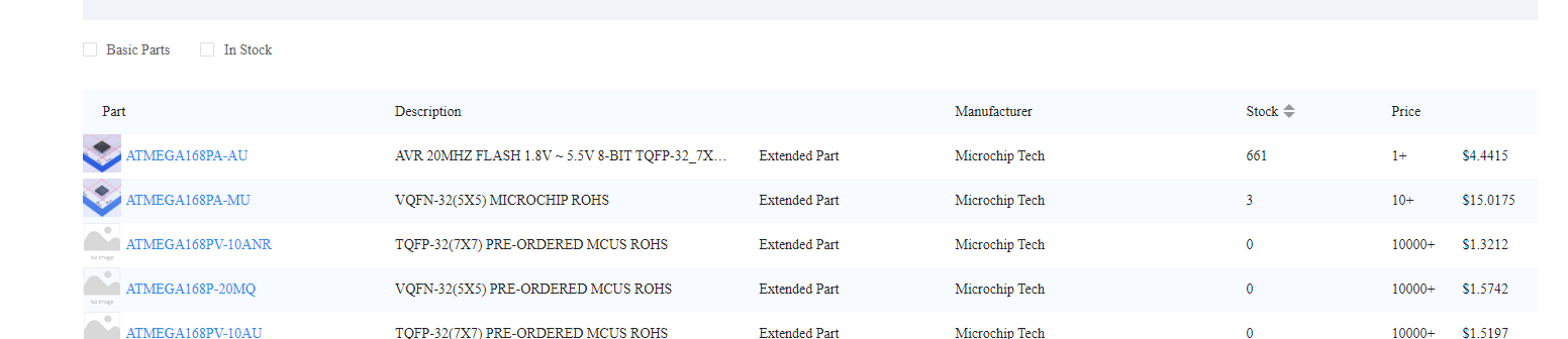

168P is available in the range of $ 2-3 as also the 48P.

In the nRF24 Rx the 168P does the job as the 48P in the servo amplifier.
