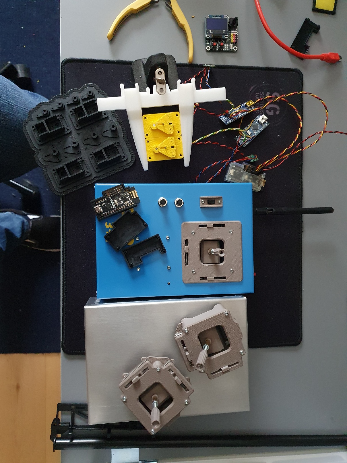

The Tx and Rx are from my GG set-up based on Phils NRF24 project and both are flown with my GG-actuators. Some more tinkering and those 2 servo will be also flown.
Here are a few bits and pieces!

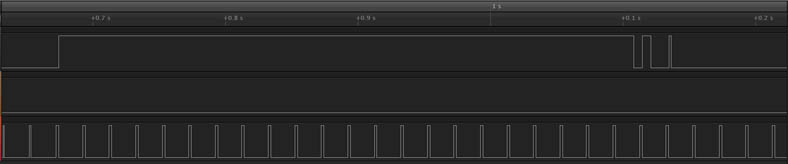

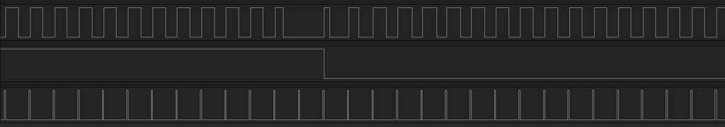

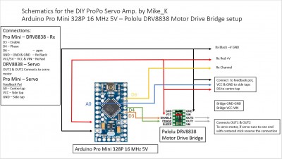

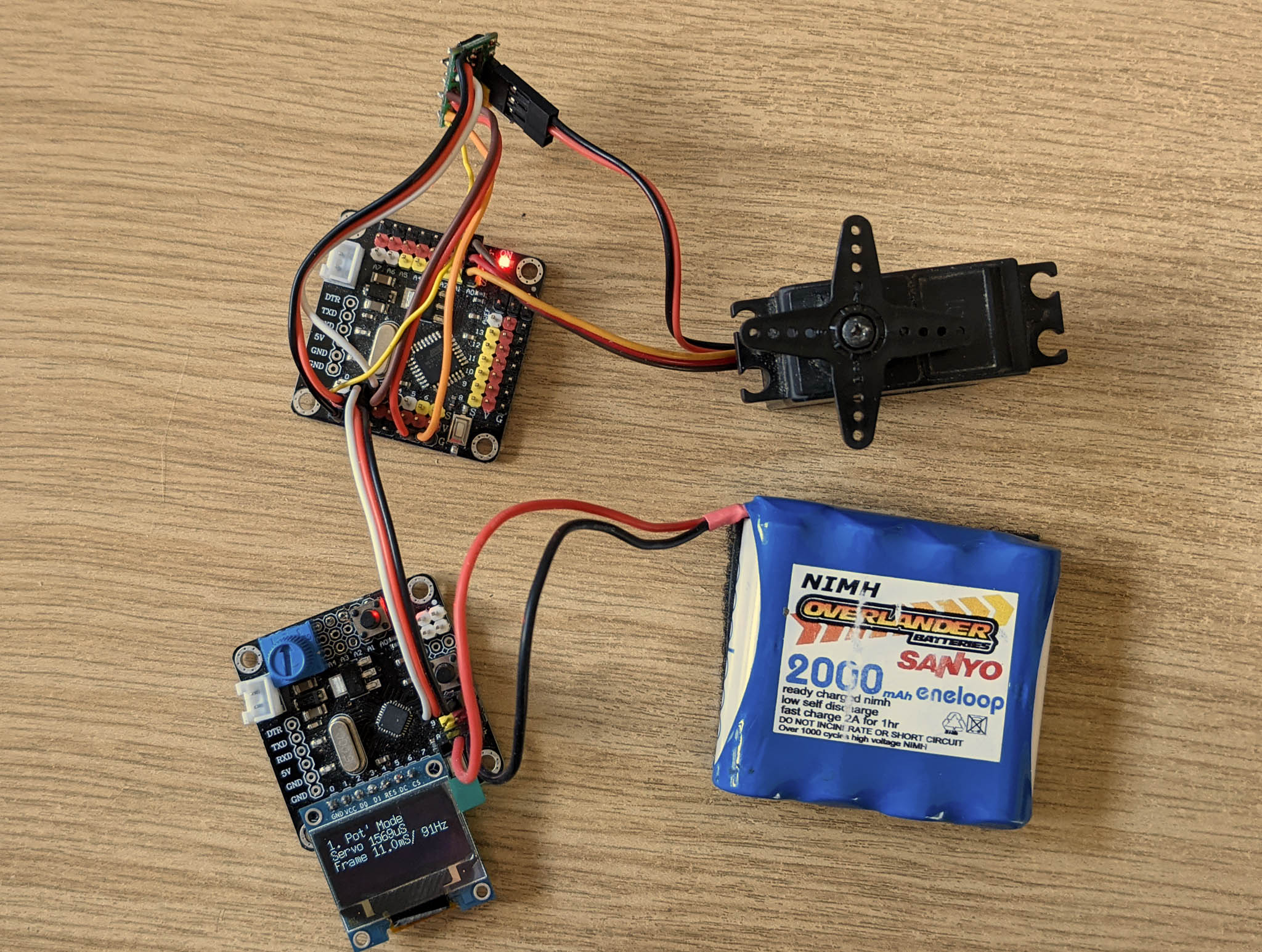

Another part to Tobe's DIY propo servo, an amplifier based on an Arduino and a DRV8838 (or DRV8835).
I've got it working quite nicely with an old Futaba S3001 and a Hitec HS-311. I was going to try PID control but as is my normal practice at work, I started with just the Kp (proportional gain) and a dead band and the result is as good as the original Futaba or Hitec servo amp, so there seems little point in adding the integral or derivative part of the equation. In fact with a dead-band, an integral term wouldn't work and would just "wind-up", but I might add the Kd term later to see if I can increase the Kp gain further. I've tested it with frame rates between 11mS and 25mS and it seems happy with any rate in that range. The plan is to get this program working on an ATtiny85, so it will fit Tobe's servo

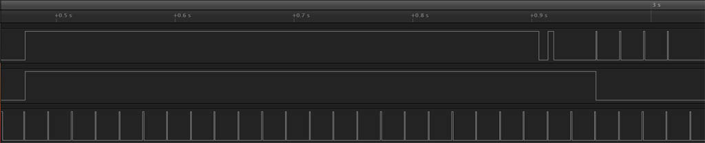

To get the gain correct I did a series of tests measuring the outputs to the DRV8838 with a logic analyser, the top trace is motor enable, with it high the motor runs, the second trace is the Phase, HIGH it goes one direction, LOW the other direction and finally the ppm going to the Arduino.
And I did a few runs with a servo tester in "cycle mode" where it goes from 1mS to 2mS and then back repeatedly. Below is the trace with the servo going end-to-end in one second. Here you can see the servo is never far from its intended position, so the motor runs pulsed (at the 20mS frame rate in this case). The servo was easy to modify, just unsolder the motor and pot from the original circuit board. I used my own servo tester (another project to write up for this site one day) and a time-expired battery! And a short video clip of the servo being operated on the bench
**Edit. I've updated the servo amp program/sketch to include a neutral adjustment**

- Posts: 769
Re: The ProPo project, a DIY proportional servo
Tobe, that is a fantastic achievement.
A home designed and built transmitter case, joysticks, a Phil encoder, 2.4GHz module and Rx and now home designed and built servos. Not many people have designed and built a complete proportional system even in the "good old days" and I expect you're the first to do it in the 2.4GHz era. Even a lot of the USA and European manufacturers didn't design their own joysticks (think of all those using Kraft Hayes or an SLM/Skyleader joystick in the UK). And even fewer designed their own servos, most just bought those in.
A few of my encoders will be in the post shortly, then you can have a complete home designed and built computer transmitter with LCD display and model memories etc.

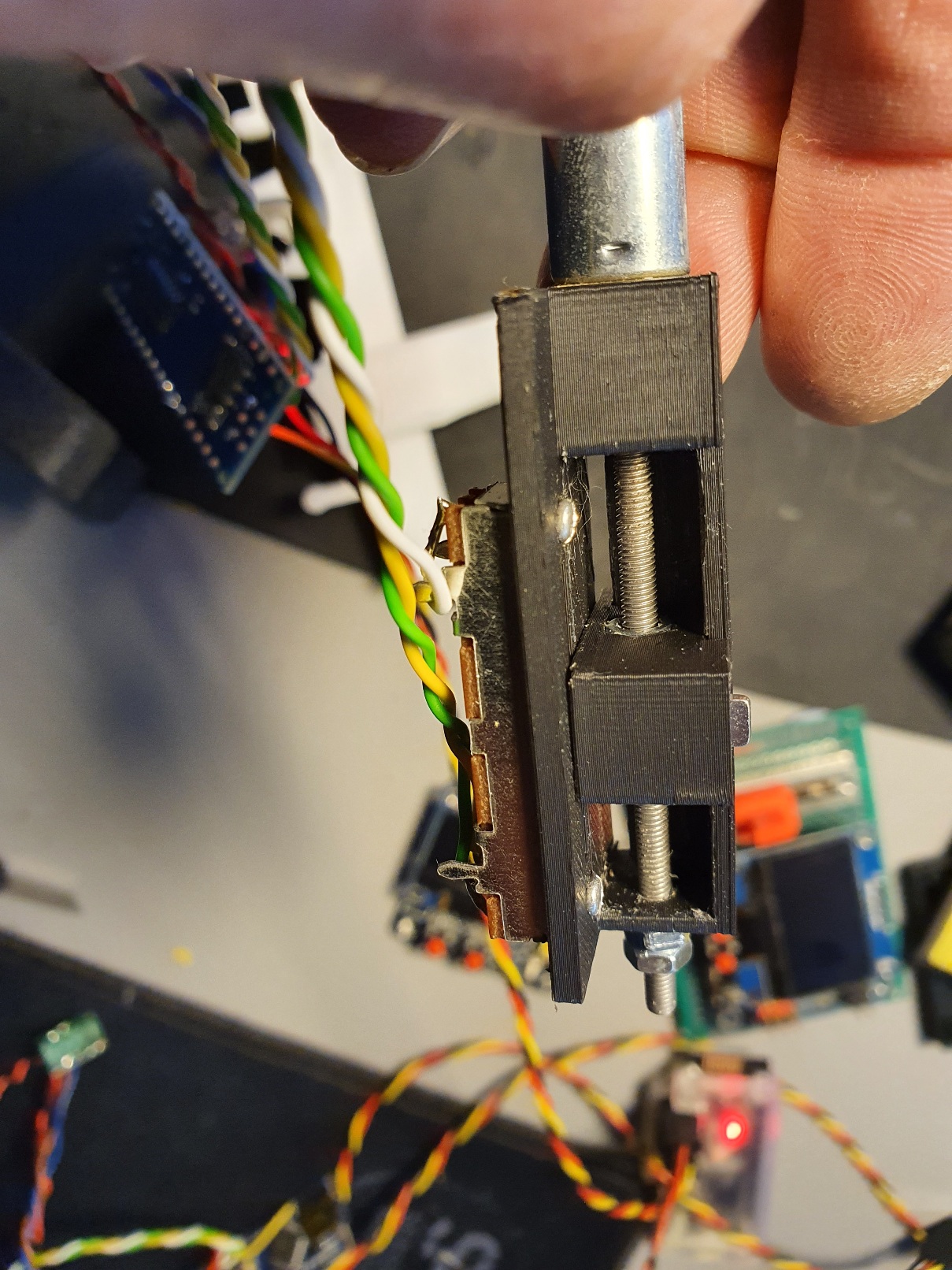

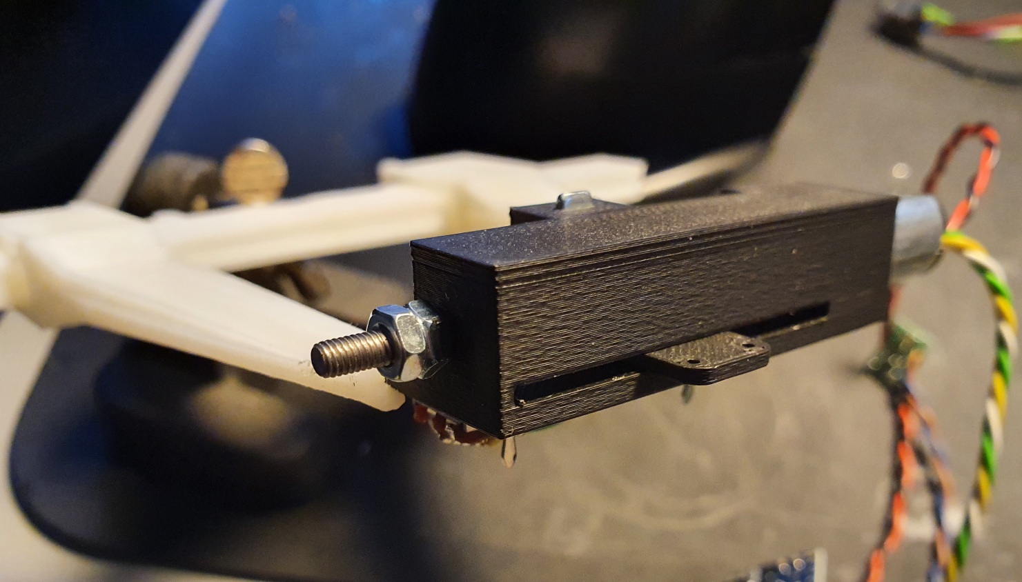

This one is for you Martin!

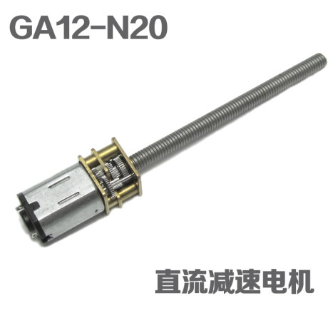

I just played around with what I had available at home, a motor gearbox running a M3 at 1000 rpm, a linear pot(the same I use in my stick as trim 5K) and Mike's amp.
There is no backlash as I have 2 M3 nuts against each others in the in the slider.

I'd also thought of using a linear pot & worm drive ala the small linear servos coming out of China - I have 4 or 5 in a grab bag of old multiplex parts only 2500klm away
I reckon they are physically about 10% larger than the ones you have used.
Are you using any gear reduction between motor & worm drive? If so, what ratio?

The GA2-N20 comes in different configuration so I just took what I had handy.Wayne_H wrote: 12 Mar 2021, 08:32
To avoid backlash I have 2 M3 nuts positioned against each other so there is no play

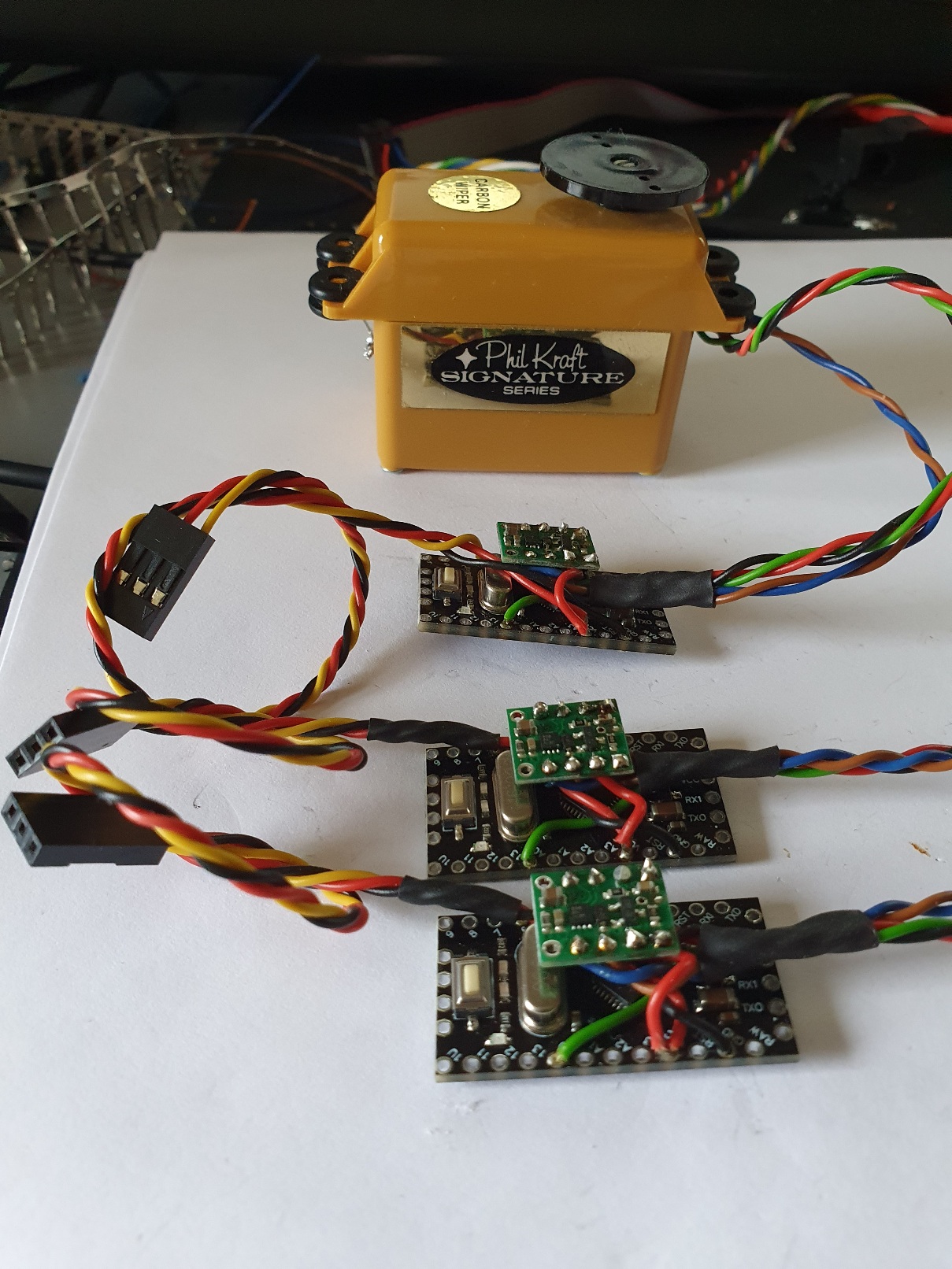

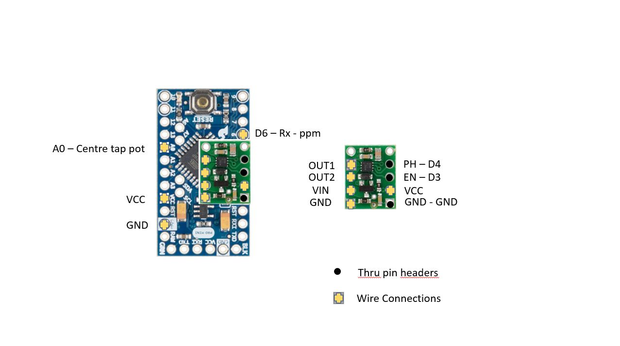

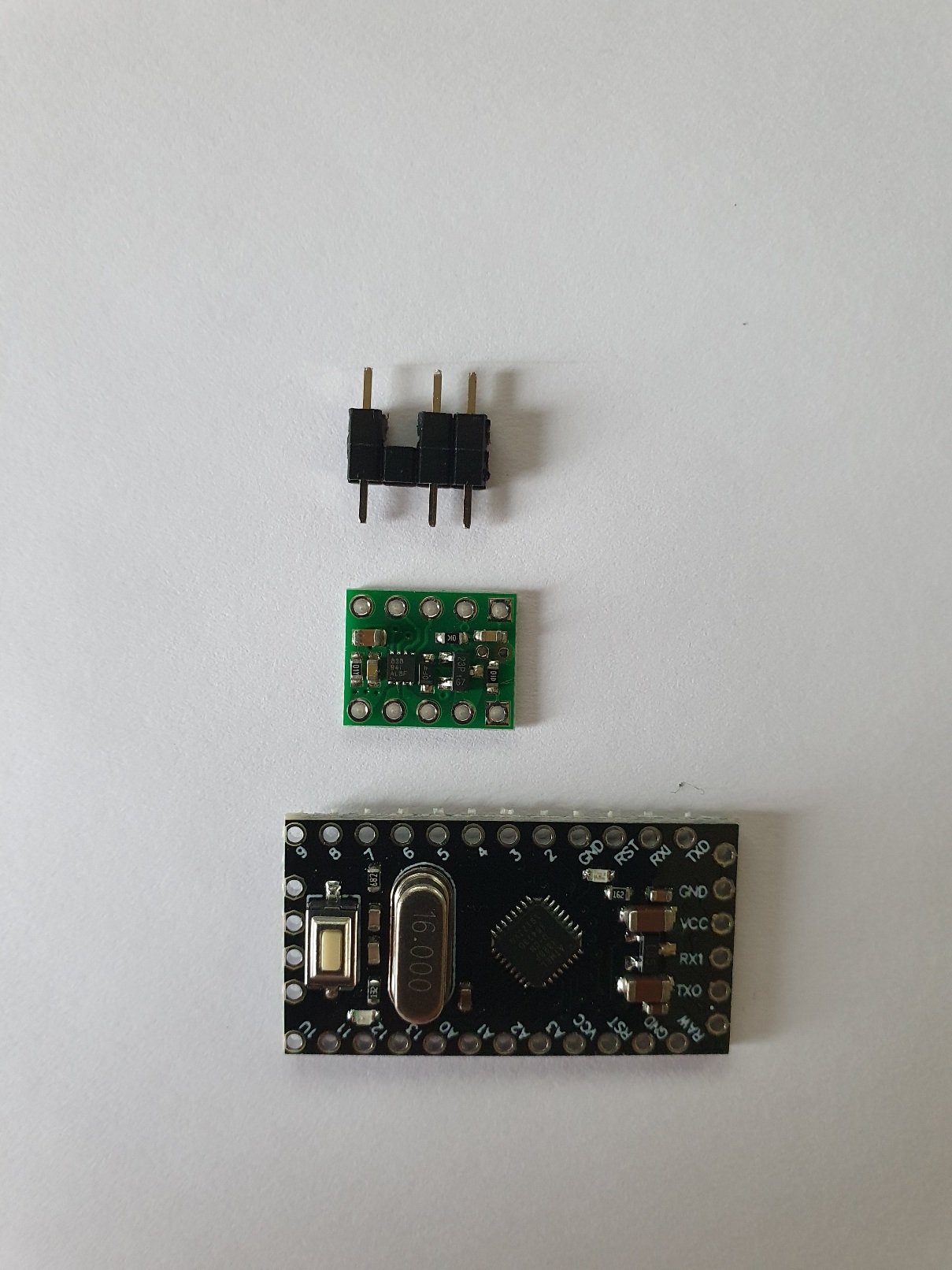

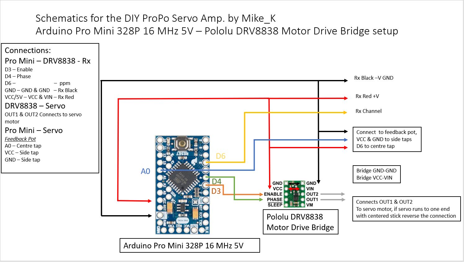

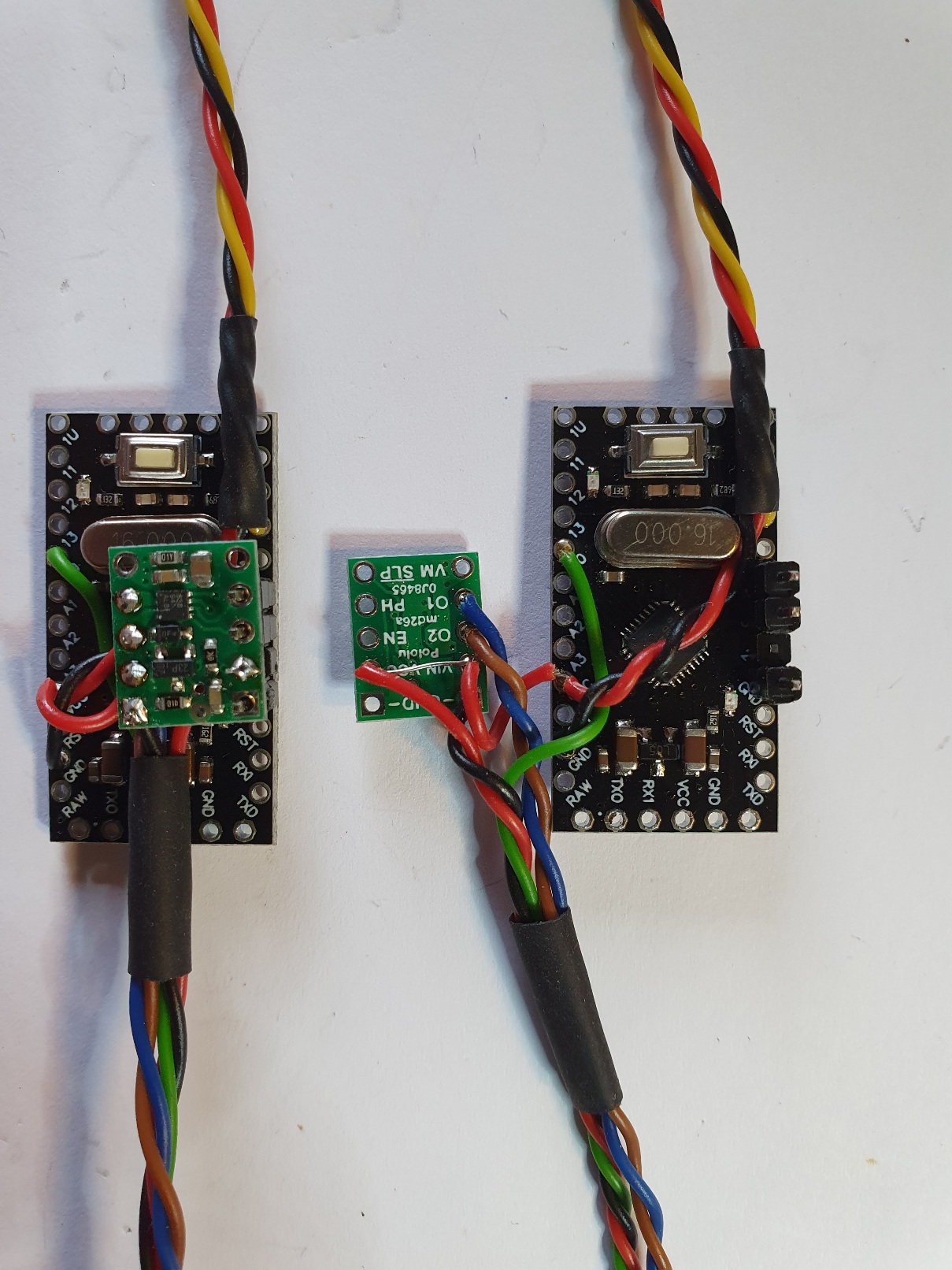

Here comes my way to build the Mike Amp. first we have to realize that this Mike Amp. is probable more sophisticated than the one used commercially as it's fully programmable and can be adapt to almost any servo.
This picture shows necessary components, a DRV8838, an Arduino Pro Mini board and my "custom made stacking board connectors". ...and here I'm showing the wires connected to the 2 boards before and after mating.
To do this I have moved the ppmin from 2 to 6. I have also included my settings for the DIY

This is how I build them and allows me to stack the DRV8838 on top of the Arduino. One remarks, this will only work if voltage of 4,8v -5-2v is applied i.e. 4s NiMh or the regular output of 5.0-5.2 v from a speed control would do fine but anything else will probably damage it and release the "blue smoke" contained in some of the electronics - 2s LiFe is a No-No
I show the board here running an old "Icon" that now can be flown again.This picture shows necessary components, a DRV8838, an Arduino Pro Mini board and my "custom made stacking board connectors". ...and here I'm showing the wires connected to the 2 boards before and after mating.

GA12-N20 6v - 60-70 rpm https://www.aliexpress.com/item/4000274 ... 4c4duO8poi
