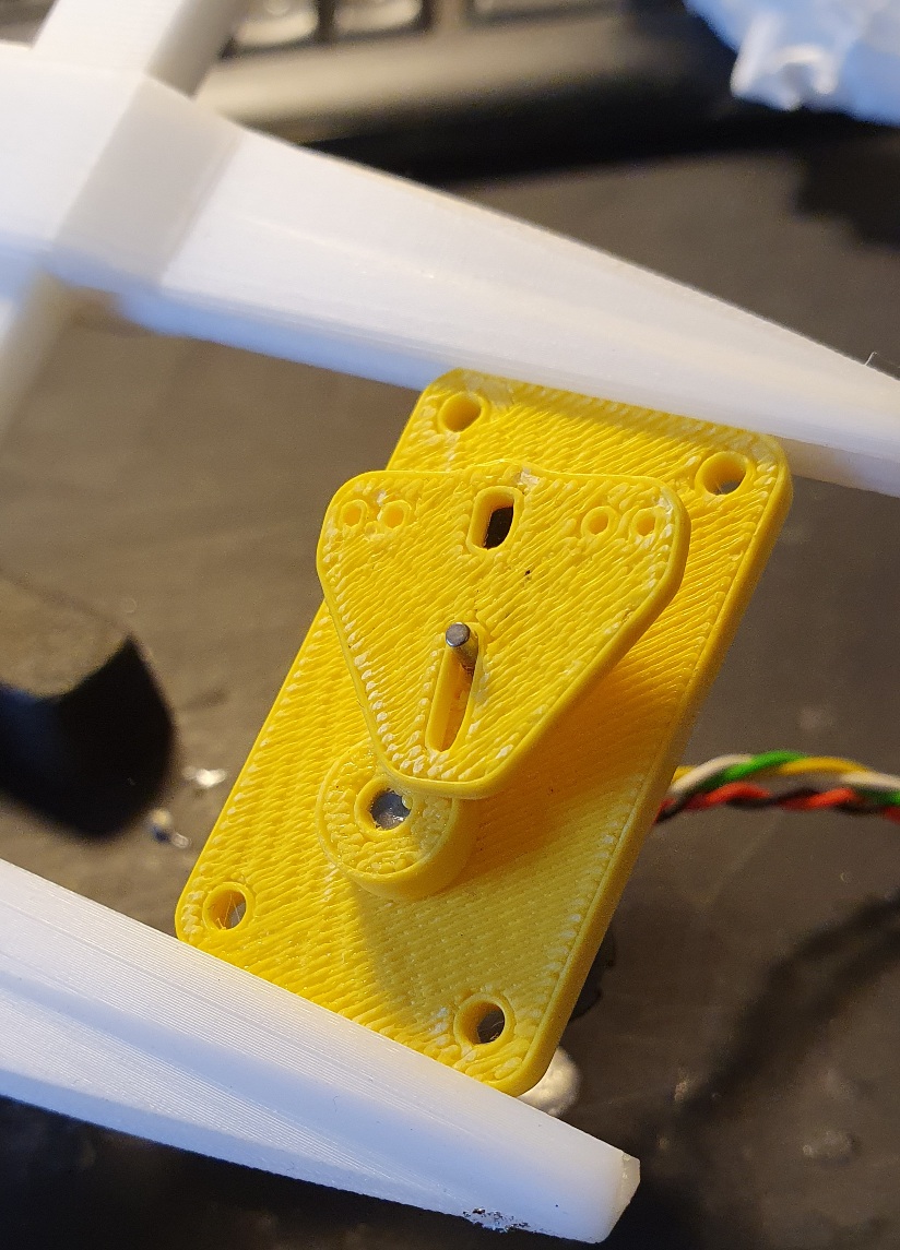

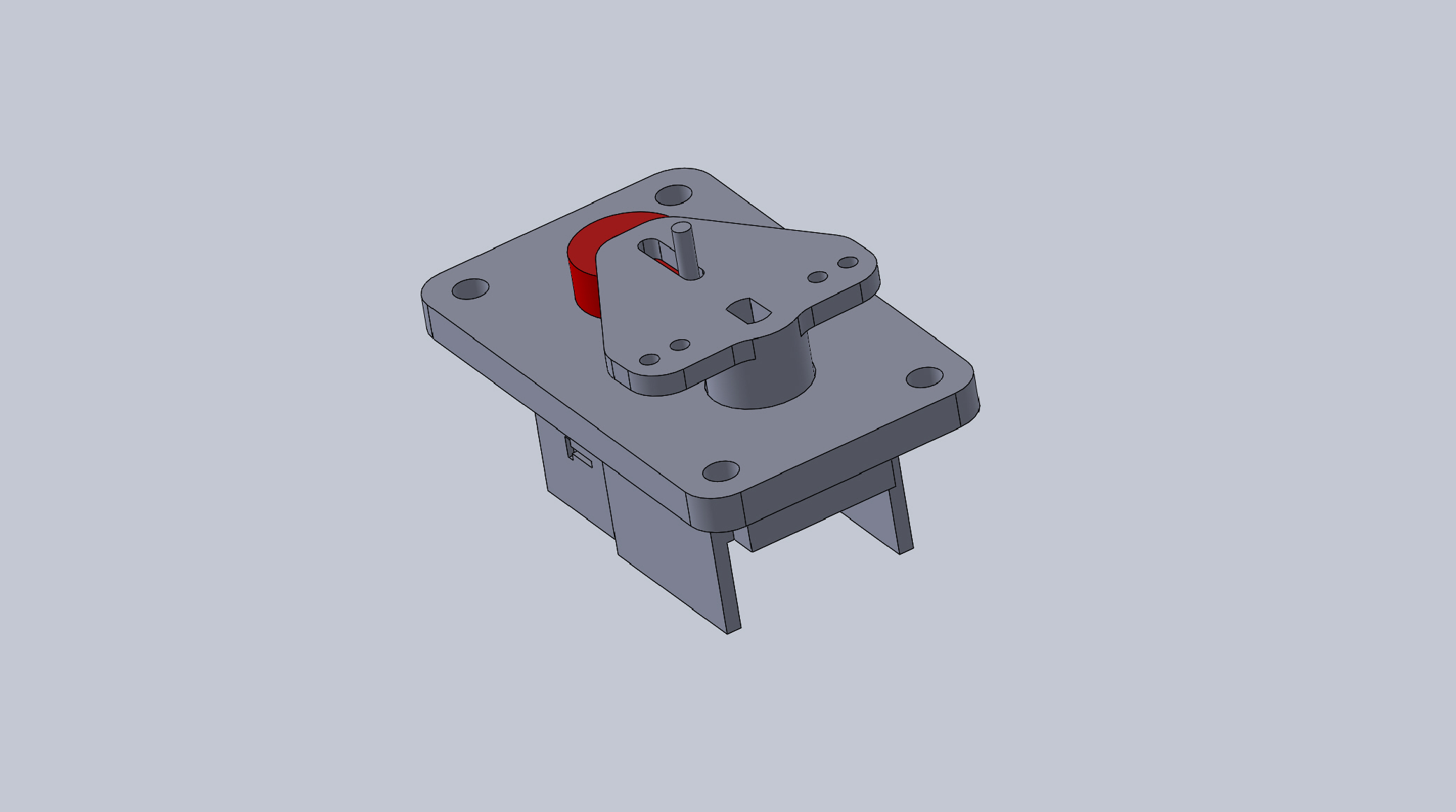

Sometimes I got too much time and I end up in "projects" and here is one I would like to share with you all...as you know I have built a few complete homebuilt TX an RX combining a few other projects here like Phil's NRF24 FHSS Tx & Rx but realized that if I was not going GG I had to use commercial Digital Proportional servos. The size is comparable with my latest GG Modular actuator.
What you see is a simple basic digital proportional servo that could easy be done with what most of us have in our workshop.
The basic concept is to avoid any spur gear to connect the feed back pot to the motion of the servo arm/motor and I have come up with this solution, the motion will not be fully linear but barely noticeable within the range of operation. Actually the servo will show slightly higher precision around center, speed set to 0.18s/60deg .
The motor I use the same G12-N20 motor/gear set as in my GG actuator with just a different gear ratio and as a feed back pot I use a 5k 180deg stick pot.
For the time being I'm using tradition servo amp. based on NE544/HT7001 but eventually there might be a custom made similar to the Recoder used for the GG
...and yes, eventually I will share the files and building instructions.
Here is the result from my tinkering lately:The ProPo project, a DIY proportional servo

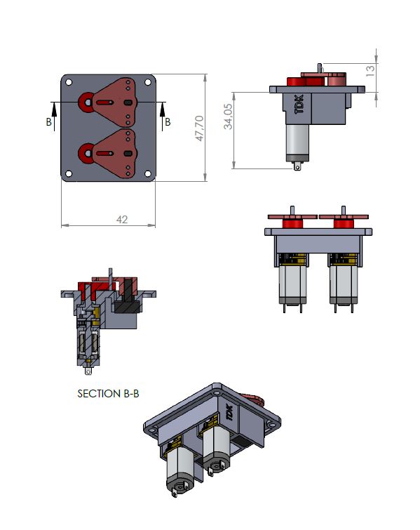

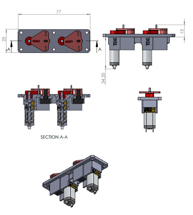

Would I be correct to assume(?) that the mounting plate could be modified into a 2 servo version, either tandem or side by side?

If I got it to develop in the direction I'm hoping for there are all possibilities for combinations including a " 2-3 channel brick"Would I be correct to assume(?) that the mounting plate could be modified into a 2 servo version, either tandem or side by side?

Re: The ProPo project, a DIY proportional servo
I've probably missed something important here but is the triangular output plate necessary? Could it be omitted altogether and just use the arm which moves the plate to operate the pushrod directly?

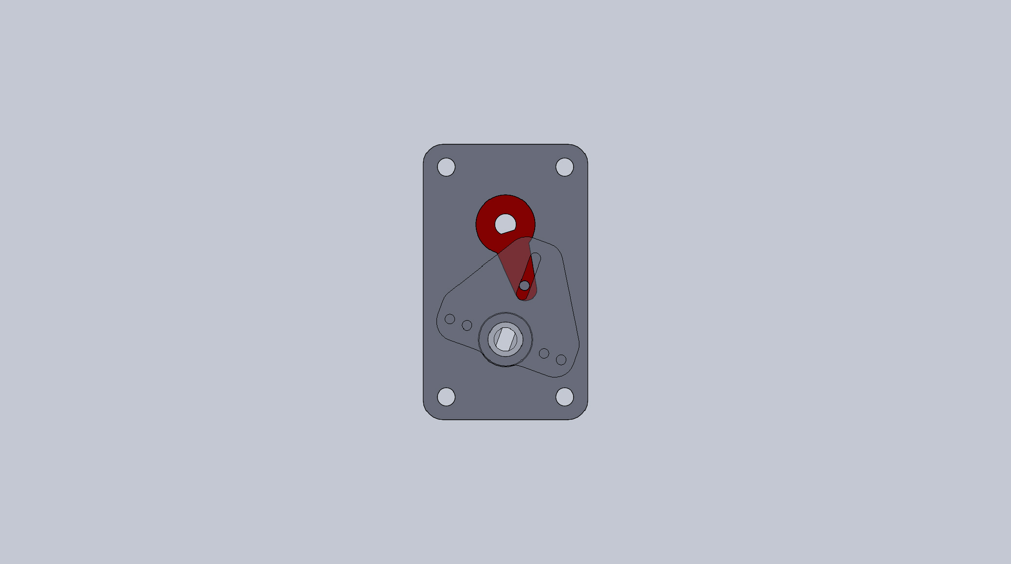

- Posts: 714

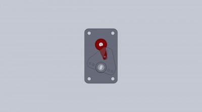

There are many way to do it and this is my way so feel free ...
The triangular plate is connected directly to the feedback pot and the arm with the dowel pin is the driving unit connected to the driving motor. The dowel pin will slide in the slot of the triangular plate and the the relation of the 2 operation radius is such to minimize the error caused as angle change. As the triangular plate rotates by the driving arm it will also give the proper feedback of its position via the pot to the electronics. This is normally achieved in regular servos by connecting with spur gears the pot with the driving shaft.

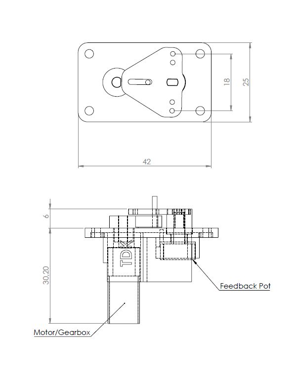

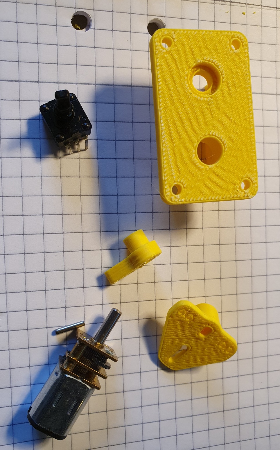

- Posts: 714

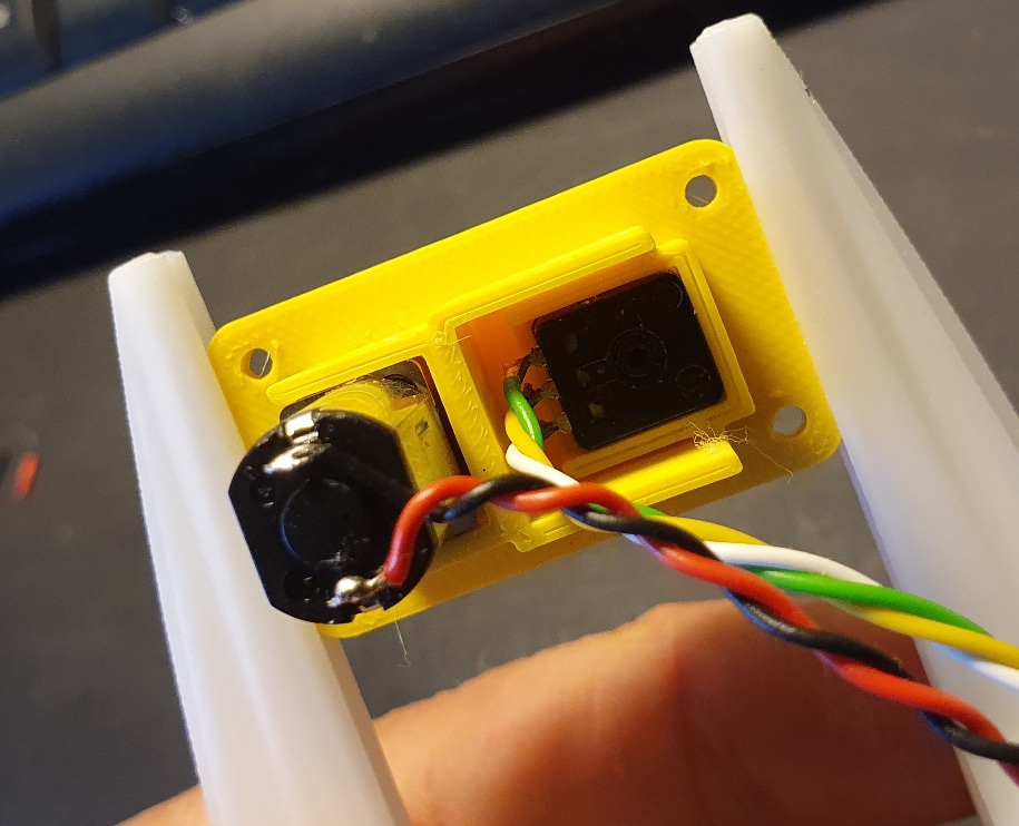

This is for you Wayne.
The motor/gearbox and the pot are press fitted in the base, the rudder arm is the press fitted to the shaft of the pot and the hole in the base for the rudder arm is sized so it works as "bearing/support" for the shaft of the rudder plate and basically it's the same principle for the driving plate to.
Most components are press fittings on the tights side and I mean in the range + 0.005/0.01 mm -0.005/0.01 mm, second as I use a motor set up with a gear ratio of 298:1 the bond between the motor shaft and the driving arm needs to be rock solid to not strip, so there I use thin CA that actually melts slightly the ABS and penetrate so when it cures and the ABS gets solidified again after a few hours it makes a very solid bond. As every servo neither this one should be moved/rotated by hand!
I'm going to supply at cost however a semi-kit like I do for the DIY, 3D-printed parts and hardware but no electronics
In the .zip folder you will find .stp files of the assembly of all 3 models, all tolerances are set after my printers and ABS but if you are used to deal with .stp files you know also how to modify after your requirements. There are out there a few .stp viewer that free if you like to take a peek and this one is just what I use https://stpviewer.com/
I have realized that there are too many critical tolerances and all printers are different so I will not be able to adapt it properly to all different machines and due of its construction only ABS parts will work...but if you really want to give it a try PM and lets see what we can do.The motor/gearbox and the pot are press fitted in the base, the rudder arm is the press fitted to the shaft of the pot and the hole in the base for the rudder arm is sized so it works as "bearing/support" for the shaft of the rudder plate and basically it's the same principle for the driving plate to.
- Attachments
- ProPo.zip
- (5.16 MiB) Downloaded 296 times
- ProPo Twin Tandem.PDF
- (63.63 KiB) Downloaded 290 times
- ProPo Twin SbS.PDF
- (54.48 KiB) Downloaded 283 times
