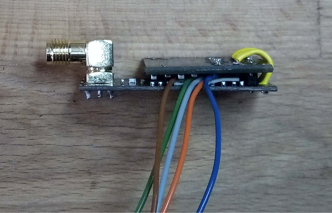

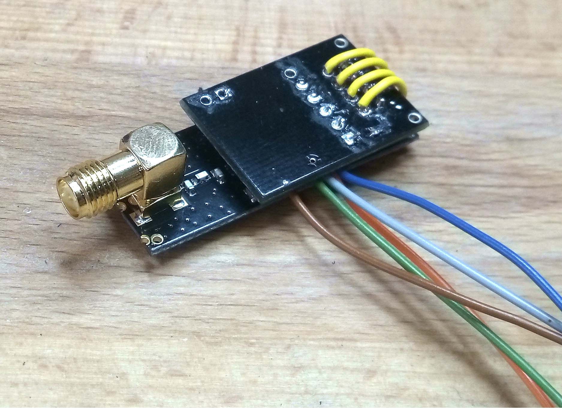

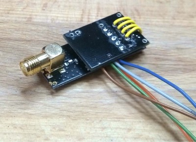

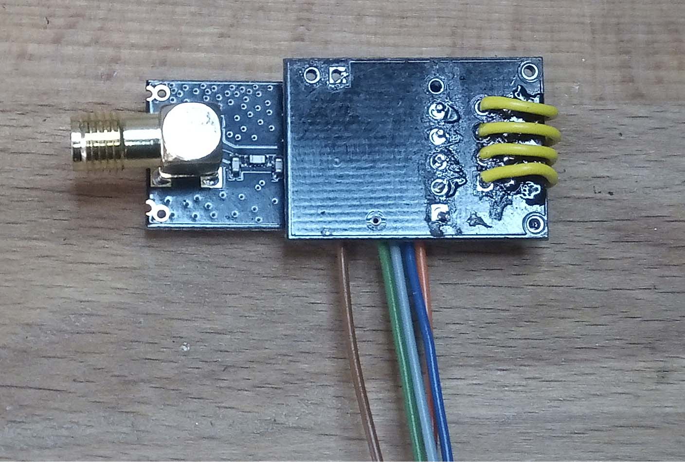

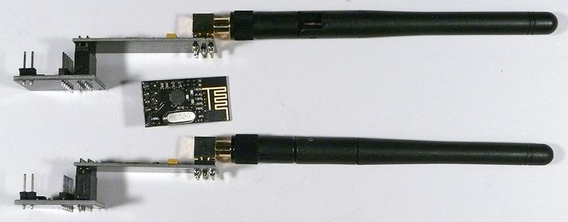

For the transmitter, especially smaller ones, here's the 'compact' arrangement of the NRF24L01+PA and its piggy-back adapter board again, taken from the hybrid thread:
They normally fit together like this :
... which is a bit unwieldy - much neater to piggy-back the 5v adapter on top of the NRF:

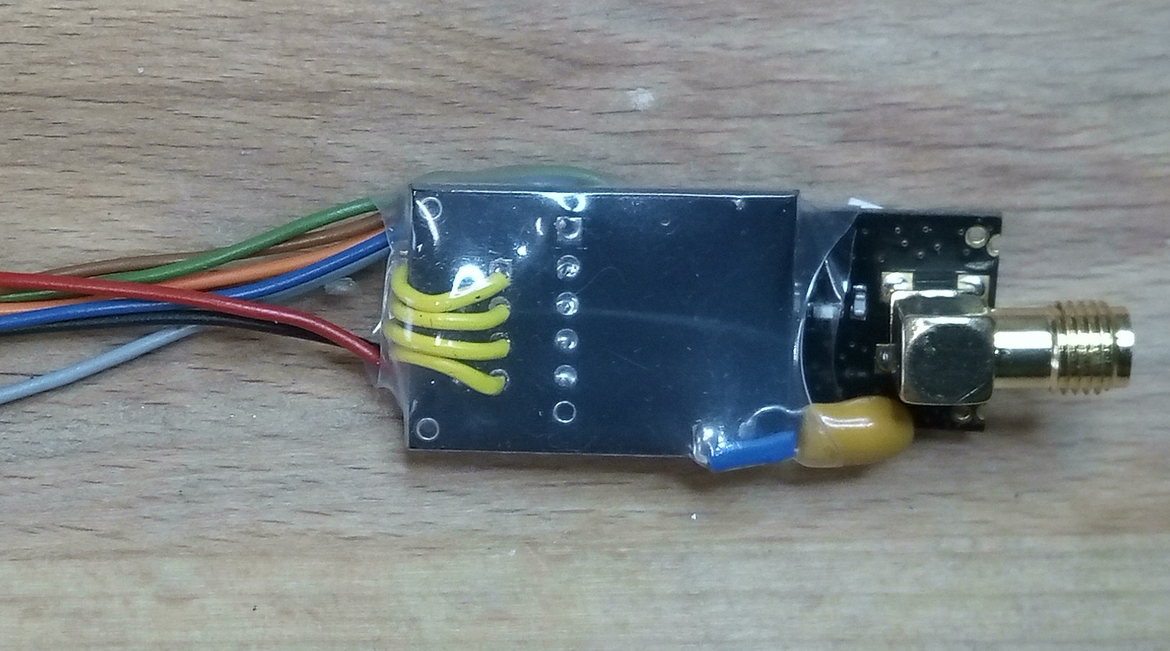

I've started adding the 100µF tantalum across gnd & 3v3 every time now.

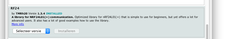

I need some help finding the nRF24L01.h library. I found and installed the RF24 lib. , and I have a feeling it is part of that library, correct?

Thanks Phil.
I found the RF24 in my Arduino library manager: And compiling the sketches is ok, so it recognises nRF24L01.h and all is fine.

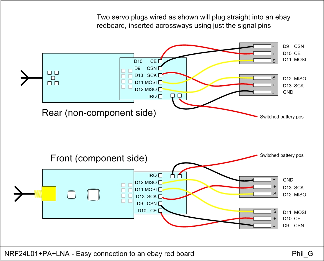

Hi Phil,
I am getting a bit confused on the CE,CSN connections, so to confirm, this is how I understand it:
I should use this in both sketches for Tx and Rx, regardless if I am using a Nano RF or a high power module in the Tx: and when I use the high power module, it should be hooked up like so:
Is this correct?
Max.
