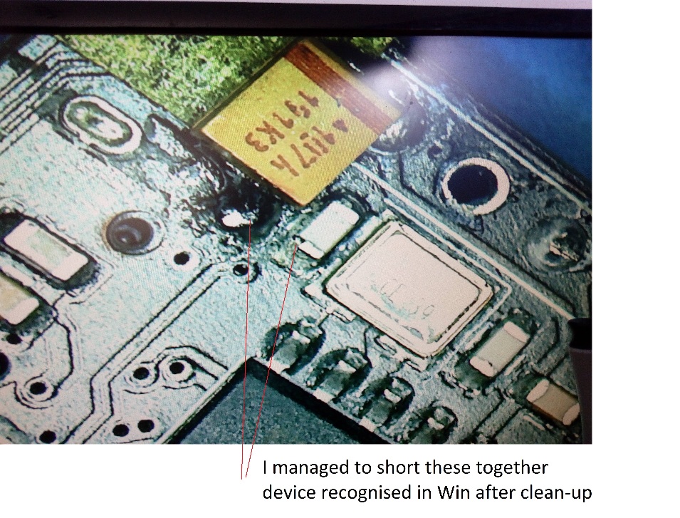

Ummm..the plot thickens then... It is entirely possible (indeed, most likely after your comments on USBasp) that I used the usb com port to program the device for the first time, however it is now not greeted with the usual 'ding ding dong' when plugged in to windows, so no more programming.. at least that is what I thought... but it turns out, after your prompting, and after inspecting under the microscope, I had managed to short one side of the CH340 xtal to ground when soldering in a 100uF smt cap to the 3v3..
Now the serial ship is running again I can re-program the device.. :roll:

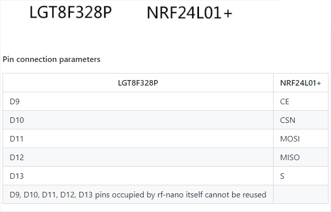

According to https://github.com/nulllaborg/lgt-rf-nano BUT this has 9 & 10 swapped wrt the Keywish we've been using so far...
I'd try the isplus test too = this will confirm its a plus and that the 328 is talking to it...
viewtopic.php?p=8890#p8890 you'll need to swap 9 & 10 tho if its different to the Keywish which is:
RF24 radio(10, 9); // RF-NANO and new builds, ce=10, csn=9
On the Tstars I had to physically buzz it out from the NRF legs to D7/8 as the docs were wrong!

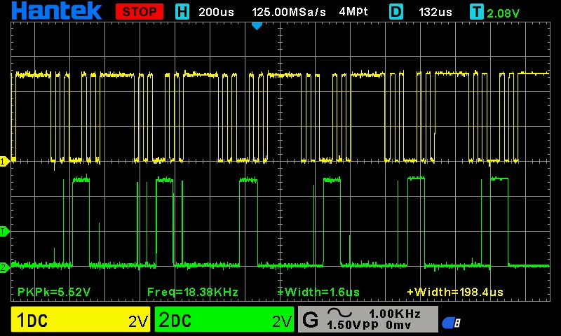

I can see the sck pulses, I can see CE goes +5V, I can see a 18kHz +5v square wave on CSN, I can see a clock pulse on SCK, if I touch MOSI with my scope probe the servos jitter (+5v but only a crappy 25mhz analogue scope) and I see 0v on MISO unless the servos are jittering then I see a noisy signal. No amount of stick stirring alters any of the signals........ the nrf24l01+ isn't seeing the incoming signal.

Phil_G wrote: 17 Jun 2022, 12:21
I think the docs here will be right as the examples that come with the IDE download also have RF24 radio(9, 10); and I have found the reason
why my board doesn't work, thanks anyway Phil. I have come to the conclusion you were right.... tobes Rx is the nicest solution!

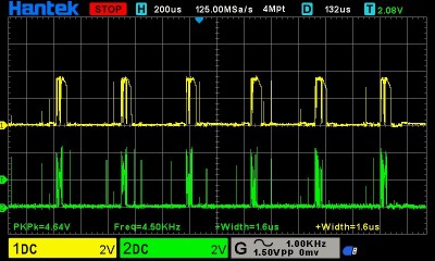

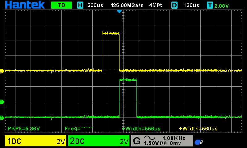

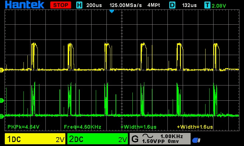

New LGT8F328P rf-nano arrived today and.... it doesn't work. I have buzzed out the CE and CSN lines and they are as per the schematic CE=D9, CSN=D10.
I get -
D2 (yellow) D3 (green)
D4 (yellow) and D5 (green)
Which look to me like good servo control pulses (I have 3 channels wired together in the Tx as it is a 2 channel steerwheel)
I see the LED coming on after a couple of seconds,
I see -
D9=5v (CE)
D10 (CSN) yellow trace and D11(MOSI) green trace
D12 (MISO) yellow trace and D13 (SCK) green trace
not sure what I should see on D13 but I expected a more uniform clock signal.. ?

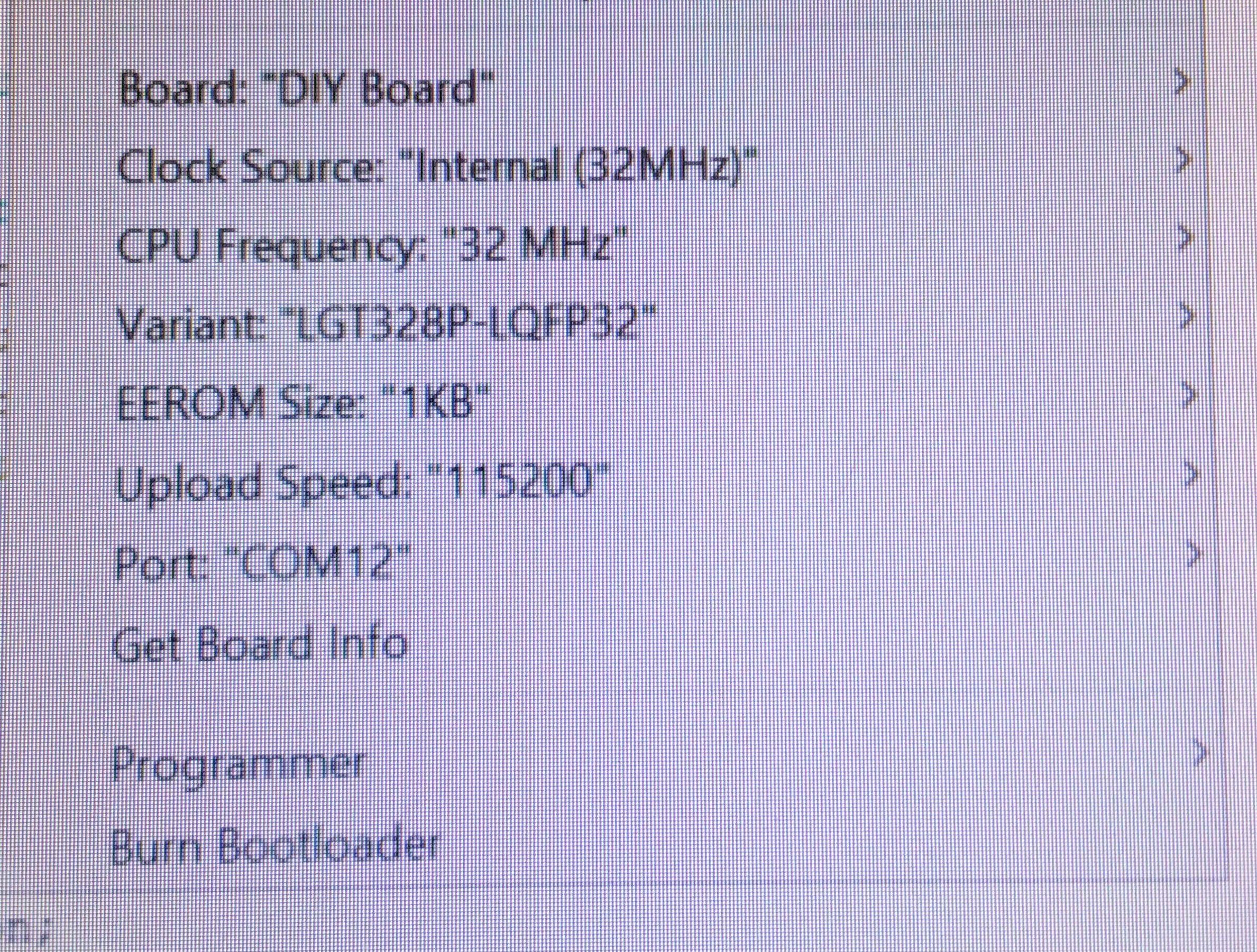

I just tested PhilG's transmitter sketch for the first time on my LGT8F RF-NANO, and it's definitely transmitting something (as viewed on my band scanner). All I did was put in my random pipeOut[] number at line 47, my random channels at line 48, and altered line 55 to RF24 radio(9, 10);
Most importantly, used the Nulllab board manager and set the EEROM Size: [sic] option in the tools menu to 1KB before uploading.

Then just compile and upload in the ususal way, with EEROM Size set to 1KB.
