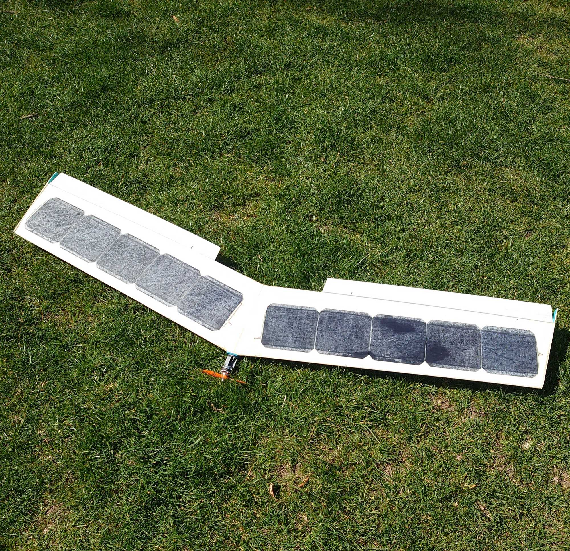

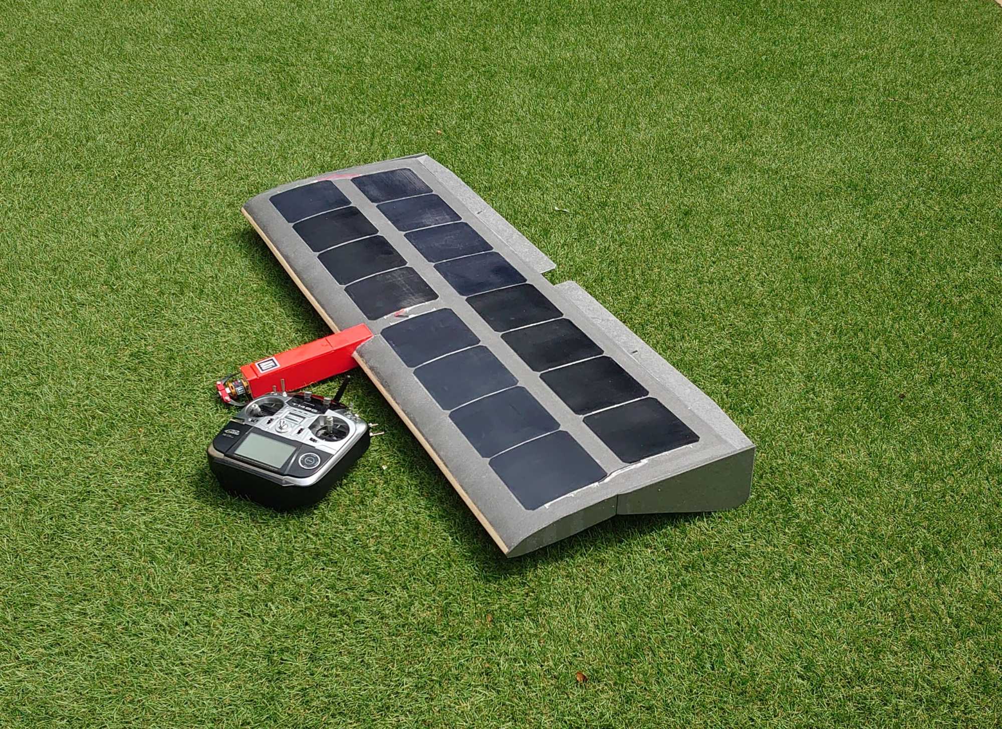

My 10-cell model made a duration flight of over an hour last week. Duration was only limited when I became too bored to continue flying. A couple of days later the record was broken when I flew it for another hour and then Mike took control of the transmitter for an extra 15 minutes or so.
Later, Mike used his 12-cell 'delta' to just beat (or at least equal) the record - he would have flown for another few minutes to make it more certain but was forced to land due to lack of power caused by increasing cloud cover and low sun angle as evening approached.
With a well-charged transmitter battery and a team of pilots to take turns with the flying, duration of 8 hours or more could be easily achieved on a sunny summer day.

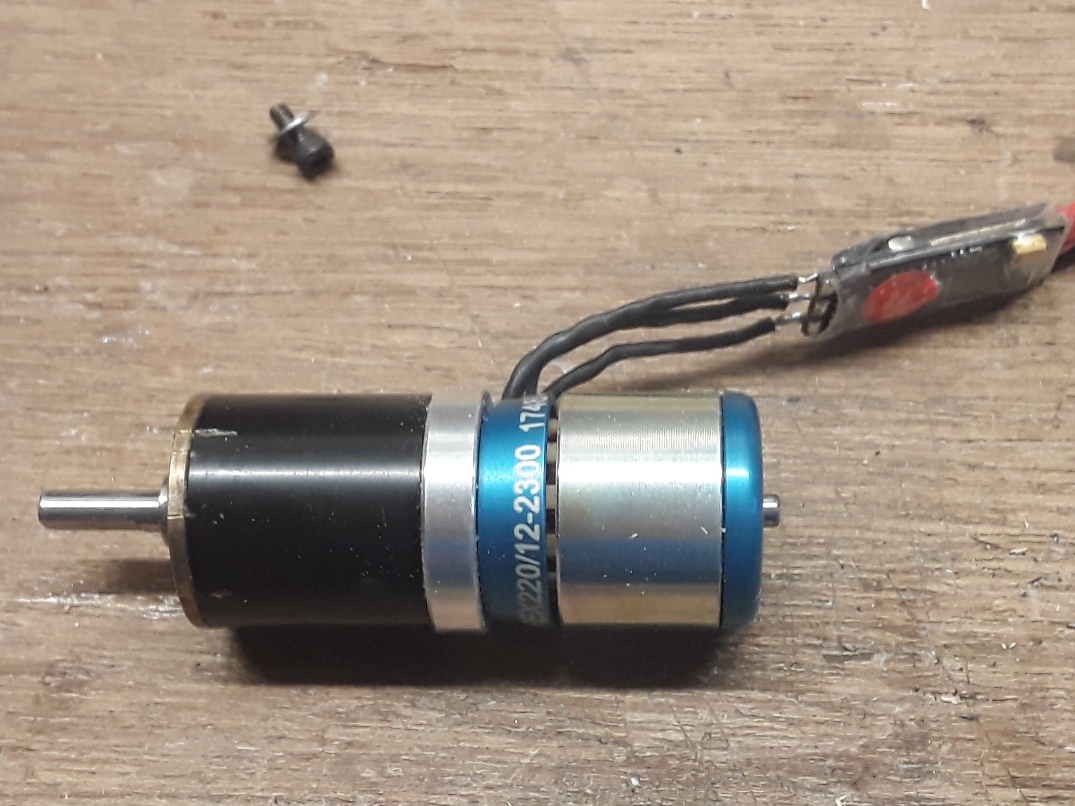

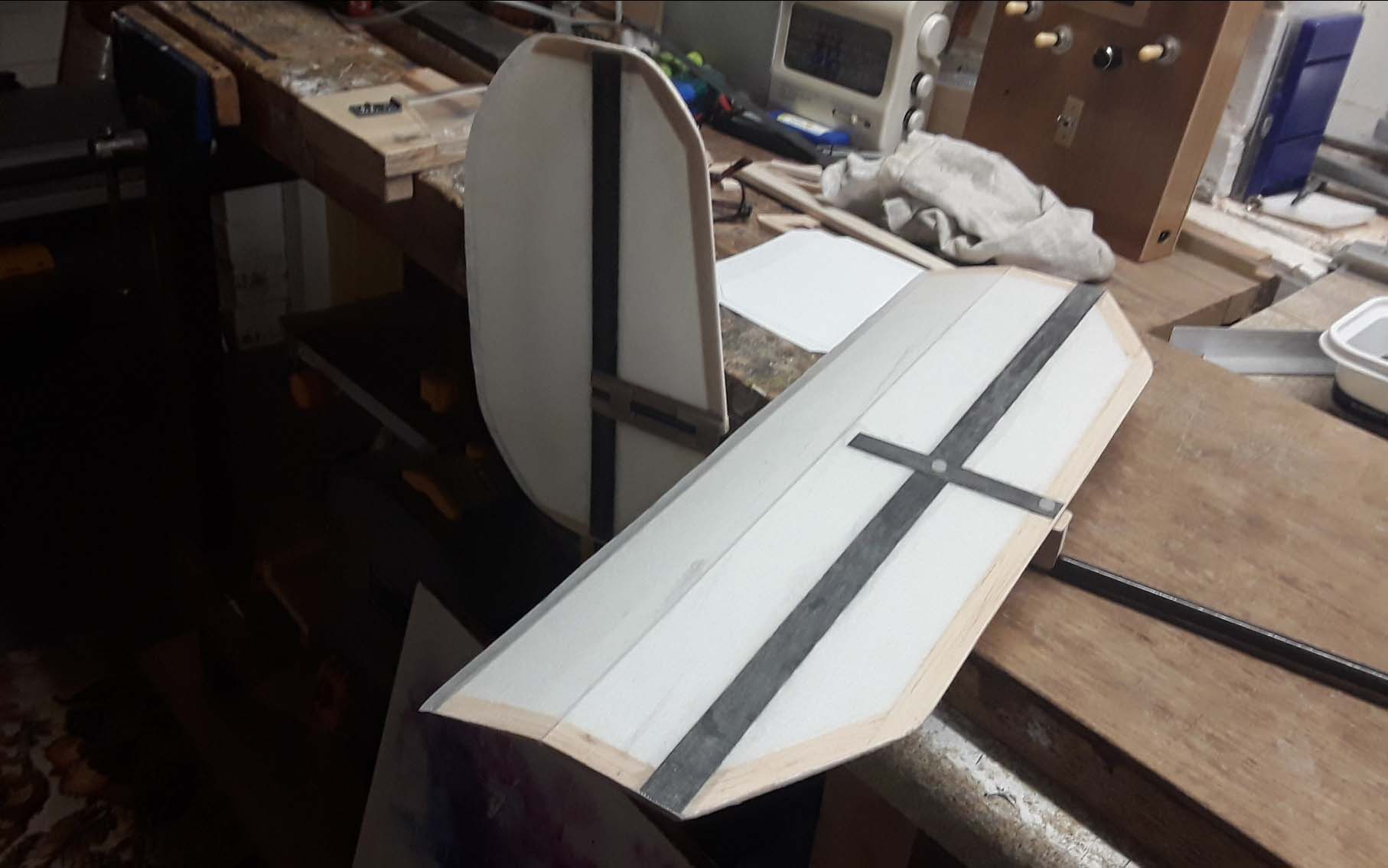

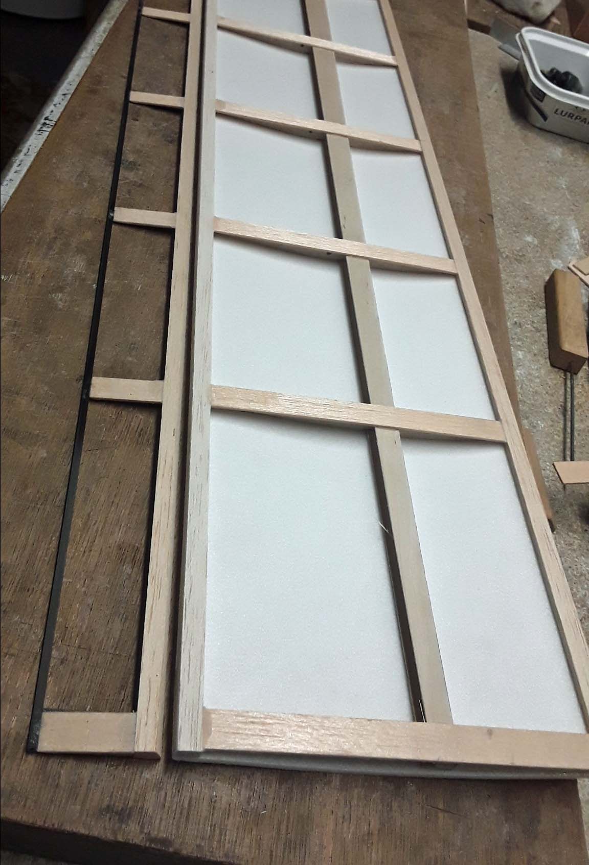

This time I am doing a normal plane along the lines of a dlg. I have a wound carbon tube for the rear and am working on a smoother wing. The tailplane and fin are 3mm depron with a balsa edge and carbon sheet spar. The one side is covered in glass cloth with acrylic varnish. The trailing edge is sanded nearly flat and then the other side is covered, leaving about 5mm of glass cloth TE from both sides to give a fine edge.

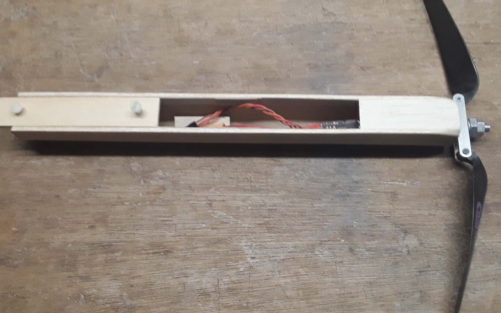

The body is a half rolled 0.4mm ply structure with 3mm ply plate to bolt the wing to. The motor is a old kontronic gearbox with a tiny 2300kv motor, it should drive a 11x8 folding graupner prop.

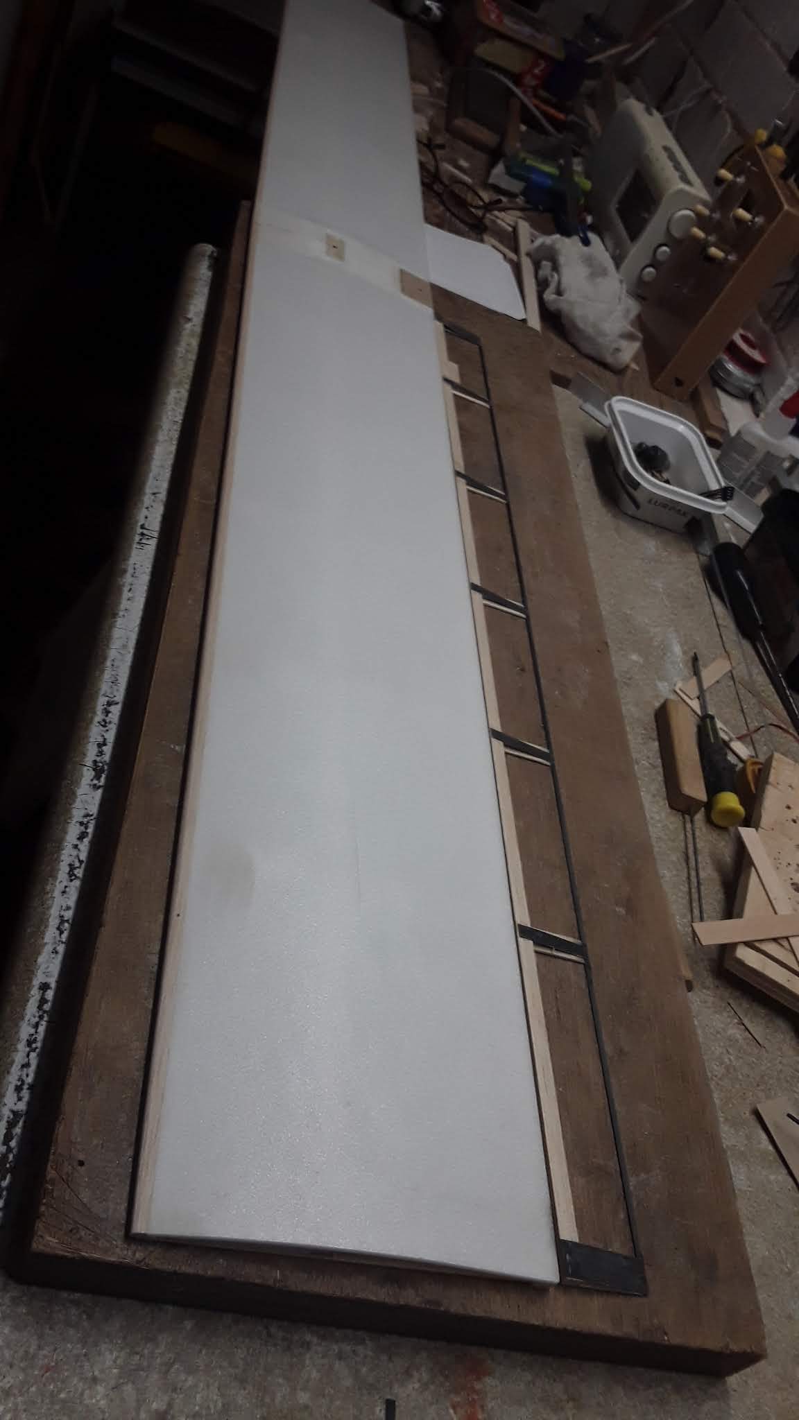

Re: Solar-powered model planes

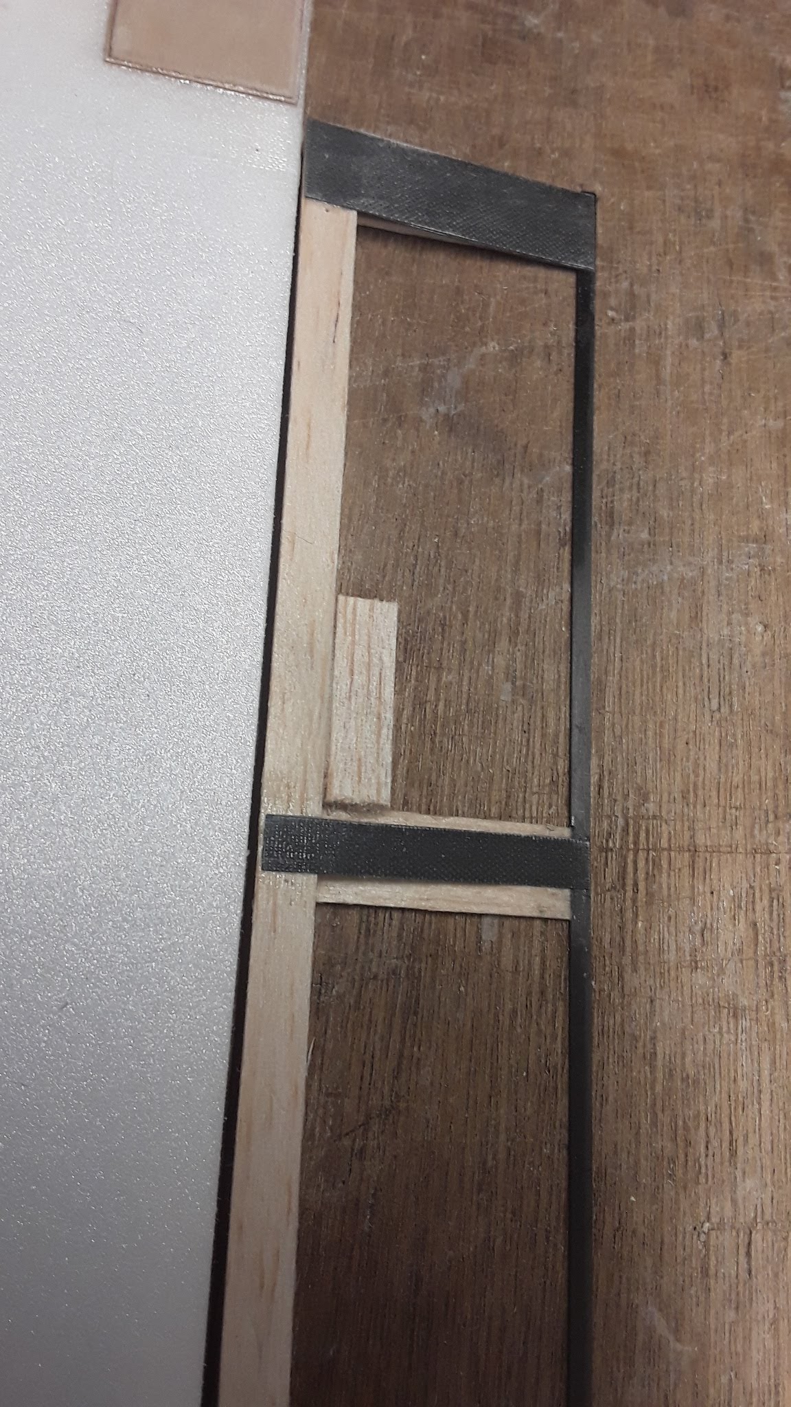

The wing has a 0.8mm ply spar top n bottom over a 1/4 balsa spar. The lower surface is open 1/16 balsa with balsa LE / TE, the top surface is 3mm depron. The ailerons are built up using 3x1mm carbon TE and some more carbon sheet capping. This now seems strong with good torsional stiffness and a sharp TE. Hopefully this will be a better section with improved gliding.
With the geared motor I hope that it will have good power in sunshine and improved performance in slight clouds. All following Martin's good advice!

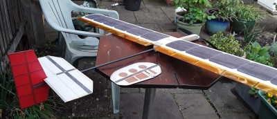

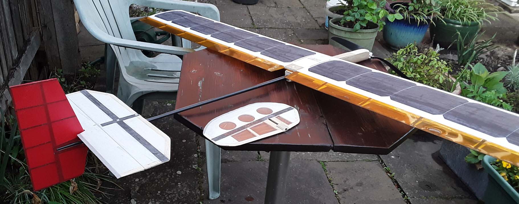

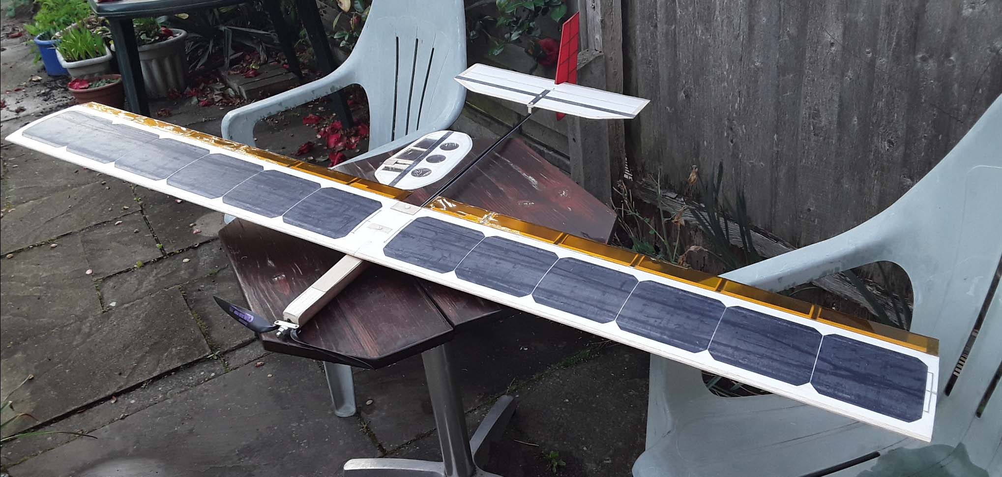

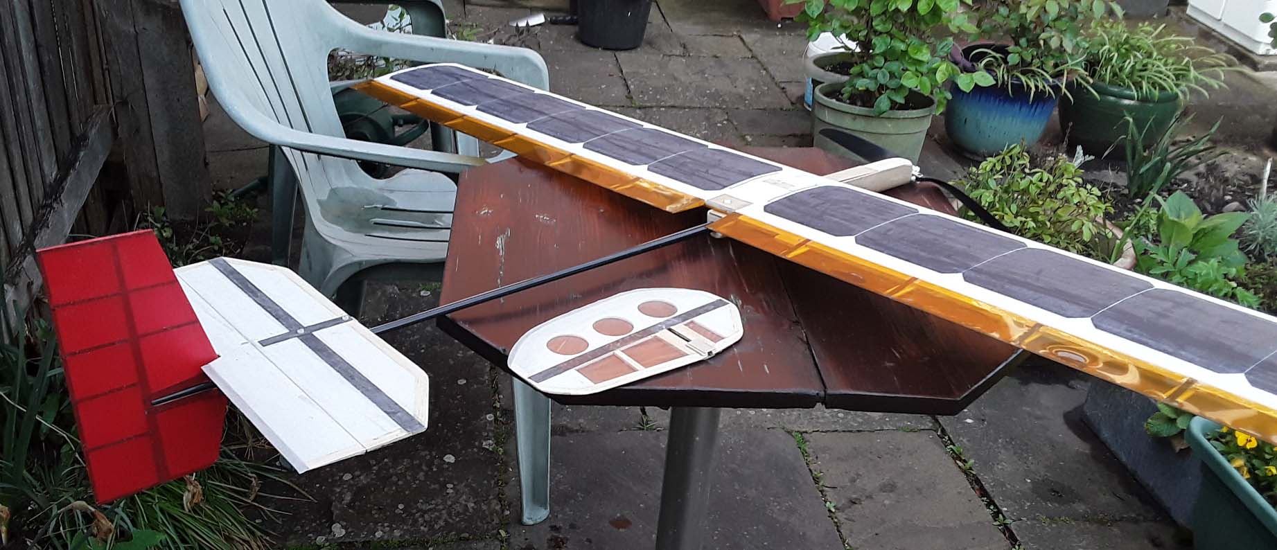

I have completed this new solar plane, it is about 500g. I found that the cog was further back than I wanted, so I moved the fin and elevator forward by shortening the boom. Then trimmed the tailplane attachment, finally cut holes in the fin removing some depron and covering it with mylar. This reduced the fin from 12.5g to 10.5g.
I had a brief flight in modest sunshine which showed that it goes well but too short to do much else. The cog is at the end of the balance range, a dive test just kept diving. I have 3 possible props, this 13x10 is the largest and heaviest. The adaptor should be a spinner but I only have a 3.2mm collett and need to get a 4mm set. The extra nut is just a spacing washer for this odd but useful 4mm collett from another 4mm prop adaptor.
The red fin is a new balsa carbon lifespan job, bit mean at only losing another 1g down to 9.5g, so now trying a depron one without any balsa frame.
