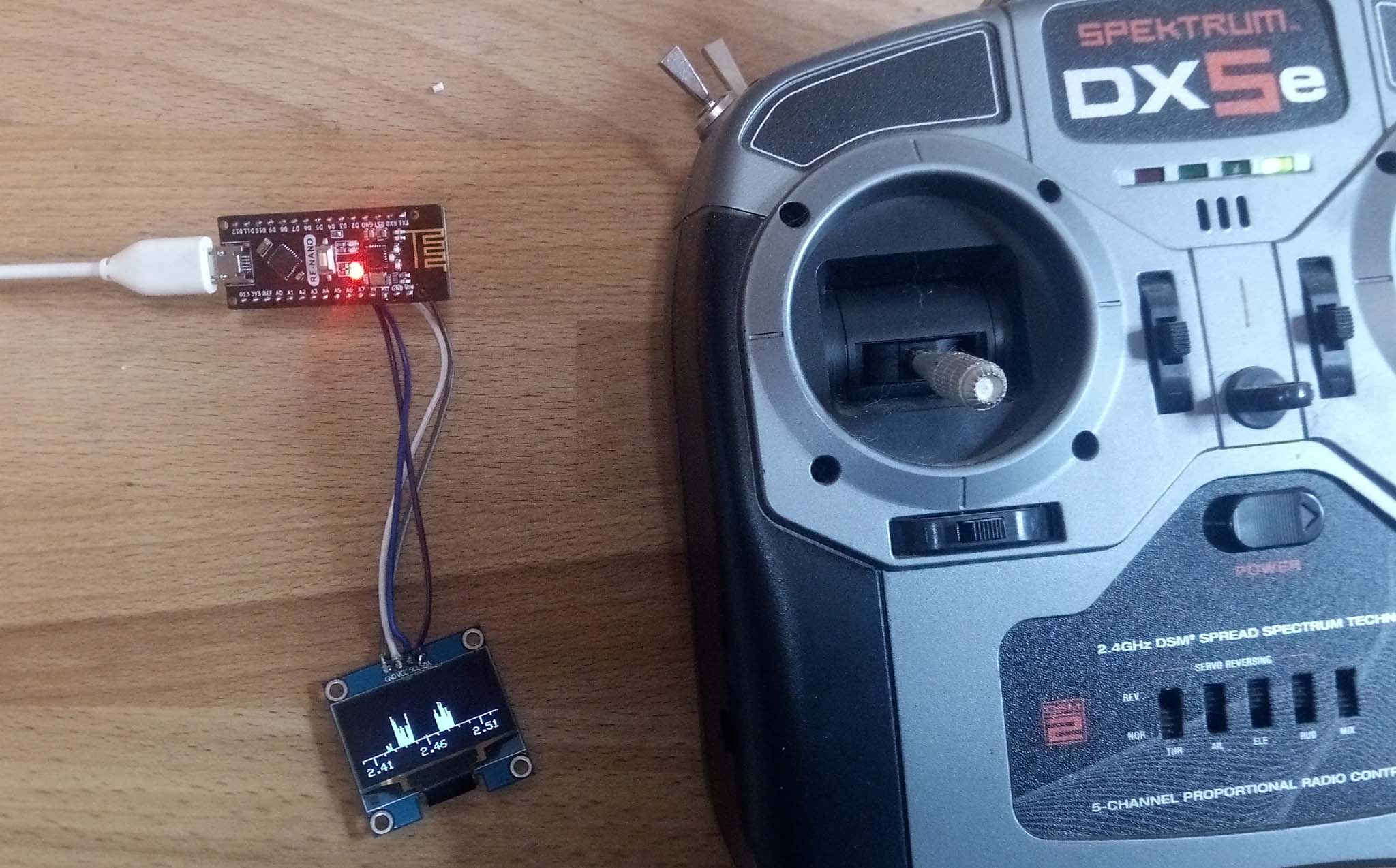

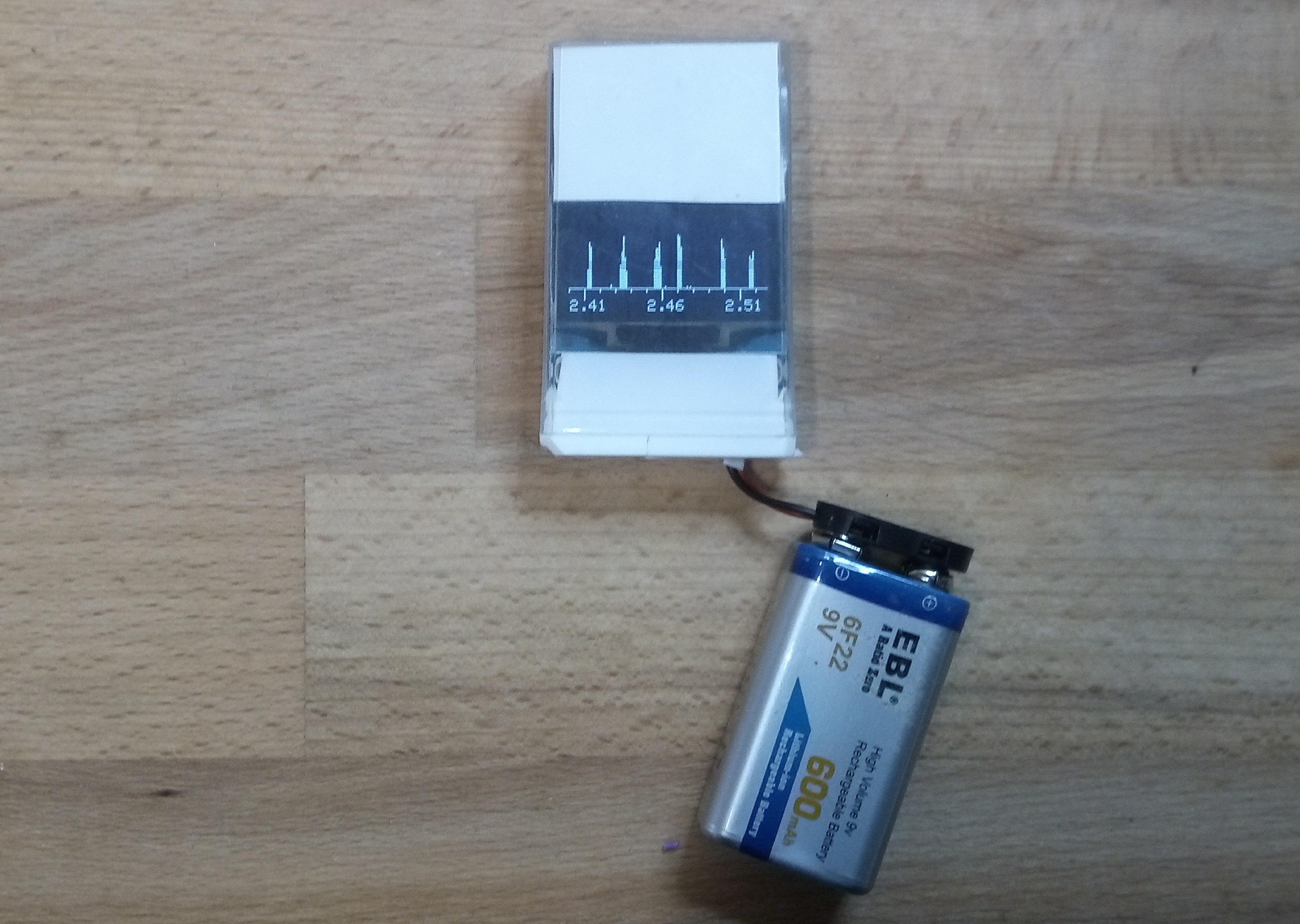

With the arrival of the RF-Nano a scanner can be built using just an RF-Nano, a cheap ebay OLED , a PP3 battery and a few short pieces of wire - its the simplest project to build yet is incredibly useful for displaying the spectral output of any 2.4g transmitter.

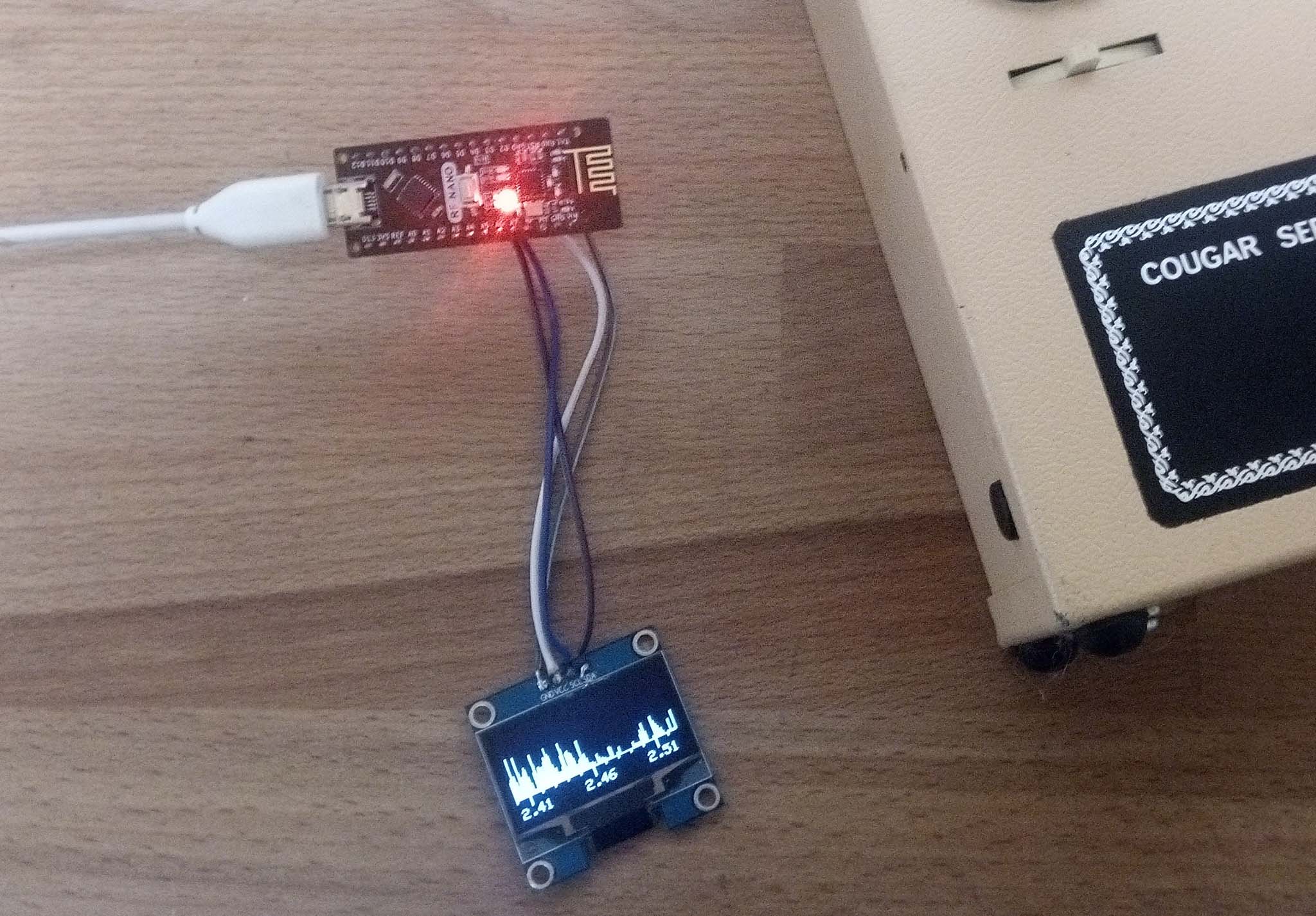

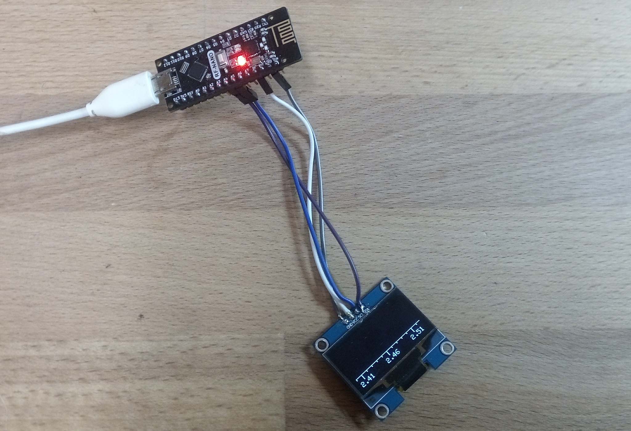

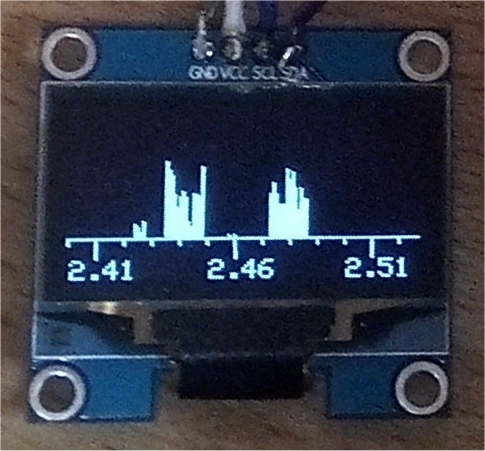

The photos show a 1.3" display:

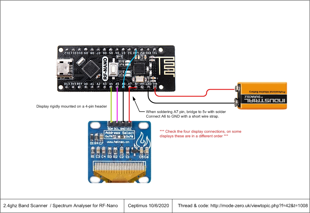

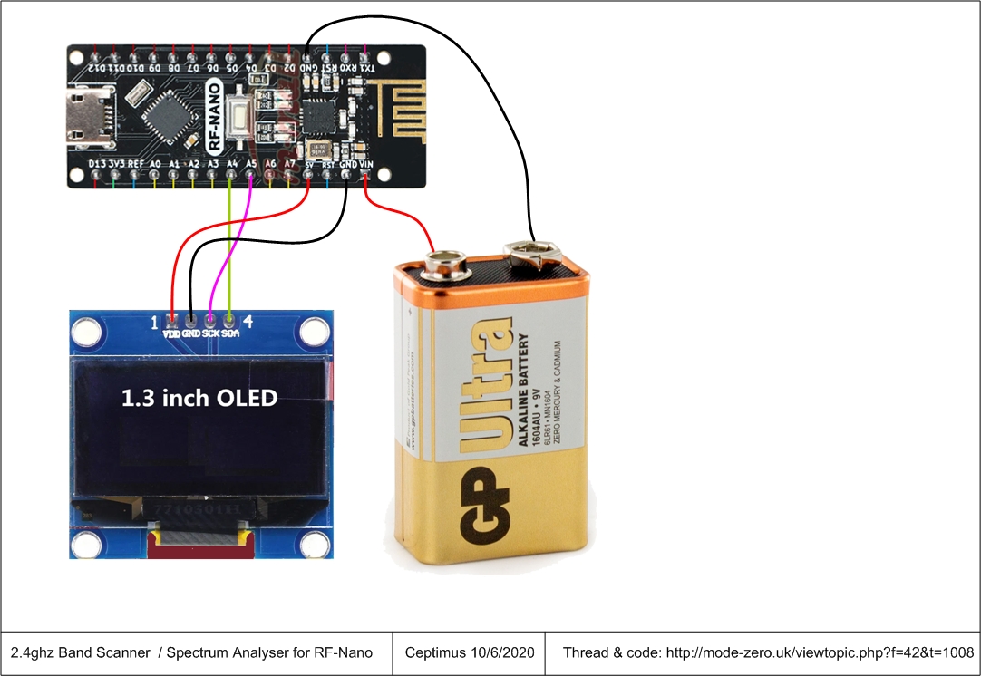

Heres - the diagram - it really is this easy, but check the display annotation as some OLEDs have the
four pins in a different order, as you can see from the photo above :D
By borrowing the redundant A6 & A7 input-only pins for the power connections, the display can be rigidly mounted on a 4-pin header soldered to A4, A5, A6 & A7 but only IF the order of vcc, gnd, clock & data align correctly: (if not its only 4 wires....)

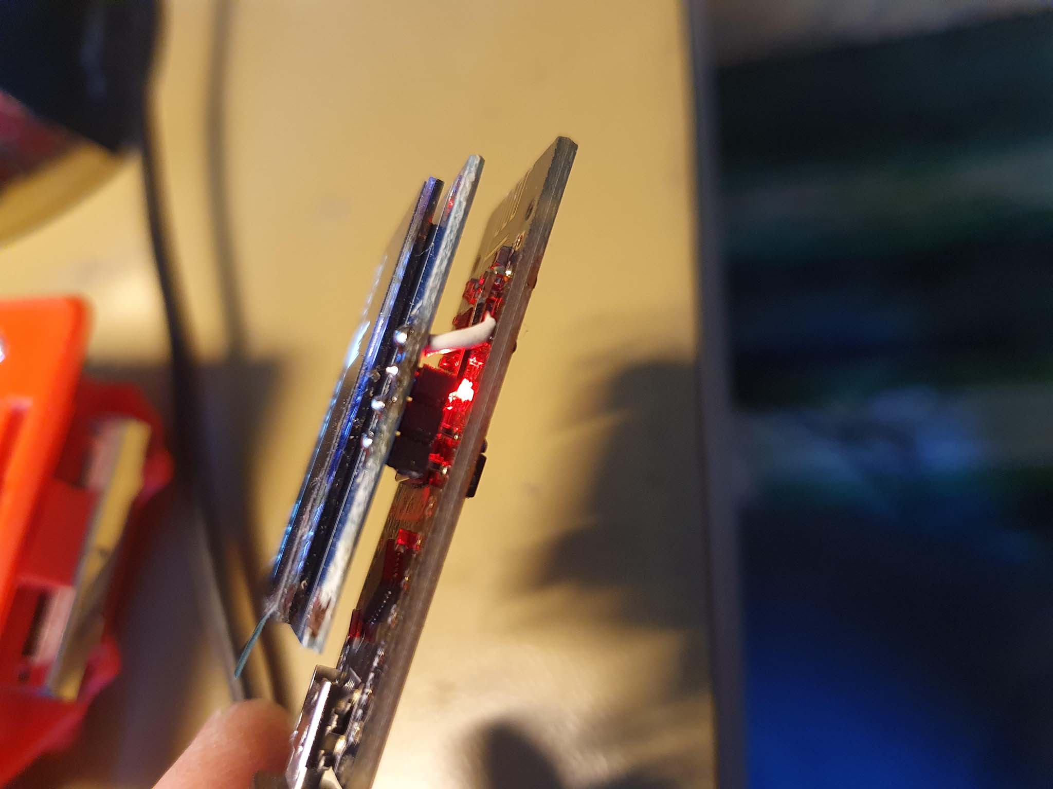

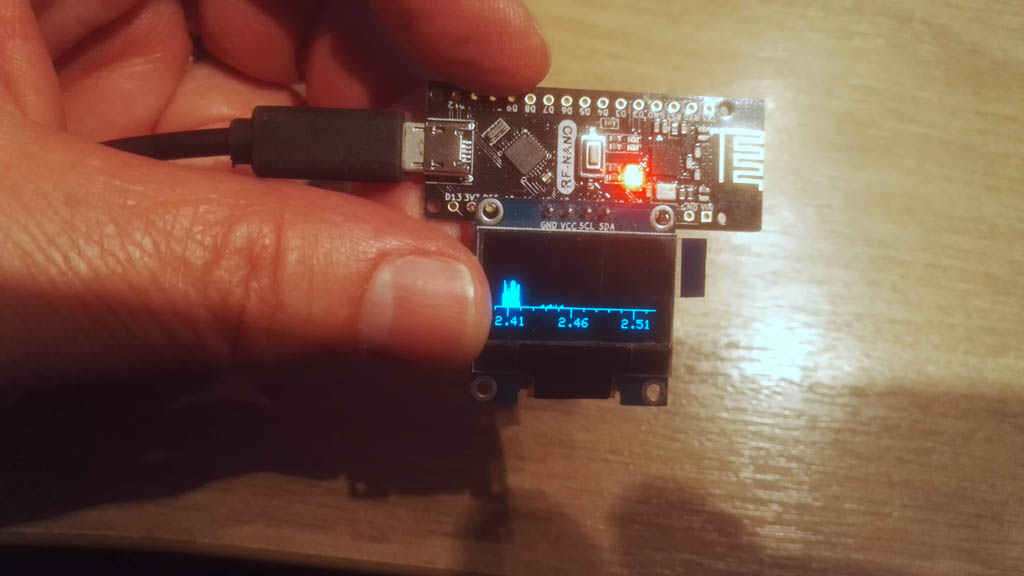

...as many of you might have noticed I use a lot and often pin heads to stack boards and here I use 2 between A4-A5 and SDA-SCK and in such way I obtain a fix connection between the 2 board.
This scanner is of invaluable help when working/following RF projects, Thank You

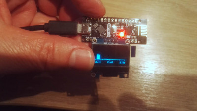

Hi Max
I've added soft I2C to Martins program and swapped SCL and SDA around in software, configured A2 as ground, A3 as Vcc, A4 as SCL and A5 as SDA so the OLED just goes straight into the RF-Nano and there are only four solder connections to make. About as simple as it gets.
Make sure which way around the supply on your OLED is, I found two OLED in my parts box and one had the pins in the order GND, Vcc, SCL and SDA which is what the order in the program is.
The other OLED pin order was Vcc, GND, SCL and SDA and would need the supply swapping in software.
#define GND 17 //A3
#define Vcc 16 //A2
In the photo, I'm powering it via the micro USB. It is slightly slower than Martins hardware I2C version, but unless you have them running side-by-side, you wouldn't notice the difference.
nRF24L01pScannerOled_Soft_I2C.zip
(10.1 KiB) Downloaded 364 times
